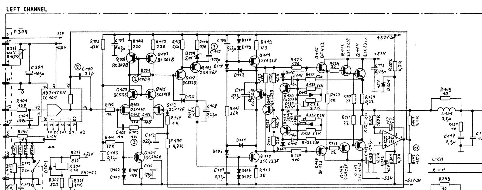

If I understand correctly Lender configuration is a simplified version of the added emitter follower between LTP and driver of VAS. It gives more accurate V-to-I conversion from input to voltage amplification stage. Double CCS current drive VAS with emitter follower arrange was used in Revox B285/286 as well from 80's. Its sound was spotless.
See the protective diode and the 2.7 kOhm level shift resistor ?
This Revox looks interesting. I actually have some SK170 Jfets available 🙂

This Revox amp must have low-voltage rails, if one BC327 (Q109) transistor can take both rails voltage and survive...
And all these visible transistors are small BC type, not even one TO-126.
This must be 20W amp...
😀😀😀This Revox amp must have low-voltage rails, if one BC327 (Q109) transistor can take both rails voltage and survive...

Nope, here is actual schematic, differs from Egra's.
Rails are 50V, but transistors are different.. Must be 'premium' model.
Update: well, this is not original Revox schematic I guess. No idea where did I get it from...
But it looks like people like it, to re-do it with modern devices and higher power...
>R123 4.7K against 2,7 K!
This is not original Revox, we can't trust it....
It's a upgraded, modernized version from Brazil...
Who knows if this was even ever built...

Found service manual for real Revox 285.
Different transistors. Rails 52V
I guess original printout did not show transistor types or values, and someone added it manually.
Luckily, Q109 is not BC327 🙂
