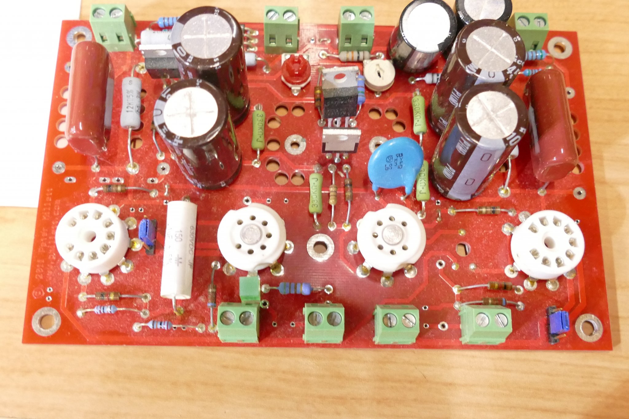

The first picture shows one of Pete Millett's driver boards, I used a pair of them for several experiments about 10 years ago, and I did crank up some 813's with it.

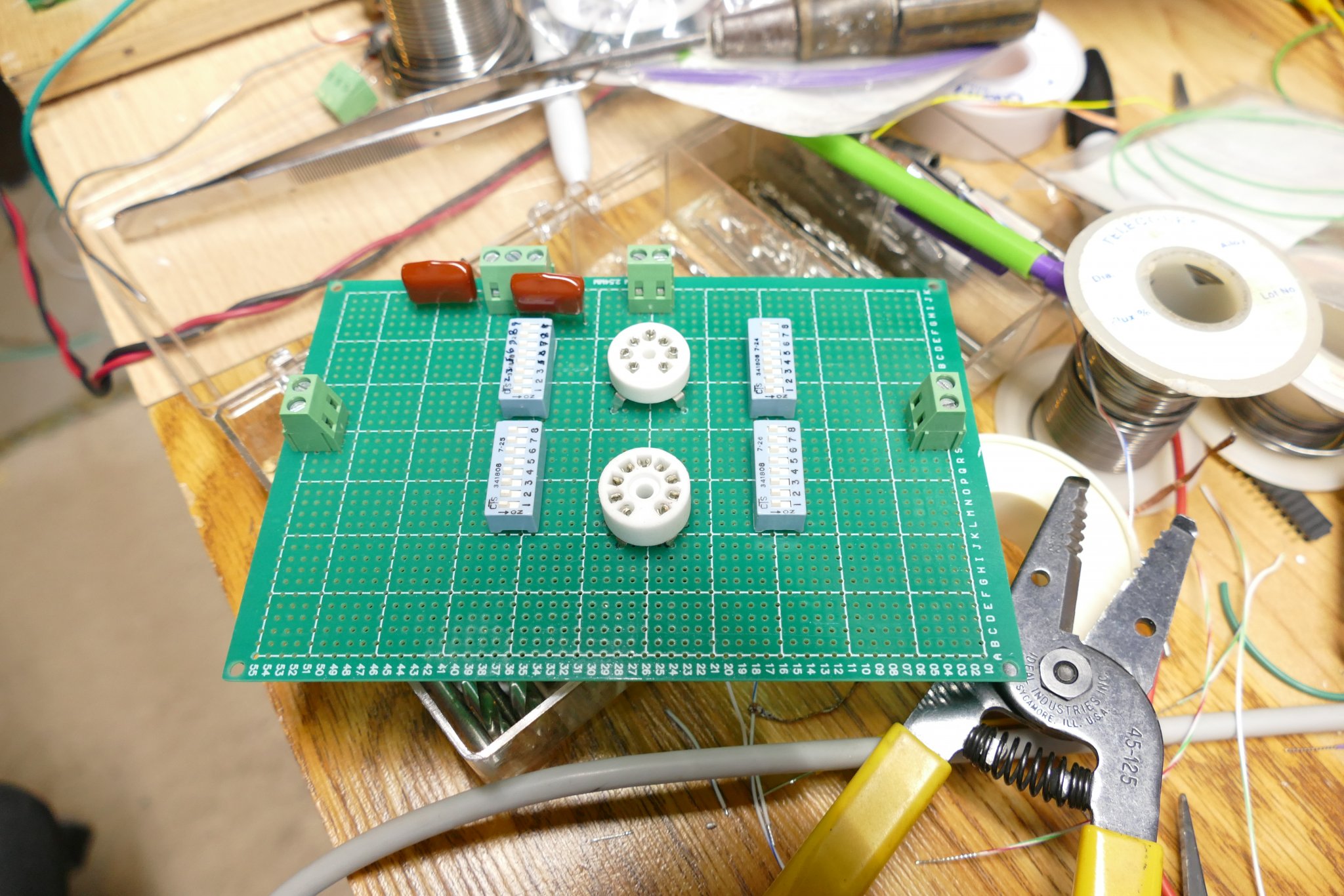

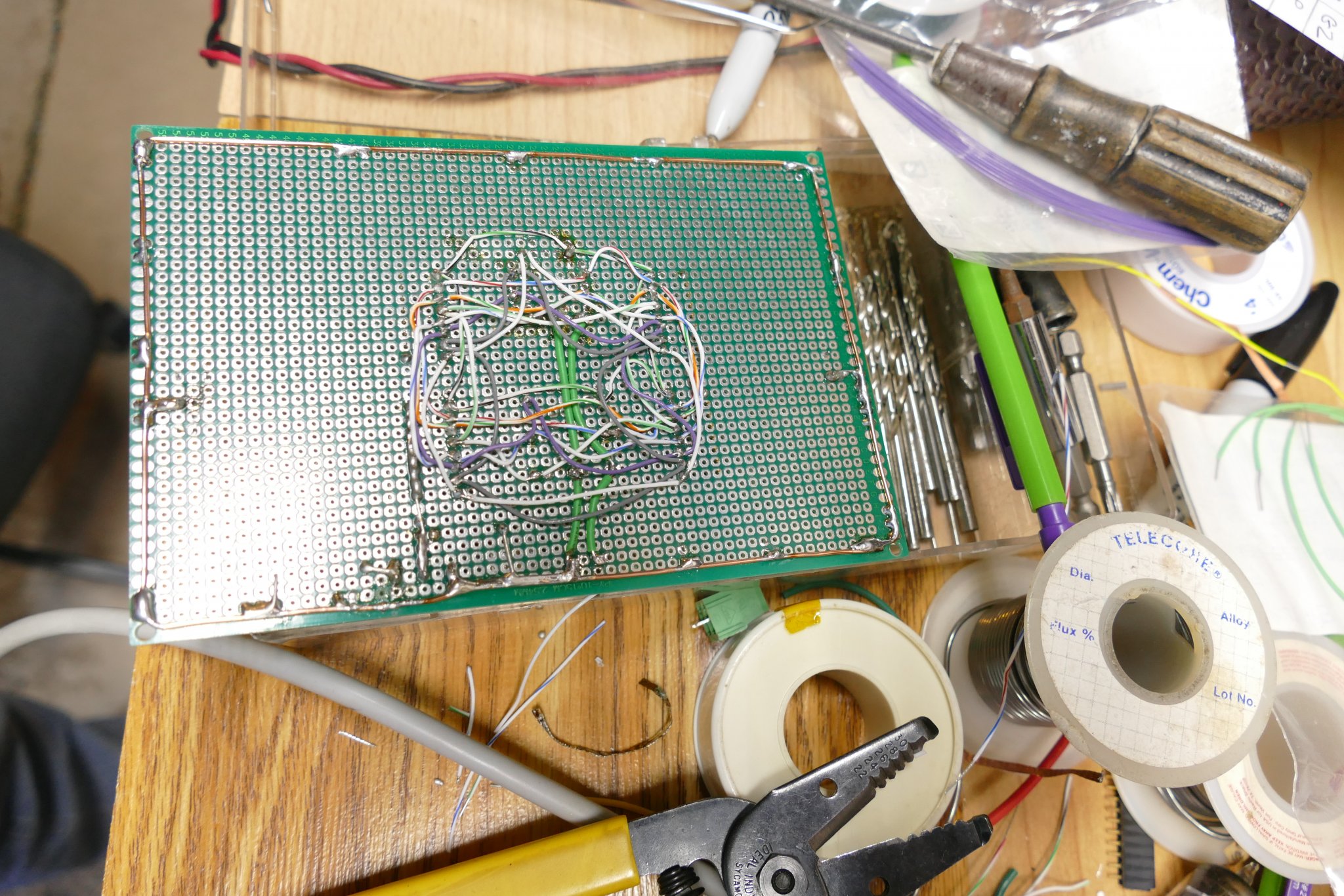

The next two pictures shows the beginning of a test board to evaluate lots of possible driver tubes. I did something similar about 20 years ago to find the 5842 that's used in the TSE and TSE-II.
