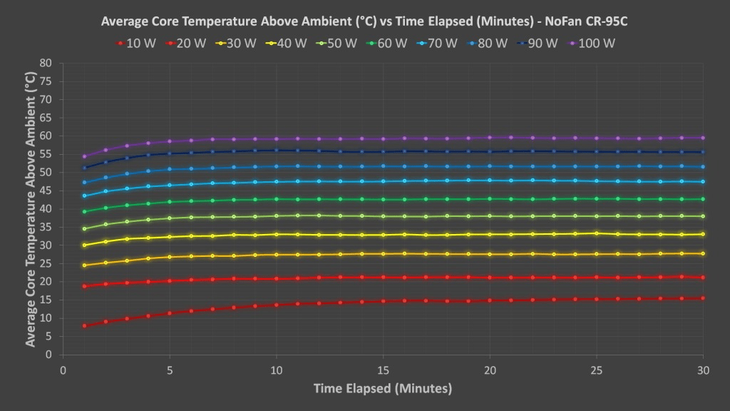

Could this be a solution on top of the amp? http://nofancomputer.comYou can squeeze over 35 watts from this amp if you can figure out how to adequately get the heat out of the mosfets.
It is designed for CPUs dissipating up to 100 W, and it is not bad looking at all on top of the amp instead of the tube (seems a toroid):

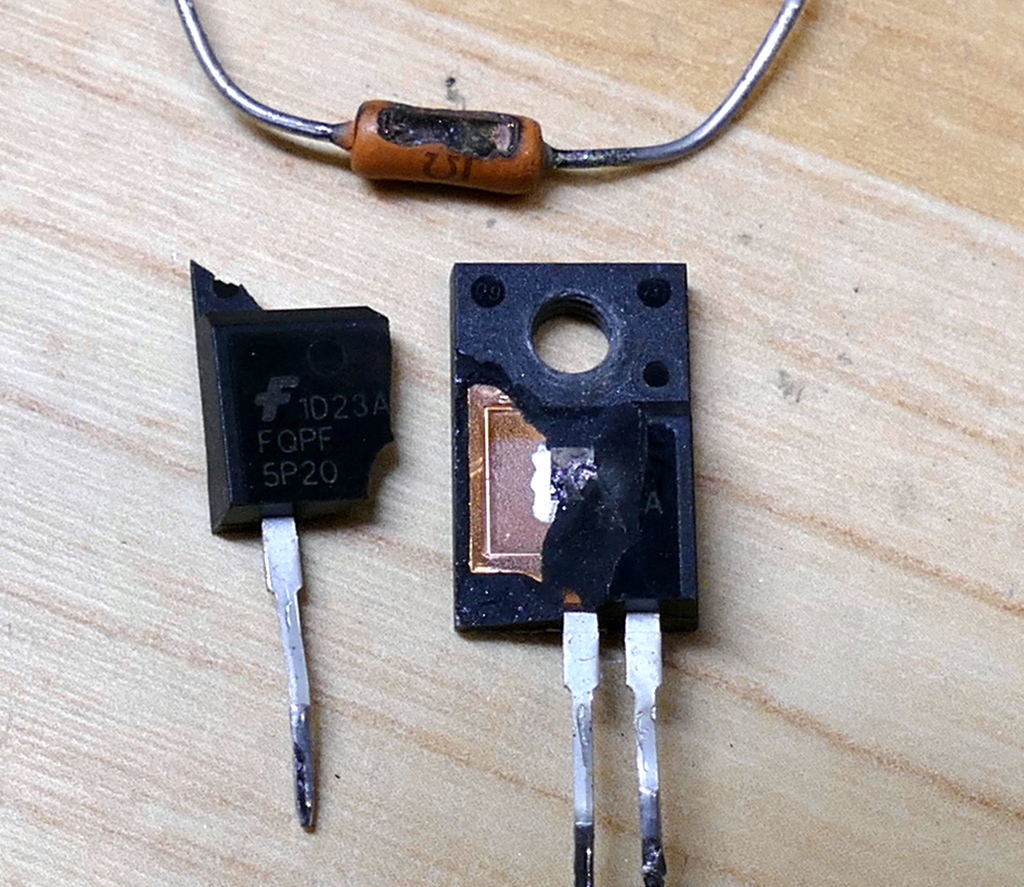

I often fuse things to prevent frying and expensive or irreplaceable OPT in the event of a component failure.
You must observe the ratings of any fuse, and respect them, or at least fully understand the consequences of violating them before doing so.
Let's start with the garden variety 1/4 inch glass enclosed fuse that's about an inch long. They are often rated for 125 or even 250 volts AC, but only 25 or 32 volts DC. Why? What happens if I put one of these in the plate or B+ lead of an OPT and a tube arcs?
A simple fuse will contain a sacrificial piece of metal that will melt into an open quickly. Any arc that tries to start will die out during the next zero crossing of the AC supply if the ratings of the fuse are respected. There is no zero crossing of a DC source so the arc can continue to grow. If the DC supply can generate sufficient current the arc will grow large enough and fast enough to ionize the metal / air vapor that was generated by blowing the metal link in the fuse. This will generate a HUGE amount of pressure inside the fuse either blowing one of the end caps off or causing the whole fuse to explode. I had a few fuses violently explode on me before I found out about this failure mechanism.
If you choose to fuse a tube amp always place the fuse in the cathode circuit and size the bypass capacitor large enough to withstand the voltage required to fully cutoff the tube assuming that the full B+ voltage is on the plate. I have used the little green fuses on vacuum tube UNSET boards and have seen one fuse blow saving the tube and all other components when an FQP9P25 failed to a short in the cathode circuit due to a stupid mistake while attempting to draw composite curves with power supplies.
My FETSET breadboard had a 1 amp fuse in series with the drain lead of the P-fet, and I was running it on a current limited bench type power supply when a screwdriver slip caused two fets to fail to a short without blowing the fuse.
Silicon fails faster than a fuse can blow most of the time, so fusing a FETSET may be futile, but probably still a good idea if a non limited power supply is used. Understand that fuses can fail violently when they blow, but so can a plastic cased mosfet if the power supply has sufficient stored energy. Any fuse not rated for high voltage DC should not be used in the B+ circuit of a tube amp due to the risk of explosion. Tiny glass or ceramic shards flying at high velocity can take out an eye very easily.

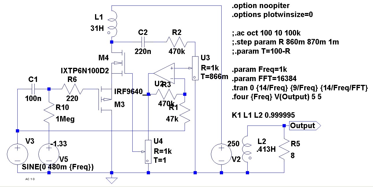

Hi George,
I would like you to comment this evolution of your circuit: this afternoon I was walking in the snow and I had this idea.
So I took a piece of paper and sketched it. Now I just modded the previous schematic to get the idea run, and it does.
Basically it is now a single stage gain, because the nmos works with the highest possible gain.
The pmos has the purpose to deive the cathode of the nmos, and can be even smaller, because it gets few volts across drain-source.
The gate of the nmos is referenced to ground.
The purpose of U3 is to set a voltage divider from the output of the nmos equal to the input of the stage, so that you cancel the signal and only get the distortion at the output of the opamp U2. Then we amplify this error through the opamp and apply the feedback to the gate of the nmos.
U4 is used to set the Zout and the distortion of the stage by applying more or less feedback tot he gate of the nmos.
I want to have it as an external control like the volume, to adapt the amp to the speakers and the volume we listen at.
This way there's no need to have too much gain to drive the output stage, and you set the feedback by the gain of the opamp, without any loss of sensitivity of the stage.
Thank you in advance George!

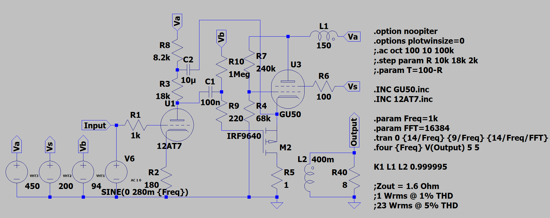

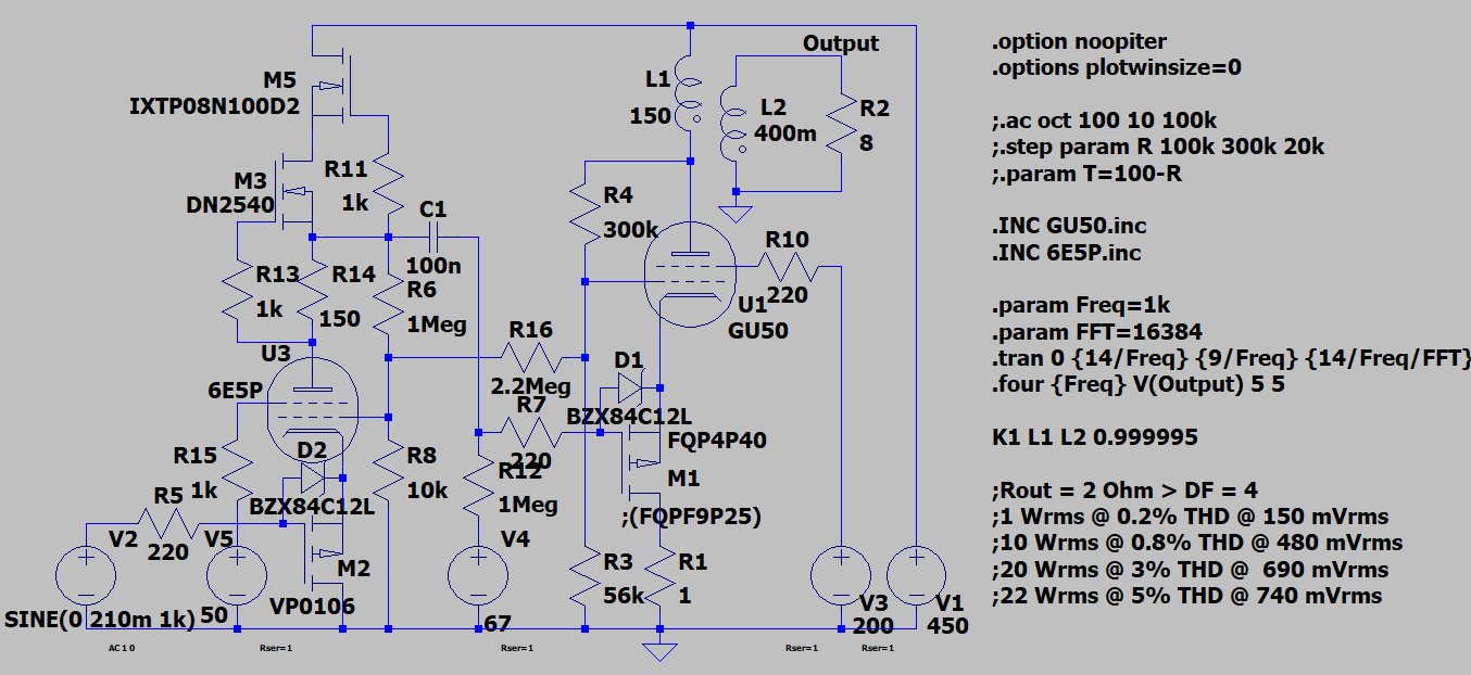

Back on tube world, this is my take with the 12AT7 as driver and GU50 as output tube:
Having the pmosfet on the bottom of the GU50, I've used it to bootstrap R3 so that it becomes like a CCS for the driver.
It is more sandophobic-friendly having a bootstrapped CCS load instead of the depletion mosfet and it solves the actual issue of components shortage.

Yes, the sim shows 34.something watts at the onset of clipping but it takes 1.05 volts peak (2.1 V peak to peak) to get there. My DVD player would not be able to drive this amp to clipping without another gain stage. There is a segment of users out there that will attempt to drive a nice HiFi amp with an iPhone or other similar device. My testing reveals that I need a LY Spice sim that can hit clipping with 0.6 to 0.7 volts for my iPhone to be able to make it clip on at least half of the songs stored in it in my testing. My cheapie Motorola Android phone seems to have a bit more output, but not much more.
The last amp I had running on the bench used a two stage SCG design to generate lots of voltage gain. It is follower by a large source follower for current gain. It was running on the bench successfully when a slip of the screwdriver turned some of the fets into charcoal. All has been torn down, and today's news may spell the end of my testing for a long time.
That thing looks amazing!
Does this explain the non-existence of a working LTSpice model of the 6JC6?[...] I tried some of the other TV IF amp tubes like the 6JC6, 6JD6, and 6EJ7 to find similar issues, though not as bad as the 6KT6. [...]
By the way, I would love to see a board made for that combo of tubes.

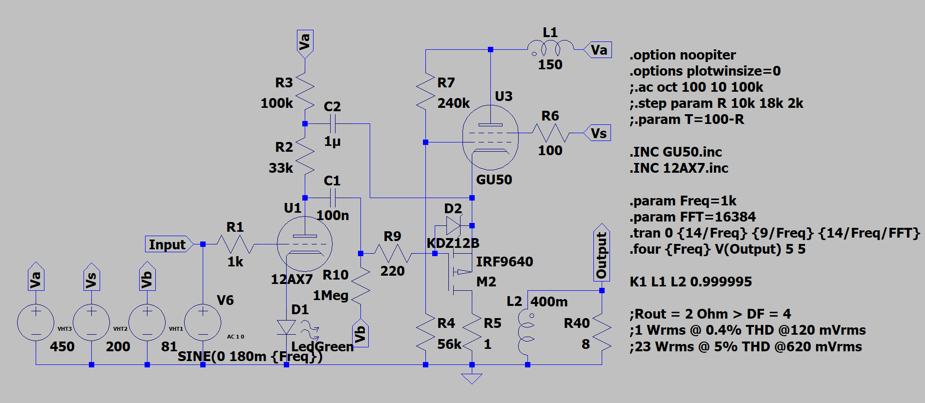

I was playing with a boostrapped concertina and I have to say it sounds quite well, so I came out with this solution where the load of the 12AX7 is bootstrapped by the pmos.
There are almost 1.5 mA through the 12AX7, and 27 pF of Crss of the pmos at 30 kHz need 158 uA @ 1 Wrms and 824 uA @ 23 Wrms.
The sensitivity of the amp is fine and there's plenty of power.

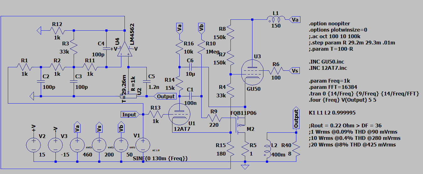

I was thinking about the advantages of sharing the PSU node with output transformer and driver, by splitting the driver plate load and taking the feedback from the split point: there will be an optimum where we can cancel PSU hum by injecting part of it through the anode-to-grid feedback of the driver.

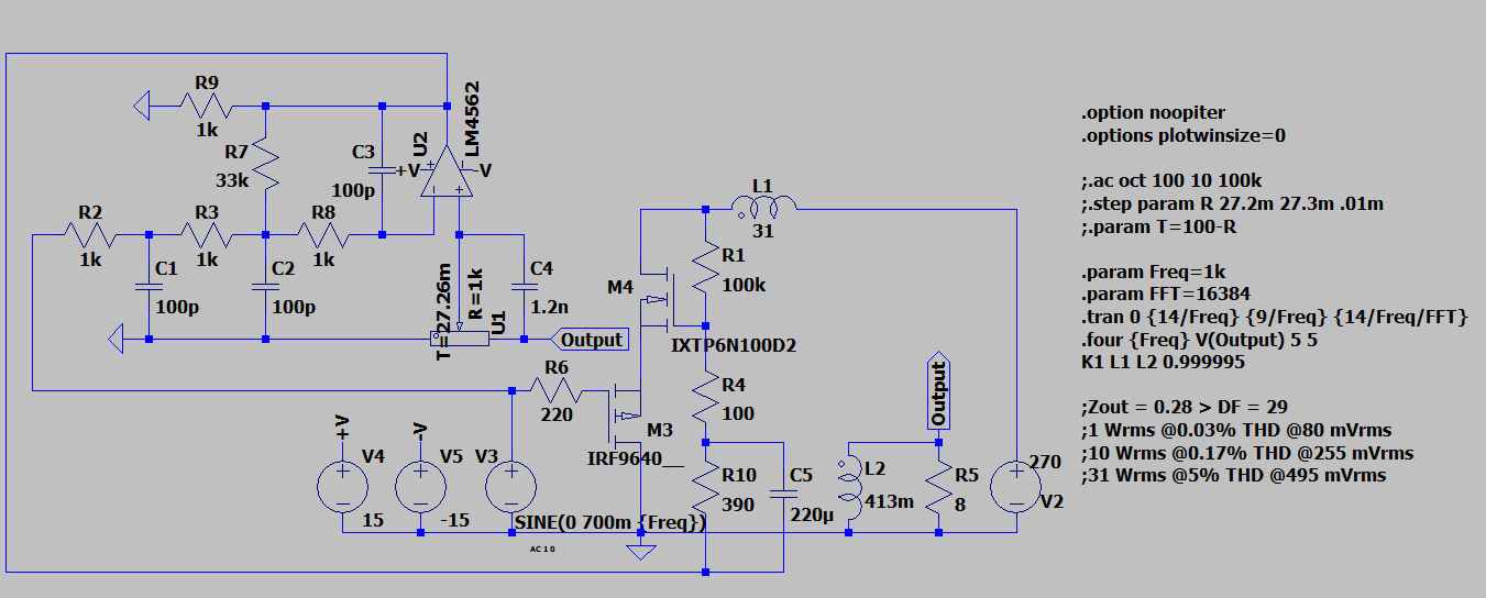

I propose you this single gain stage FETSET amp, it simulates very well:
It is inspired by my last iteration of the UNSET (waiting parts from Mouser):

I have decided that my next HiFi amp build will be a two stage FETSET amp based on the working prototype seen in post #911 of the SCG thread in the Pass Labs forum. It just sounded too good not to build one. I have always wanted to revisit the class H SET that I built for a magazine contest back in 2007. I had a modified two stage SCG proto board running, but blew it up with a screwdriver slip.
