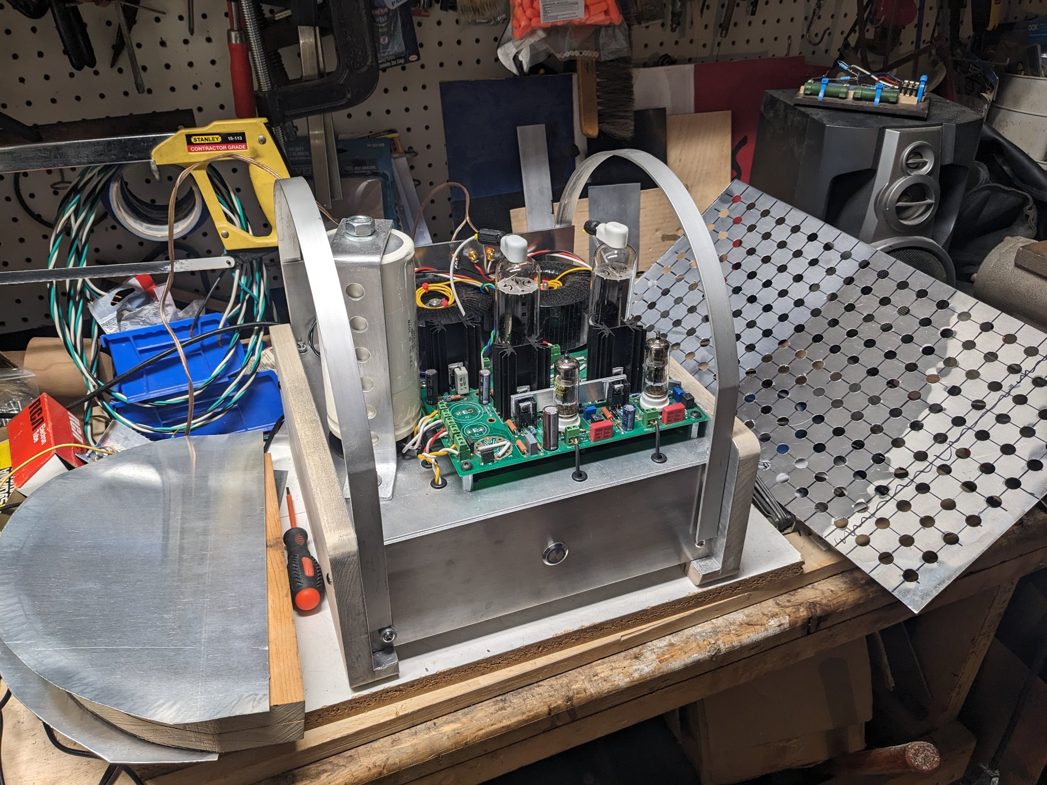

The film cap is comically large isn't it. I thought about hiding it under the top plate instead of the choke but putting it up there made the wires the shortest and why not make it the star. Celebrate it's absurdity. Plus it measured and sounded the best out of every cap combo I tried.

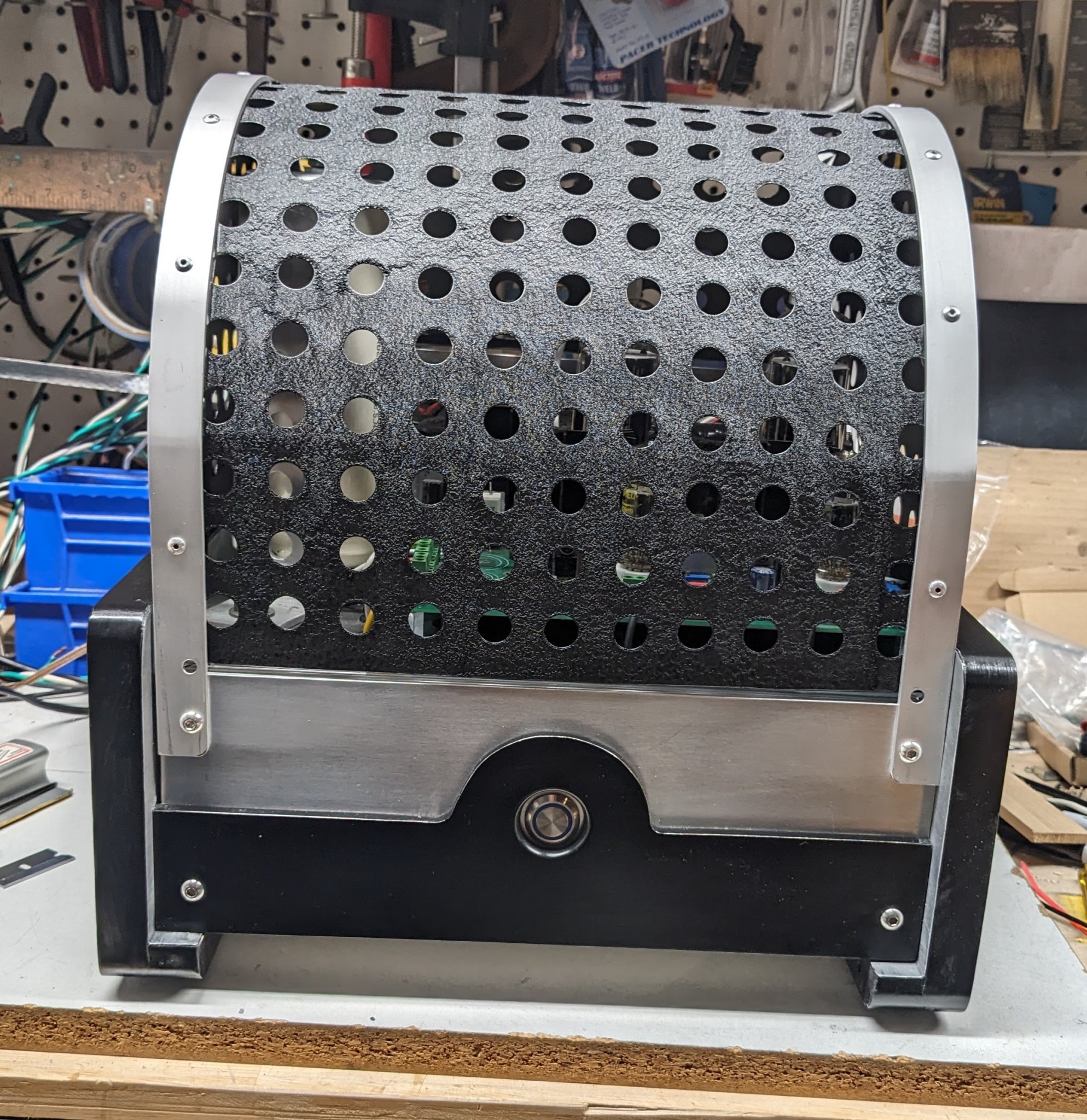

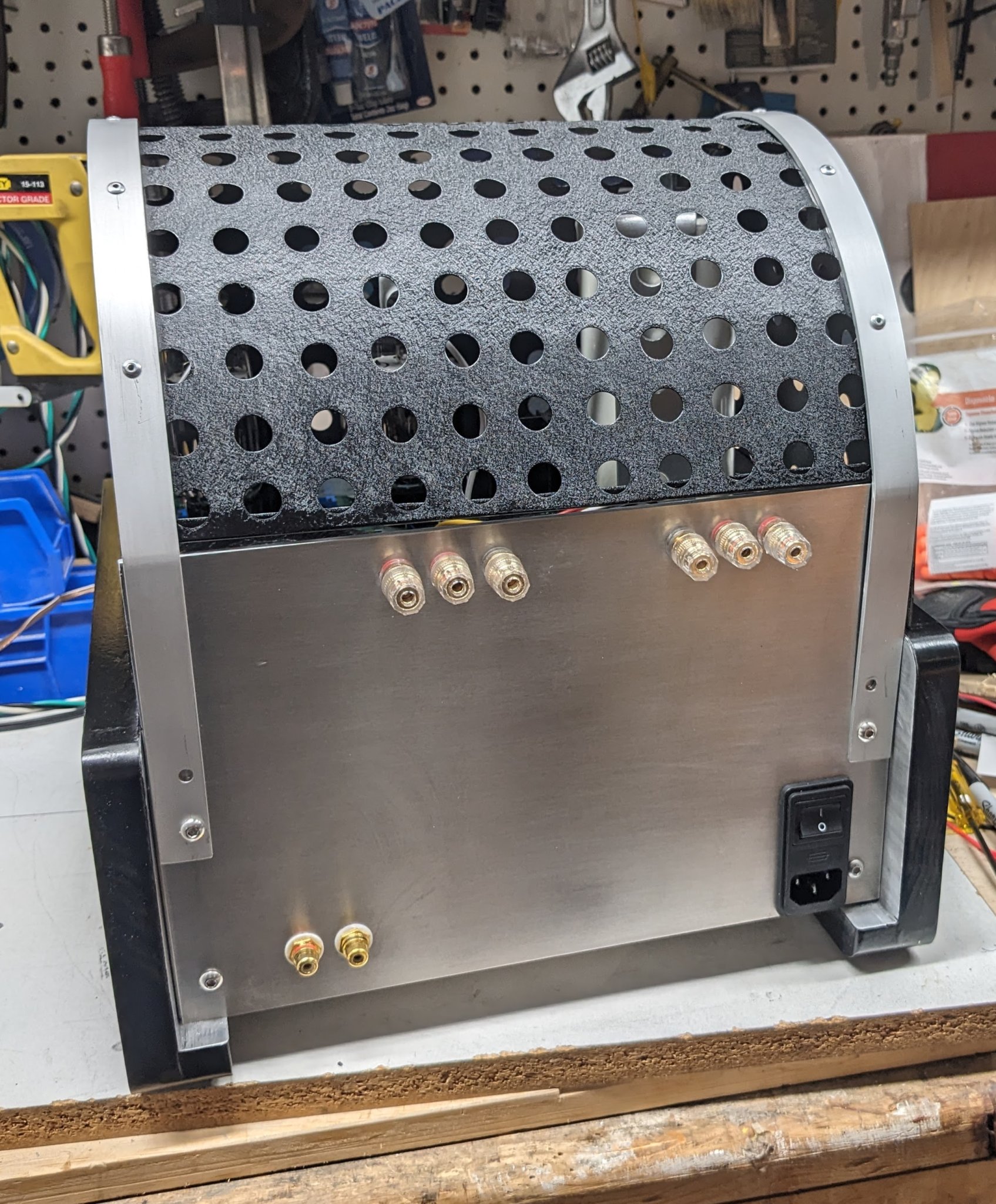

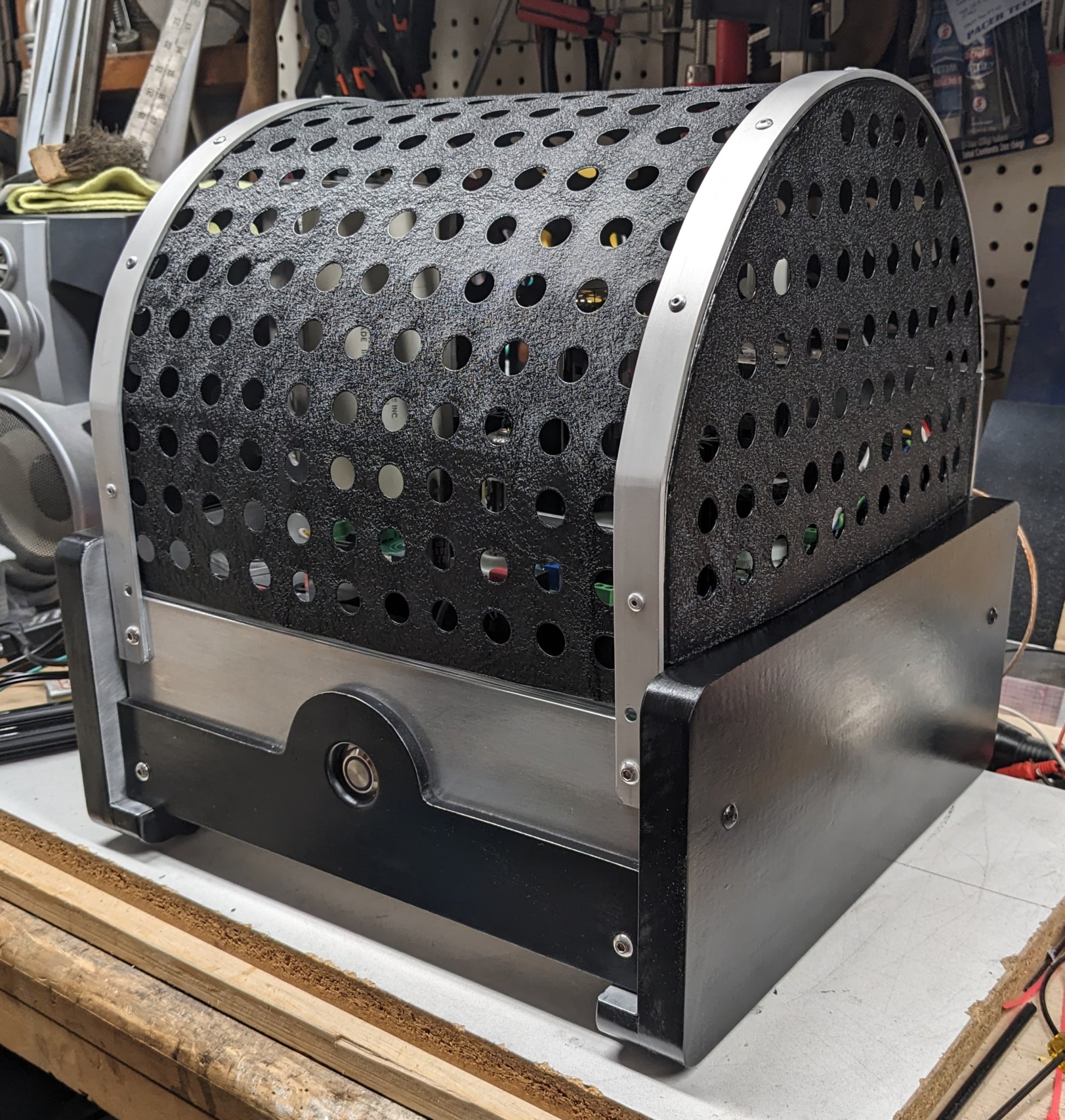

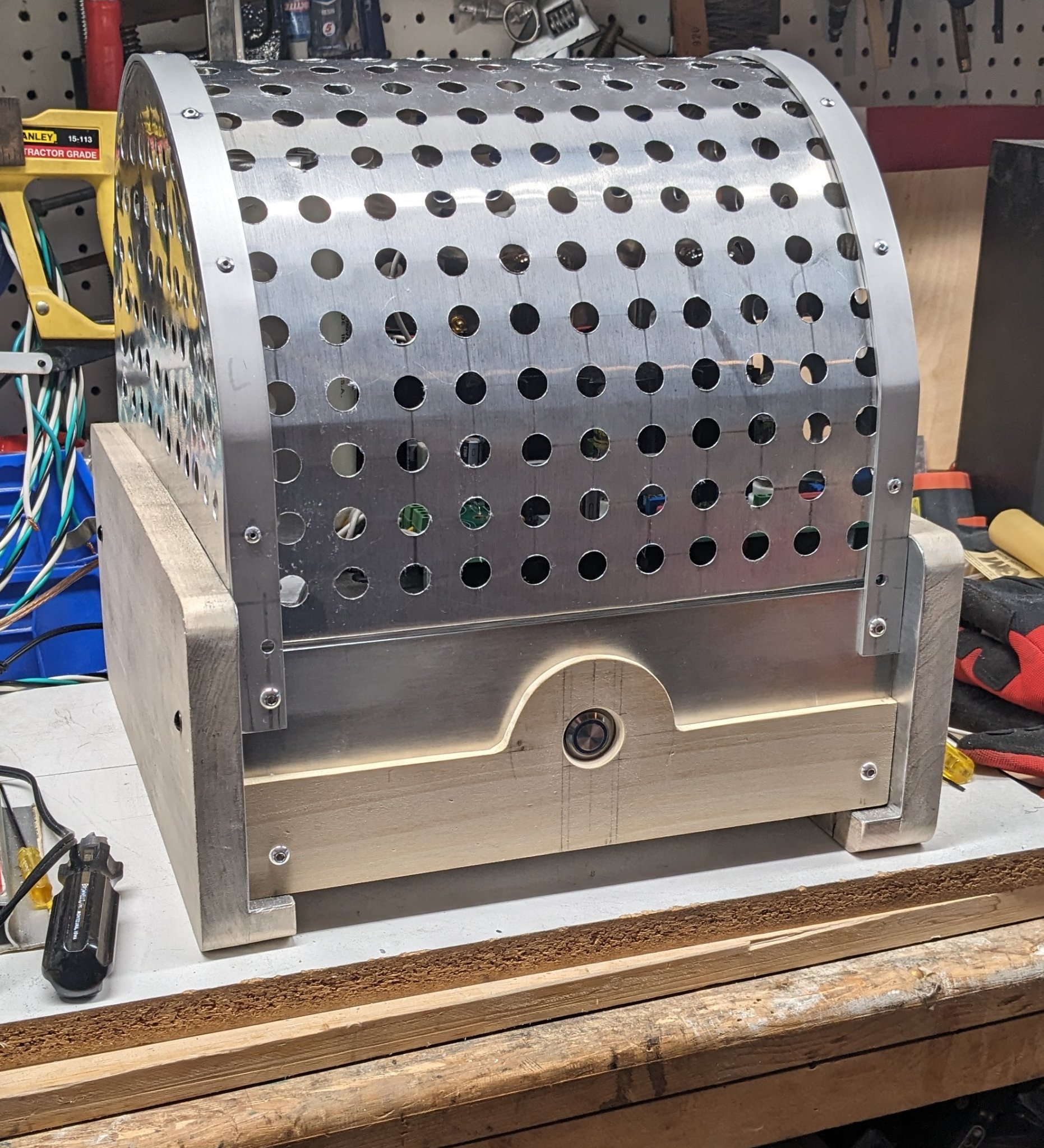

Some small progress on the chassis. Hopefully the pic shows where I am going with the cage. The drilled out panel will attach between the ribs that curve over the top. Side panels are cut out and anealed so I can bend over the sides using a hammer form. I will drill those out as well. Hoping to get this finished up for the new year.
