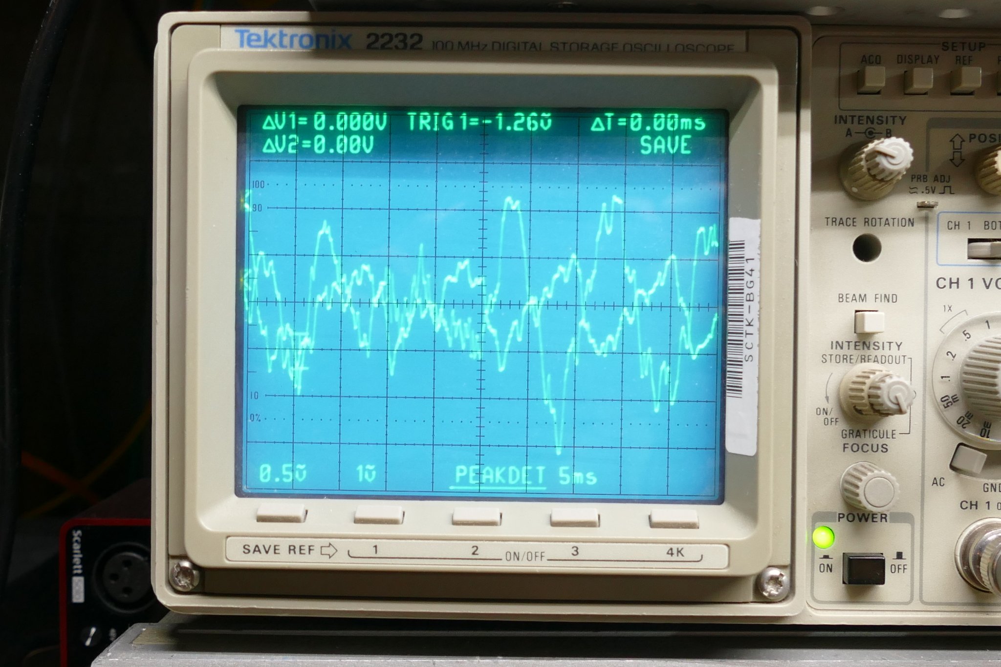

That turned out to be last night. The 6AV'5's already met the Edcors twice, many years ago and a few days ago. Tonight, the pair got to hook up with some other old friends, my Yanaha NS-10M Studio Monitors. Now I remember why I kept the old Edcors when I gave almost 500 pounds of transformers to a metal scrapper because I had two weeks to empty a house that I had lived in for 37 years and get out of Florida. After playing some musical selections from about 20 CD's ranging from guitar and a singer to full metal racket, I realized that this combo just sounds good even when it is pushed to the point where clipping is visible on the scope. The scope is connected across the speakers with both channels overlaid on top of each other. I simply kept hitting the save button randomly as the music played. The volume knob was left at full except for a few loudly mastered CD's where there was obvious distortion at full volume. For these I turned it down until there was visible but not audible distortion present. Loud bass notes didn't clip hard, but were gently rounded making them sound "fatter" as opposed to distorted. Picture 761 shows a bass guitar note at about 90 Hz. The initial transient got rounded, but not severely clipped. This is almost 30 volts peak to peak.

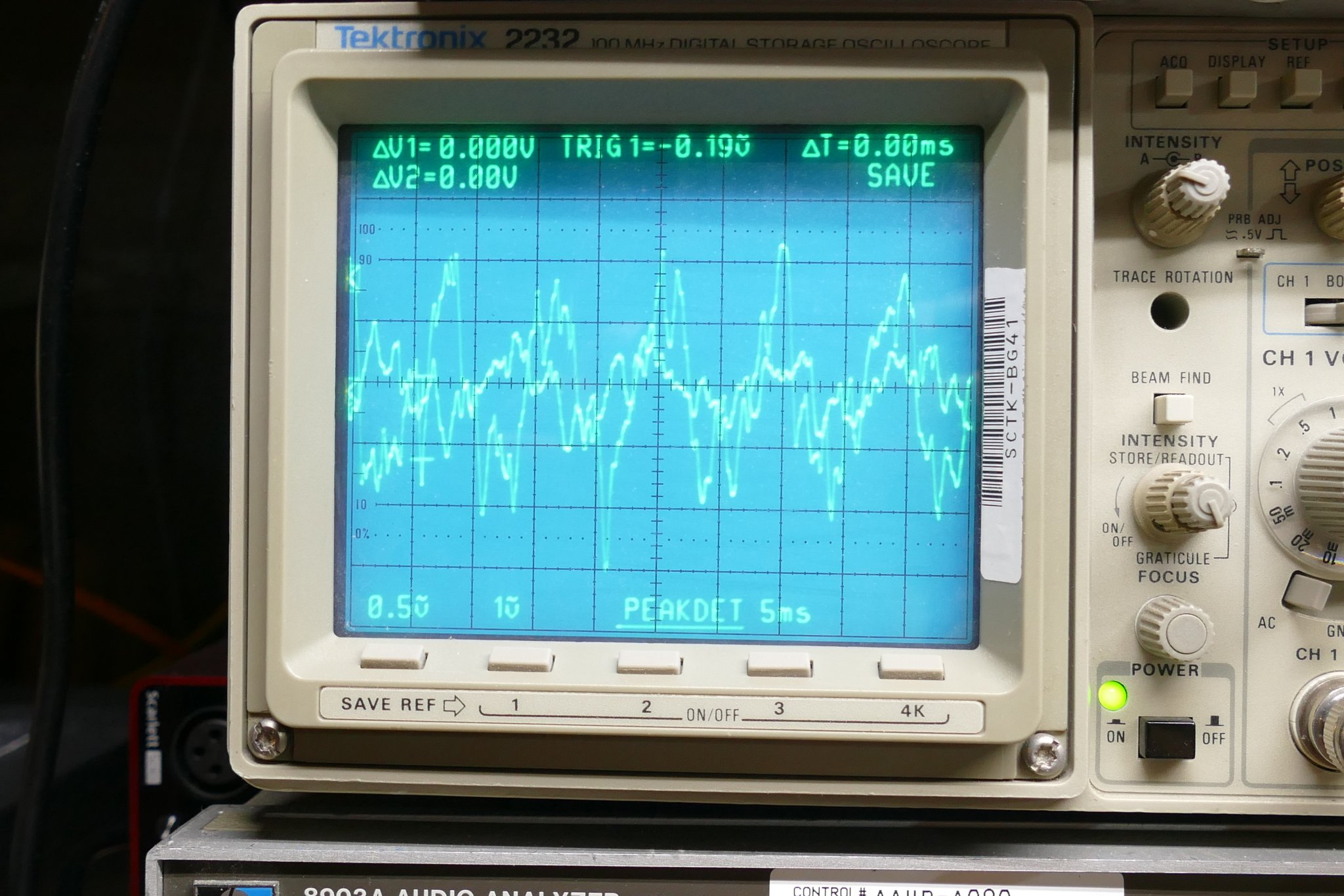

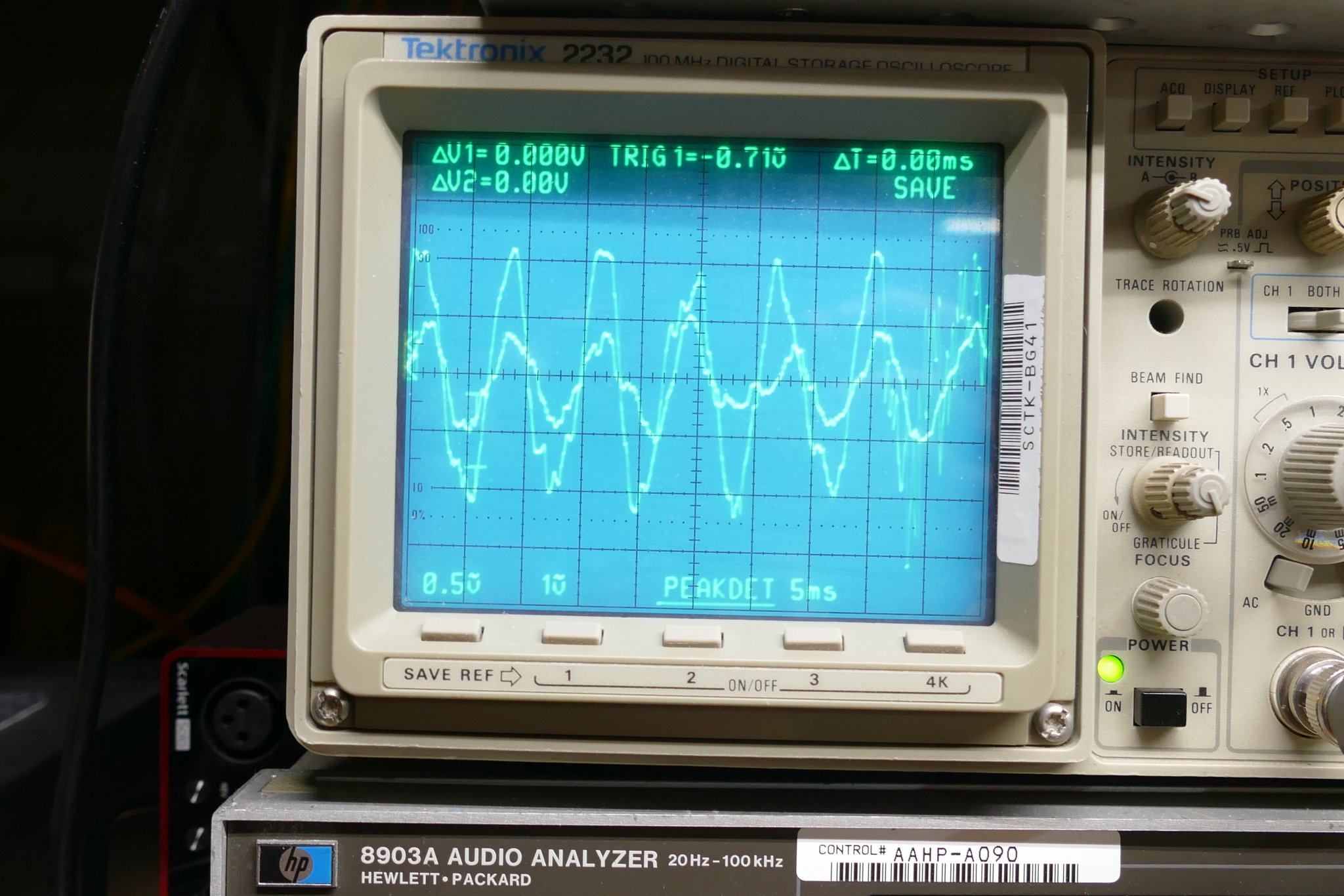

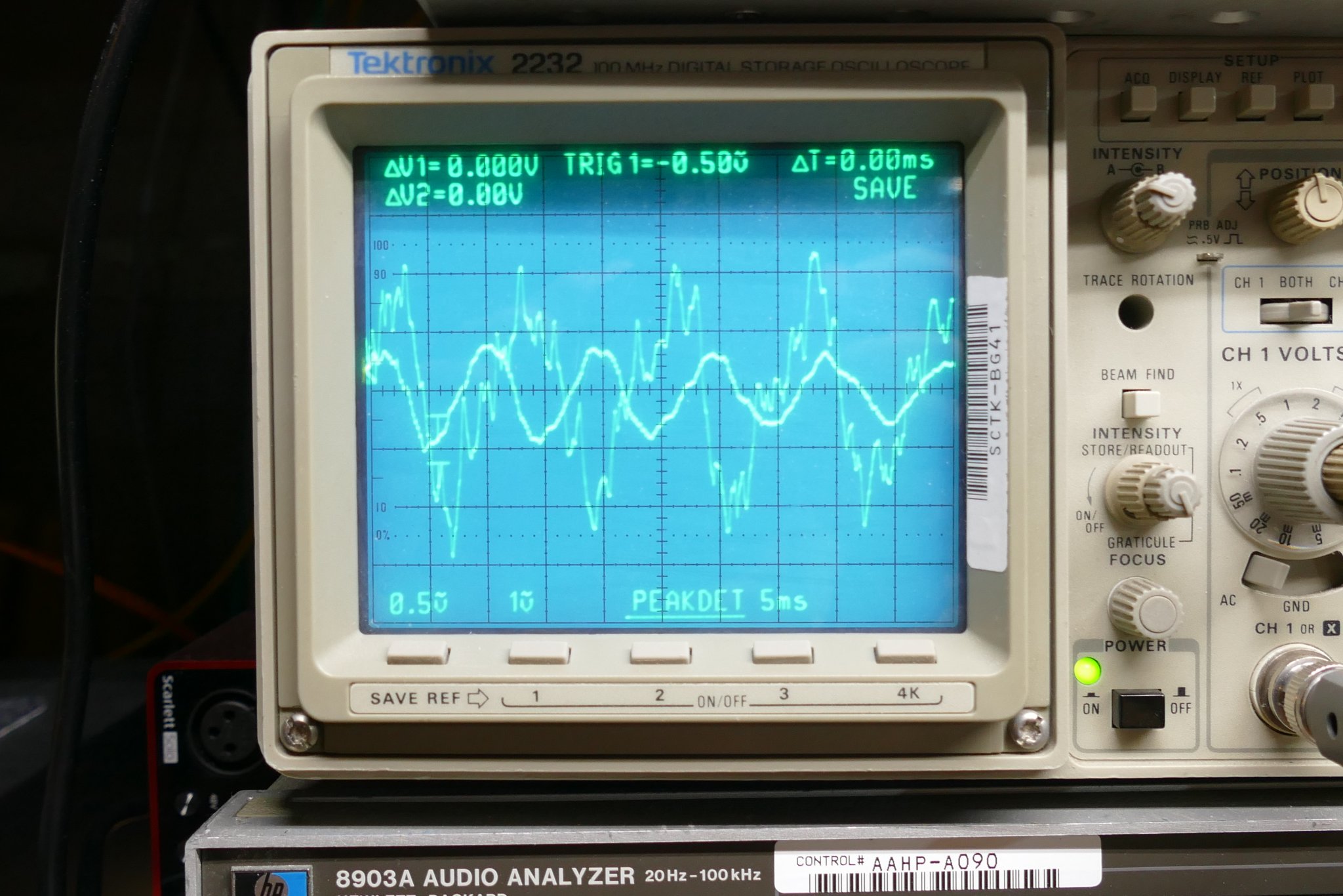

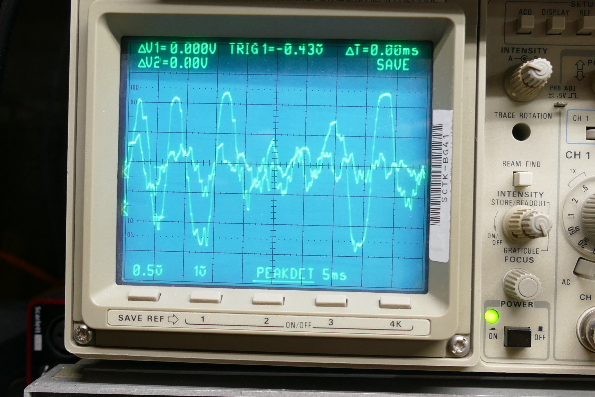

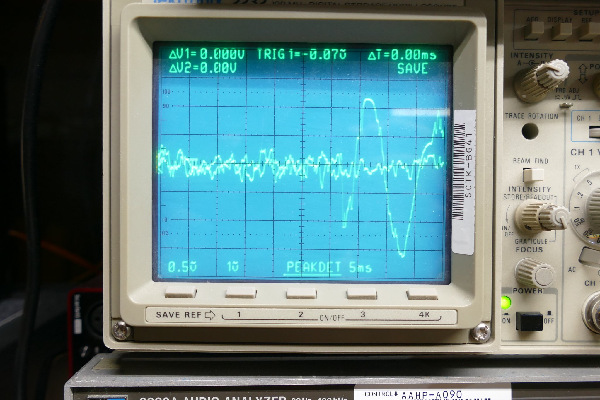

Picture #0761 shows a bass guitar hit a note of about 100 Hz, where the speakers are about 12 ohms. This light load is the reason the amp had no problem putting 28 volts peak to peak across the speaker with a slight clip on the positive peak. This is about 10 watts from an amp that can't make that much power into an 8 ohm resistor. I grabbed a few other random scope pictures of some instances where the signal is clearly clipped, but not audible, or barely audible. None of it was due to serious bass, but my speakers are over 16 ohms from 70 to 100 Hz and peak at over 20 ohms. Most of the peaks with their heads chopped off are drum hits, floor tom, tom tom or snare. Chopping their heads off is not always obvious especially if it coincides with heavy bass or guitar. There are also several instances of 25 volt peak to peak waves that are not clipped! I imagine that the results will be different with a different set of speakers.
Nice! Still running at 300V 65mA or have you pushed the tubes harder since the initial tests?

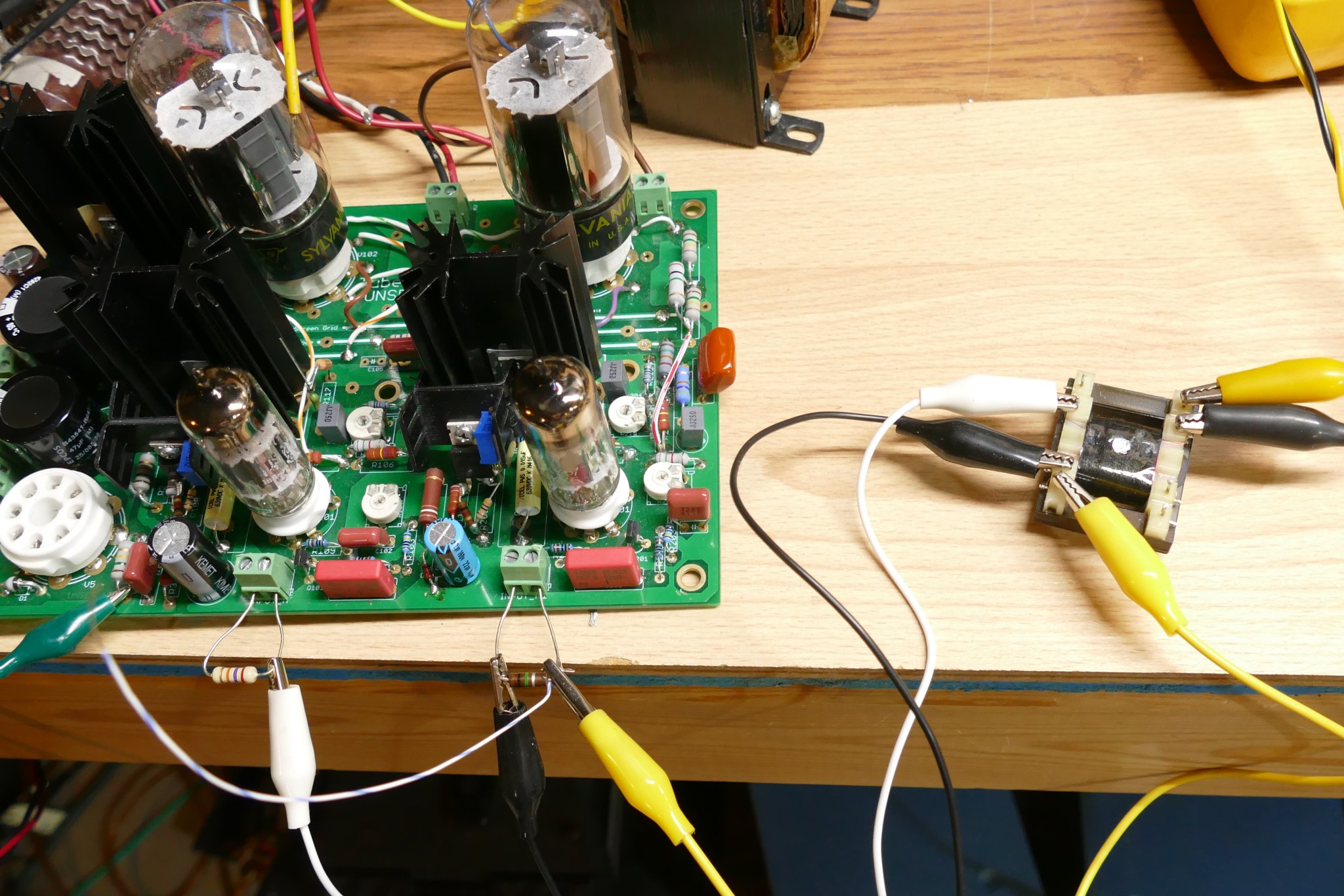

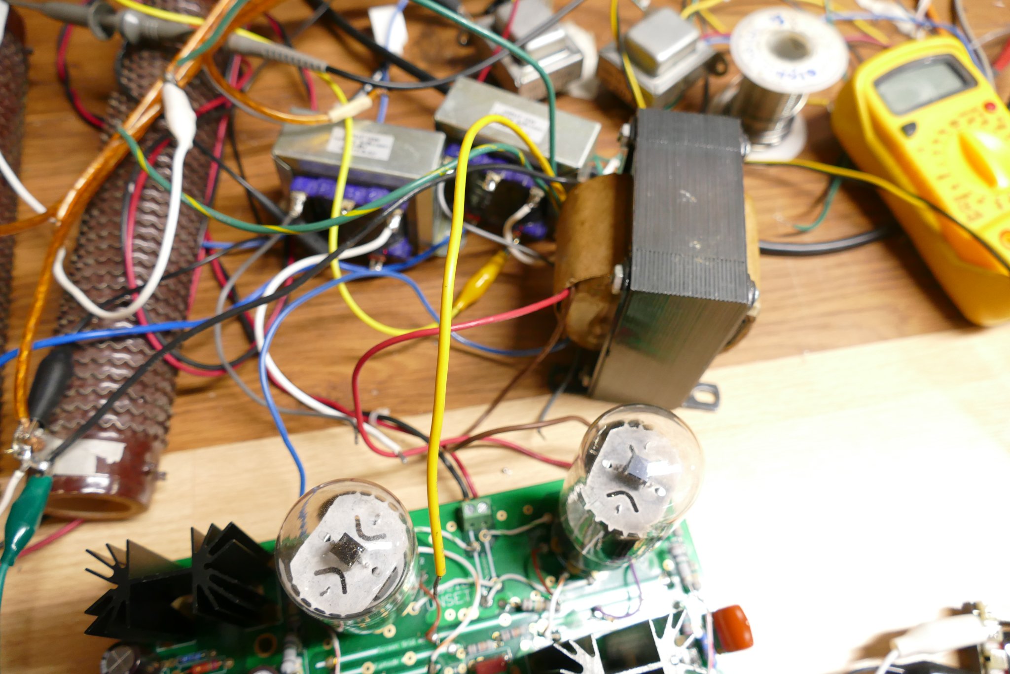

I grabbed a little Edcor transformer and used it for a phase inverter between the audio generator and the test board. I disconnected the little SE OPT's and wired a P-P OPT across both channels. I then proceeded to find max power. With a 6600 ohm load (the rating for the OPT) I could hit 40 clean watts on 400 volts with the current meter around 300 mA. I then put the 8 ohm load on the 3300 ohm tap and turned the power supply up to 450 volts. I saw 56 clean watts and cranked harder to make the analyzer read 68 watts. The current meter was pegged (goes to 300 mA) and the THD was bouncing around between 7 and 9%. Something started to smell hot, so I shut it off before I broke it.

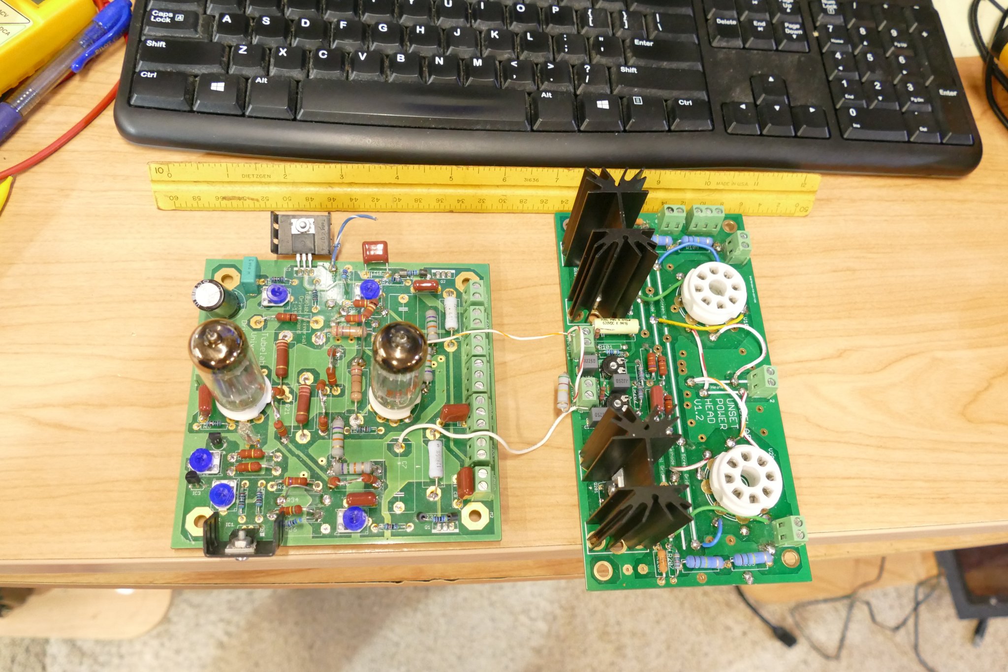

This tells me that my DIY test guitar amp will use an UNSET board for output duties. I prefer a tube without a plate cap and the 6AV5 is the biggest octal that I have, but I have a 12 pin Compactron UNSET board in the works.

The UD board is 5 X 5 inches and the UPH board is 3.75 X 7 inches.
The UD board has an N-ch mosfet driver circuit for directly driving the grid of an output tube. The UPH board has a P-ch mosfet follower to drive the cathode of the output tube directly. Two mosfet followers are redundant so I usually leave the buffer parts off of the UD board and run a pair of wires directly from the LTP plates to the UPH board. These boards were removed from my test setup, so the wires are still in place.

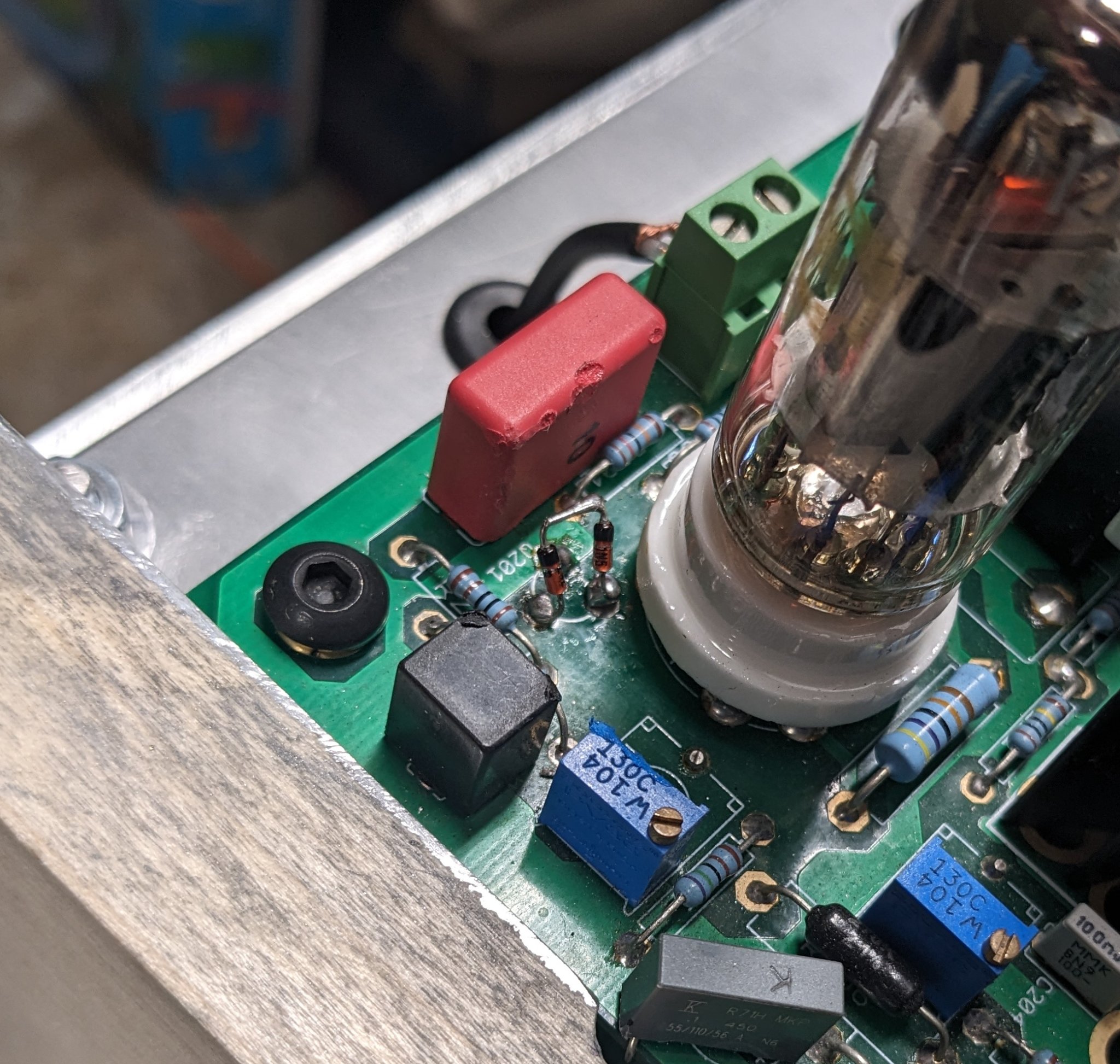

My amp has developed a hiss in the left channel. Kind of sounds like when you put your ear up to a seashell. It does not change with volume. I tried swapping tubes, speakers, inputs, and grounding the inputs but it remains. Any ideas what to try next?
A hiss can be caused by several things including a bad solder joint, an oxidized connector or a defective component. To determine if it's in the first or second stage, remove the driver tube and power the amp up. If the hiss is gone the driver / input stage is likely at fault.
Many years ago the first place to look would have been a tube or germanium transistor followed by a resistor. Silicon devices including a mosfet can cause hiss, but it is not as common as with germanium. Resistors are now the first place to look.
The best diagnostic tool for noisy device hunting used to be a spray can full of "freeze spray" or "circuit cool." This stuff instantly freezes a single part. If the hiss changes considerably in volume level or pitch when a component is frozen, change that part. A quick Google search reveals that this stuff, or something similar is still available. I know that the original freon based product vanished from the market in the mid 70's when people were abusing it by "huffing." If you try this, practice on some junk board as it used to take a very light touch on the spray nozzle to freeze one part at a time. I have not used this stuff since the 1970's. Never point the spray directly at a hot tube, it will shatter.
https://www.amazon.com/Tech-Spray-1.../B00012WIMK/ref=sr_1_1?crid=3HJ77VDTAKROI&dib
Thanks for the tips. Local electronics store had a can of the freeze spray. I first narrowed it down to the first stage then used the freeze spray and found it was Q101 the VP0106 FET that always seems to give me problems. I should have just guessed. I can't say how many of these I have changed out now. New one in and it is quiet again. Back to working on a case for the UNSET so I can get this one off my bench and into the house.

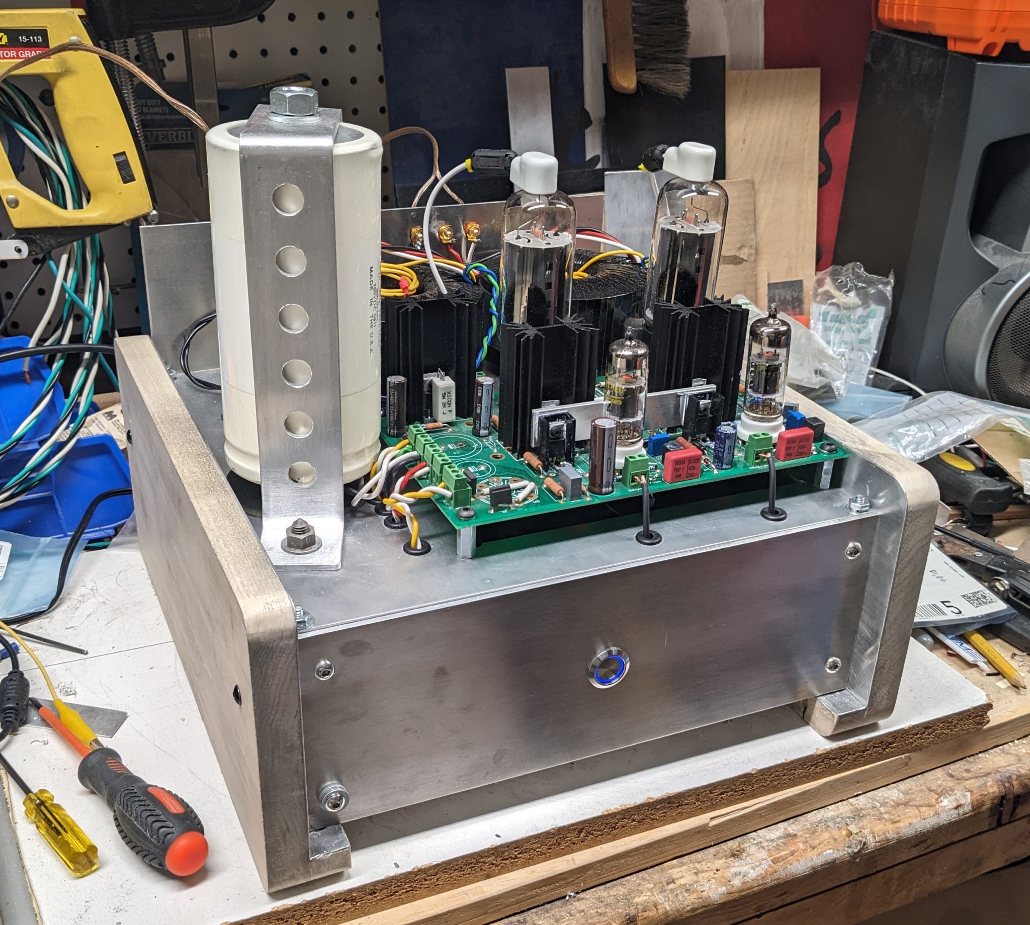

Not much to see with the case, just a plain box so far. Under the top plate is the power toroid, choke, and SMPS heater supplies. Next is to make a top cage then cleanup and paint and some little details to try and make it look finished.
