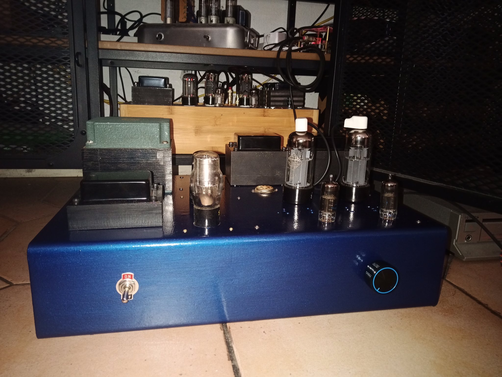

Getting unSET #2 ready with its older brother in the background.
Fired up and making music.
No rectifier tube, nor the FET g2 supply. Instead a tube voltage reg for the output screens.
The old Tek power tranny delivers a healthy 660V to the output plates, 360V goes to the 12HG7a's and g2 reg.
At the moment running with E130L and planning to try 6CD6GA, 8068 and 12E1. There are sockets wired up for EL509 as well.
It's too big to put in the rack and with the topcaps I want it behind a door or a cage. But that's a problem for later: first I need to clean up my workbench to do some measurements and figure out what is the best setup for this amp.

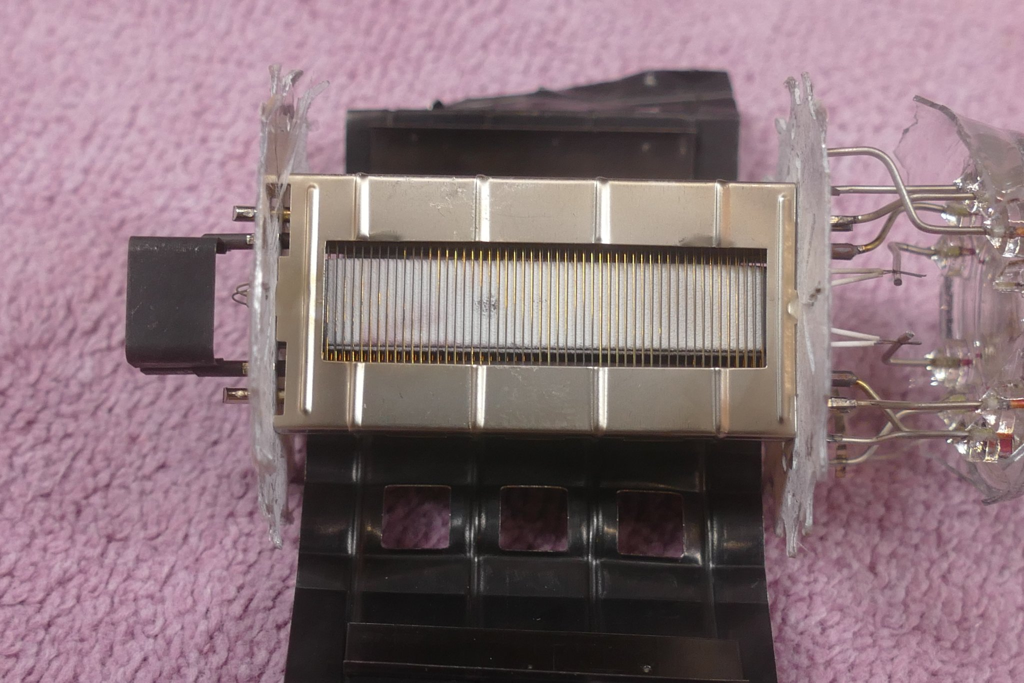

Every tube from a simple voltage amp triode to a monster transmitting tube should have a maximum plate dissipation spec. No vacuum is perfect, and none of the materials used in the manufacture of a vacuum tube are completely pure. As the operating temperature of any tube is raised, several things begin to happen. The concern with typical audio, radio, and TV tubes, often called receiving tubes, is the release of some of these impurities into the vacuum, and creating a path for stray current flow due to ionization. The ionized cloud tends to gather around the cathode causing unwanted grid current to flow, which upsets the bias leading to higher current through the tube, raising the heat and making matters worse. Eventually this will lead to a red plate runaway in a tube carrying enough current to "feed the fire." This effect is why all output tubes, and many other tubes have a maximum grid circuit resistance spec. If you are going to run a tube hard, keep that grid circuit resistance to a minimum.
All tubes will have a maximum current carrying capability associated with their cathodes. In most small tubes it is not given as the plate dissipation rating will usually be violated before the cathode current spec. Attempting to draw more current from the cathode than it can support WILL cause a cathode to plate tube arc. It can vary in intensity from a small piece of the cathode coating being destroyed, to a tube shattering explosion. I pushed some old 6L6GA tubes to the point of no return just to see what would happen. Somewhere around 110 watts of audio output from a pair of tubes into a 3300 ohm load on 500 volts the 1 ohm 2 watt cathode resistor exploded. This indicates a cathode current of well over 2 amps. The tubes survived, so I tried it again and a different cathode resistor exploded. Again, the tubes were not harmed.
In a completely different experiment I had a 6HJ5 tube shatter due to a tube arc. Autopsy revealed a tube arc took off some of the coating. A second attempt with a different tube resulted in glass all over the room and the grid drive mosfet blown in half.
