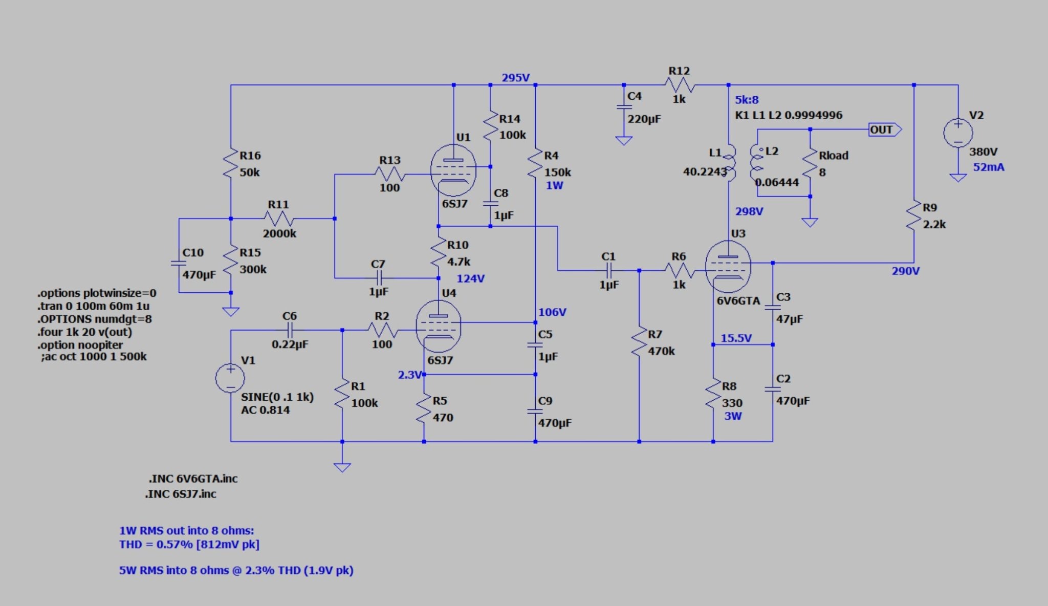

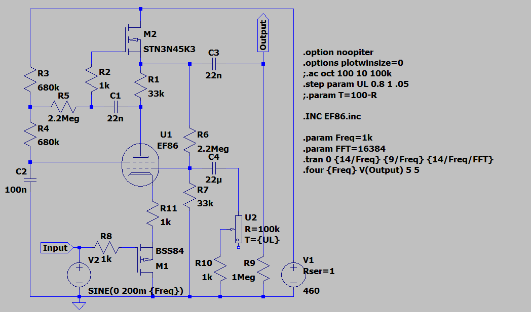

I will give this circuit a try, reducing R5 until it is stable on the whole range of U2.
U2 will be a log pot, R5 will be most probably switchable to have two different loadlines.
Let's see if the voltage drop on plate voltage due to the current drawn by g2 during peaks will be euphonic.

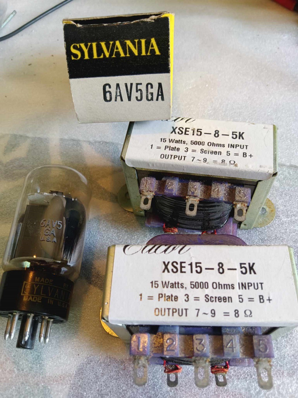

When I saw a pair of the Edcors for sale locally the other day I got a bit nostalgic and couldn't resist buying them. I also still have about a dozen Sylvania 6AV5GAs left on the shelf.

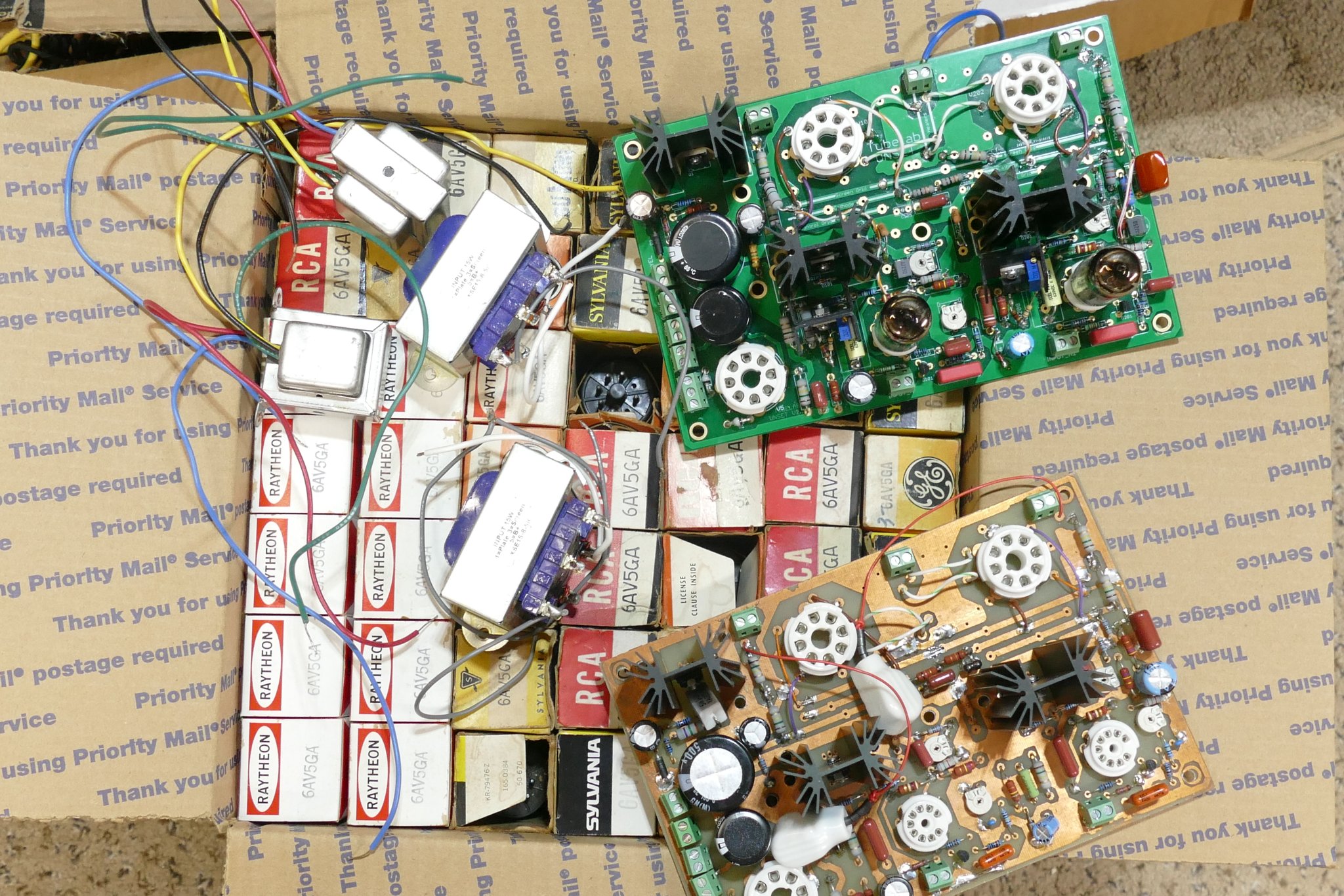

Some digging through boxes has uncovered all of the necessary ingredients for this recipe. One UNSET board is the original prototype, probably untouched since I made a commercial PC board. The other UNSET board has been the subject of several experiments, and is not in original condition. I should have another populated board or two, but I can't find them. In a random stroke of luck I found a box labled "Small Transformers" that had not been opened since I left Florida 10 years ago. It contained the old Edcors, apair of even smaller "Fender Champ OPT replacements" that I had long ago forgotten. A box labeled 6AV5GA contained 45 tubes of various flavors.
I envision two experiments depending on how things go. The first experiment will use one of the UNSET boards configured for the 6AV5GA and possibly for a bigger tube or two for baselines. I have the Edcors, and a few other OPT's to test.
The driver circuit on the UNSET board can't quite make enough gain to drive a big tube like the 6LW6 to clipping from a low output source like an iPhone (yes, people do this). Here I will test a one channel prototype driver circuit that has been shown to be capable of stupid amounts of gain, since my original thinking revolved around a guitar amp. The Octal Unset Output Board will be used for these tests with bench power supplies capable of up to 650 volts.

That’s nice! I’m very curious as a clean yet high-Zout power amp is what I’m working on.
Do you bootstrap splitting the saturator load in two and connecting the middle point to the output tube’s pmosfet source through a capacitor?
I did it with real triodes as drivers and works fine for Hi-Fi.
For guitar amps I’d bootstrap through a voltage divider from the anode of the output tube to the same middle-point of driver’s load.
The driver tube circuit is almost identical to what you drew in post #562 except that the screen grid has its own divider so the voltage on the left end of R5 does not change with tube or G2 current. Most if not all of the component values are different and chosen by the "Guess, try it and see what happens, and if it doesn't work, guess again" method. I have been playing with tube stuff long enough that my guesses are usually close enough for the circuit to work.
Since the plate load, R1 has nearly the same AC voltage on each end, it looks pretty big to the tube.
Interesting! Assuming that the mosfet on top can be replaced with a triode, this circuit could be a way to put 6BL8 and similar triode/pentode compactrons to good use. Their 300mA heater equivalents are cheap and have better heater-cathode insulation.
The apparent load impedance seen by the active tube depends on how accurately the follower copies what's on the plate and puts it on top of the load resistor, and the value of R5 and the divider that feeds it. The Gm of the follower device is the most important spec for accurate "following." In this aspect, a mosfet is hard to beat. I have been gathering parts and doing a few simulations for a guitar amp I will call MetallicAmp, all tube, no glass. Here I will use only metal cased vacuum tubes and other parts that were available before WWII. I have a simulation that uses a pair of 6SJ7 pentodes driving a 6V6. Both of these tubes were made in metal and glass envelope versions as was the 6L6. The Saturator gain is about 800 in this case. That is approaching the level where tube microphonics becomes an issue. Note that this is a simulation only I have not built this yet. I have built several mosfet loaded saturators. and one with UNSET features called the UNSETURATOR breadboard
Is it important for the stability of the unset even in “guitar-mode”?

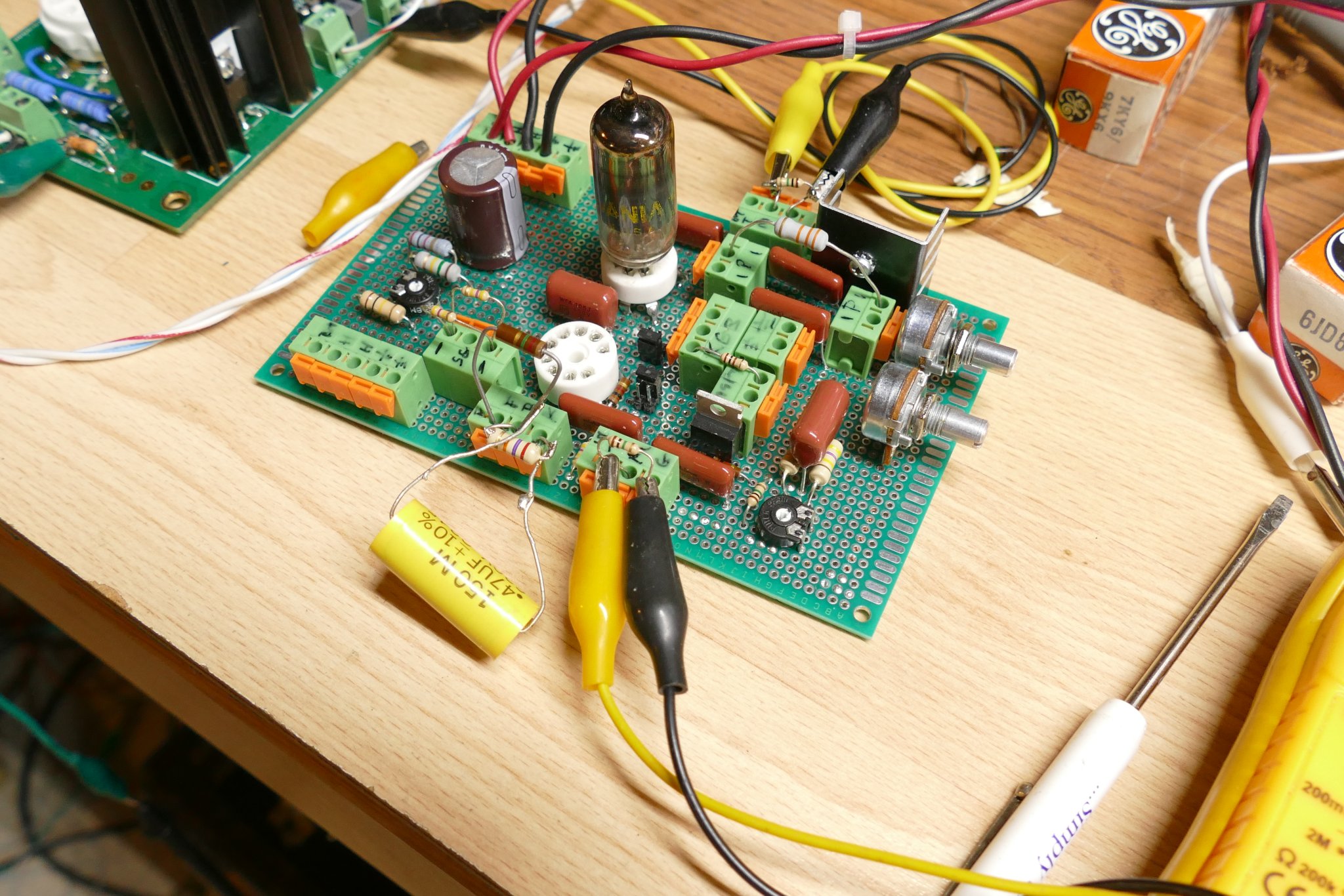

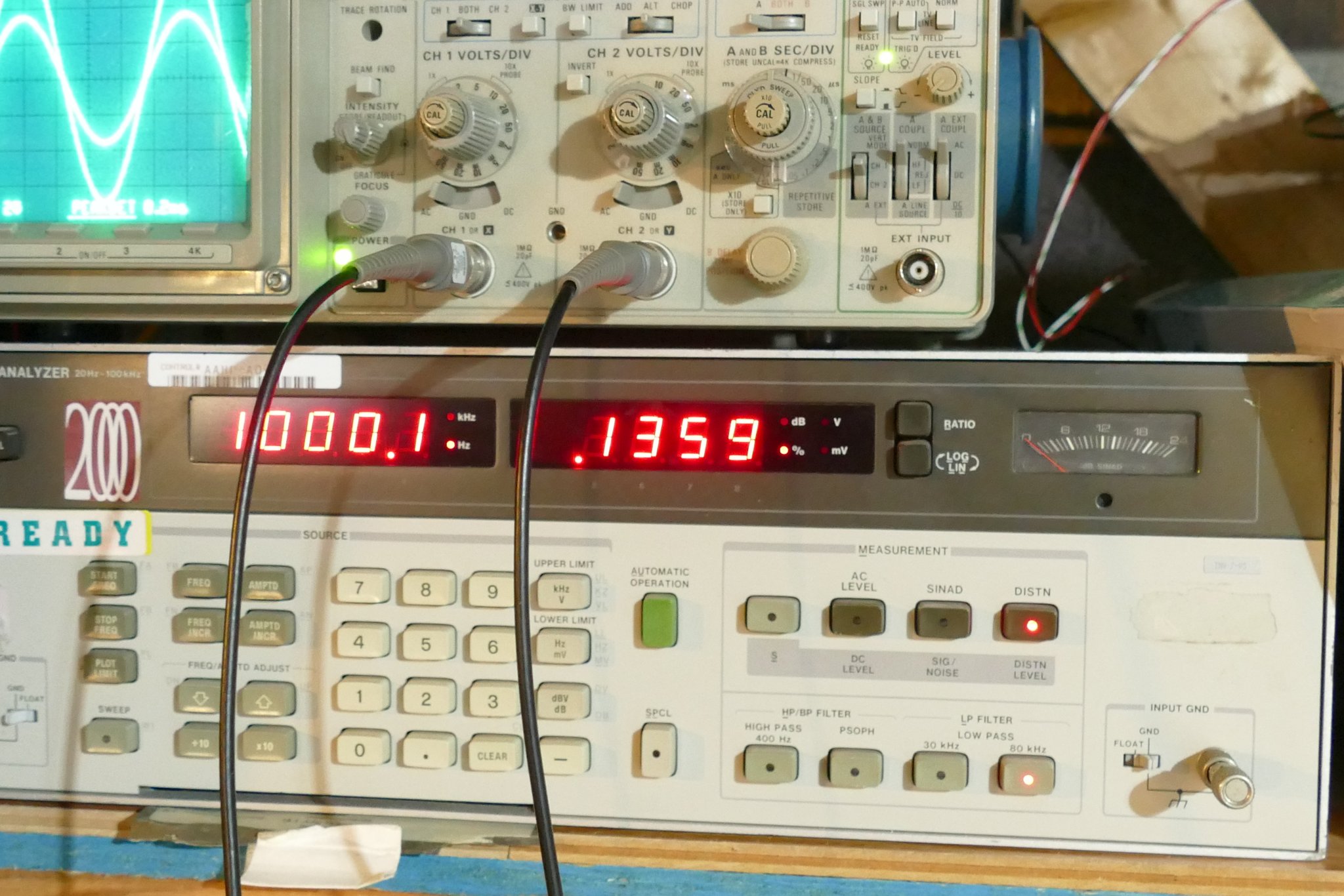

I desire a guitar amp that can be adjusted to play very cleanly and also be capable of a "full metal racket." The saturator allows this by using a 2 meg pot in place of R5. For minimum distortion the screen grid and plate voltages need to be stabilized. The UNSETURATOR board seen here has a pot in place of R5 and a pot for U2 and some trimpots to adjust other voltages for different tube types. There are two tube sockets wired in parallel so I can test 7 pin and 9 pin tubes. This board can get a voltage gain approaching 1000 with some distortion, but it can also get a gain of 60 while putting out 50 Vrms at 0.136% THD with the right tube! Most of the tubes that I tried got 0.2 to 0.4% THD at that level.

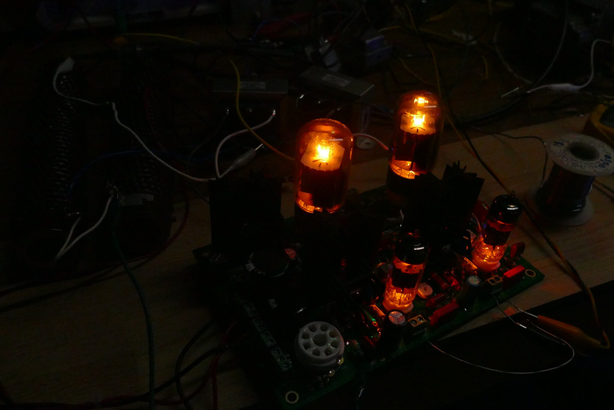

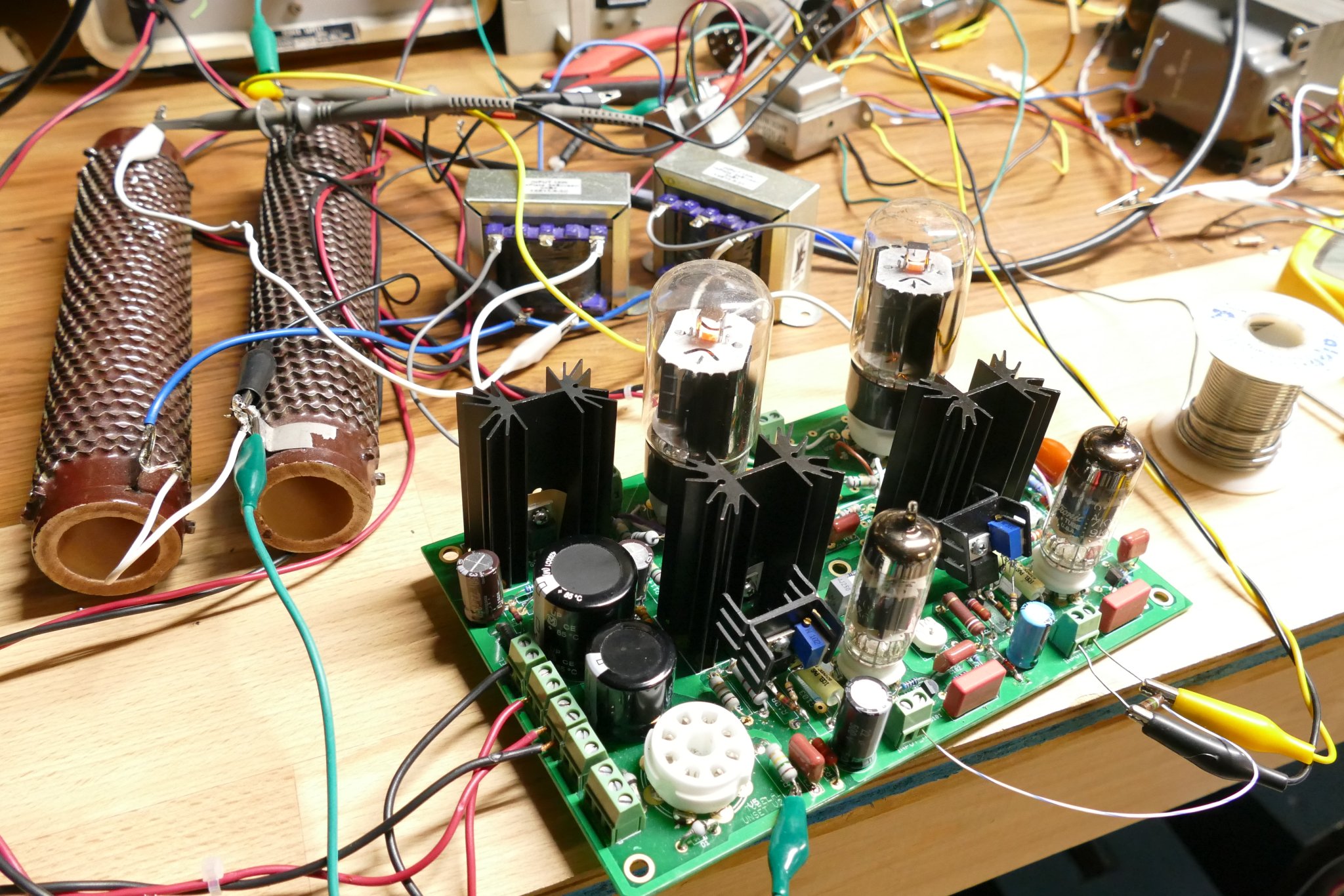

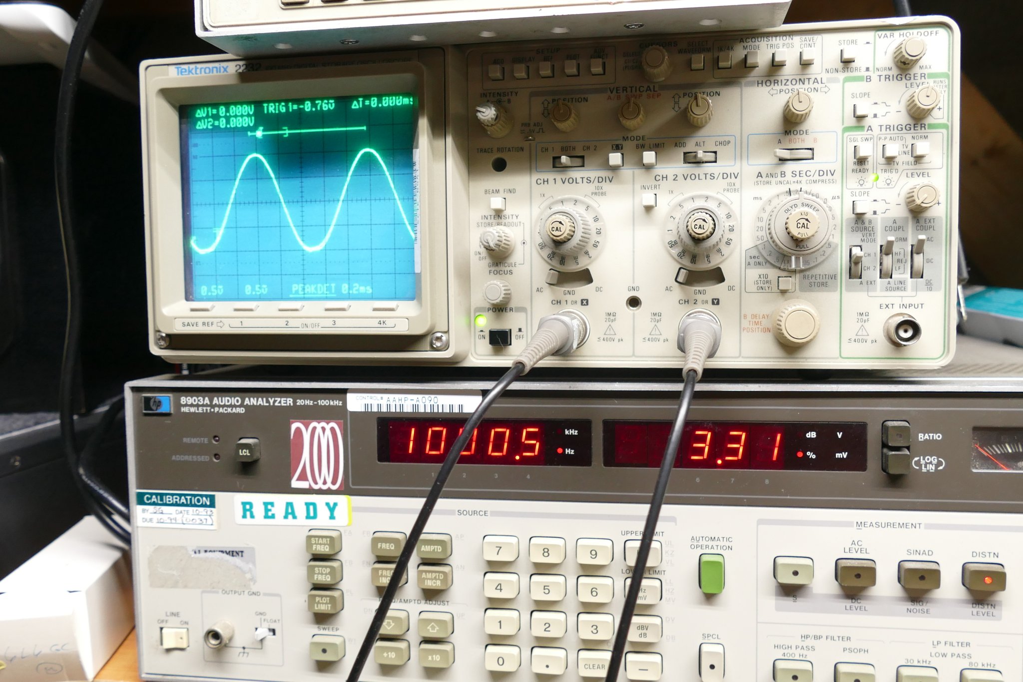

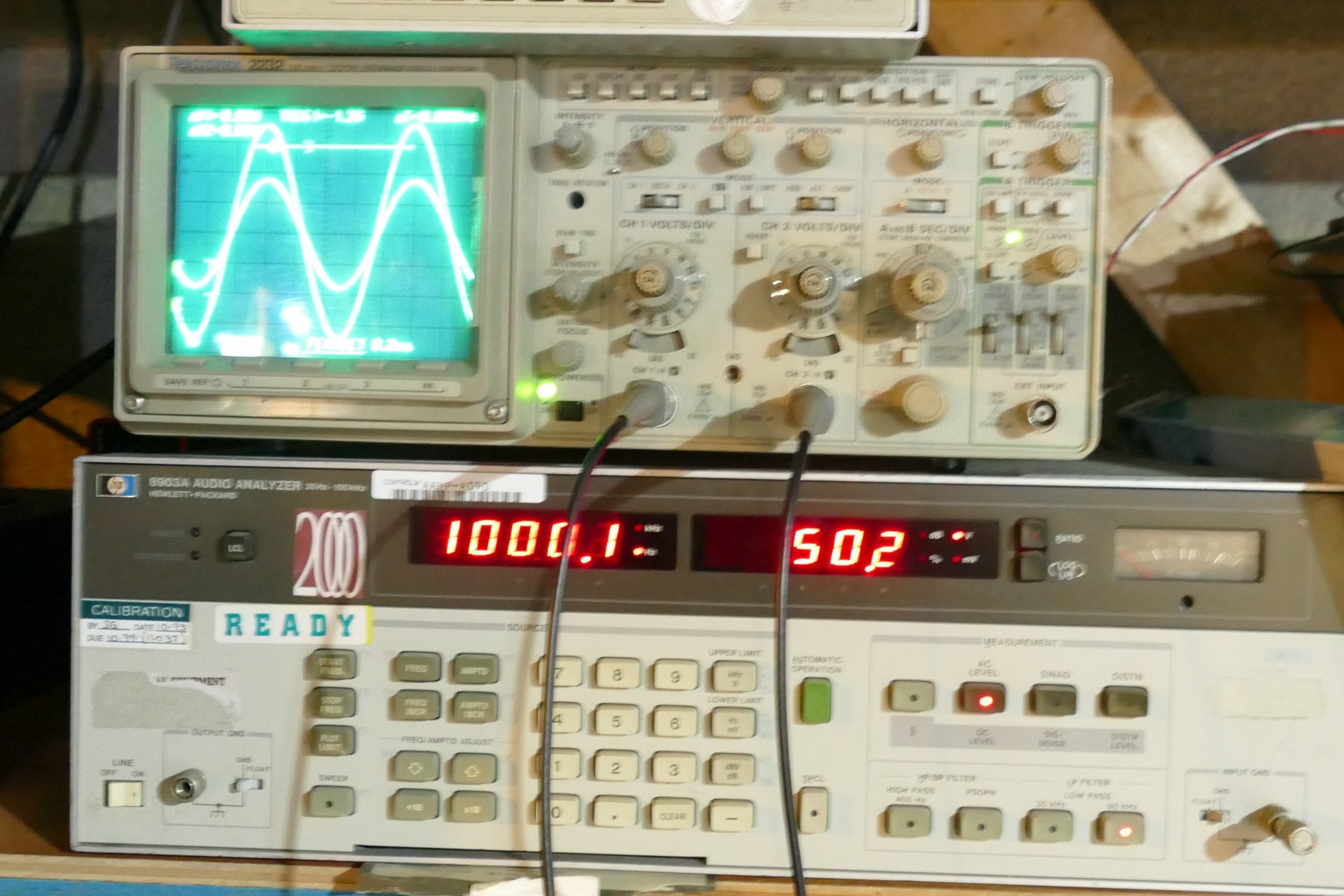

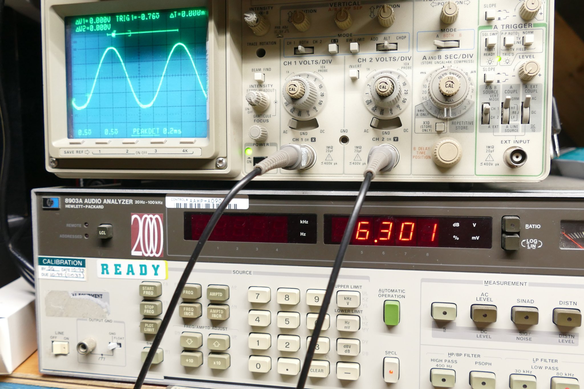

OK, It took a bit of digging and soldering but overall this was an easy test with minimal effort. I dug up an old UNSET board, rewired the jumpers to suit a pair of 6AV5's, plugged in the first pair of Sylvanias that I found that looked the same internally, flipped the switch and both channels sprang to life with nearly equal performance. I set the power supply on 300 volts and the idle current at 65 mA per tube. This burns about 20 watts in each tube / mosfet pair. I let it cook at this level for about 20 minutes, then killed all the room light. Nothing is glowing except the heaters and cathodes.
Preliminary testing on the 6AV5 / Edcor combination in an UNSET board shows good performance at 1KHz with the onset of clipping at just over 6 watts output and 3.42% THD at 7 watts. reducing the frequency to 100 Hz gives 3.4% THD at 5 watts. Saturation is evident at power levels above 2 watts at 40 Hz. I have not tried any cathode feedback yet, nor have I tried to UL wire an UNSET board. These may take a day or two to get to. The power supply was set to 300 volts and the idle current was 65 mA per tube. Both channels are shown on the scope screen at the same time. They are nearly identical except a slight difference at the bottom.
Can it be R11? So it changes the load seen by the unset?
I’ve bought some cheap 6J5P for these kind of tests in guitarland, but on LTSpice they seem very good for Hi-Fi as well, being linear and with good amount of gain.
Yes, R11 in my schematic, and R5 in yours.
