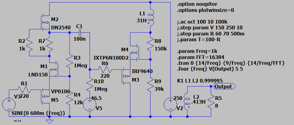

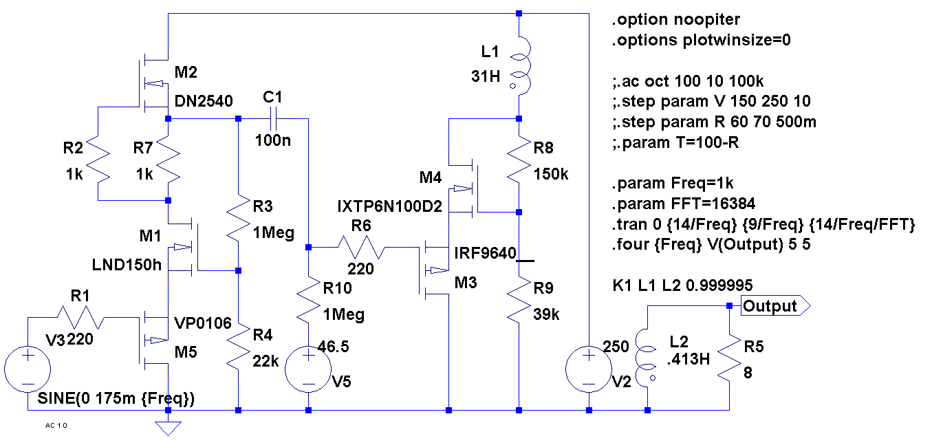

Can you comment the attached circuit? Due to the fact that the driver has high gain and low distortion, I've pushed the local feedback on the output stage to 20%. This should bring towards 35 Wrms before clipping.
Thanks!
Roberto

Yes, the sim shows 34.something watts at the onset of clipping but it takes 1.05 volts peak (2.1 V peak to peak) to get there. My DVD player would not be able to drive this amp to clipping without another gain stage. There is a segment of users out there that will attempt to drive a nice HiFi amp with an iPhone or other similar device. My testing reveals that I need a LY Spice sim that can hit clipping with 0.6 to 0.7 volts for my iPhone to be able to make it clip on at least half of the songs stored in it in my testing. My cheapie Motorola Android phone seems to have a bit more output, but not much more.
The last amp I had running on the bench used a two stage SCG design to generate lots of voltage gain. It is follower by a large source follower for current gain. It was running on the bench successfully when a slip of the screwdriver turned some of the fets into charcoal. All has been torn down, and today's news may spell the end of my testing for a long time.

With a small mod to the driver stage I targeted your suggestion of clipping with 600 mVp at input.
Ciss of the IRF9640 is 1.2 nF ( https://www.vishay.com/docs/91086/irf9640.pdf ), so to swing 93Vpp at 30kHz it is needed to have:
2 x pi x F x Vpp = 17 V/uS
I = Ciss x slewrate = 21 mA
Is it correct? On the driver I have 1.5 mA, do I need more current?
I do not actually use an IRF9640 in my builds. I use an FQA9P25 in the output stage because they fit my quick change sockets. They have the same die as the TO-220 FQP9P25 part. I have not found a model for the 9P25, so the sim uses a 9640.The P fet is FQA9P25 (FQP9P25 will work too) and the N-fet is IXTH6N100D2. My brief experiment with the SiC J-fet did not work, but I didn't try to figure out why it didn't.
The p-fet operates as a follower so the gate to source capacitance, Ciss is effectively bootstrapped since they operate at nearly the same AC potential. The important capacitance in a follower circuit is the gate to drain capacitance, Crss since this is from the input (gate) to AC ground (drain). The Crss of the 9P25 is 27 pF. Note that all of the p-fets in this and other similar series have been discontinued and are no longer being made.
My test board has a 330 ohm resistor in the CCS of the first stage with an IXYS IXCP10M45S CCS "chip." That generates about 8 ma of current. It's basically copied directly from my modified UNSET board with an LND150 in place of the tube. Measured frequency response was limited only by the OPT and went out beyond 30 KHz. Didn't record the actual number, just turned the frequency knob on the generator. It was the LF response that surprised me the most, as I could get a clean 20 watts at 20 Hz.
