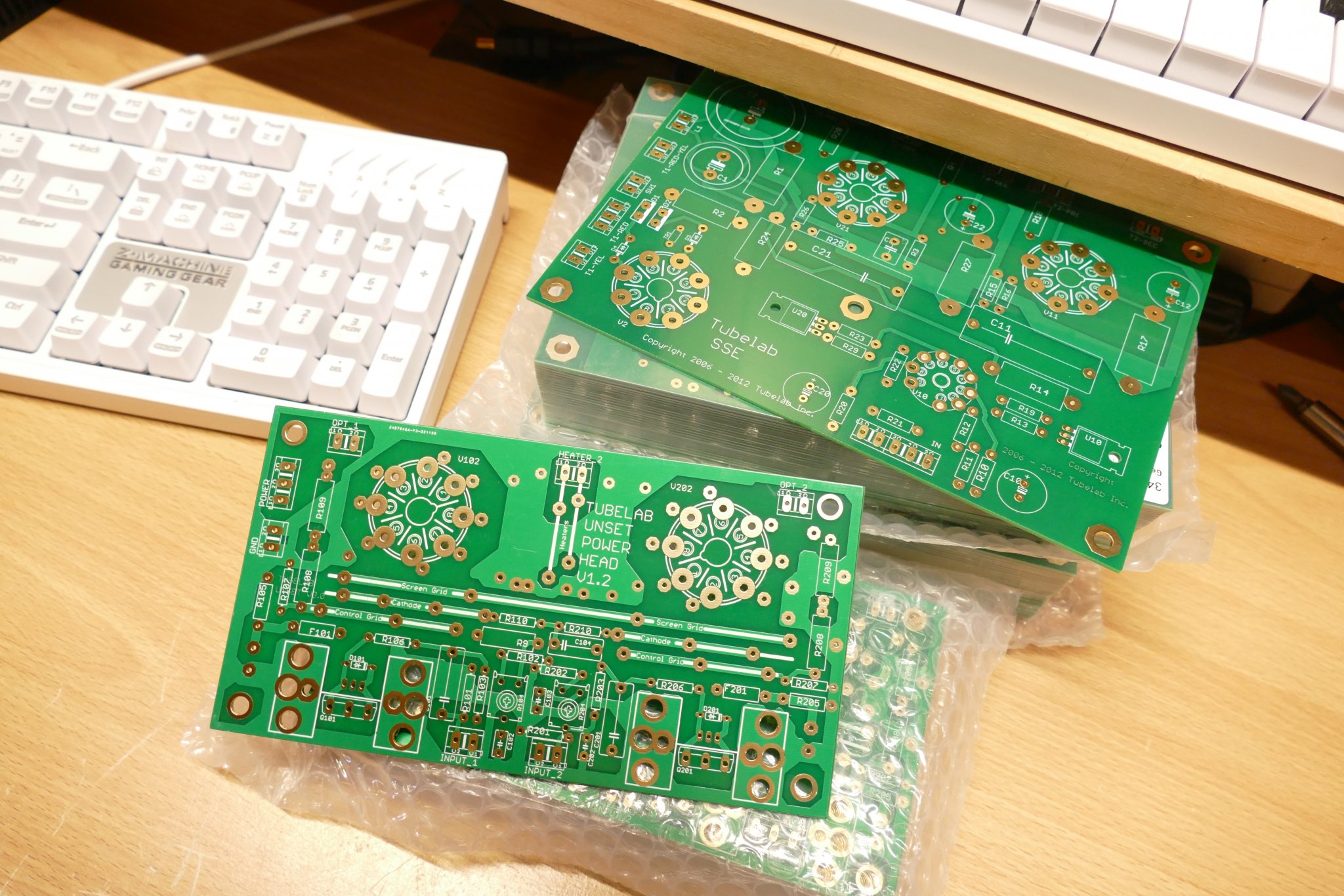

Due to budget constraints, I only got 15 boards. They were added on to an order for restocking SSE boards to keep cost low as shipping is nearly as expensive as the board itself. Depending on how things work out, I may order more of these and possibly make some with different tube sockets, or none at all. I have collected all the parts to build a 1 kilowatt (500 WPC) vacuum tube amplifier and this technology looks like the best choice so far. I really need to build this amp before I get too old to lift it. It could use 4 or 6 of these depending on how testing goes. There will also be a more typical 100 to 150 WPC amp that uses two boards, and few boards used for testing. It's doubtful that I will build the kilowatt monster until I build and beat on something smaller for a while, so it will probably happen with the second batch of boards.Neat, are you going to offer any extras?

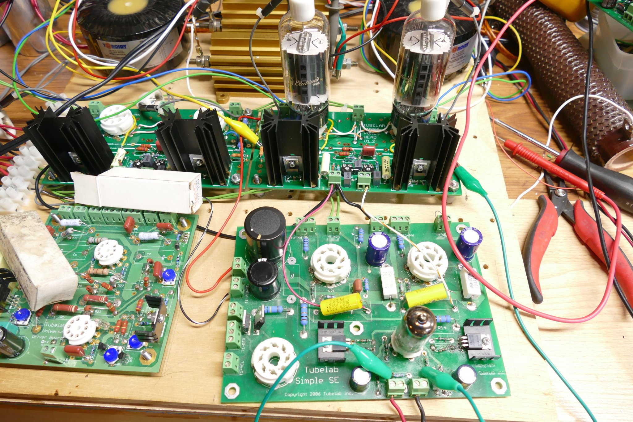

I had originally planned to make a few test boards like these by cutting a few of the UNSET Beta boards in half on the table saw. Now that I made these, there will be a few more of the UNSET Beta boards available. Some of the Power Head boards could be sold as well depending on how well they work and how much Tubelab time I will have, and how many other projects are in process. Much of that depends on the weather as I have two major projects that involve working outdoors.

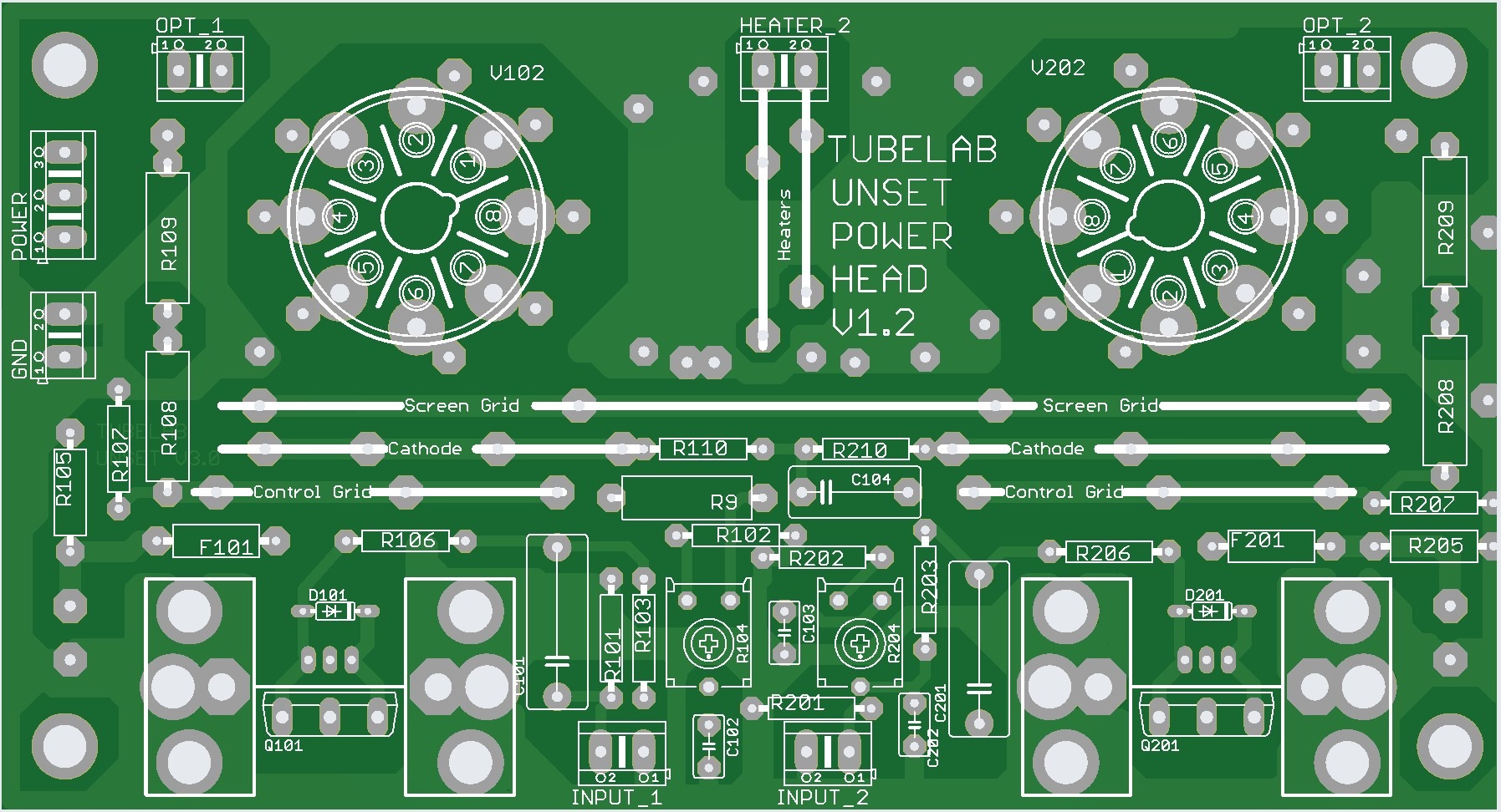

This is a nearly exact copy of the output stage from the existing UNSET Beta board. No electrical changes were made except for the provision to use a TO-247 device for the P-ch cathode FET. There is no screen supply either. It is intended for high power push pull amps using the Universal Driver board for a push pull driver. As I stated I was originally planning to cut up some Beta boards with the table saw, but I may need 6 of these for a 1 KW tube amp and I only have 4 UNSET Beta boards left. I took the UNSET Beta board files and ripped off the power supply and driver stages. I did these in one evening and did not do my usual DIY proto board, so there is a possibility that an unknown error exists in these boards, so I did not get many made. They were tacked on to a restock order of the SSE boards. This order is now in the US with scheduled delivery on Friday. If this is correct your SSE's will ship Saturday.
Depending on how these work and how the high power testing goes, I may tend toward the modular approach for future iterations of UNSET. This would allow for both SE and P-P amps from the same board set. I did manage to squeeze over 250 watts from an UNSET board when driven in push pull on a 625 volt supply. I expect the same from these boards.

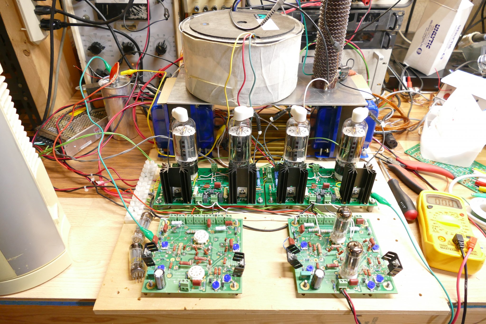

Some shiny new boards showed up Wednesday. This means that it's time to melt some tubes or blow up some parts. That didn't happen. For some unexplained reason I spent two days digging through the box of dead circuits and attempting to put a pair of well used Universal Driver boards back to something resembling two working boards. I cleaned off my proto build board and mounted some new stuff on it along with a pair of big Edcors. I then wired most of it up and completely finished one channel. I connected up some power supplies and the usual scope, sig gen and audio analyzer with no feedback connection at all. I flipped the power switch expecting a big bang, bit nothing happened.......except for 200 watts @ 3.85% and 100 watts @ 1.20% and 10 watts @ 0.769% and 1 watt @0.416%. Some red glow was noted in a completely dark room at 200 watts. No attempt to optimize anything or try any feedback was made. I was using my Sorensen DCS600-1.7 SMPS based power supply which only goes to 600 volts.

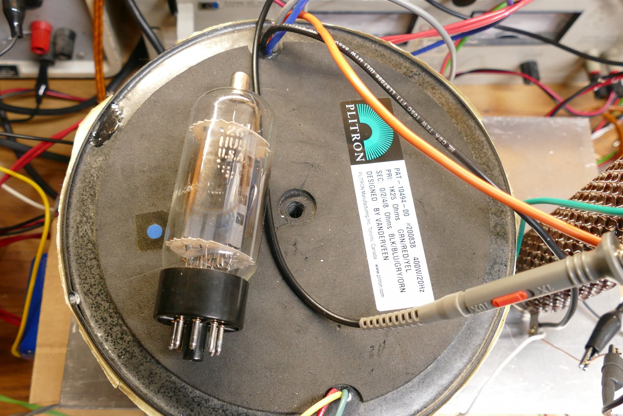

These 33 watt GE 26HU5 tubes have the same plate in them that the GE 26LW6 and 36LW6 have. They are rated at 40 watts. Well constructed samples of these tubes can eat 50+ watts with no color in a dark room. Both of these were a bit off center as only one side showed a slight glow at about 50 watts (a rough guess) of dissipation.200W from a pair of 33W tubes. Nice 👍
The ideal load depends on the tube's peak current and plate dissipation abilities, target power output, and the available B+ voltage. I had limited time, so for this experiment I simply ran the Edcor 3300 ohm OPT's at their rated impedance, then tried 1650 ohms which is where the 200 watts was seen. I also have some huge Plitrons that can work at 1250 ohms, 2500 ohms and 5000 ohms. I will try all 5 combinations and measure efficiency when I have more time to find the best choice for these tubes. I have a few used unboxed large magnoval sweep tubes here somewhere. Whether or not I can find two identical good tubes is not known, but if I have them, I will test them. I keep lowering the load impedance until the plate efficiency drops, then back up a bit.
I will probably build an amp in the 100 to 150 WPC range with these OPT's. I am also planning a monster in the 500 WPC range with the big 1250 ohm Plitrons, so those are my target power levels. I have up to 650 volts at 1.7 amps to test with.

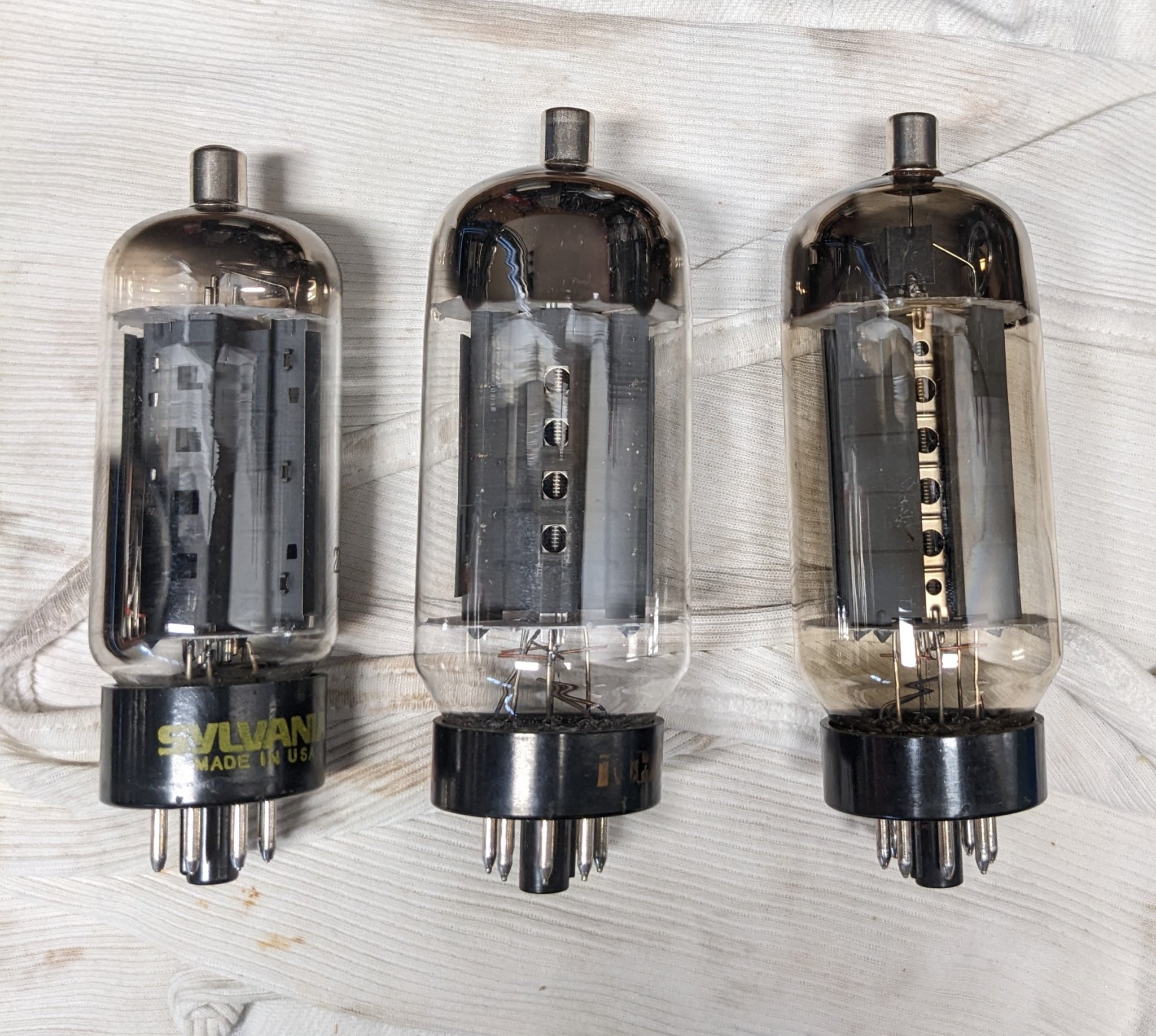

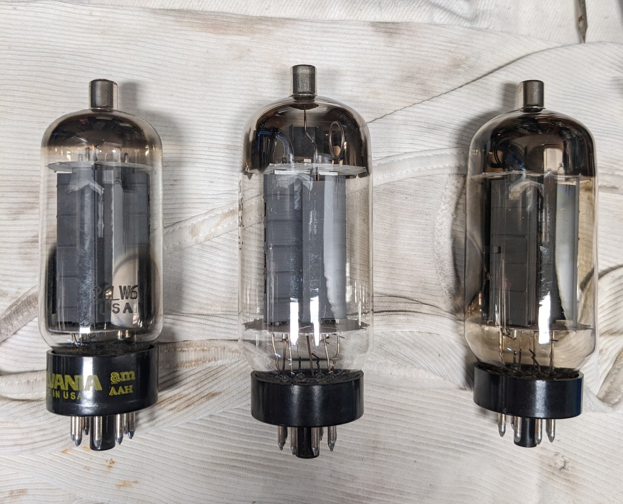

I have seen 3 different type of 26LW6 tubes. The left one pictured below looks exactly like the 26HU5s I have. The middle one looks like the same construction except in a bigger bottle. The one on the right is a whole different thing and looks far more robust that the others. I assume the ones on the left are like the 26HU5s you are using where the better ones can survive at 50+ watts?These 33 watt GE 26HU5 tubes have the same plate in them that the GE 26LW6 and 36LW6 have. They are rated at 40 watts. Well constructed samples of these tubes can eat 50+ watts with no color in a dark room. Both of these were a bit off center as only one side showed a slight glow at about 50 watts (a rough guess) of dissipation.
The tube on the left is a Sylvania made tube with a Sylvania brand. The middle tube is a GE made tube with an RCA brand. The tube on the right is likely a GE made tube without a brand name visible in the picture. As most of us know by now, the name on the tube doesn't indicate who made it. There was lots of tube swapping going on especially among the big 3 during the later days of vacuum tube production.
I picked Stan's (ESRC) brain every time we met for the details, and I still can't identify the three Japanese brands. These are the easy clues, and I have found exceptions.
A GE made tube from the late 50's on will have the date and plant code etched into the glass as a series of coded dots. This is usually placed under the letters U.S.A. (WITH periods) which is under or near the type number. Somewhere on the web I found a site with info on how to decode the dots.
A Sylvania made tube will have the type number etched into the glass in a thinner font than the GE tubes with the letters USA underneath WITHOUT the periods.
An RCA made tube will have the type number etched inside the usual octagon. The RCA octagon has 8 equal length sides on large tubes. There are Japanese made tubes with a short fat octagon.

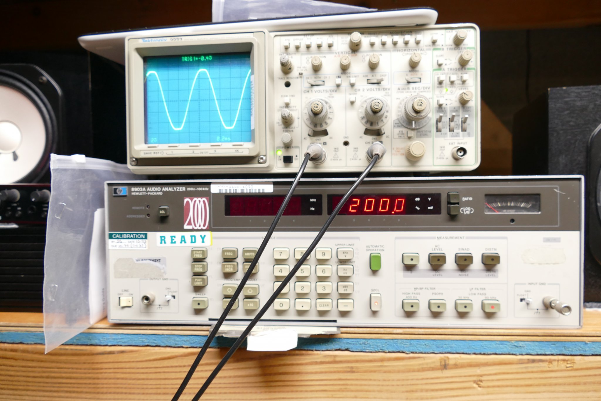

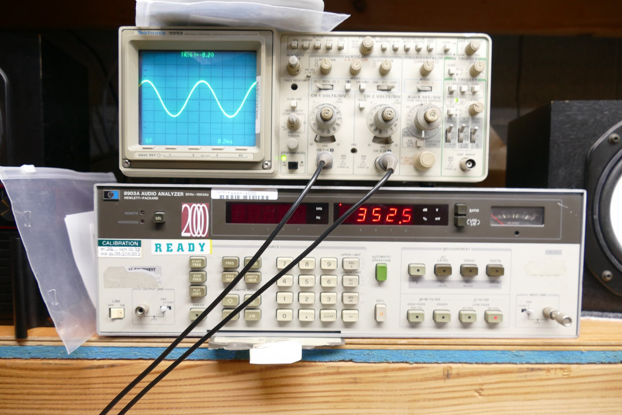

I set out today to achieve a PB. What? and what's MOAT. Well MOAT is needed to achieve a PB.
PB is an old term often used in the gym to state someone's Personal Best. All my gym related PB's happened nearly 20 years ago, so this one is related to diyAudio. I'm looking at maximum undistorted audio power from an amplifier that I designed and built. I saw just over 500 watts come from Pete Millett's Engineers Amp when I stuffed 4 35LR6's into it and connected the board up to MOAT over 10 years ago. MOAT is the Mother Of All Transformers. So today I stuffed a pair of 26HU5's into each Power Head board and wired two boards up to a single Universal Driver board.

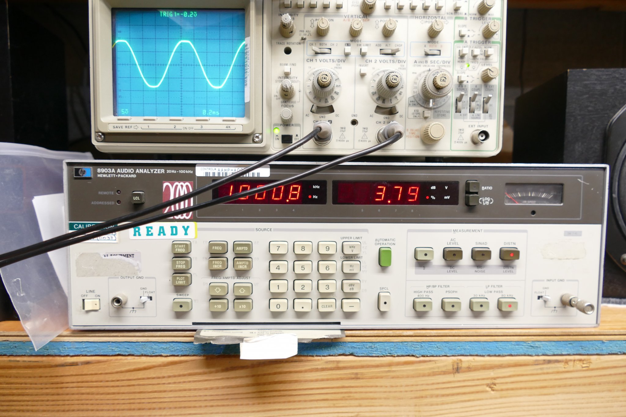

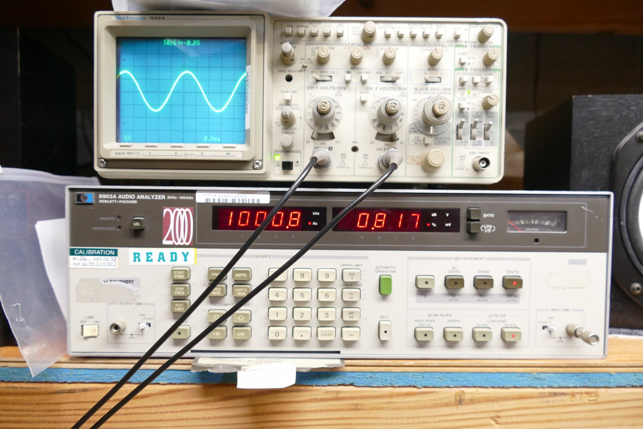

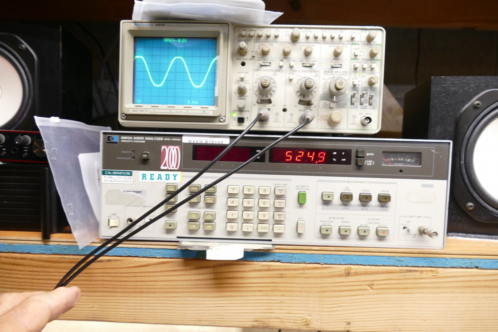

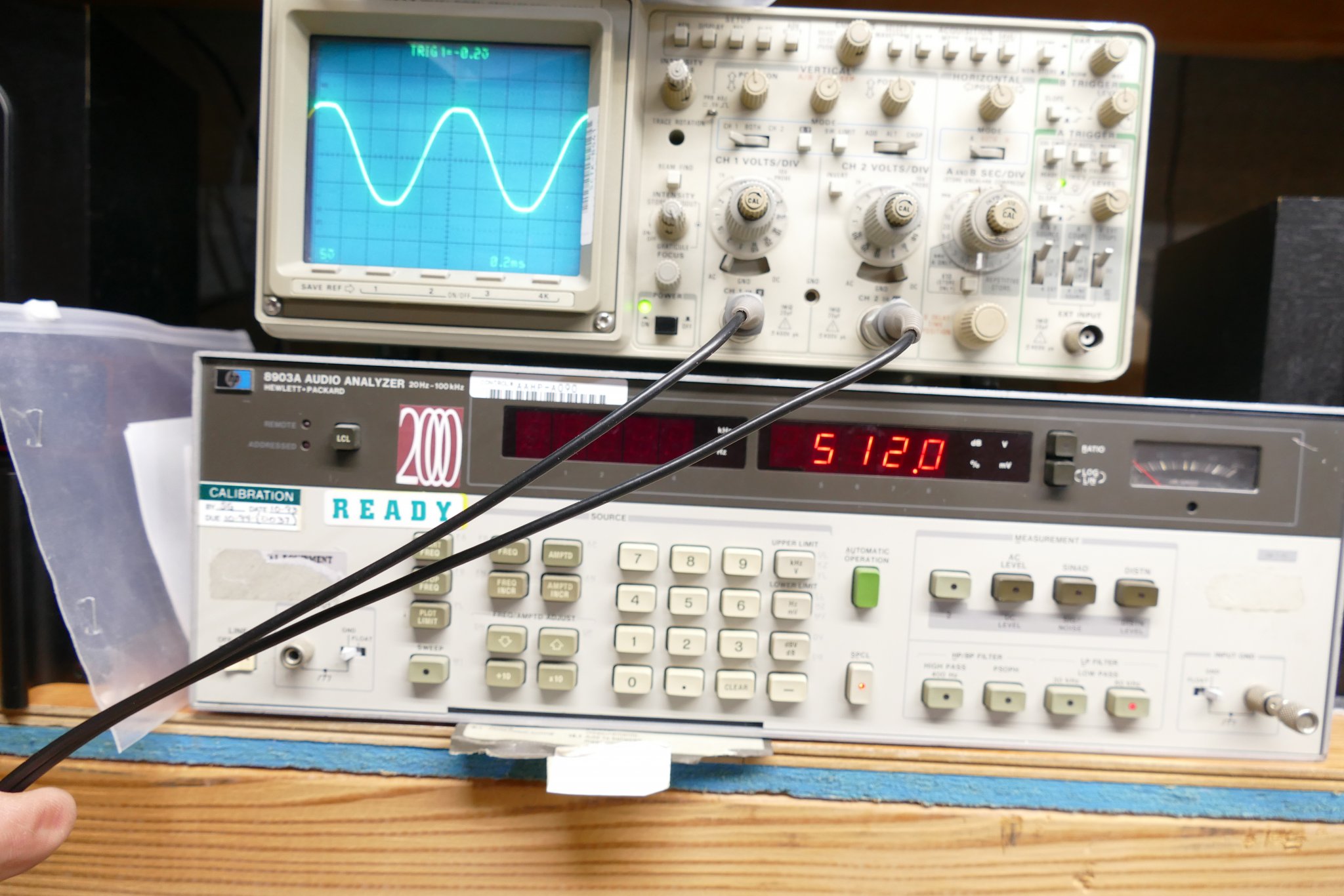

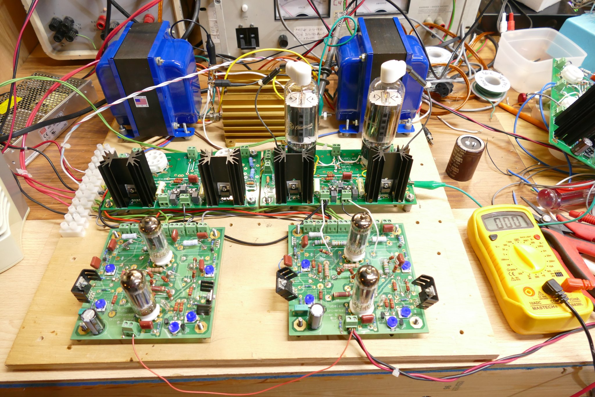

I fired it up and nothing blew up, it just worked. I had a separate power supply for the driver board and connected up the monster 650 volt at 1.7 amp supply to the CT on MOAT. The Knight Kit supply was just for the output tube screens. The big brown thing to the right of MOAT is a 500 watt 8 ohm load resistor.
I cranked it up to 350 watts where it made 0.8% THD and let it burn all the crud off the load resistor before pushing further. I then turned the knobs up to 512 watts where the THD was 3.8%. The screen current climbs pretty quick on a sweep tube as you start to hit clipping, but I still had some room to max spec, so I turned it up further, looking for the 5% THD point. I was at 525 watts (my new PB) and just under 5% THD but the 15 Amp bench breaker tripped ( a new first) before I could take the THD picture.

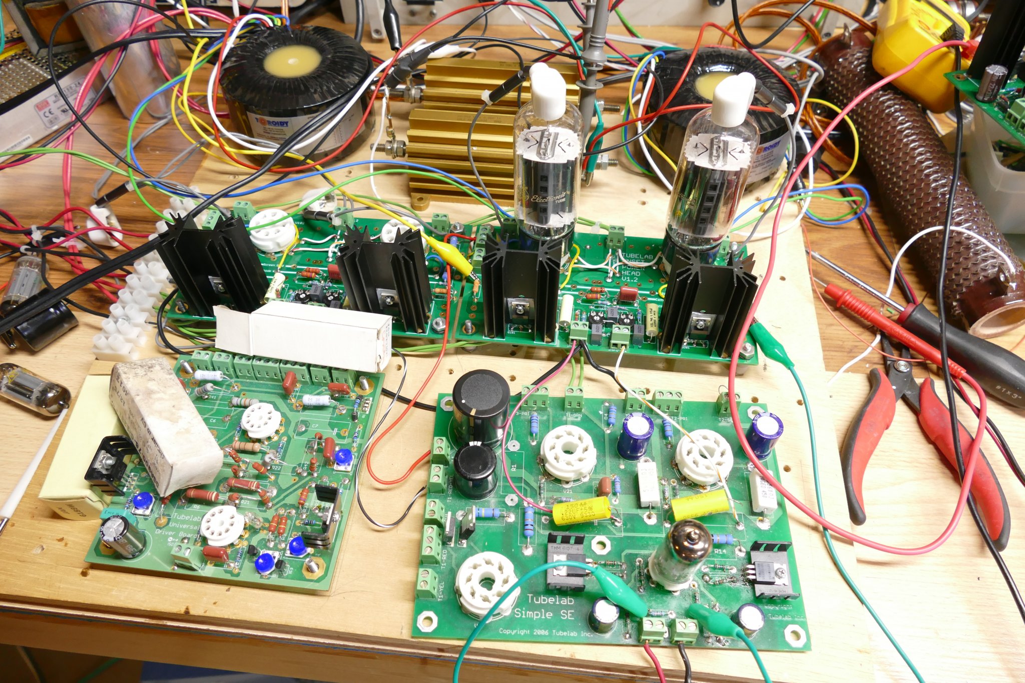

The few of us who have played with an UNSET Beta board have probably realized that the output stage just works. It seems to do fine in SE and P-P and it's equally as happy making 10 watts in SE as it is making 200 watts per pair in P-P.
The driver stage seems to need the most fiddling. It works great in small to medium power amps with a pretty wide "sweet spot." It begins to run short on gain when asked to deliver 120 to 150 volts peak to peak. This often results in a single point for minimum THD, and the point is tube specific. I began to think that maybe there is a better choice for the driver.
To test this theory, I simply wired my UNSET Power Head board to the driver section in the old SSE board. I had no problem squeezing 25 watts out of this combo in SE from a 500 volt supply. The THD was as good, or better than the UNSET beta board.
OK, the SSE board is not my best performing board, the TSE-II is. I was about to wire the UNSET Power Head up to an SSE-II board when my Dumm Blonde brain said STOP. When the TSE was morphing into the TSE-II one of the common requests was to find a more available tube than the WE-417A / 5842. That would have required more work than I could have done at that time, but maybe now is the time.
