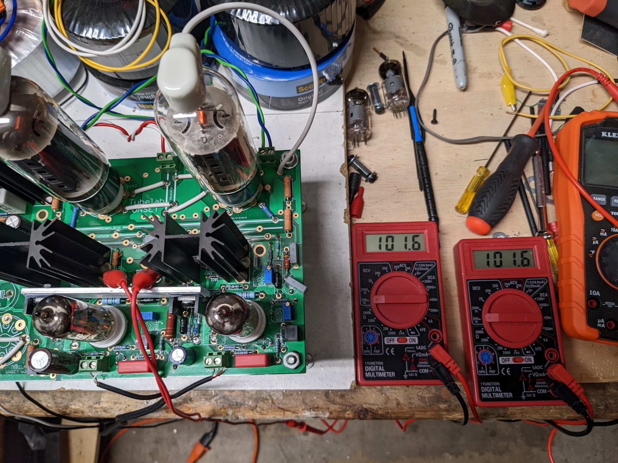

I got a few minutes this evening to poke at it .
Right FQPF9P25 tested short . Left tested fine (but maybe wasn't) . Replaced Right MOSFET.
Powered up with 6DQ5s. Started to raise bias current on Left and blew fuse.
Tried again. Another fuse. Pulled left FQPF9P25 and tested again, now tests short. Replaced.
Powered again, both channels fine , though bias in both channels is twitchy/hair trigger at desired 60mA.
Powered down to cycle it again to see where bias ends up. Pretty good. Just under 60mA after a few minutes.
Not exactly sure why the FETs went after running fine for these past few months but touching the heatsinks after powering down they were really hot. I plugged another heatsink (HS380) into the top of the existing one and tried again. Top heatsink started to get warm pretty quickly so this fix might work but i had to get on to other things and so will try it again as soon as I find a few minutes.

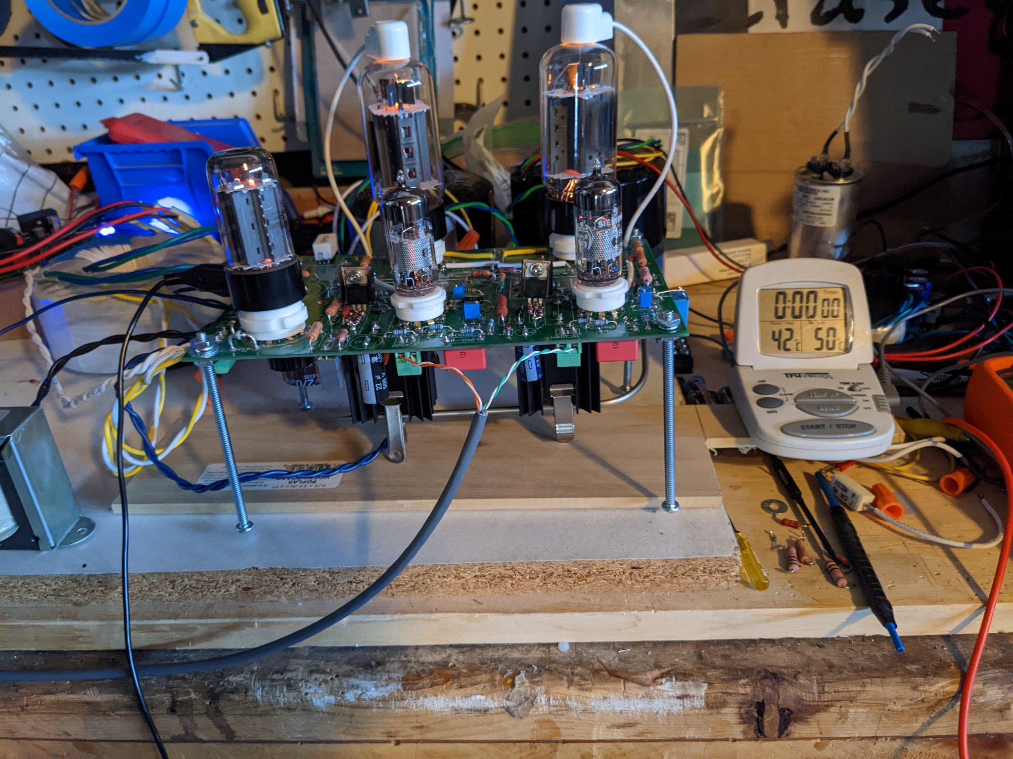

Question 2) Even doubled , the heatsinks for the FQPF9P25's get stinging hot. The kind of heat that just remembering it makes the hair stand up. It's presently a 500VAC secondary into a choke input supply. I have to say I really like the sound the way it is. Maybe that heat is just the price that has to be paid, though I can't imagine the MOSFETs will take it forever.
After a couple hours of running I tested my heatsinks. I just used an electronic meat thermometer clipped to one, highest reading I saw was 42C. After turning off the amp and giving it a minute for the voltage to bleed down I could keep my hand on the heatsink for an easy 10 seconds so it's not getting extremely hot. This is running 6DQ5 and 6EJ7 with a B+ of 318VDC. Driver plates are set at 180VDC, current through the output tubes 104mA.

No time to put the amp on the bench but found the thermocouple and measured what I could in situ. Power FET mounting screws are just under 70ºC and heatsink half-way up the body is just under 60ºC. Certainly hot but by the data sheet well within temp limits. B+ is 460 so probably unnecessarily high but I was playing music while measuring and it does sound good.

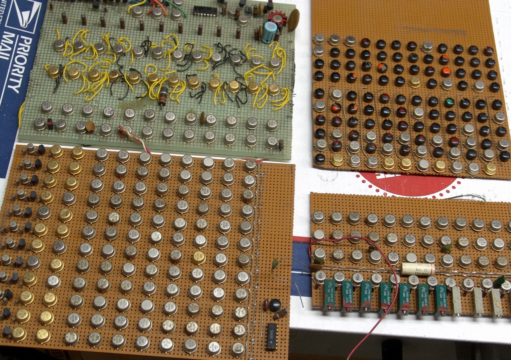

Pulling hundreds of chips out of scrap circuit boards, soldering about 400 of them onto some perf boards and then interconnecting them with tiny bits of wire over a nearly year long period to build a digital music synthesizer back in 1971 qualifies as insanity. The synthesizer was destroyed by my father in a drunken rage in a matter of minutes, but I salvaged some of the boards because they represented almost a year of my life. I still have them, but little else from the early years of my life.

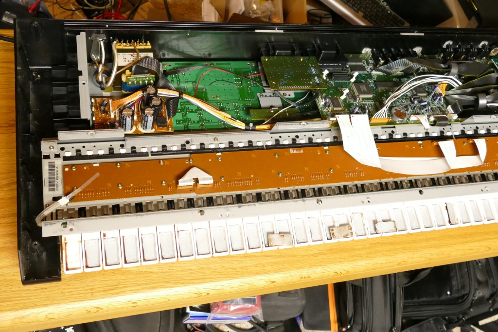

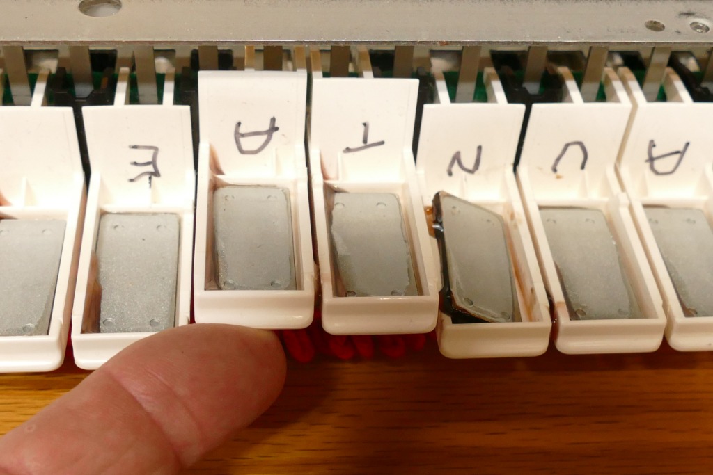

My workbench is currently occupied with a large Roland JV-1000 music keyboard, which has a possibly terminal case of "Roland red glue disease." It was my daughter's in the late 90's before she abandoned it and all of her other music stuff. She used it to play and teach music to kids. The idea is that she can use it to teach her own kids how to play the keys.
