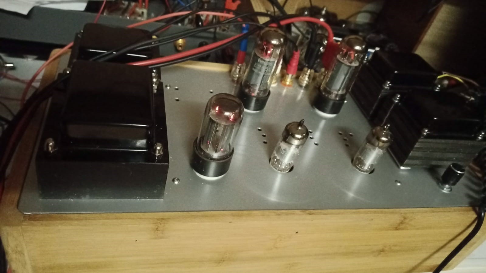

In a box now, with E235L outputs and EF184 drivers.
Homegrown choke and OPTs.
In the mess that is my workshop it sounds pretty good: bass and details I didn't hear before.
And that is using a USBC converter cable and my phone as a source.
I'll bring it to my living room later and hook up my regular streamer and speakers.
Didn't measure anything yet except for bias 😅
