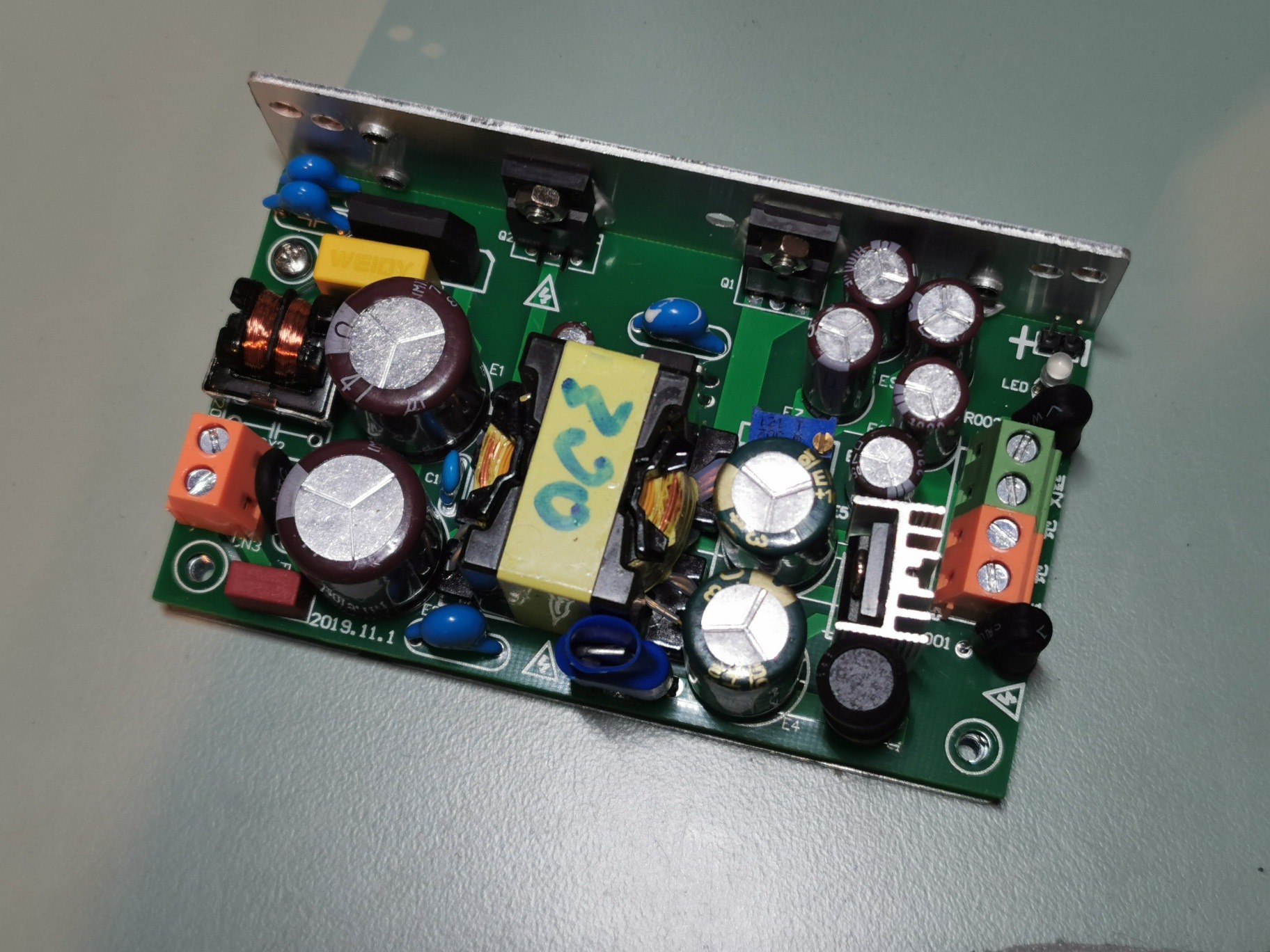

I had high hopes for the imported little SMPS but it didn’t work out. I was getting an audible low frequency warbly tone plus higher frequency noise heard from the tweeters. I swapped out the SMPS and replaced with a regulated linear HV/LV supply and voilà!! Dead silent background and sounds very good to my ears .

I believe its very similar, if not the same, as the SMPS you were working with.
Same board setup different parts.
