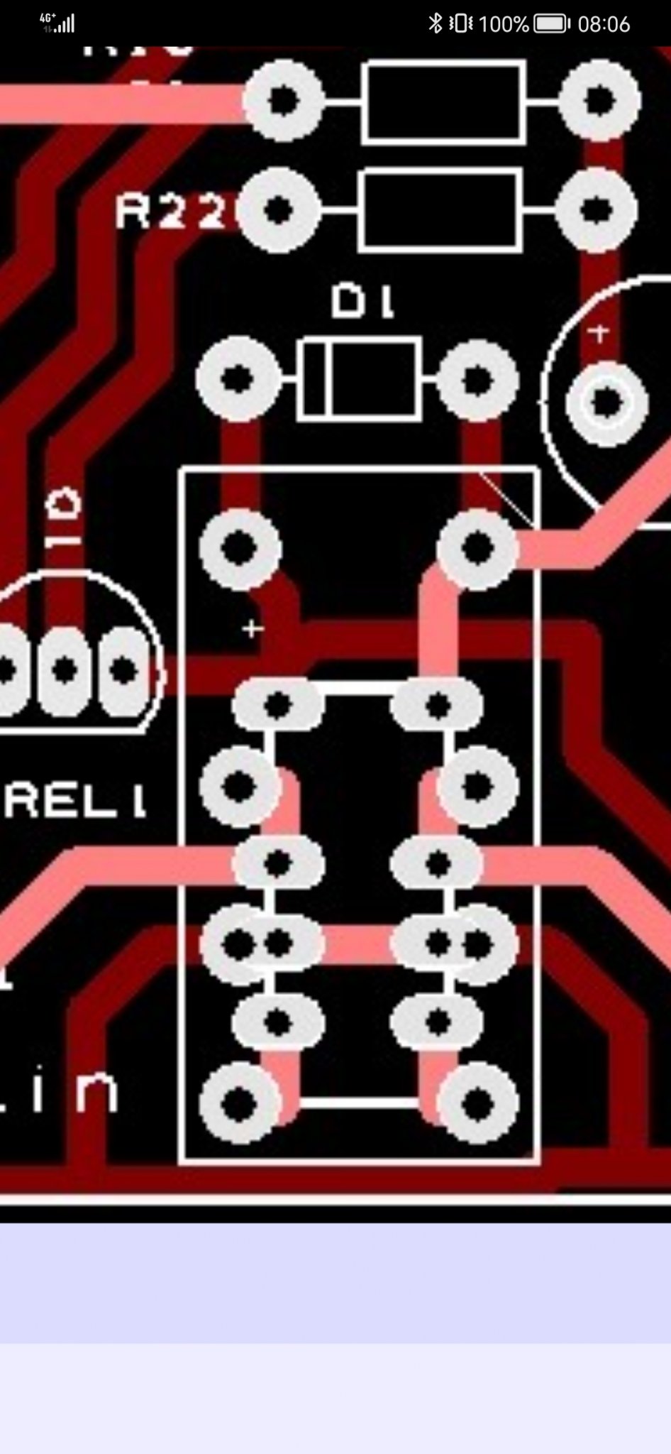

on the NA-5? the EC2 is negative of pin 12?Yes. pin 12 is coil DC positive.
the NA-5 is a non latching, i thought the first polarity is the right one, which indicate pin 12 is negative
good to know
The Kemet relay has been functional since first powered up weeks ago 😉
yeah that confirms the Kemet EC2-5NU is the correct part for it. thanks @KoifarmPin 1 is plus coil.

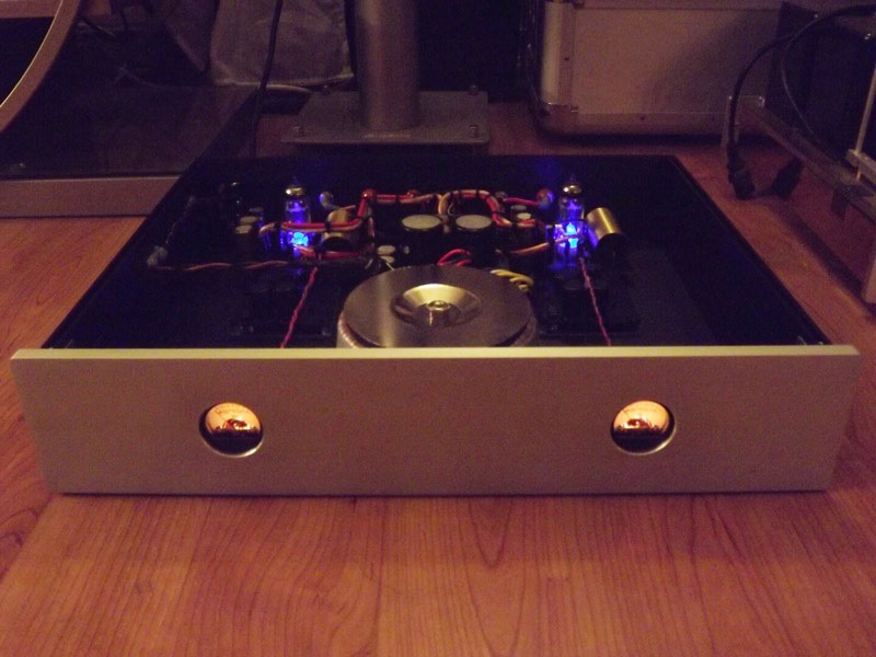

A project
Junior line; multi configurable fro different tubes

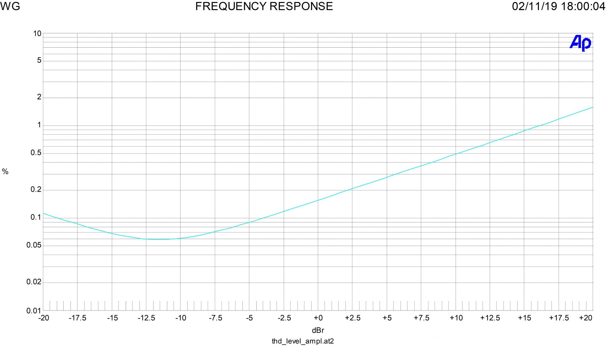

The THD vs level has a 0 dB = 2 volts

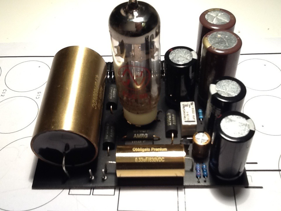

Yes.Can l confirm that other than 3 W R5 and R15, all other resistors are 0.5W?
Thank you Koifarm

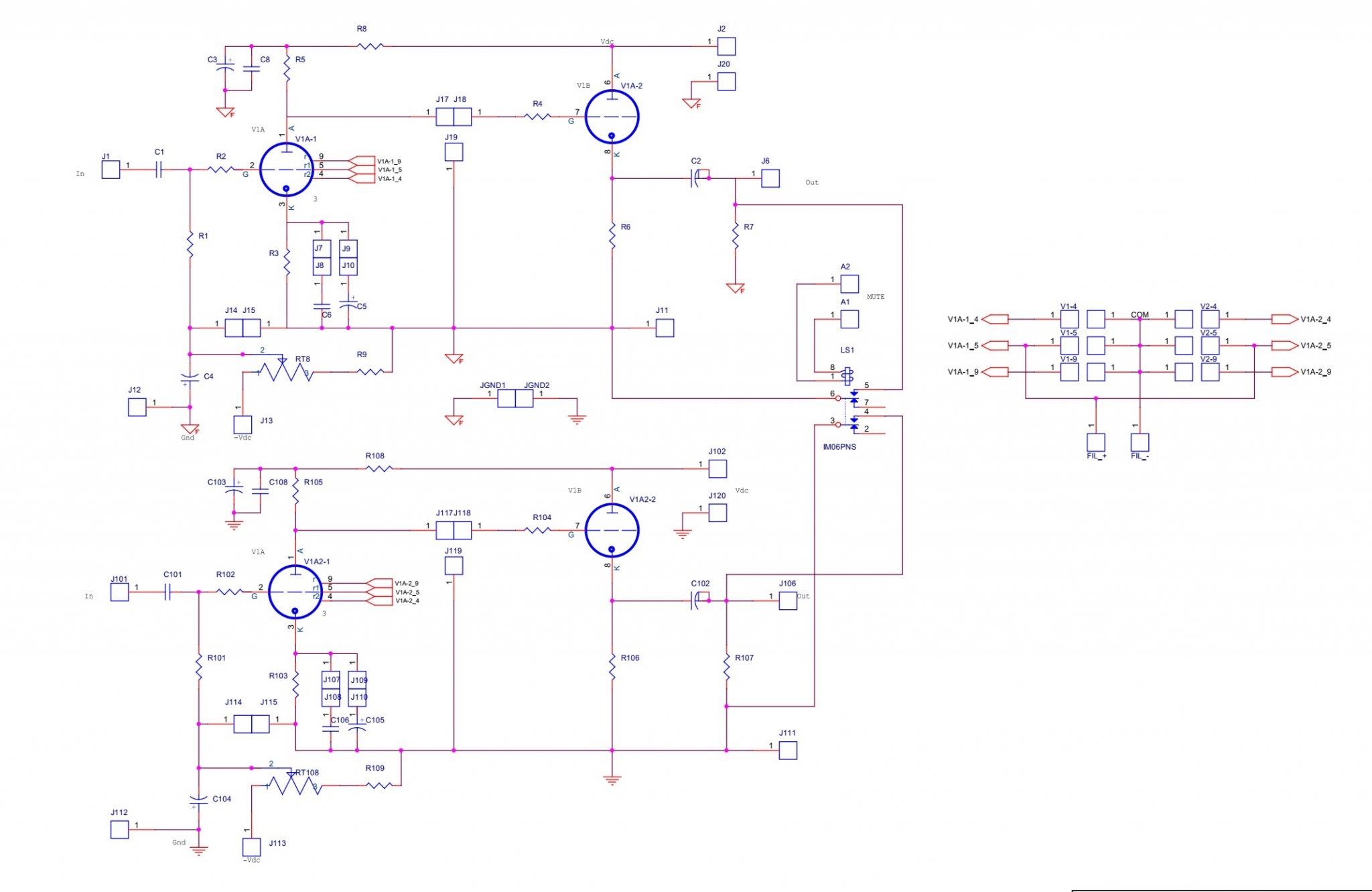

What is the voltage rating for 100nf at C1 and C11? 63V should be enough? Is the value of 100nf critical? What is the function of this capacitor ?
I notice the 400 V 10Uf output capacitor. Can i substitute for 4.7Uf , 250 V rating?
Voltage rating C1/C11 should be minimal voltage drop(80/90V)over R5 but at warmup this voltage could be easy 150/200V. To be save use minimum voltage of anode supply(265v).
The upperstage is a active load. It is just a cathode follower. C1 and R6 are a high pass filter the crossover point should be below 20Hz.
The voltage of the output capacitor is the same story as C1.
The value can depend on the inputimpedance off the following stage. It is also a highpass filter.
You can calculate crossoverpoint by freq(hz) =1/(2*3.14*R(ohm)*C(F)).
10uf is good for low impedance like 2k
2.2uf is good for impedance like 10k
and you can use 0.22uf for 100k input impedance.
One thing if you choose capacity to low there is no bass. So do not go cheap.

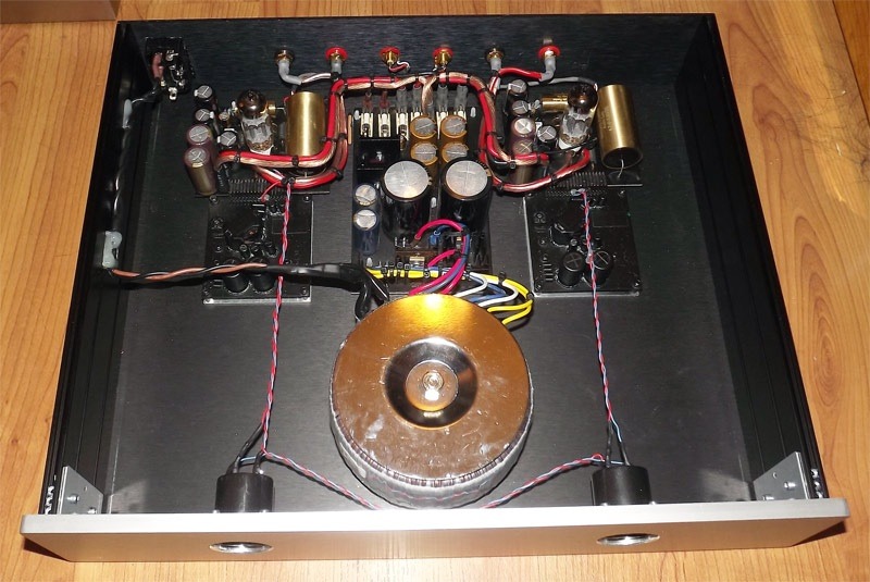

may i ask what is the linear PSU for this?Driving 1k8 is no problem for the buffer.
In the past used a ecc99 srpp to drive ucd400oem.
Now i would use the 6n6p mu follower config.
