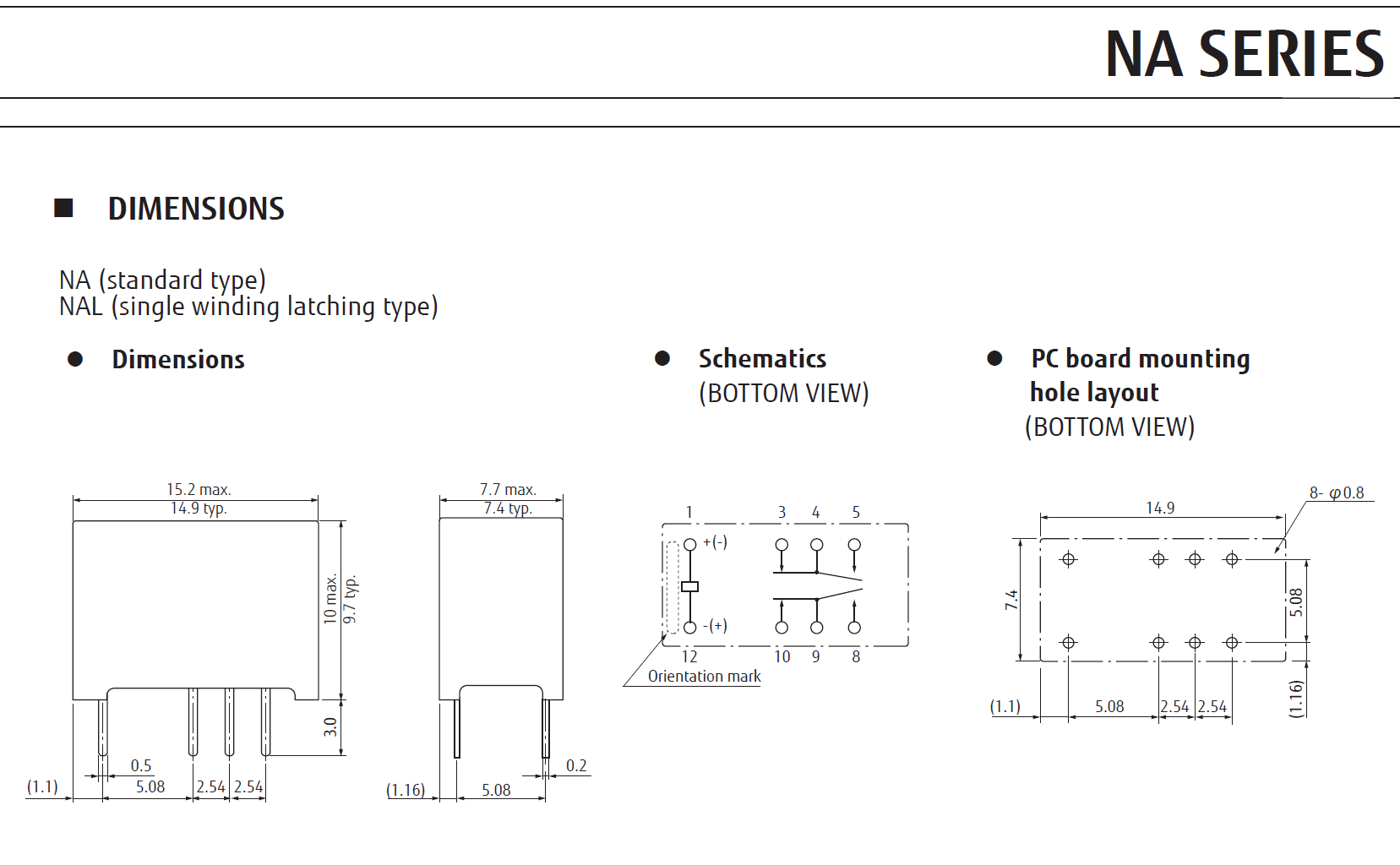

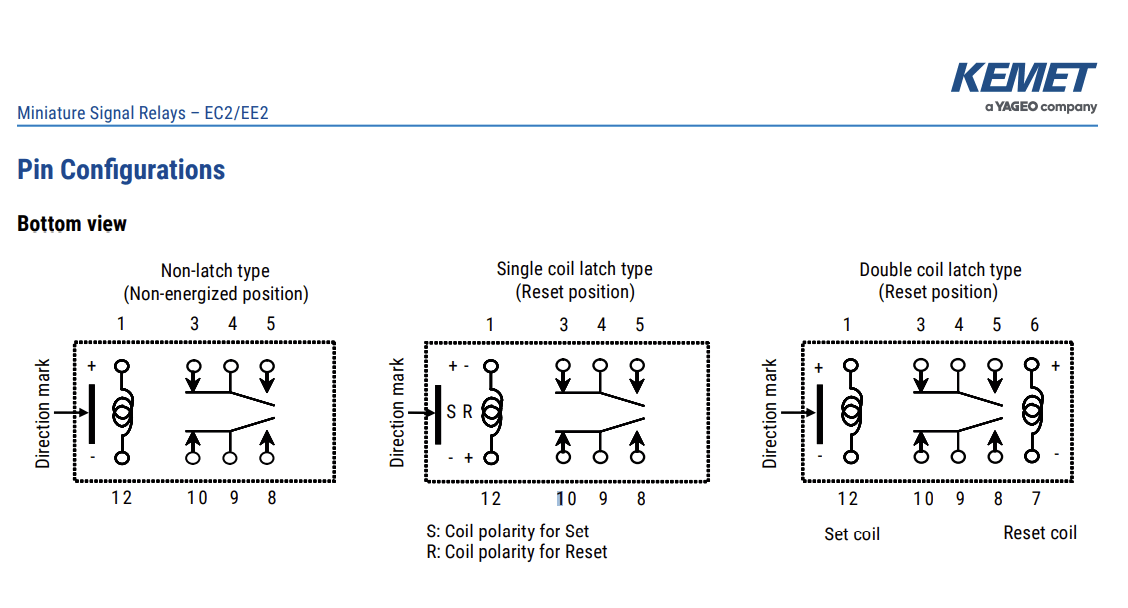

hi gary, i think that one has different polarity to the takamisawaAnd this is the one I have ordered:
https://au.mouser.com/ProductDetail/653-G6SK-2-H-DC5
the KEMET also has the wrong polarity....Yeh, I got that wrong, different pin spacings as well. Bought the one Vunce has used.
If it was the wrong polarity, wouldn’t it not function?
https://www.mouser.com/datasheet/2/212/1/KEM_R7002_EC2_EE2-1104574.pdf
https://www.mouser.com/datasheet/2/164/na-914632.pdf
i was a bit confused as well, but thats what koifarm told me, however i have just realised that the NA datasheet use 1 drawing fro non latching and single latching, so it could be ok with the EC2. @KoifarmIf it was the wrong polarity, wouldn’t it not function?
