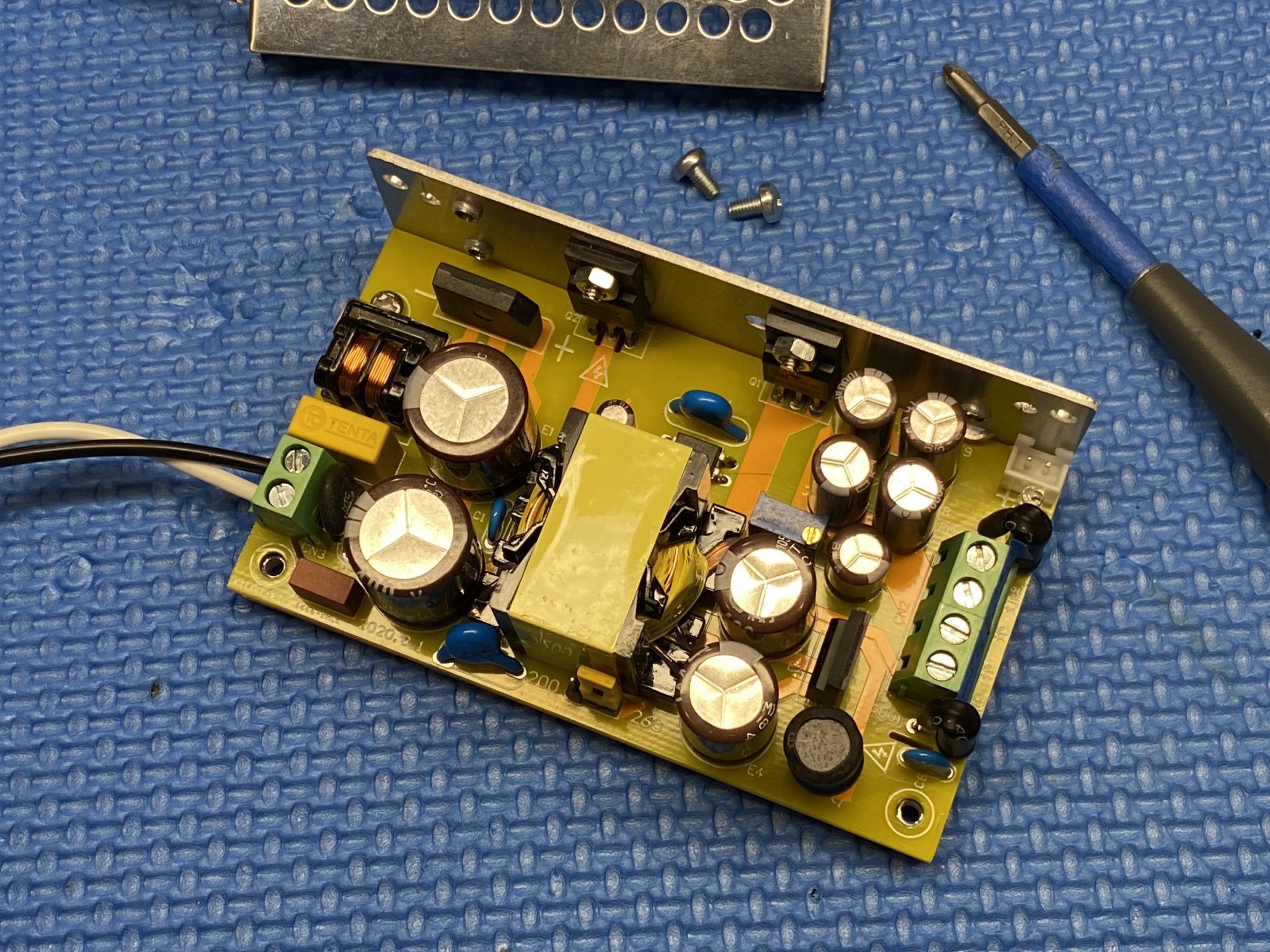

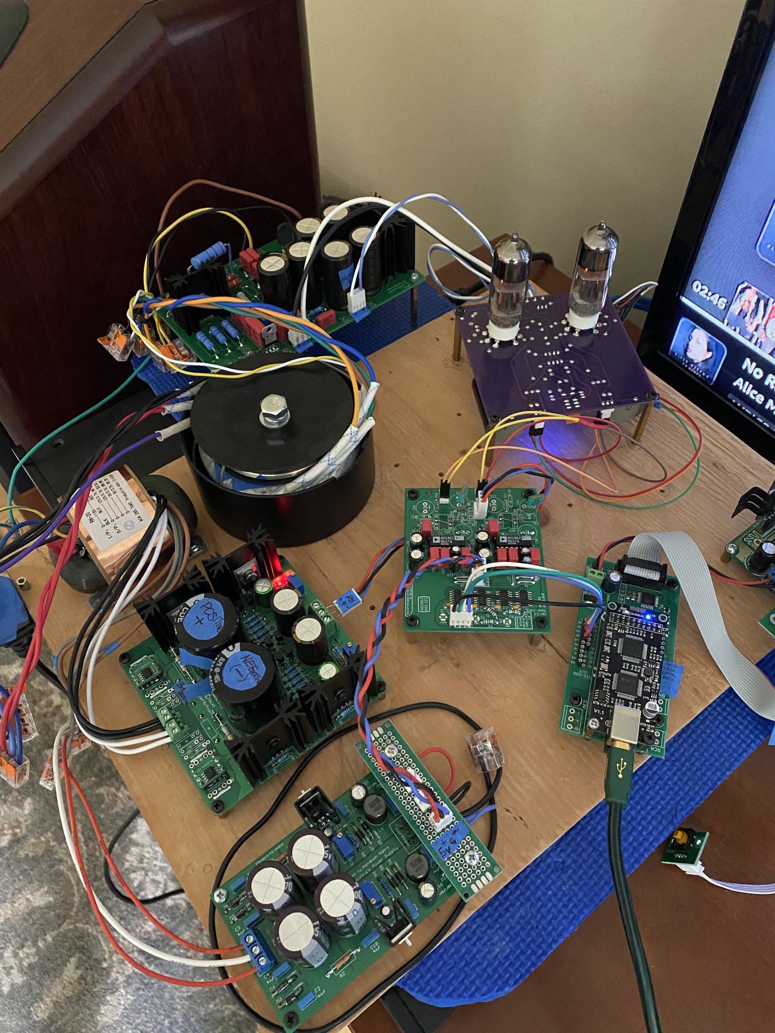

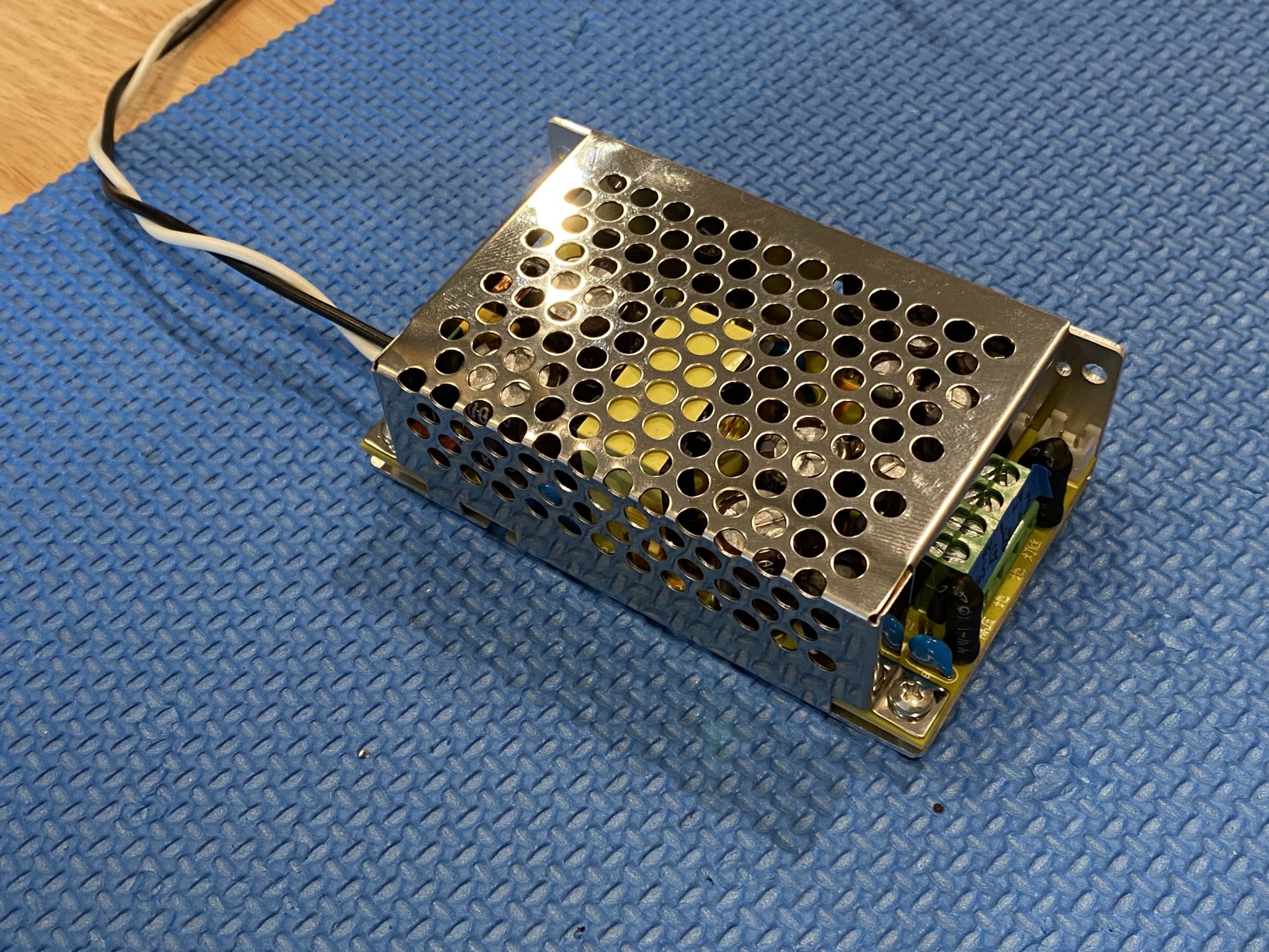

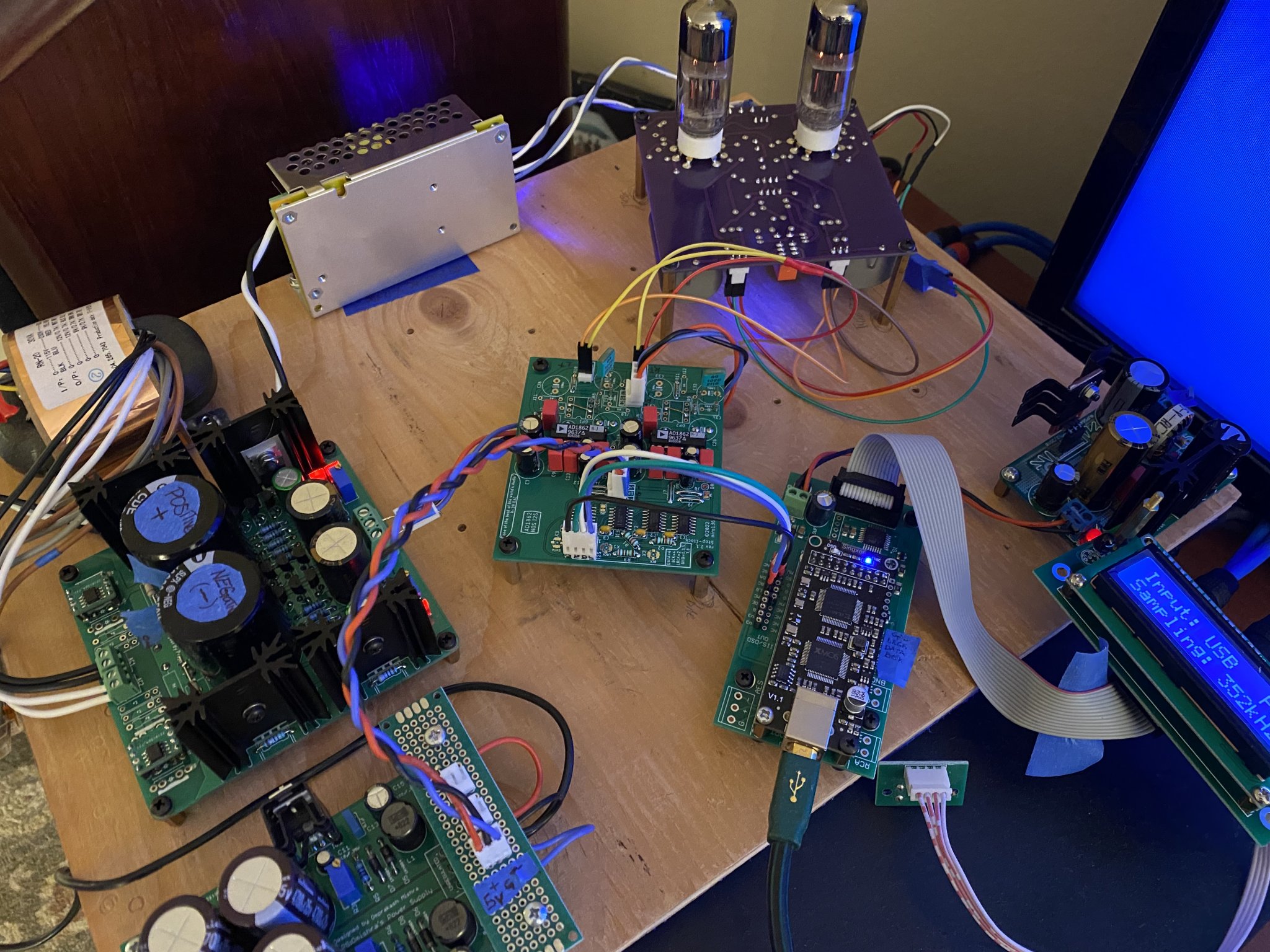

Your pcb design is sounding very good as my AD1862 dac output stage configured for SRPP with 6n6p tubes and a linear psu.
I had high hopes for the imported little SMPS but it didn’t work out. I was getting an audible low frequency warbly tone plus higher frequency noise heard from the tweeters. I swapped out the SMPS and replaced with a regulated linear HV/LV supply and voilà!! Dead silent background and sounds very good to my ears :spin:.
Thanks again Koifarm!
