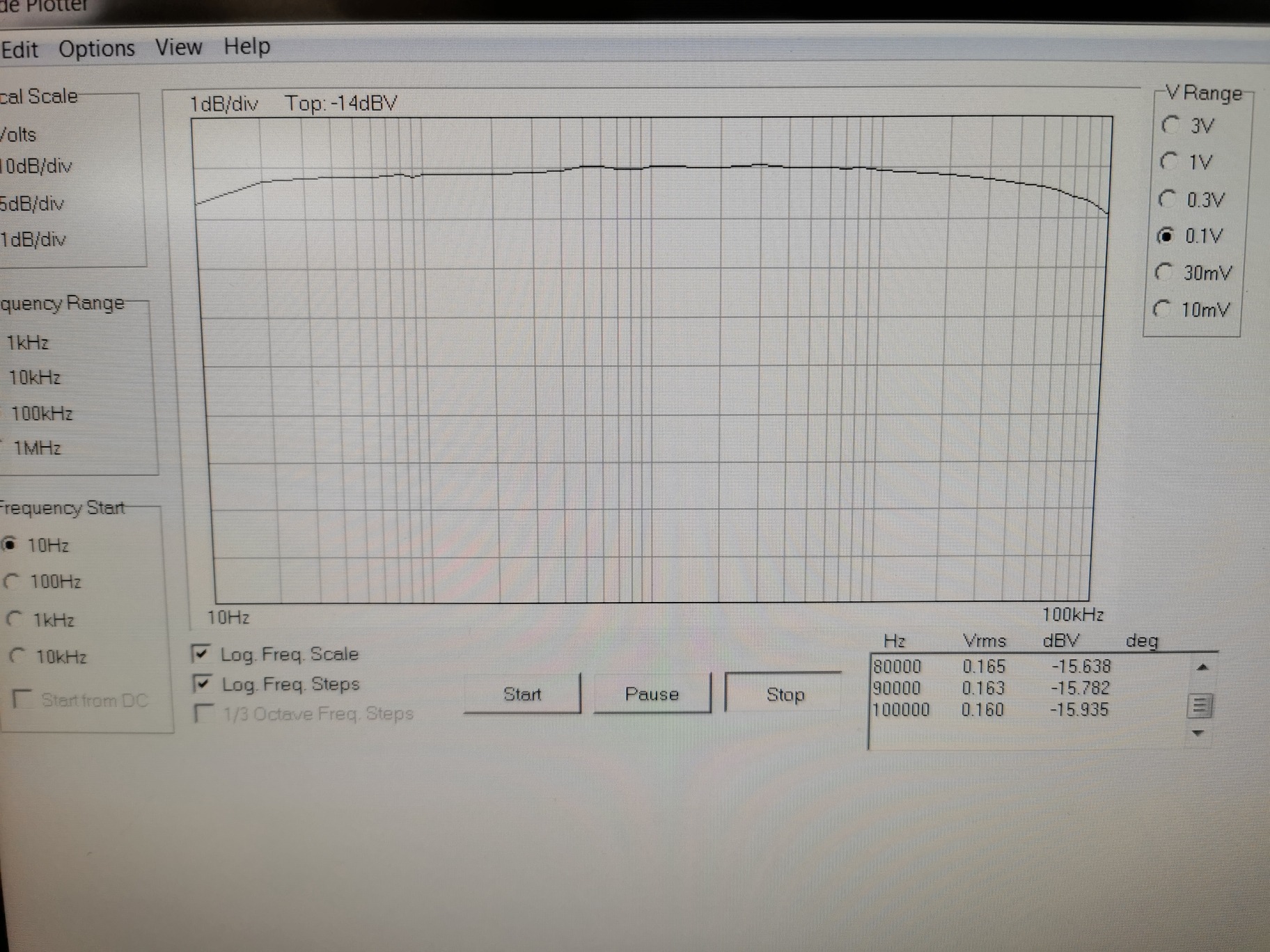

Enough time has lapsed where at least a few of us will have built this 'universal tube preamp'. If you have, please share your impressions and experience with the rest of us.

I first used this recommended SMPS, it was very noisy and a piece of junk, don’t bother.
https://www.aliexpress.com/item/1005001407107303.html
Then I used a conventional linear psu and this preamp board sings beautifully.
Yes linear is better.
I have no noise with this

I should know in the next couple of weeks.
Some resistors I put on the other side. I like the idea of the warmer resistors to be on the top of the pcb instead of under.
Some cotton I have to remove I see from the pics.

Vunce, are you able to share the details of the linear power supply that you are using?
I posted my setup back in 8/22, there are several posts and then a spin-off power supply was created/revised. Not sure if that one got built and verified to work correctly.
I believe the eBay member is HVForless that the psu board I used was originally created by.
