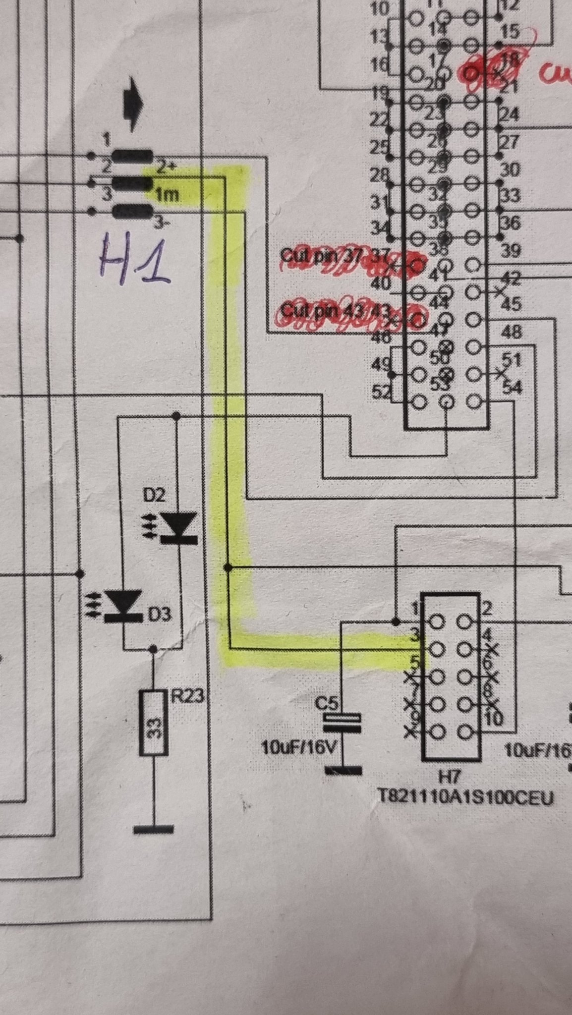

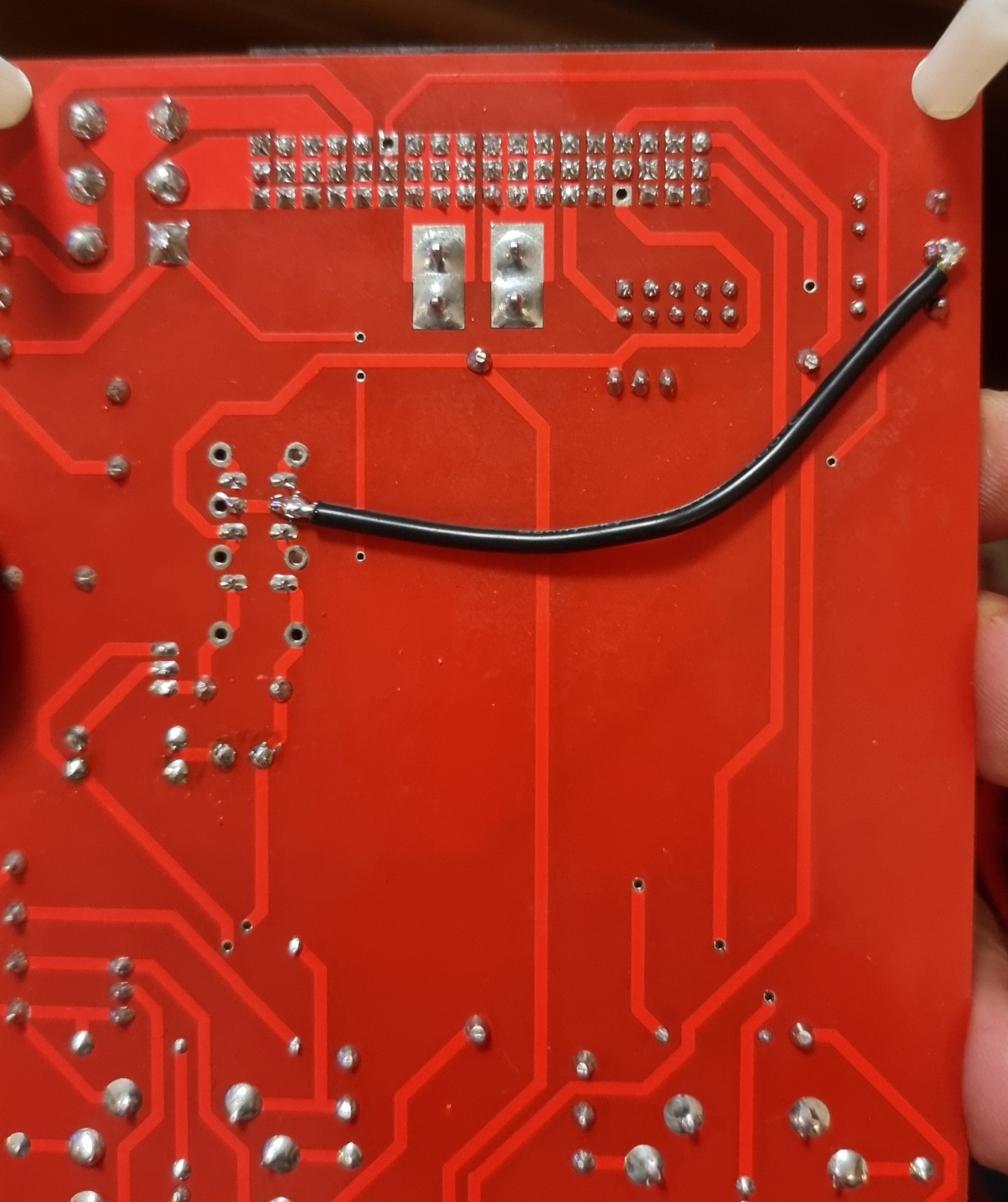

I found the problem!
One ground trace is missing on the pcb, so pin 37 40 4143 46 49 52 were not grounded... Incredible nobody got the problem before 🤔
Anyway finally working 👍👍👍👍👍
