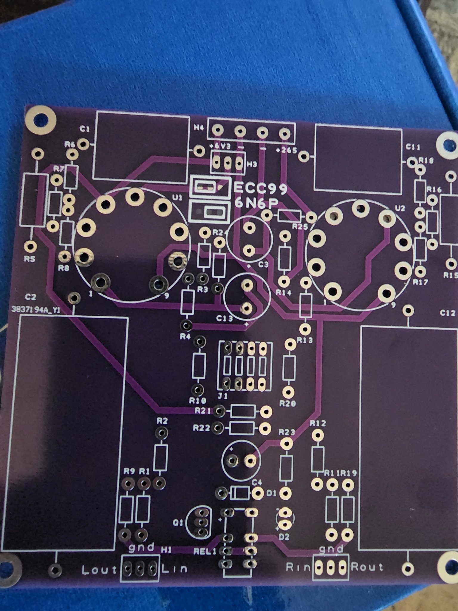

Universal tube preamp PCB, ECC99/6N6P/ECC88/ECC85/6922/6DJ8 etc. MU follower or SRPP

BTW I do like your design so no negative criticism except a few quibbles like lacking volume control and PSU. Nice design.

I just realised there has been no discussion about heater elevation and looking at the schematic the heaters are floating unless you connect one side to HT0V somewhere. With many of the tubes you could use in this circuit, their Vhk spec is may be low for the upper triode if the heaters are grounded with a 265V HT voltage. The normal solution is to elevate the heaters to around 25% of the HT voltage.
Cheers
Ian

I am aware about the specs for elevating the heater supply. But as Jeam Paul stated my SMPS share GND between anode and heater supply. Luckily it is forgiven by the 6n6p tube.
Yes, some tubes will be OK others may not. You need to be careful with a regular 6DJ8 for example because the two triodes have different Vhk specs, but if you use an EH6922 instead you should be OK. Just something to be aware of.
Cheers
Ian
Reproduce luxman cl34 heater supply and heater wiring It's totaly silent and it has a small secret that will help you every single time you meet weird constraints! By the way...you can go opposite way too, lowering the fillament potential below ground!

In reading the SMPS operation description, the HV section has a turn-on delay of approx. 30 seconds behind the filament heater turn-on. And the HV has an adjustment range of 10% (approx. 247V - 273V). Will cattle be powered from it? :rofl:
Can you confirm if this is accurate?

A package arrived in the mail today
Looking forward to building this up and testing it. Plan is to build as SRPP for 6DJ8s
