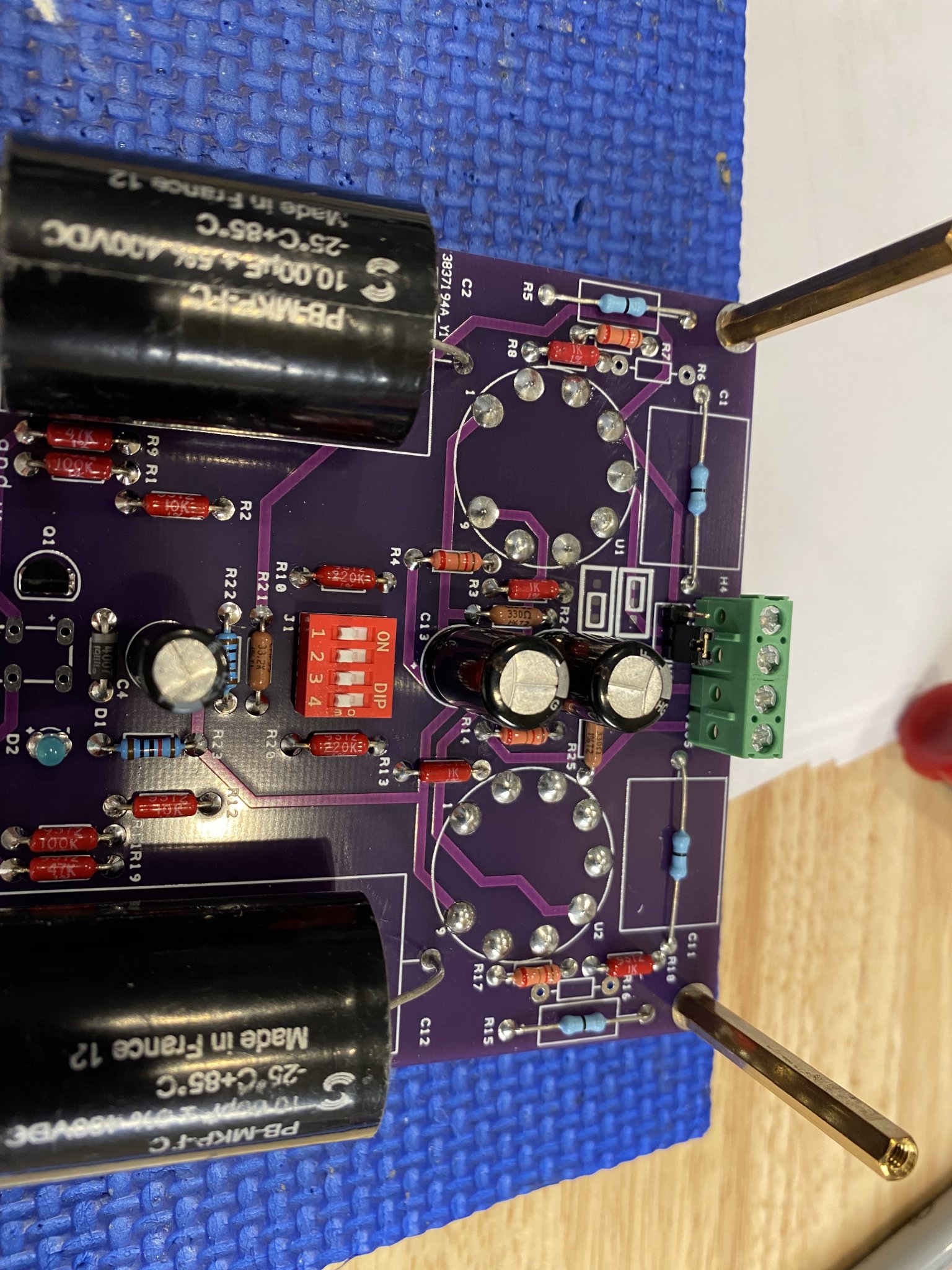

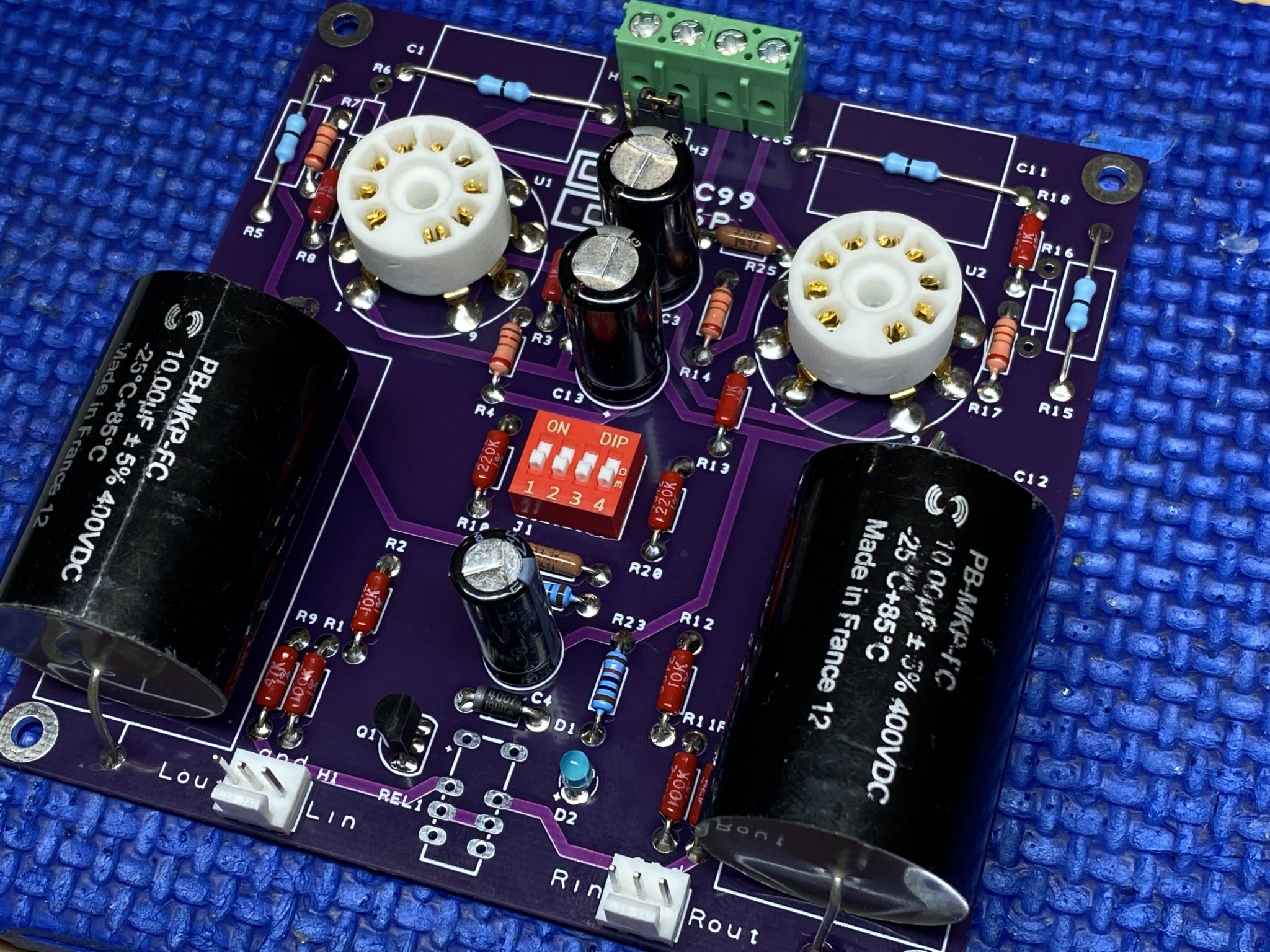

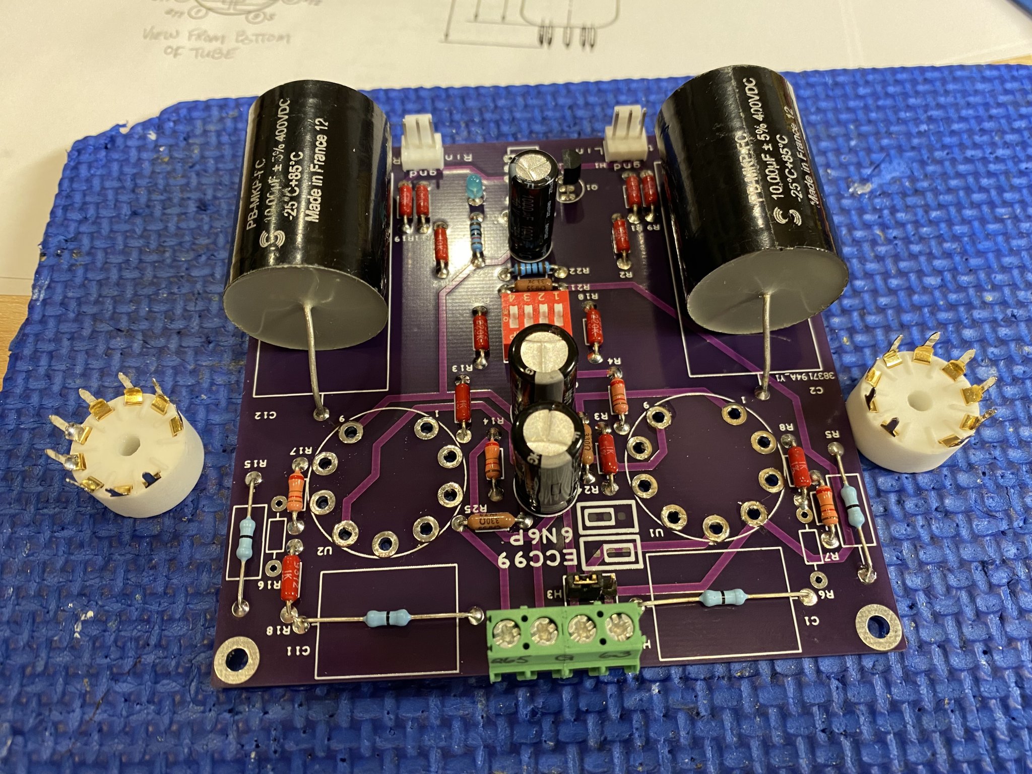

Hi Vunce, hope you have a good desoldering iron - as shown in your photo, you have pin 1 of the tube socket soldered to pin 9 land on the board - yes you need to have the tube socket on the back of the pcb. This enables the pcb to be slung under the lid with the tubes protruding above the cover, which is better for cooling and also allows for easy tube rolling. Otherwise, your build is first class.
