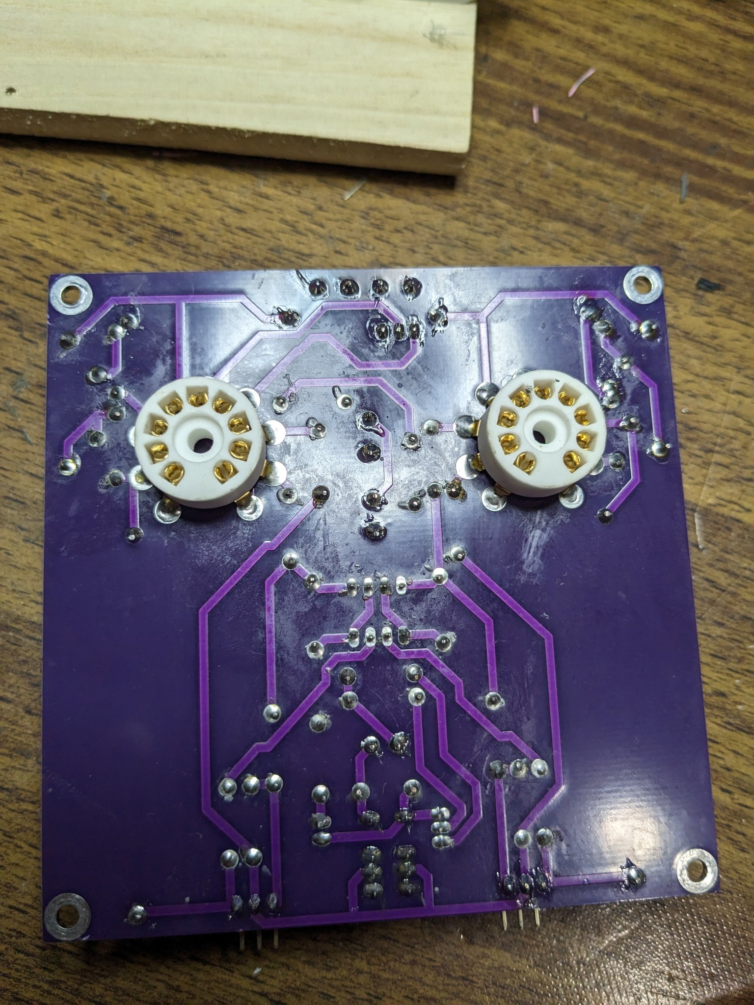

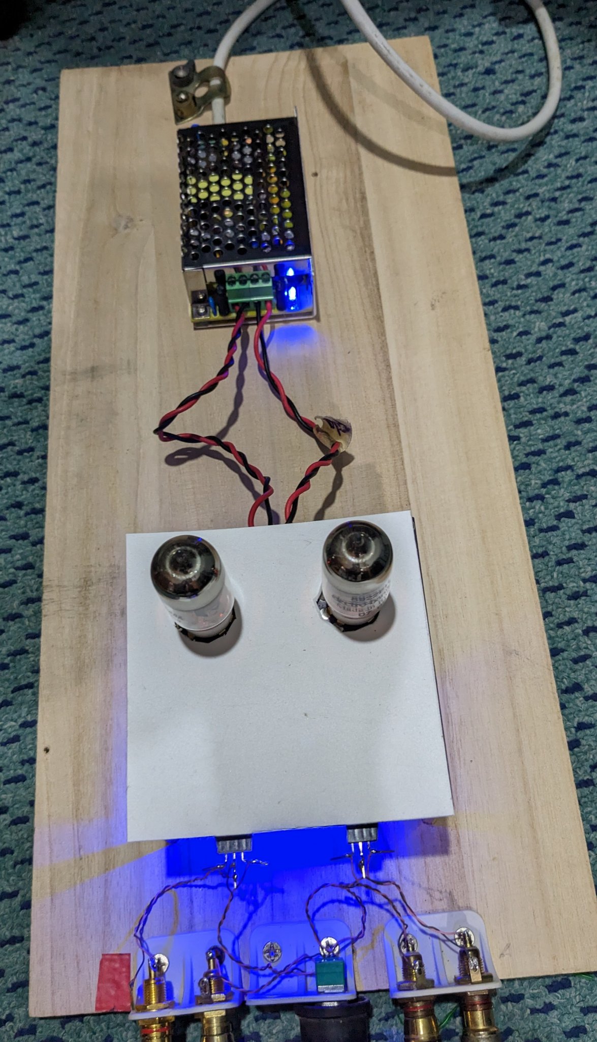

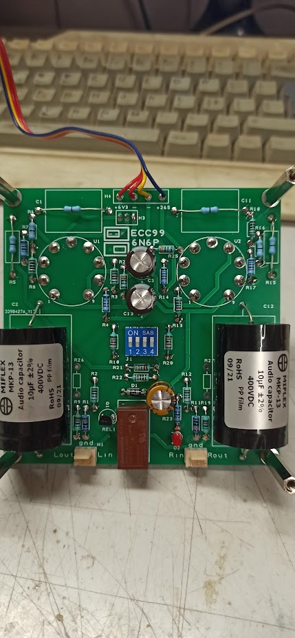

Finally completed the project.
Nice sound. No hum. Quiet and great soundstage . By the way, how to remove the solder resin effectively?

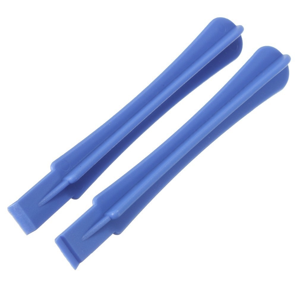

First I try to remove the most of the dried resin with a hard plastic stick.
Then IPA and a toothbrush
Then IPA with cotton swab.
Then IPA almost a rinse with a light paintbrush...to remove the remaining residue.
Quite time consuming. But I enjoy the process. I just can't stand dirty pcb's
