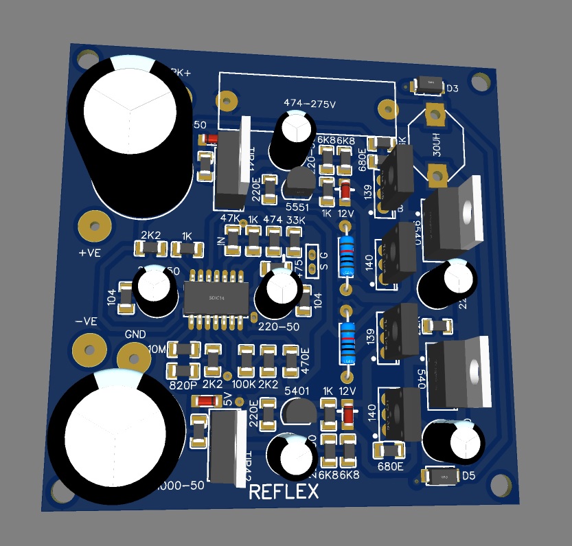

looks nice , please replace all 220ohms resistors with 1/2 watts ones . the 0805 or 0603 smd package will fail.
I made some of these but had issue with bd139/140 heating badly. Sounded quite nice but that heating issue never solved. Is there any remedy for that?
use bc327 and bc337 instead of bd , check my previous schematic

not yet sir , but any one with a good working overcurrent protect schematic . please post
Will the heat problem get resolved by using 327/337?
yes if you use it as i have posted in my schematic at post #591 . i have used up to +/-49volts without any driver heating issues
Ok thank you for the driver ossue clarification. It works as you suggested. Also i did a load testing at 45 volts. 225khz freq. Output fets went above 75deg celcius in 2-3mins and output was max 156watts per channel. What would be the problem? Load was 4.3ohms
