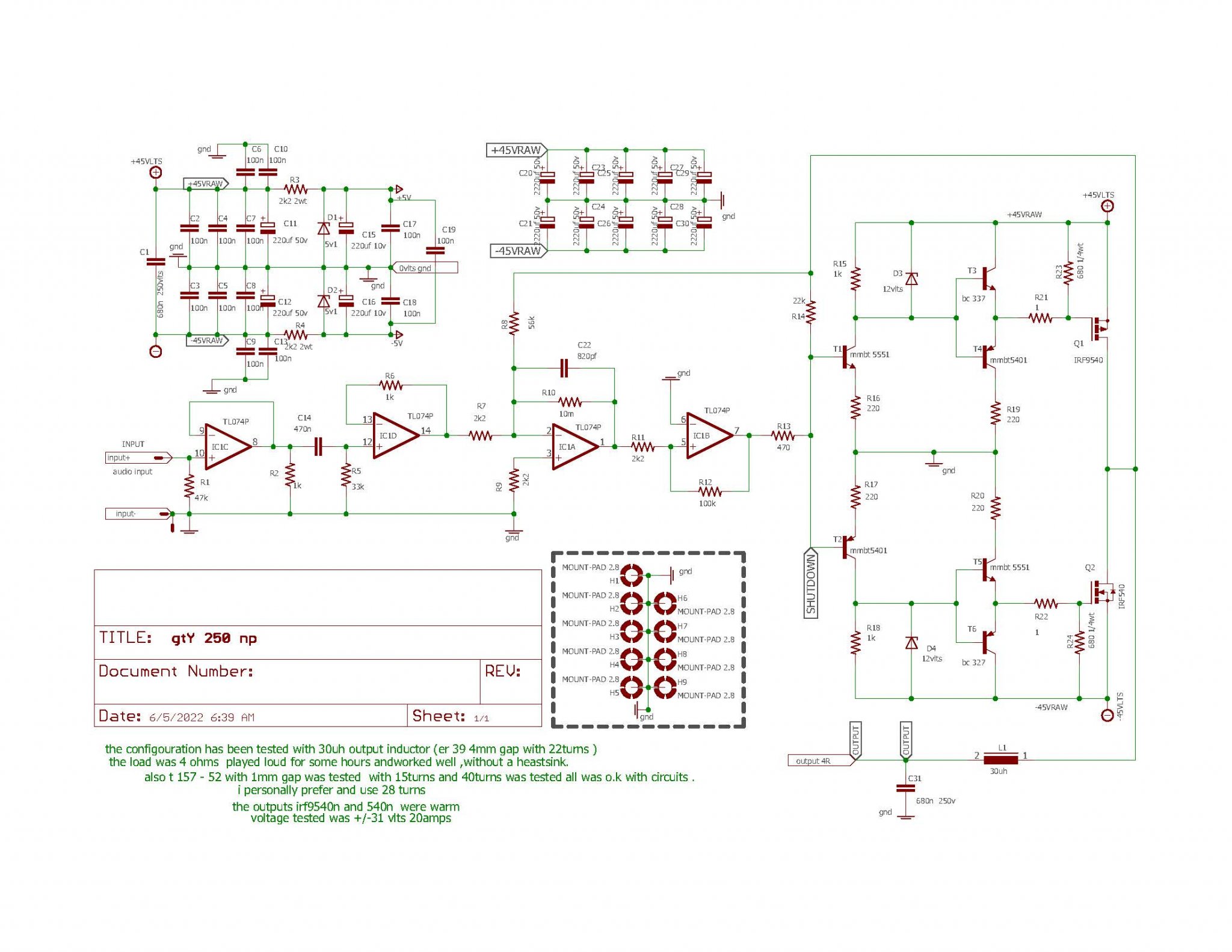

Hi Stewinhi all , kindly help me out .
will this protection schematic work?
how are you today?
are you test this schematic?
is it worked properly good?
do you have pcb file for it too?
thank you

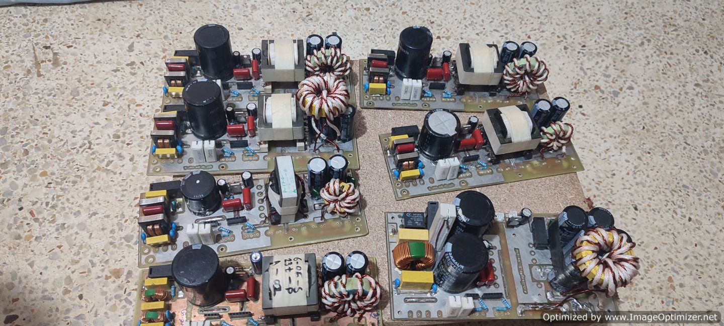

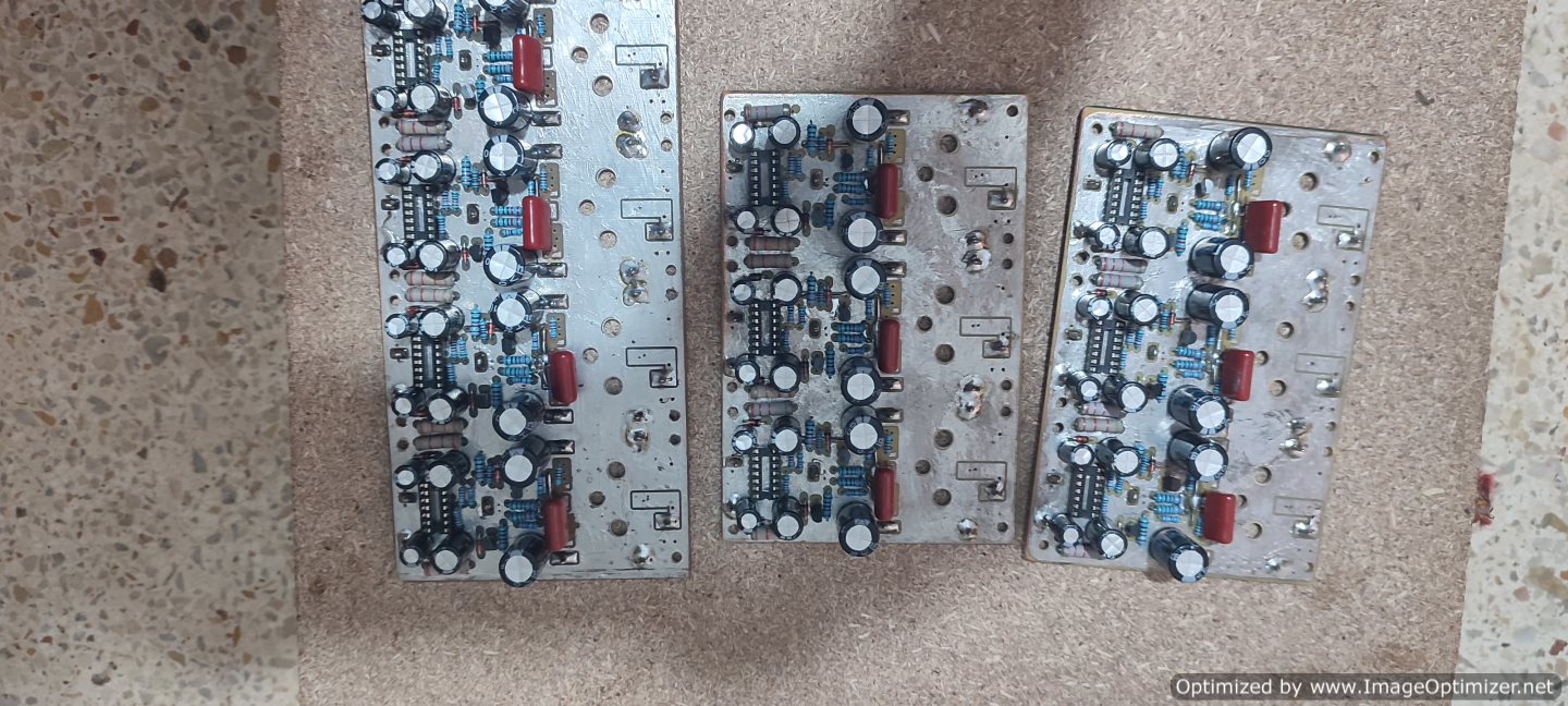

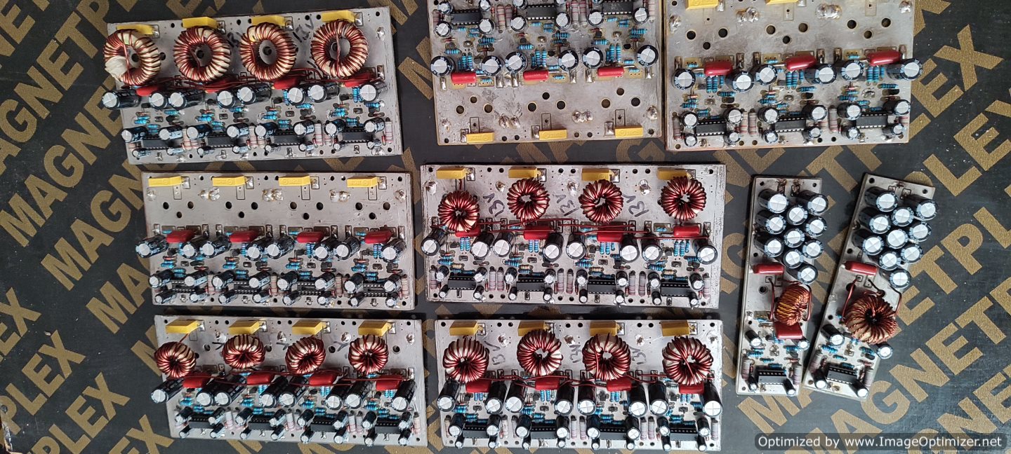

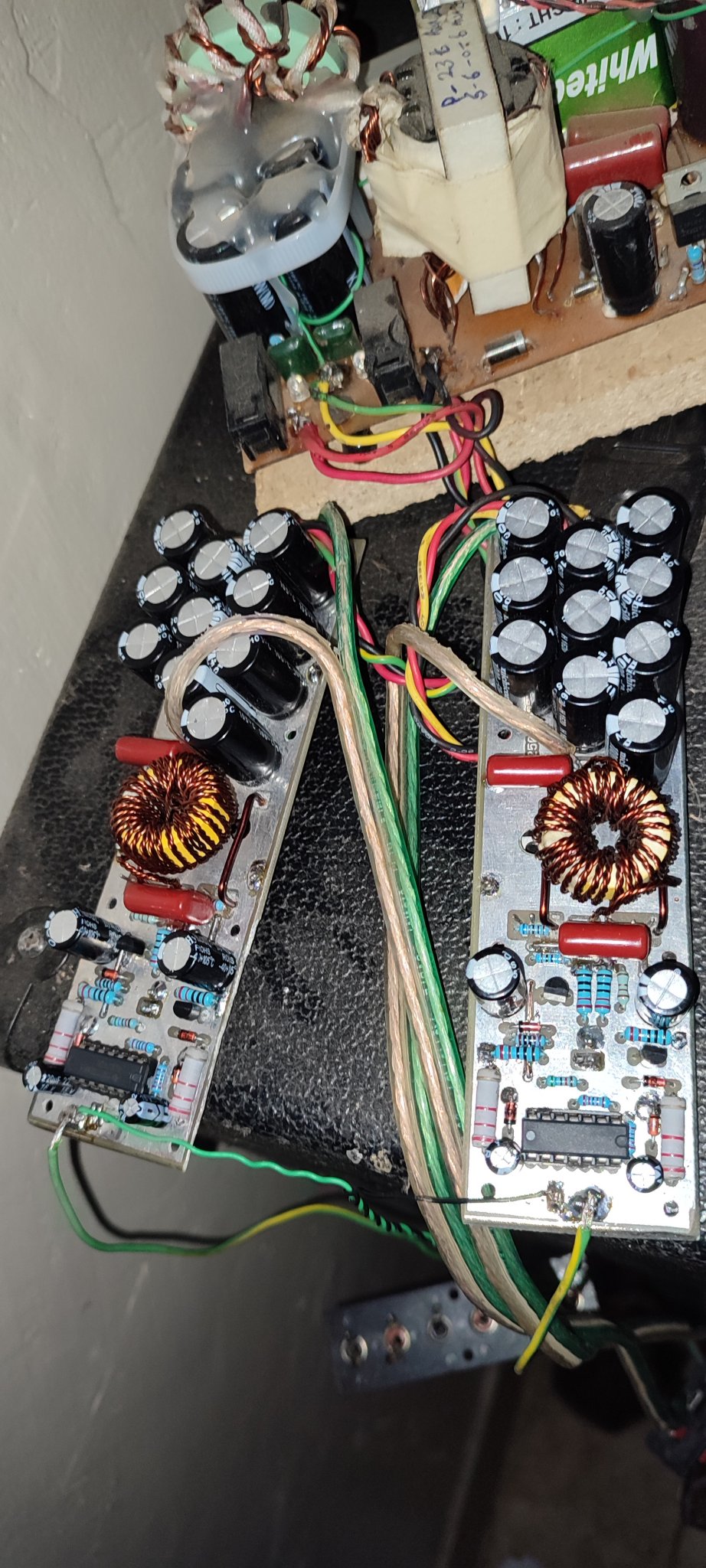

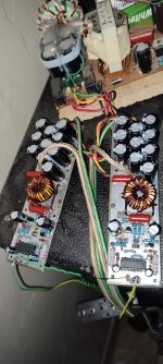

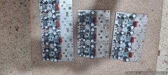

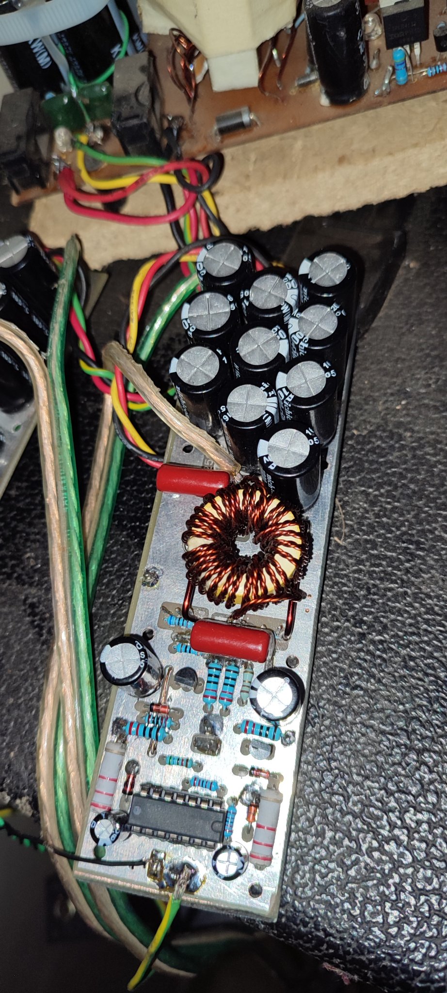

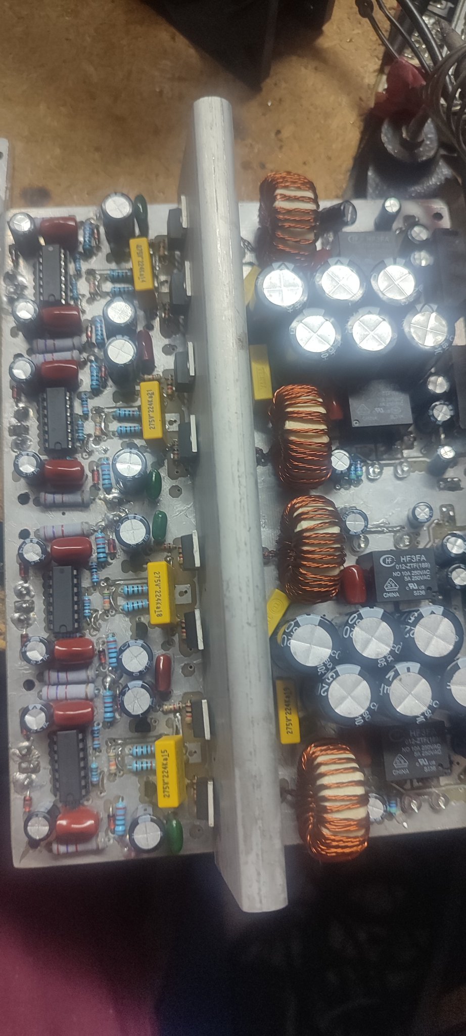

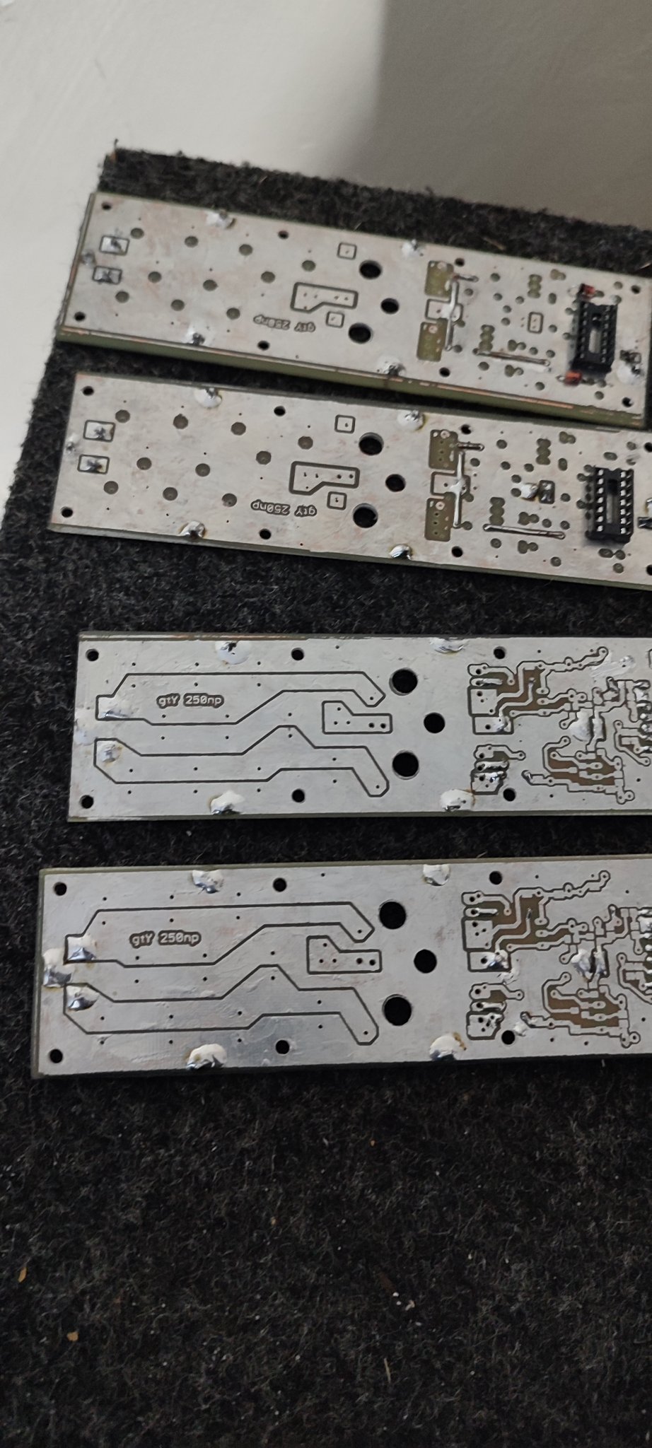

hi all , i have made another version of this amp in smd style . i have added 10caps to help in dynamic power.
The amp is working fine ,
enjoy all
kindly any opinion will be appreciated .
enjoy all

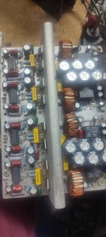

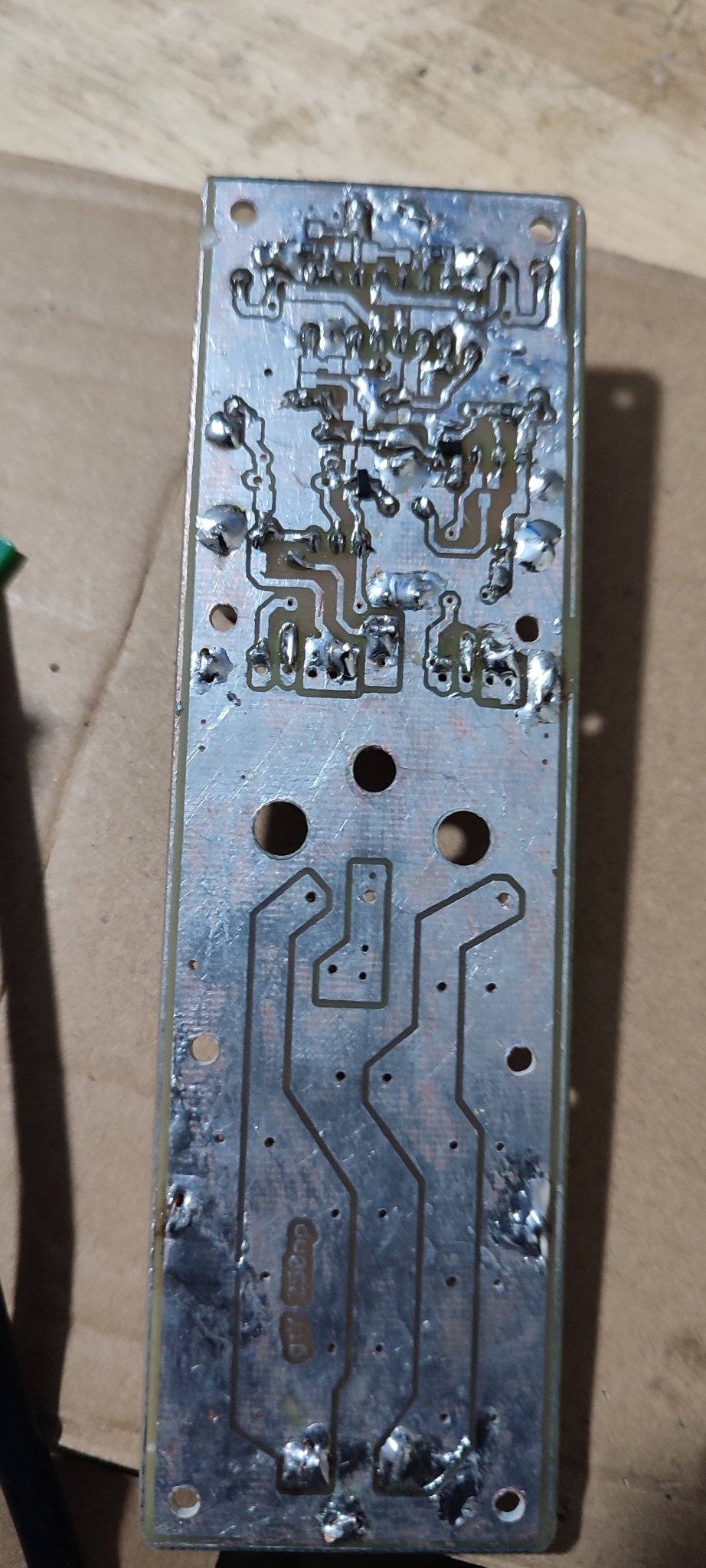

Total gate charge of these is bigger than the original, so they'll either be more demanding on a driver side, or slower to turn on and off, in which case you may expect more cross conduction and heating.
oh ok thanks sir , notedTotal gate charge of these is bigger than the original, so they'll either be more demanding on a driver side, or slower to turn on and off, in which case you may expect more cross conduction and heating.

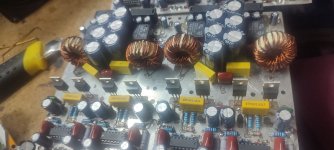

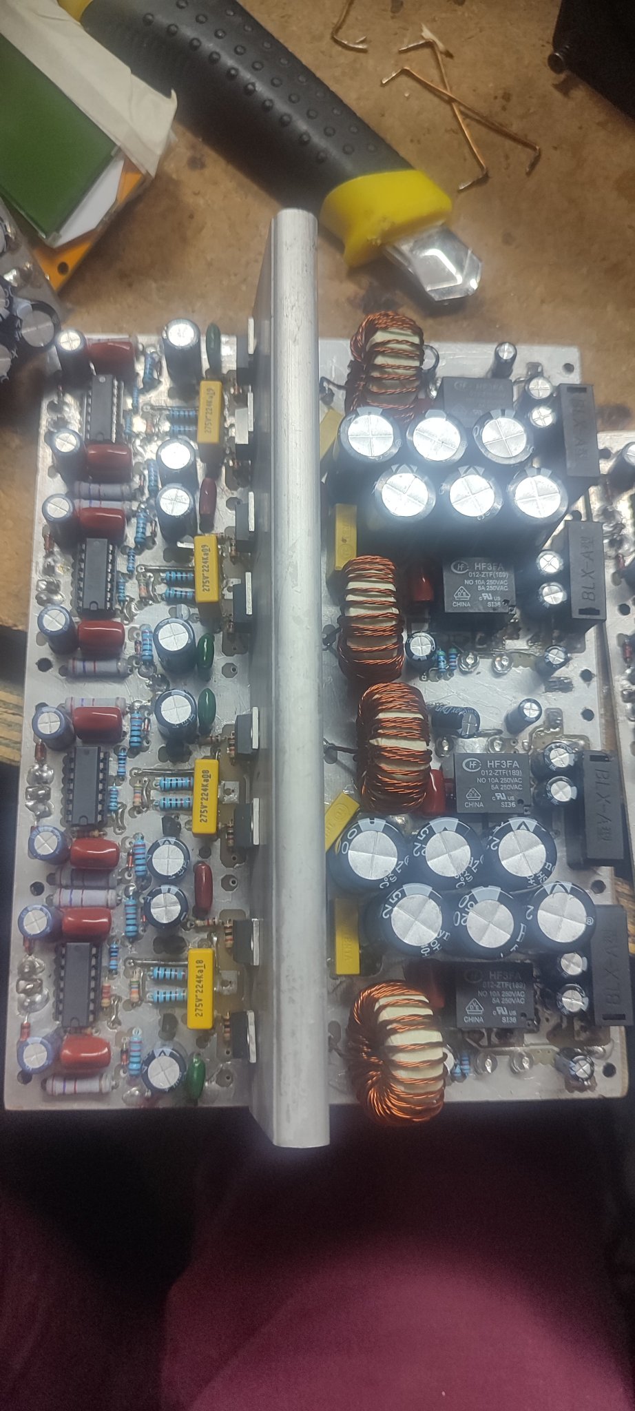

kindly provide photos and schematic of your buildHas anyone tried paralleling mosfets For this design?

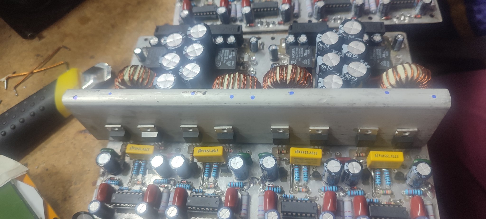

i tried to add extra irf9540 but does not work. Any suggestions will be highly appreciated.
It is same as you have used in your builds. Just added an extra irf9540kindly provide photos and schematic of your build
kindly post photos of your build, top and bottomHasn’t anybody paralleled mosfets on this one?

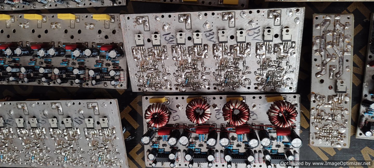

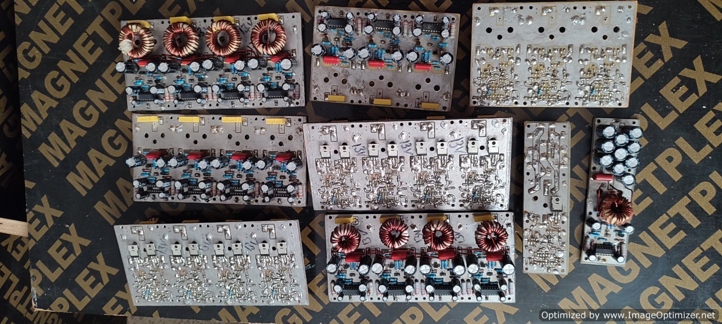

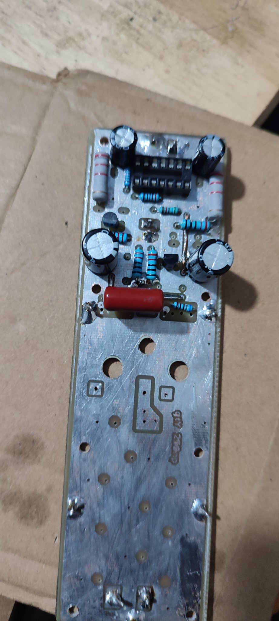

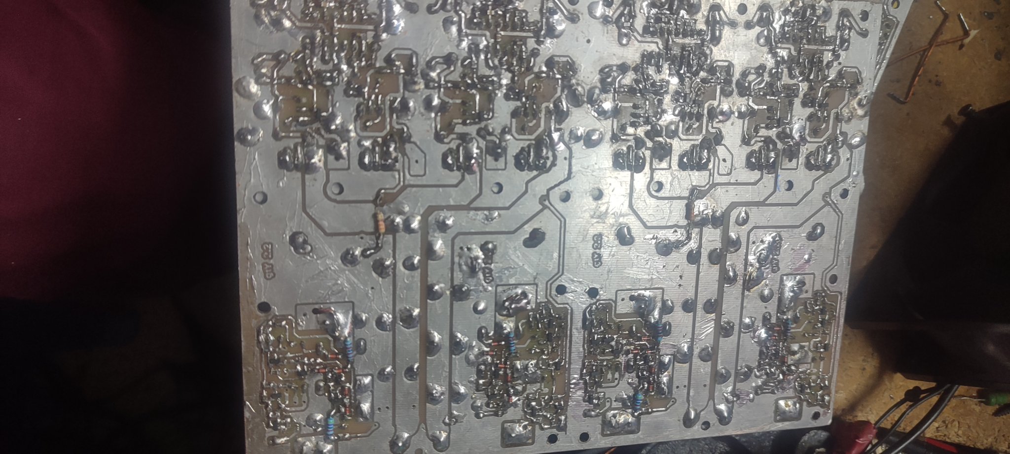

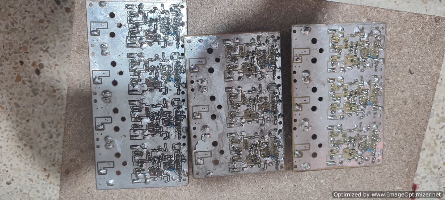

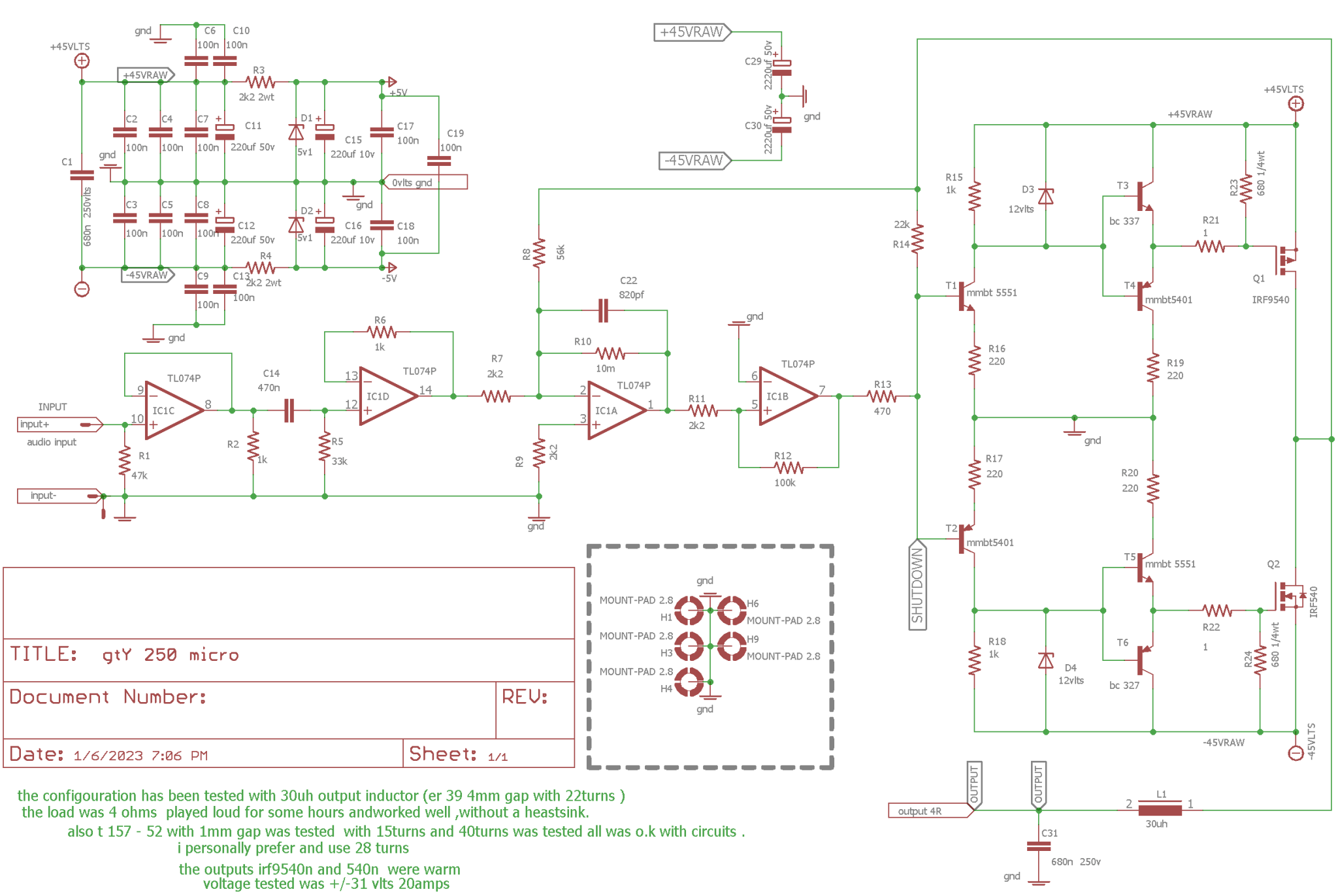

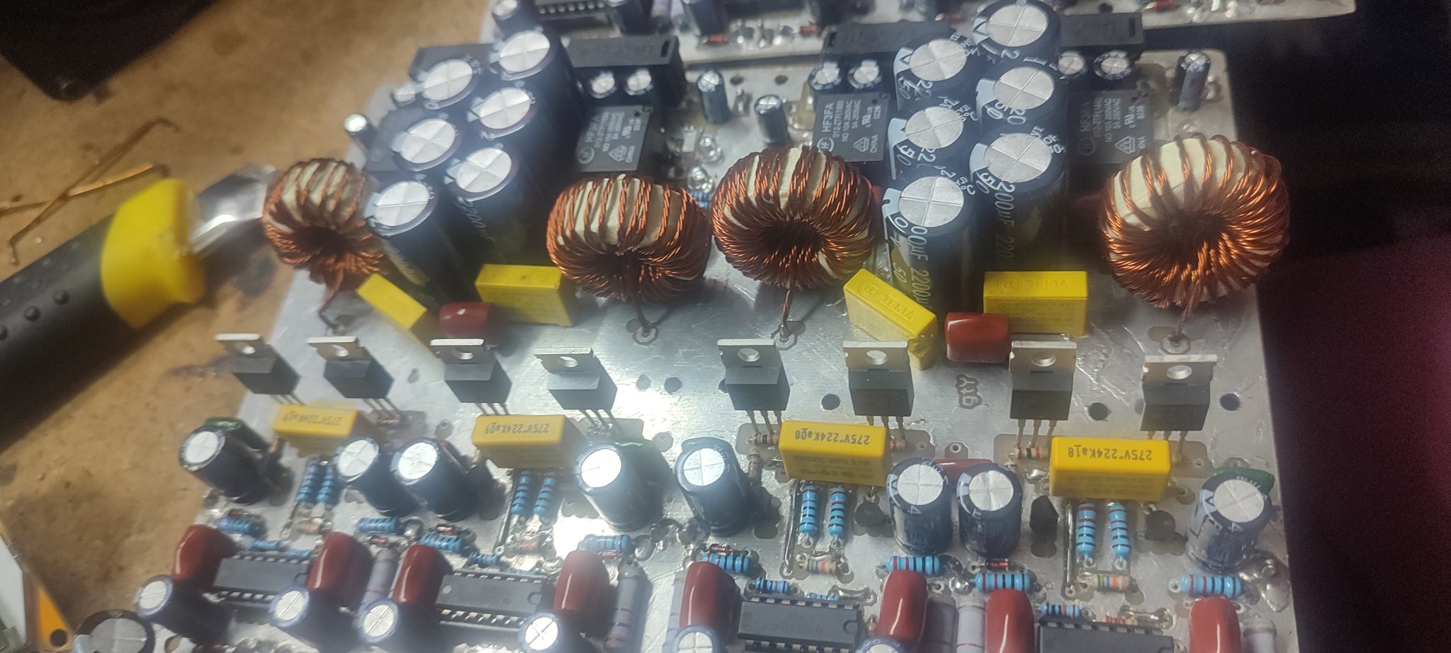

hi all i have made latest designs did not incorporate dc protect relay or many caps . it is just plain with two capacitors
all files are below have fun all

hi all can BCX53 and BCX56 used to replace bc 327 and bc 337 ? are they fast enough ?
thanks @ sweetperfume it is possible.
it is not advisable @ freedom666 because of stray inductance

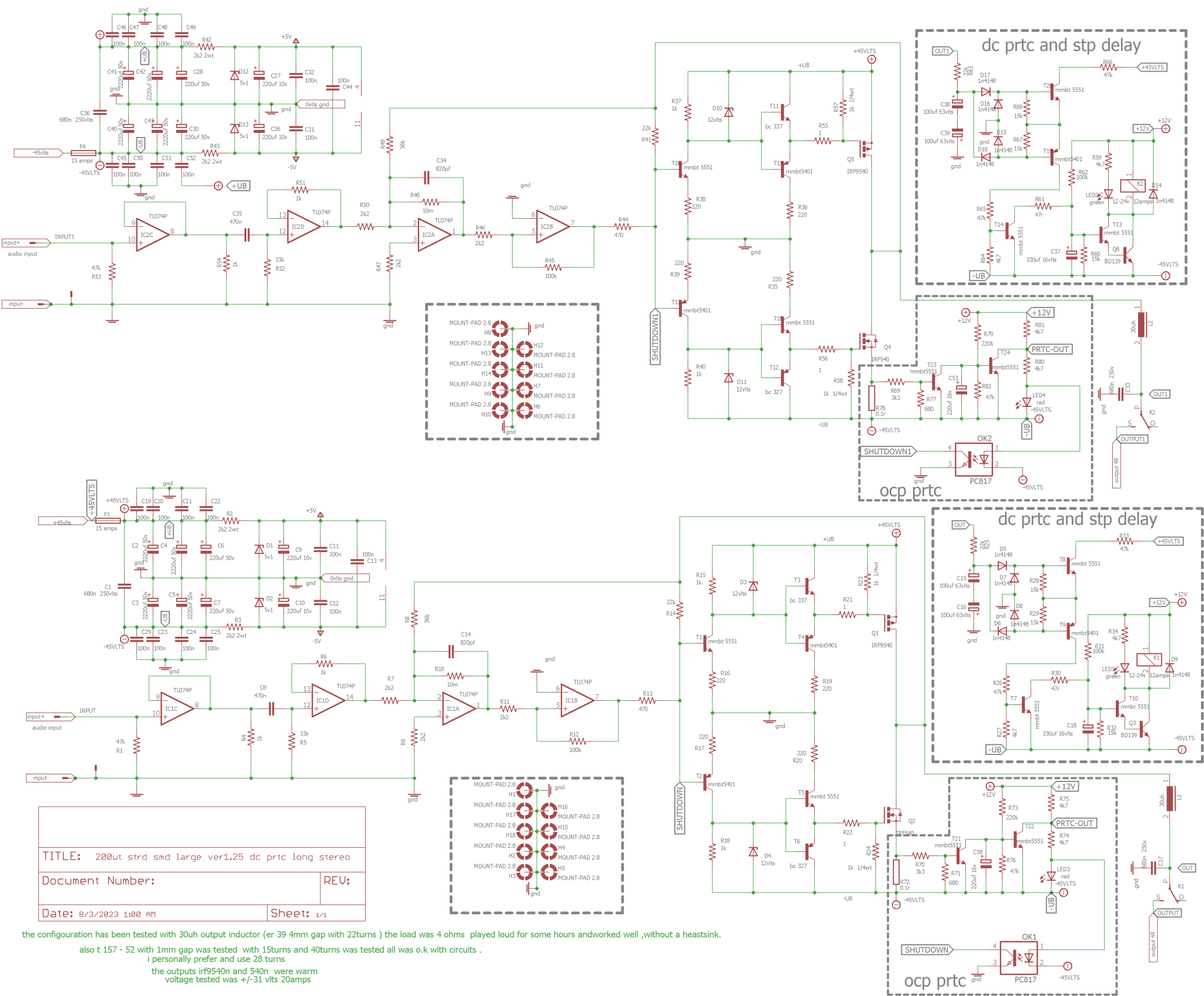

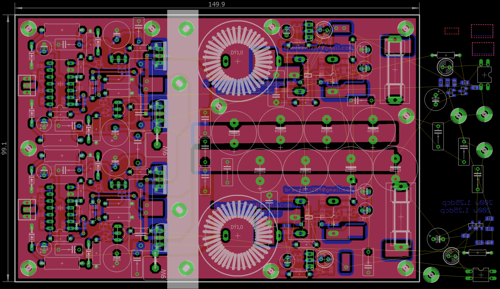

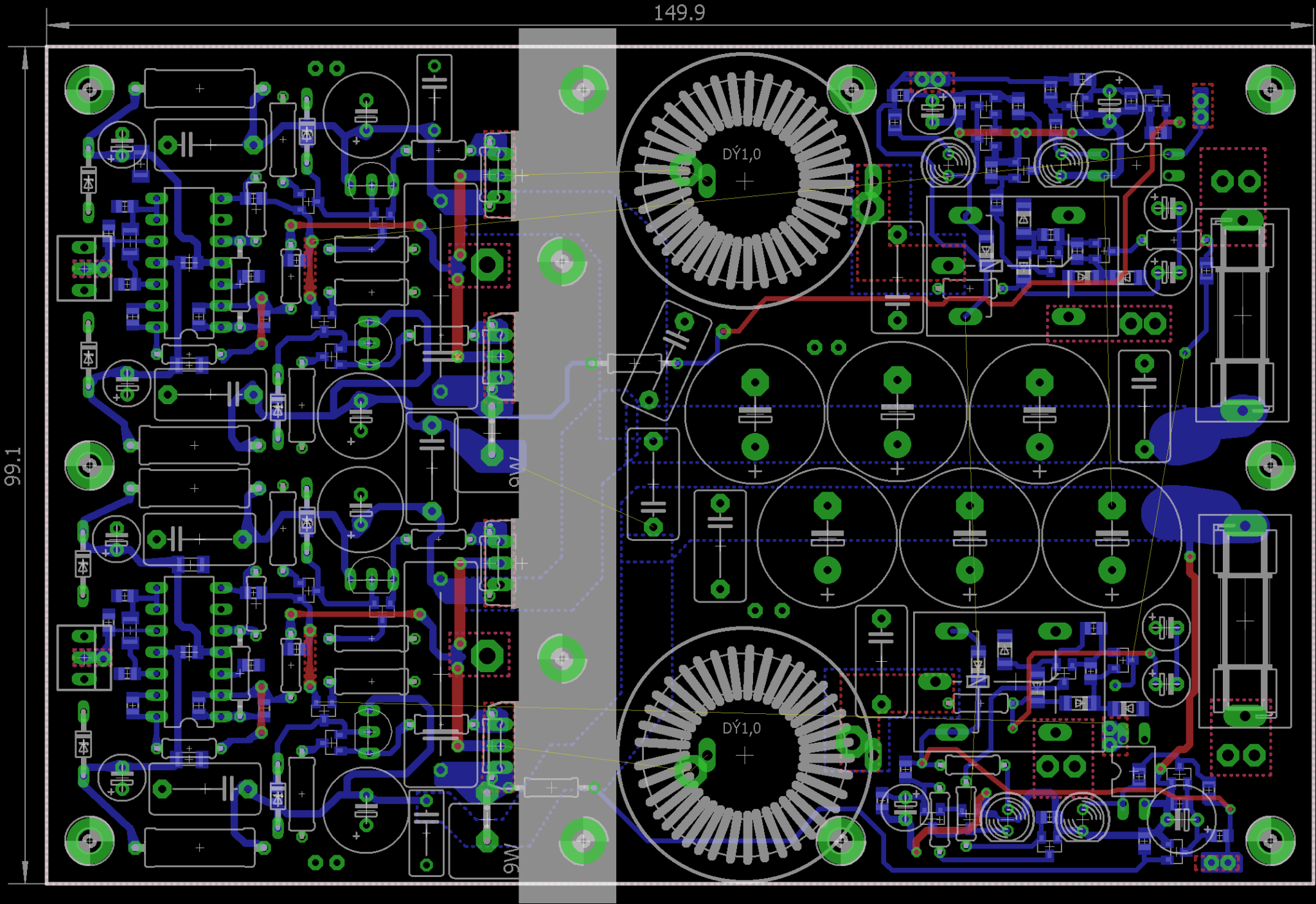

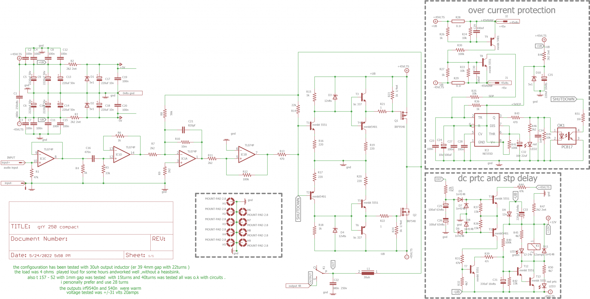

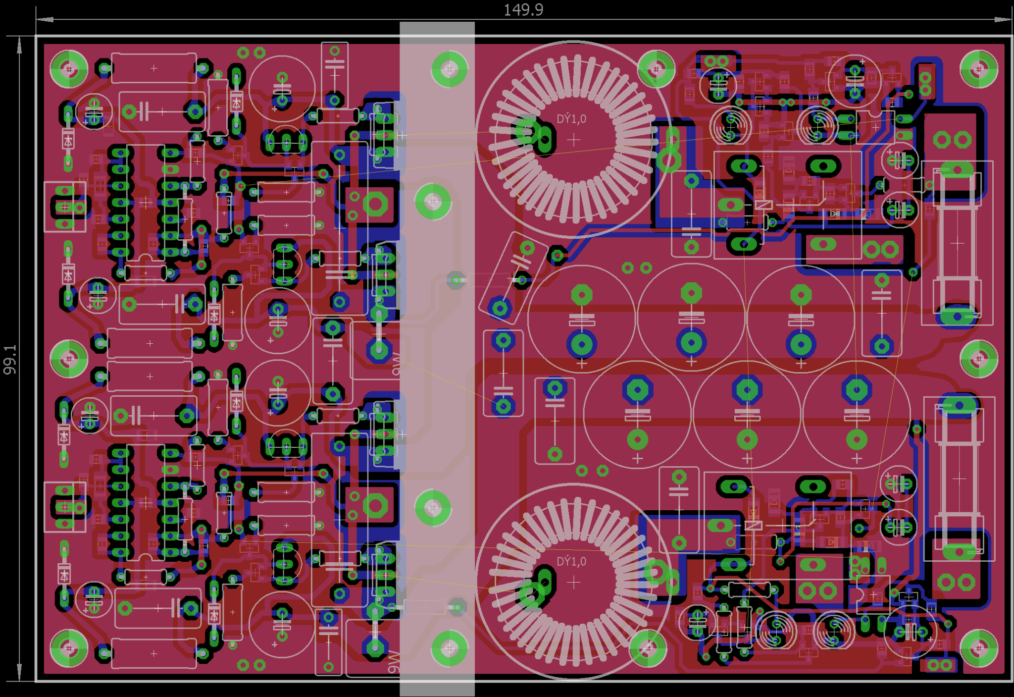

hello all ,
here is a stereo version with ocp start delay and dcp protection . your views and ideas are welcomed

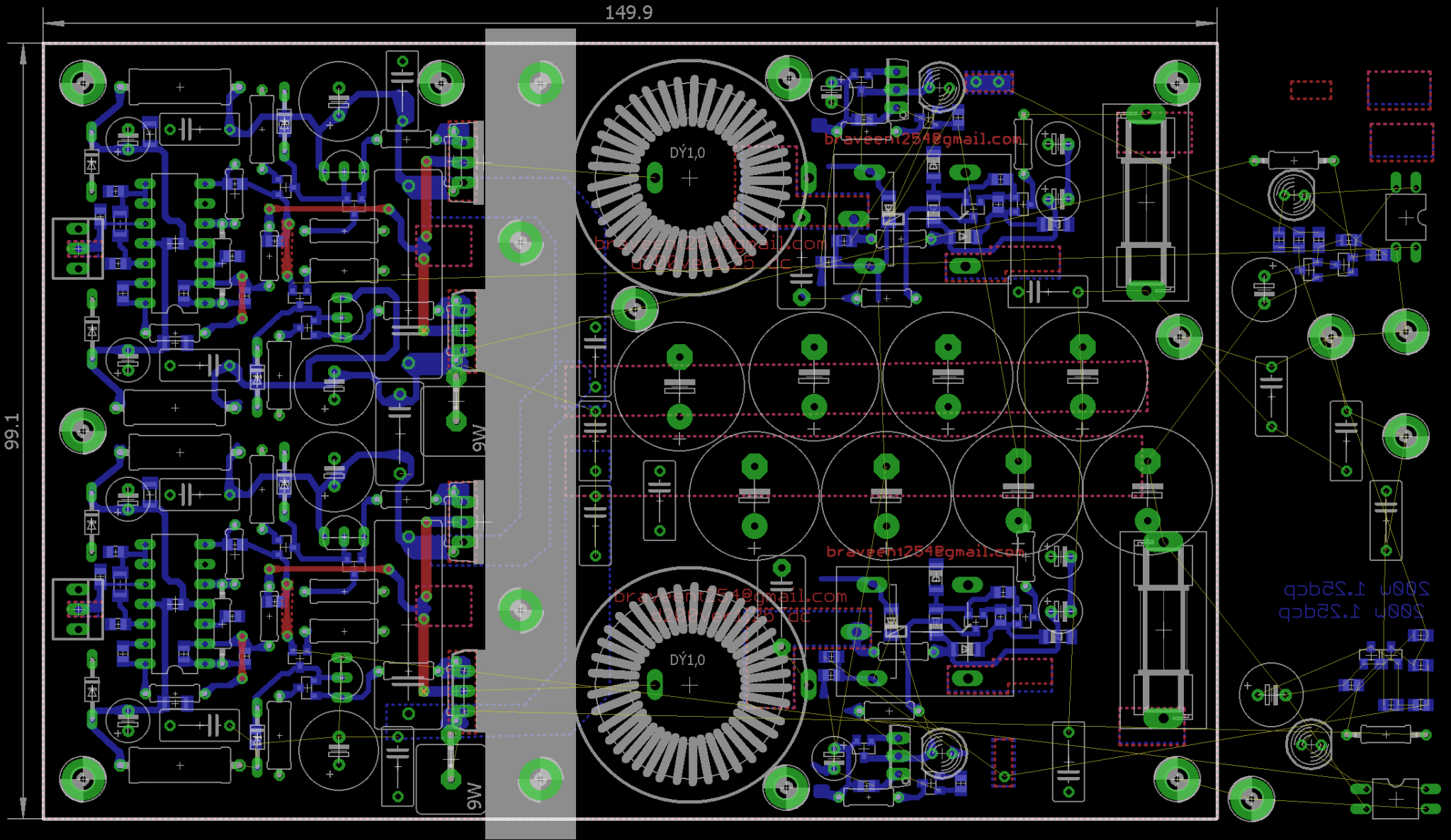

hello all completed the stereo version with relay and dc ocp protection

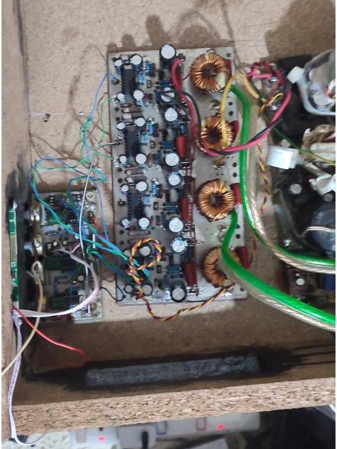

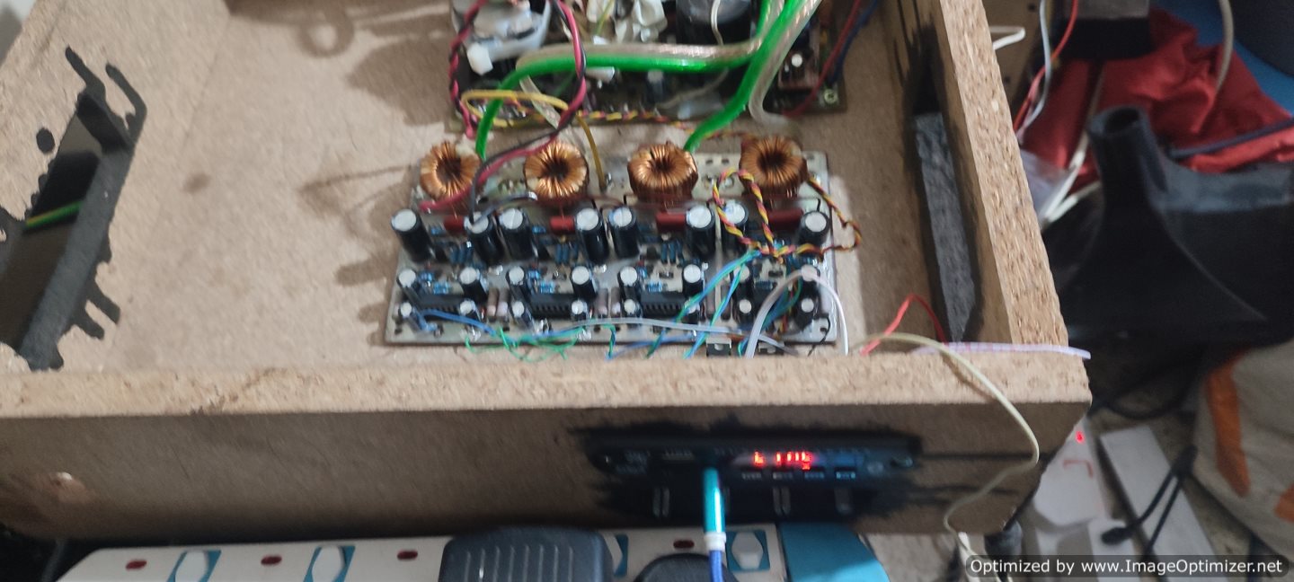

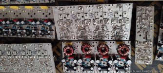

photos of the buildhello all ,
