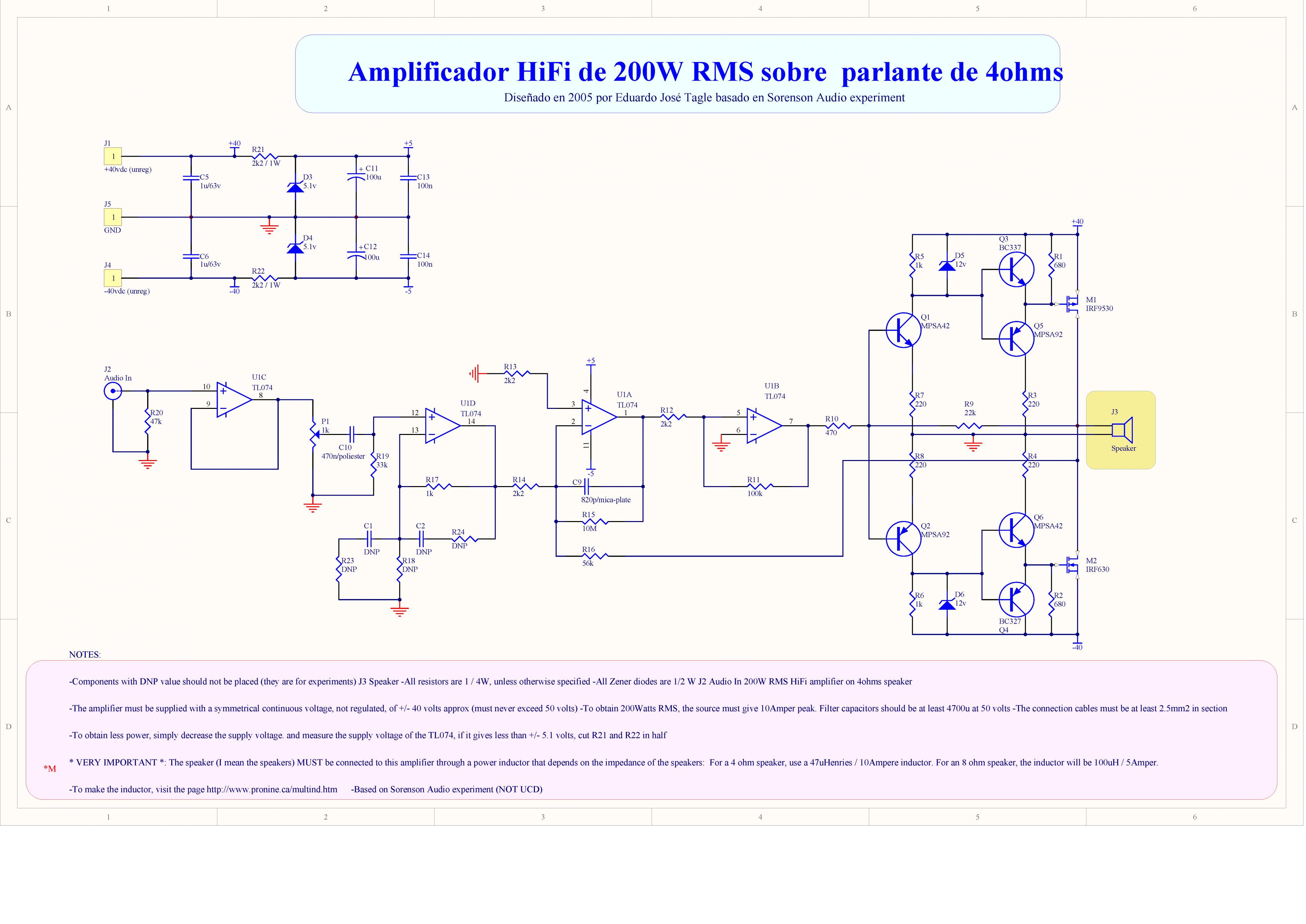

Indeed very simple, but notice that there’s no feedback loop. One has to consider its hifi-ness.

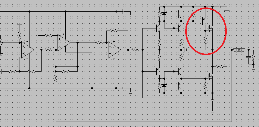

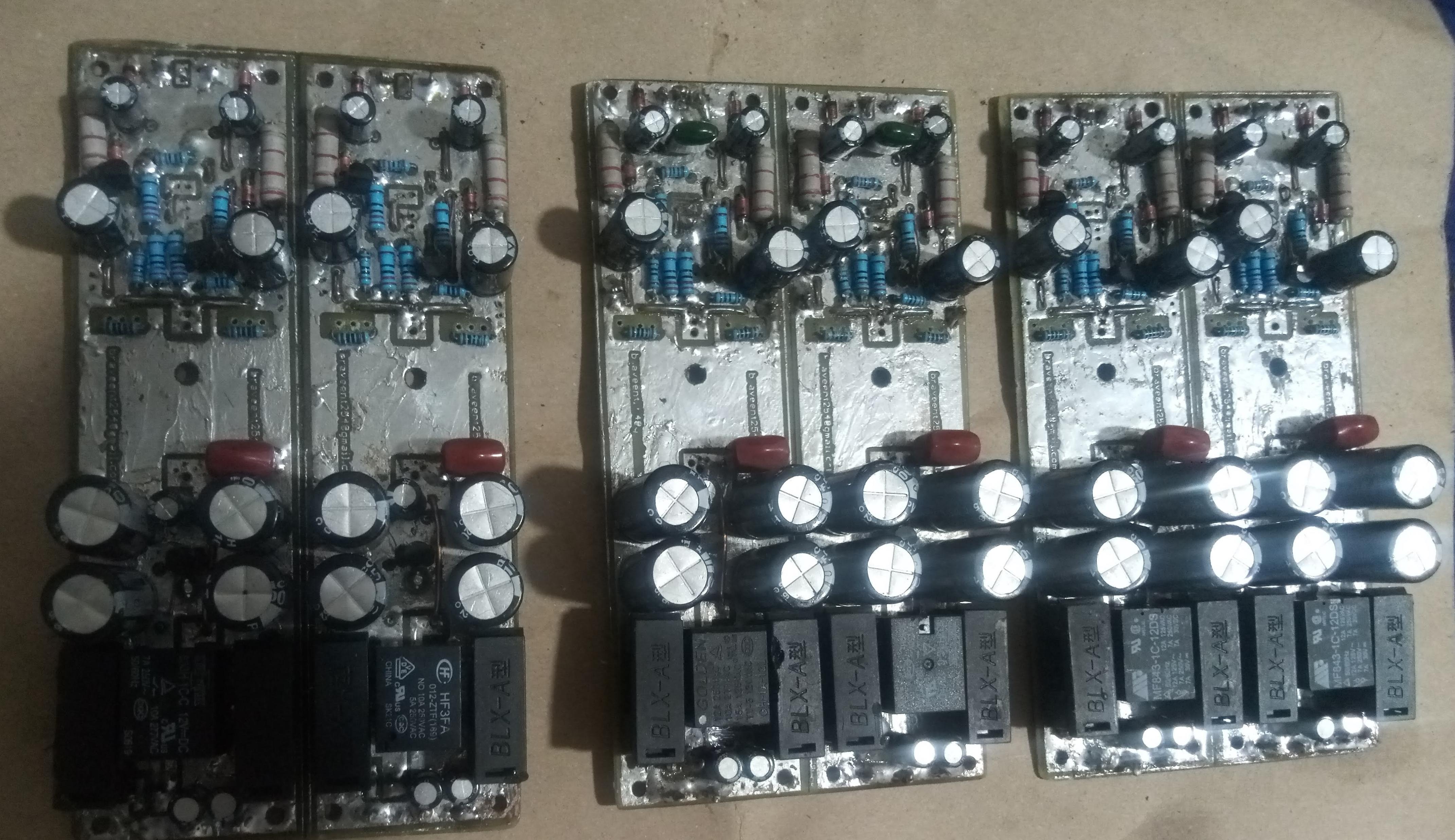

updates on my amp. firstly i rectified the transistor arrangement on the dcp section , then i removed the overcurrent protection and remained with the dc protect 😀 . (I should have used an optocupler at the ocp instead of the transistor😱. when i connected the ocp to the shutdown of the amp it had a bad noise interference.) the files below for the revised amp with only dcp
use this original schematic by etgale . it works fine .

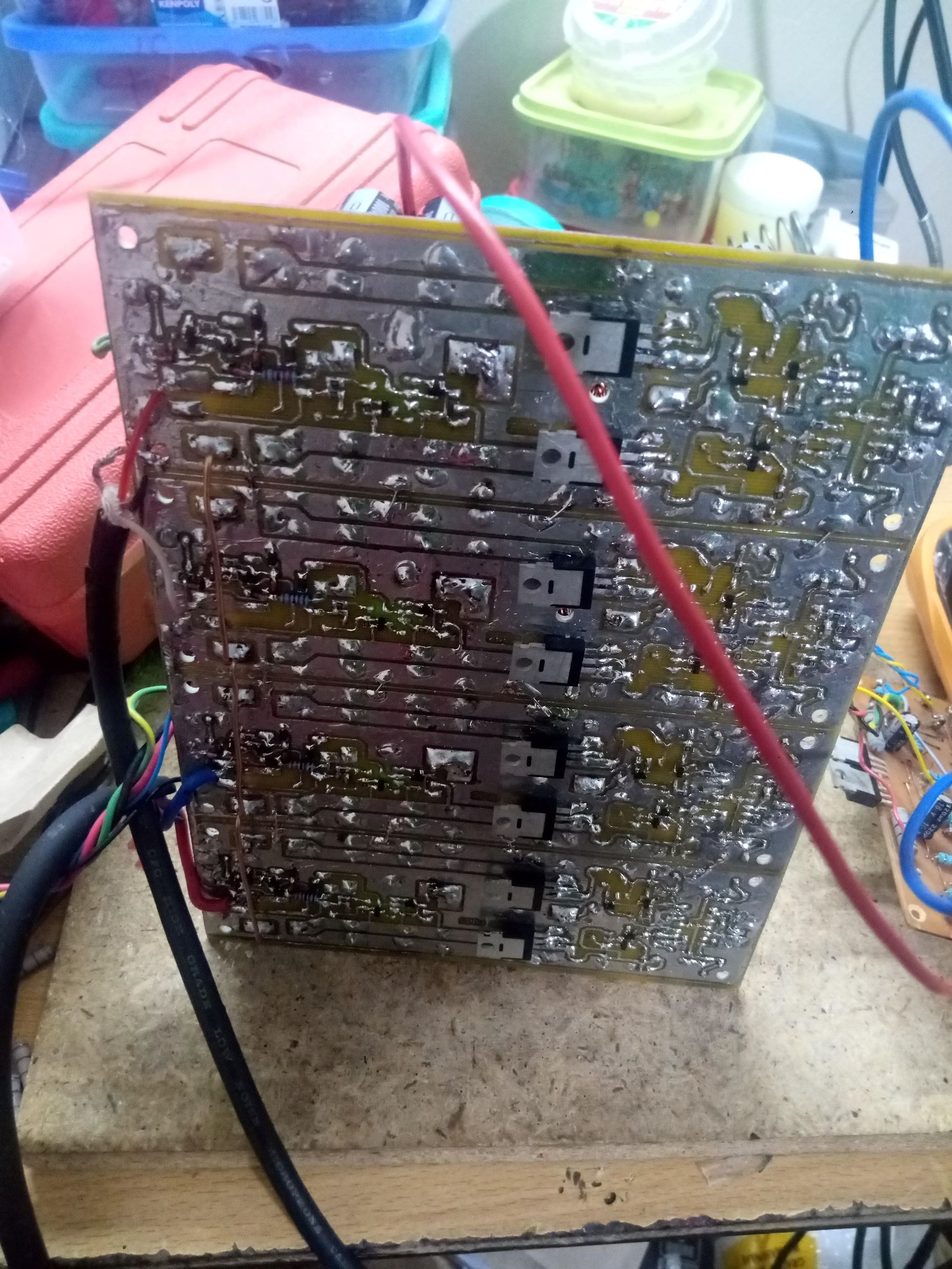

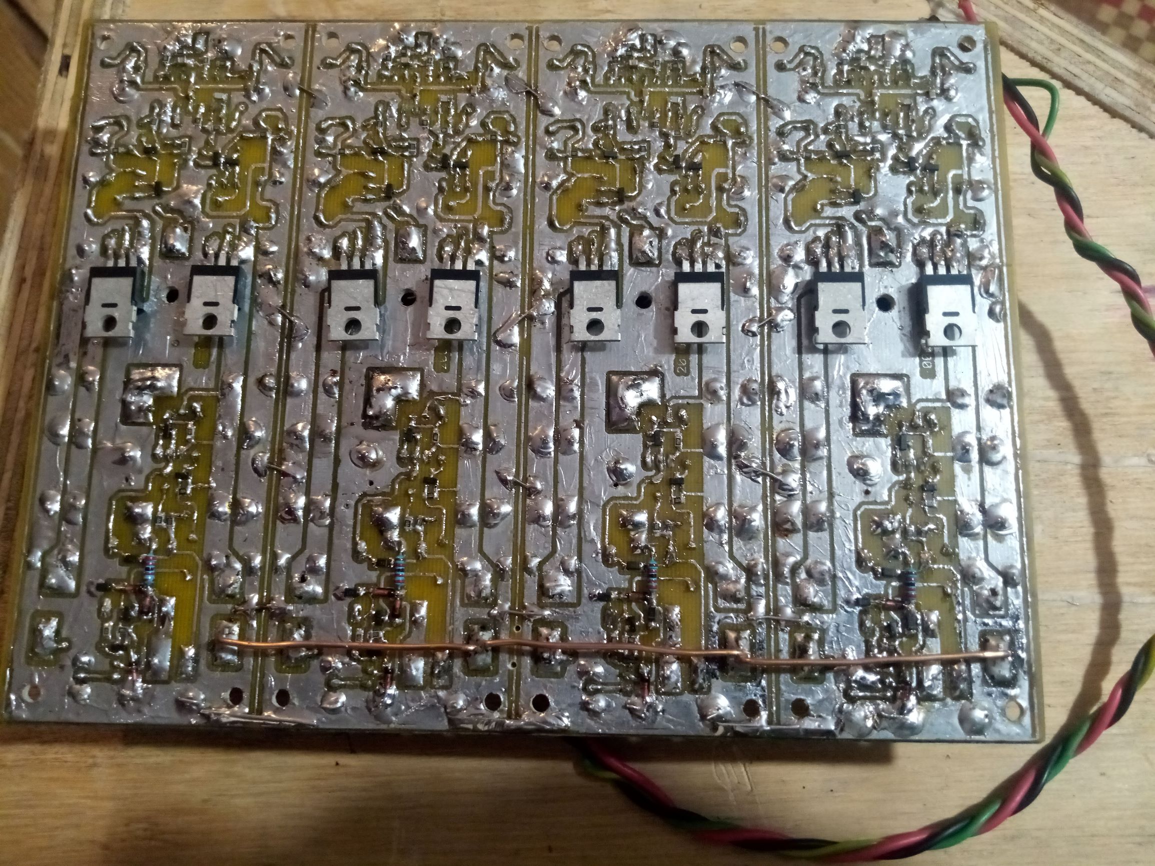

hi all , i have made many pcb versions of this amp ,
i still stick to the original schematic in the above link.
the thing i found interesting in this amp is that it requires original tl074/084 and bc327 and bc337 . if you compromise in this area it will consume alot of current at idle an produce hf noise.

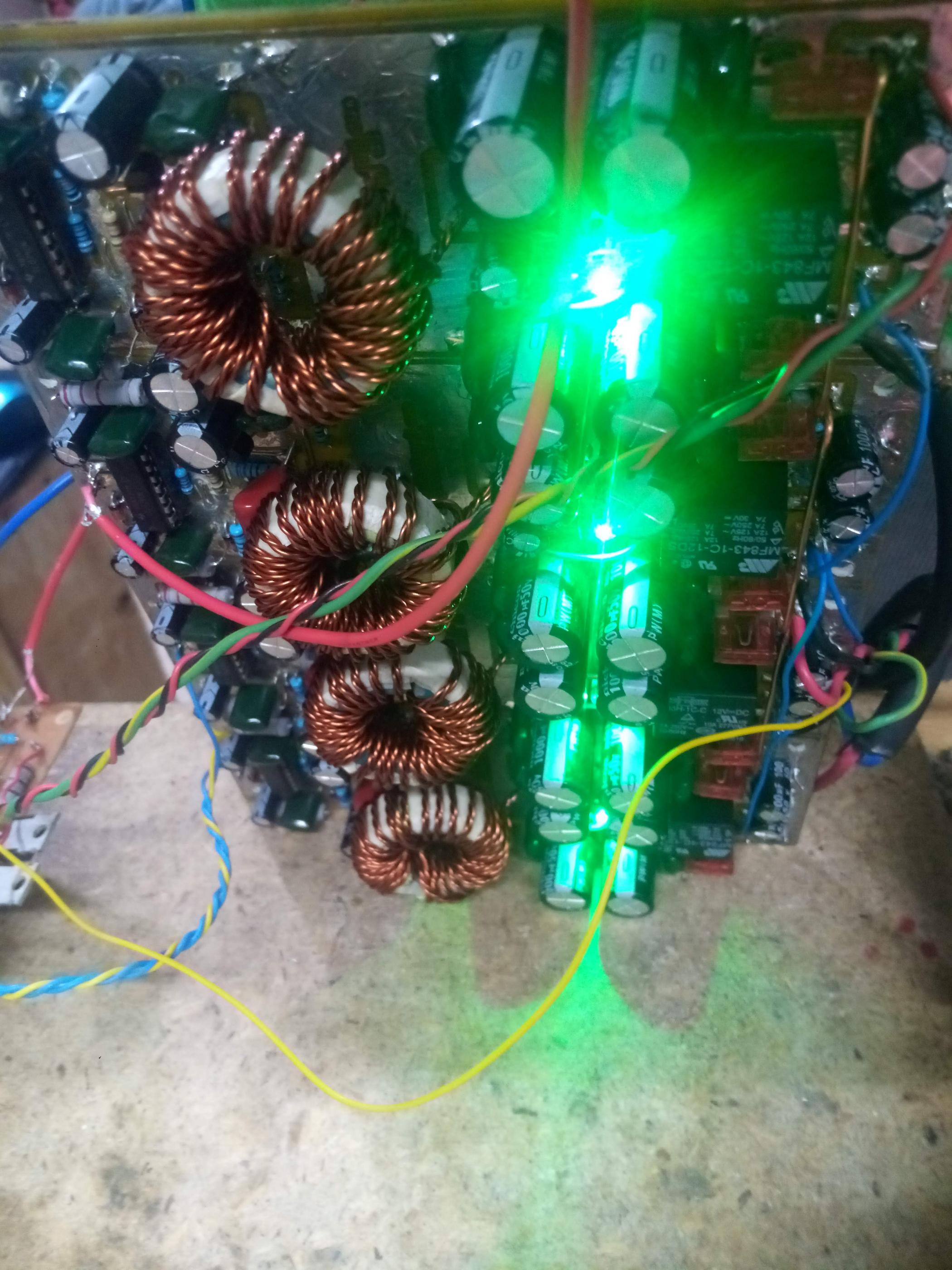

vvv vvv my current project vvv vvv

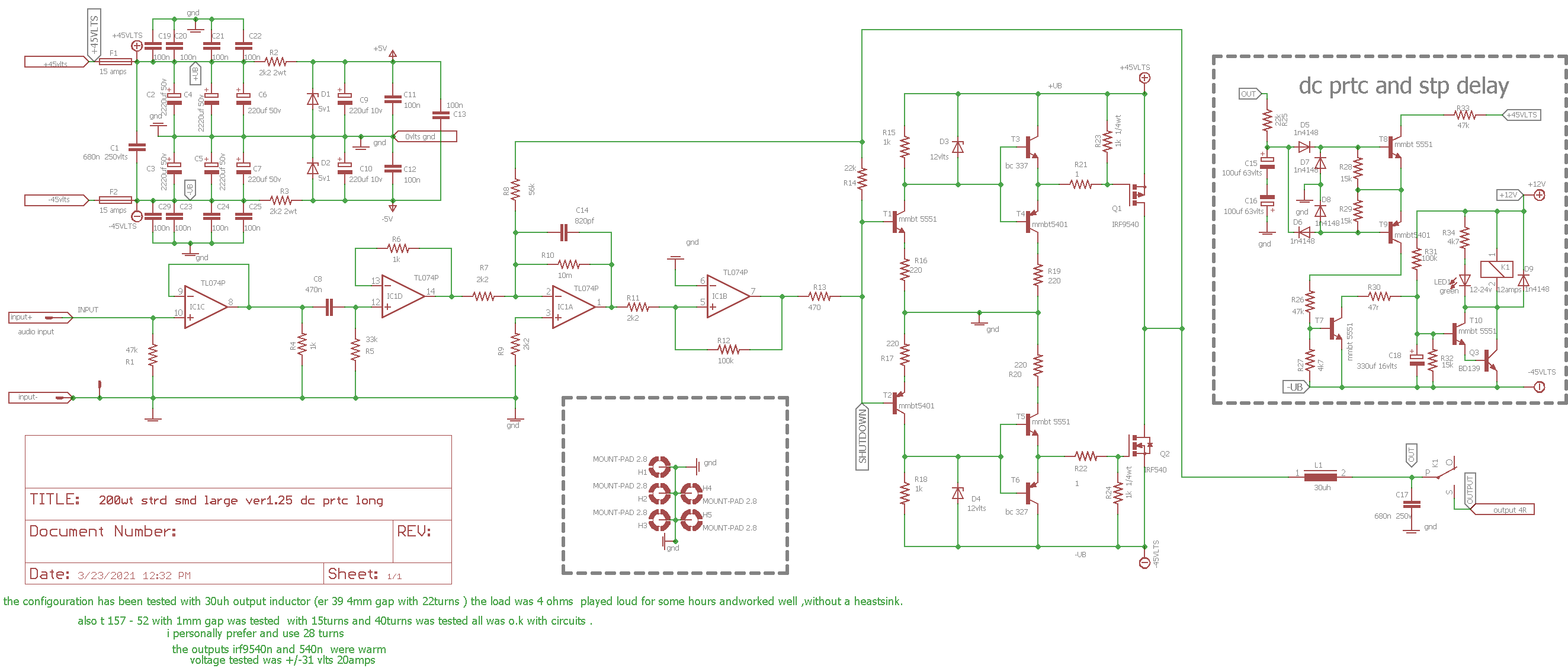

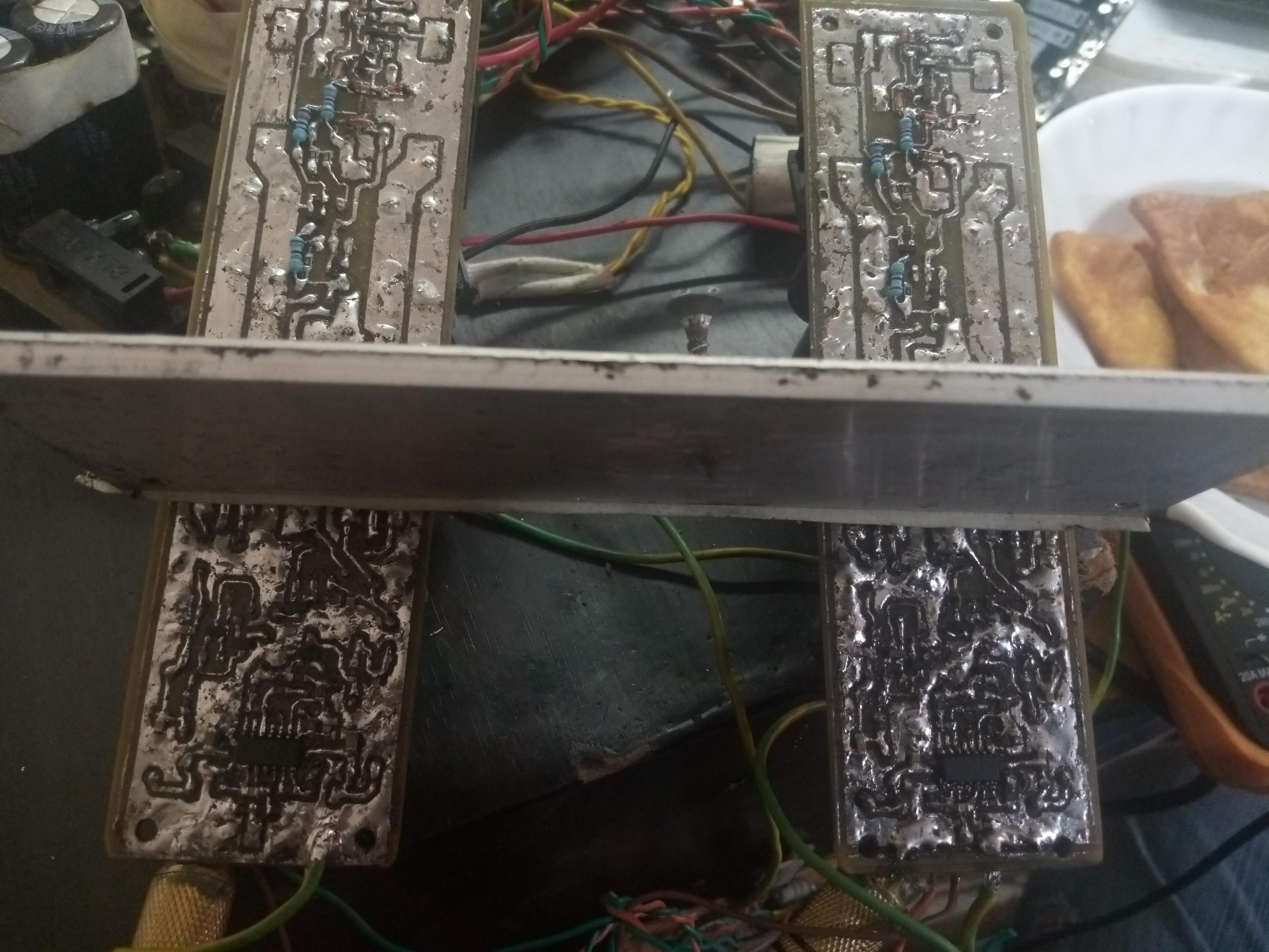

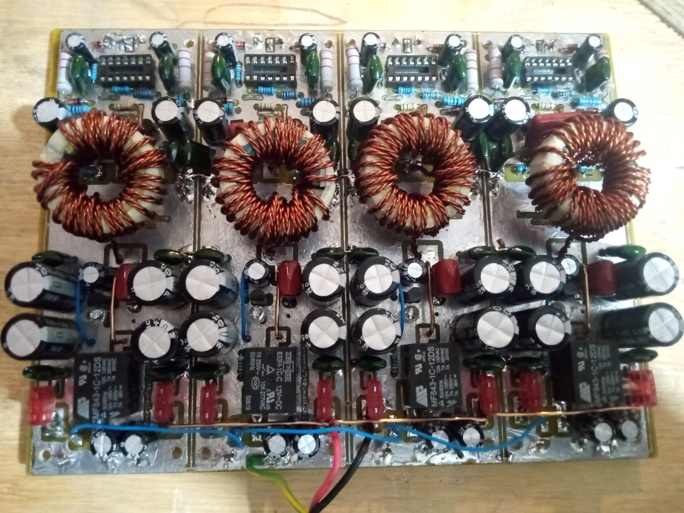

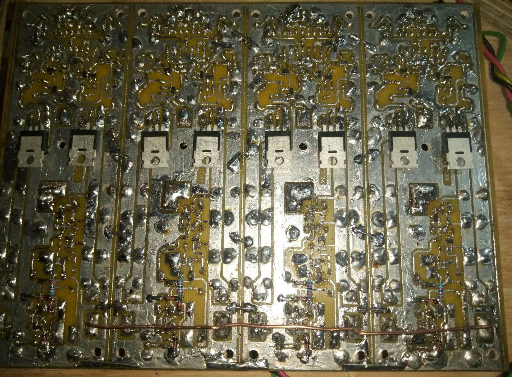

hello all , i have made my latest version of this amp , i opted for a through hole ic due to challenges in getting a geniune tl074/84 smd . imagine the smd also have issue 🙁,
A not original ic works fine in preamp,eq, crossovers etc , but can't work well in this class d amp ,
with this amplifier it works but the amp produces a lot of hf . but when i use a good geniune ic the hf noise reduces and the amp does not draw a lot of current
but a geniune tl074/84 works with no issues at all .
here is my project and pcb files . have fun fam 😀😀
