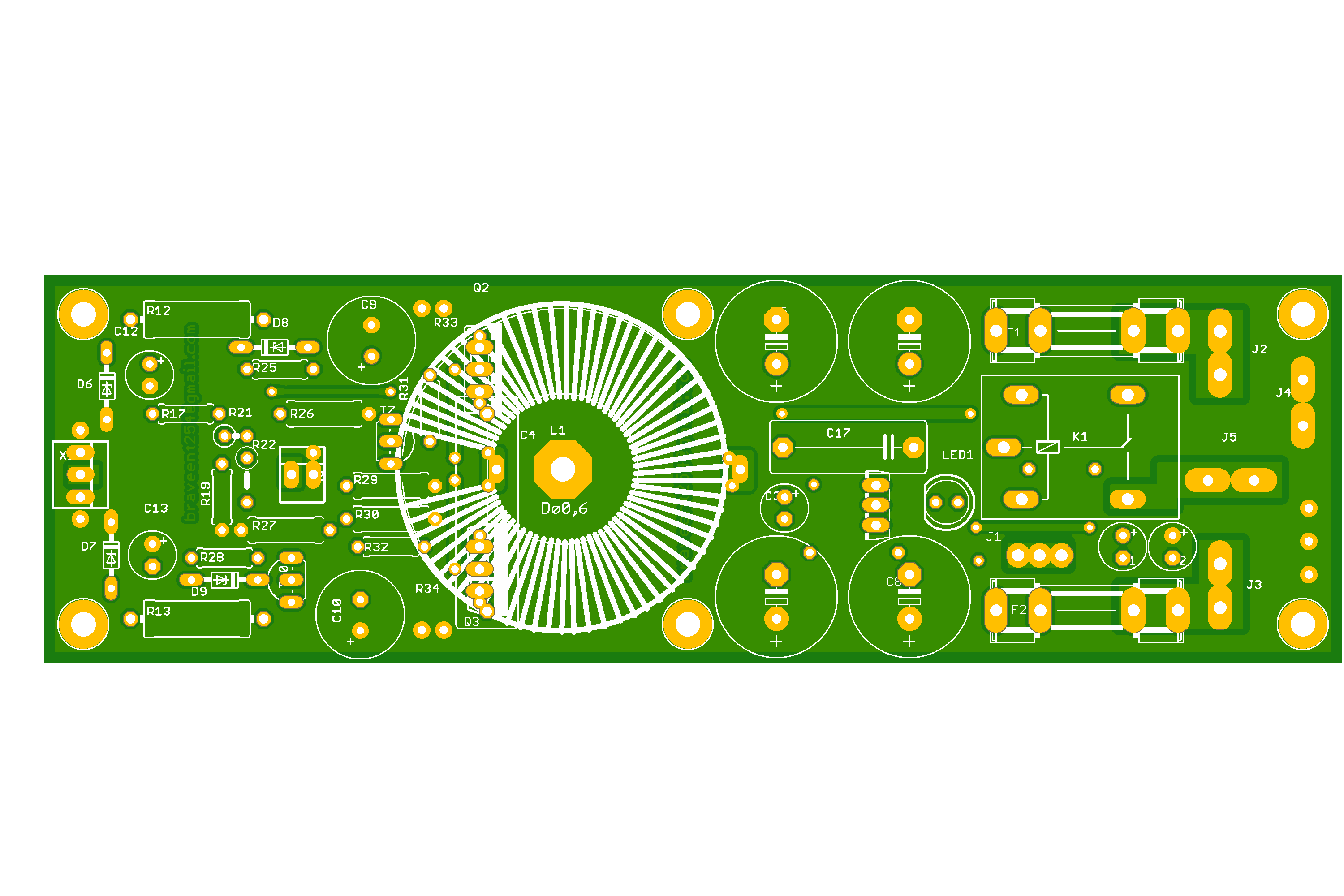

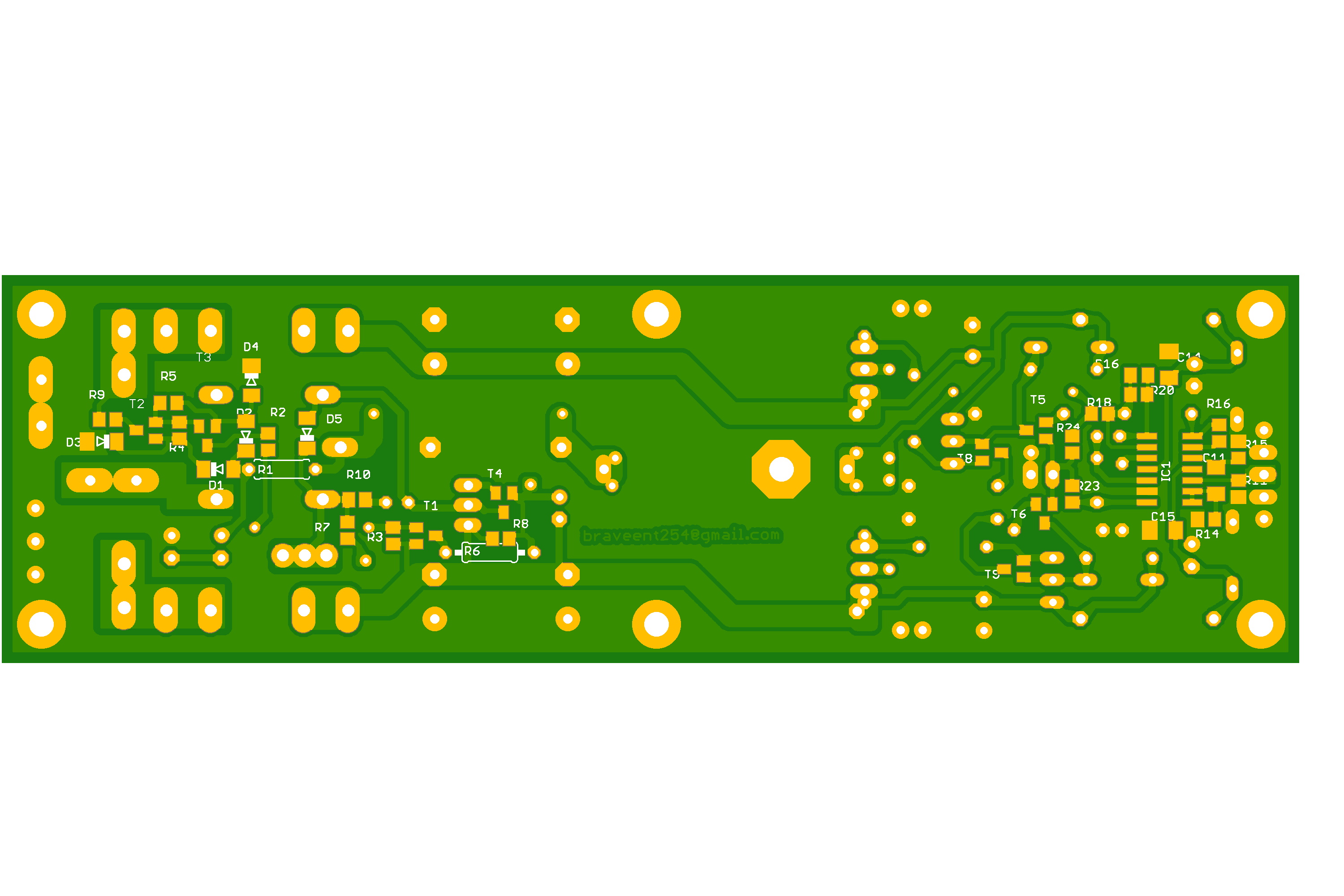

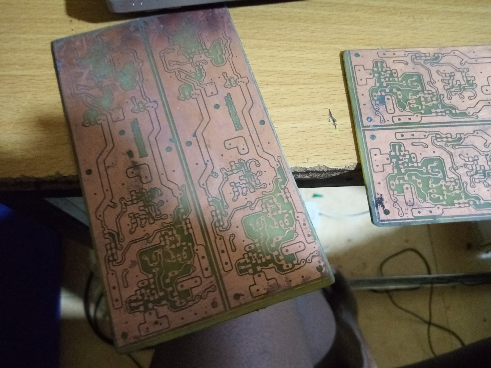

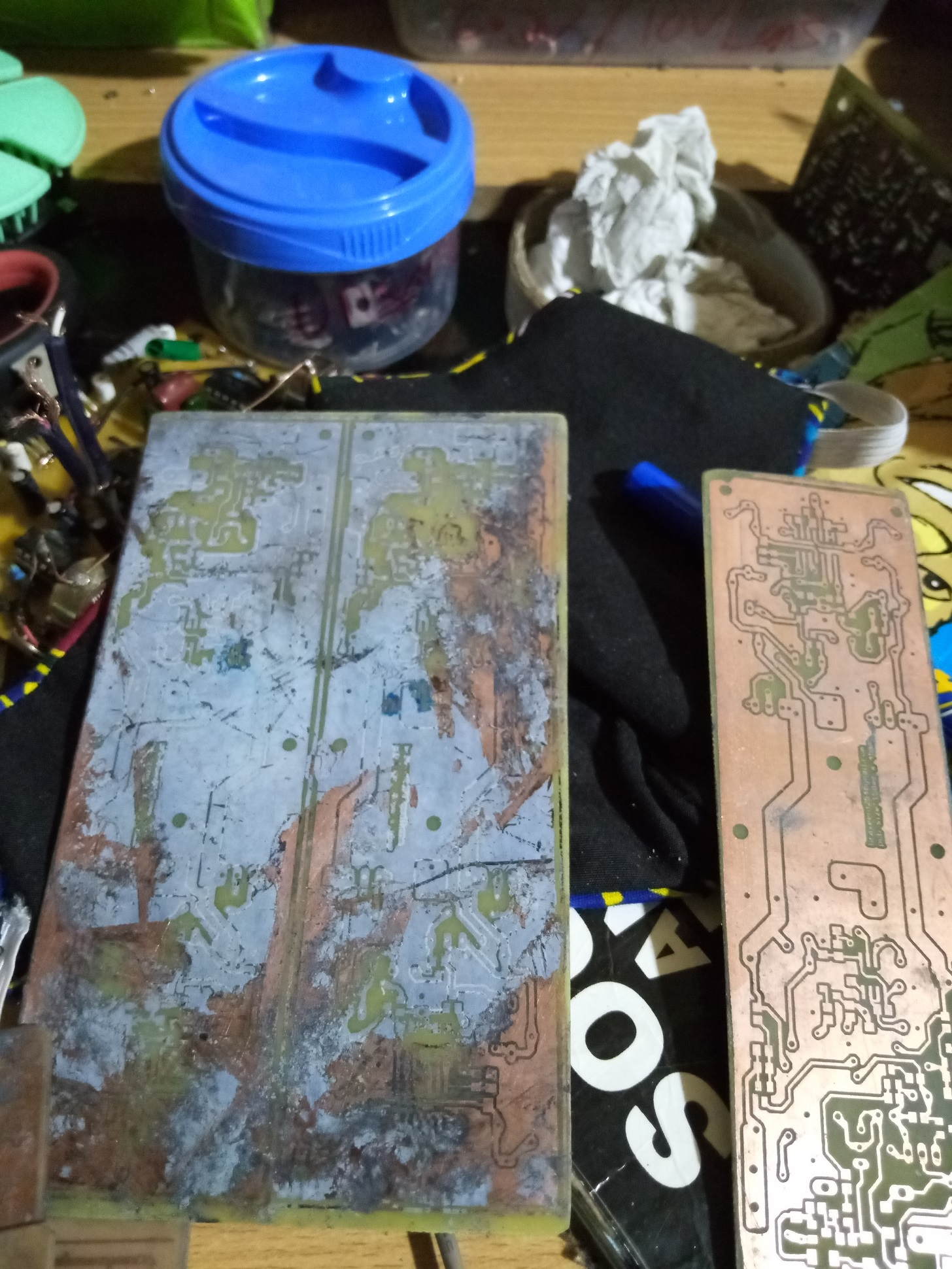

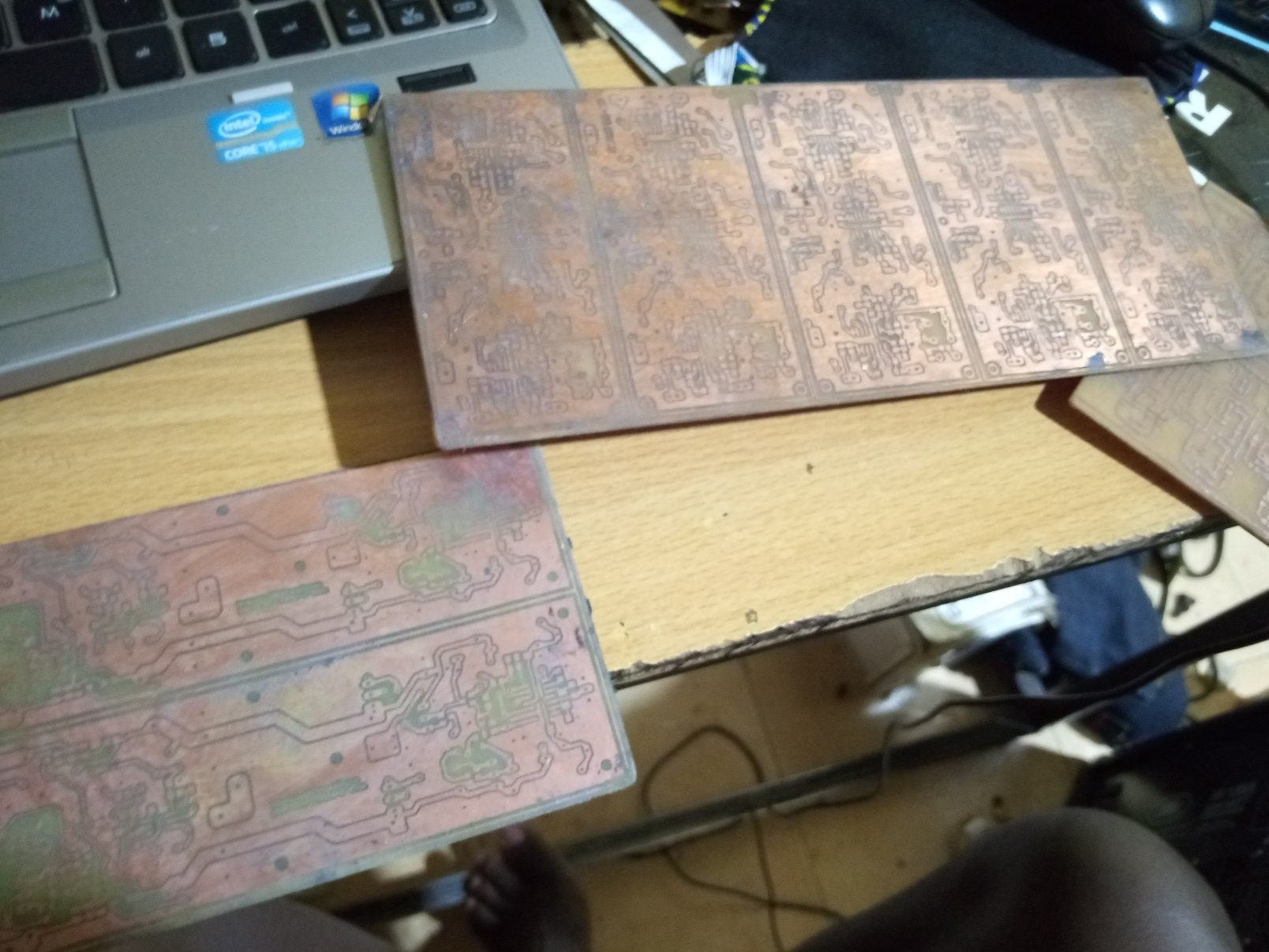

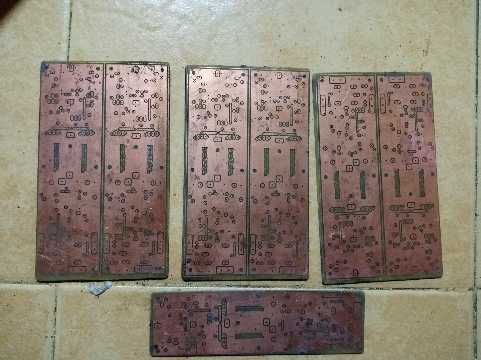

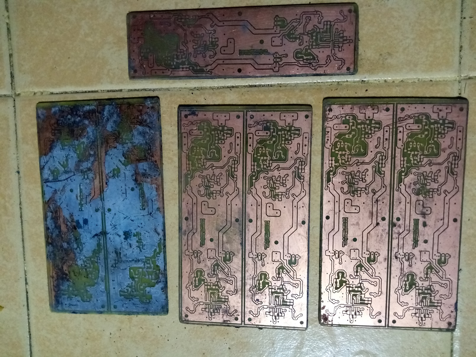

😕😕 and i have etched the pcb 😱😱
thanks manoj for the heads up , i will have to use jumper wires in the boards i have etched

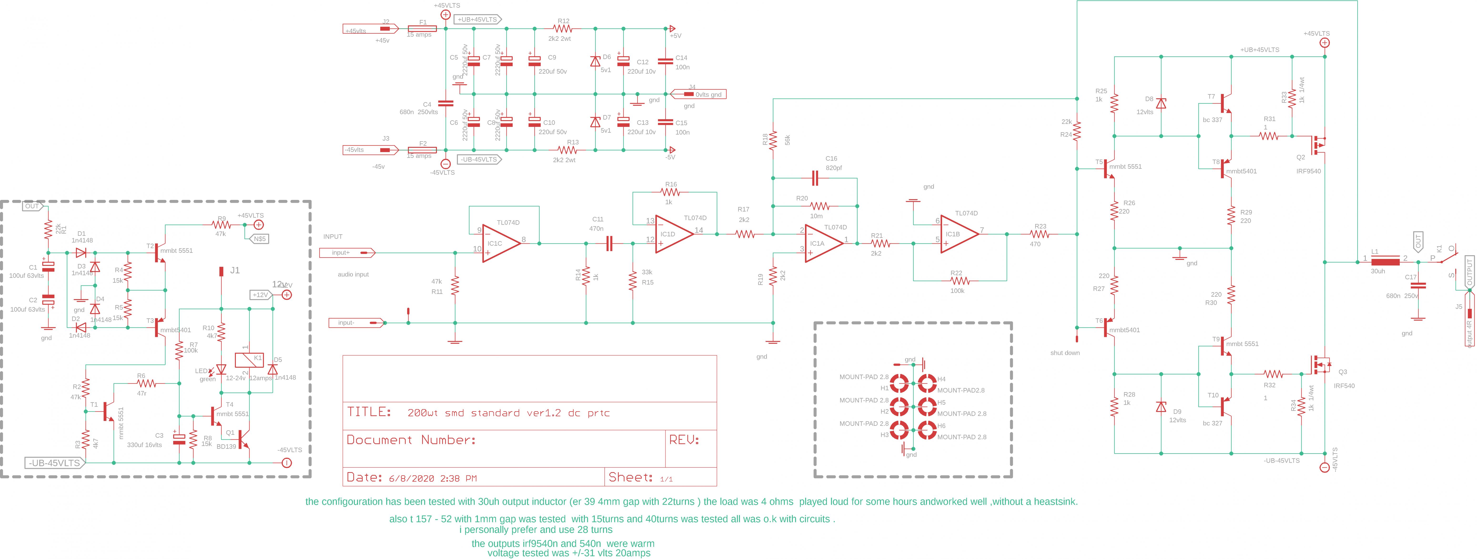

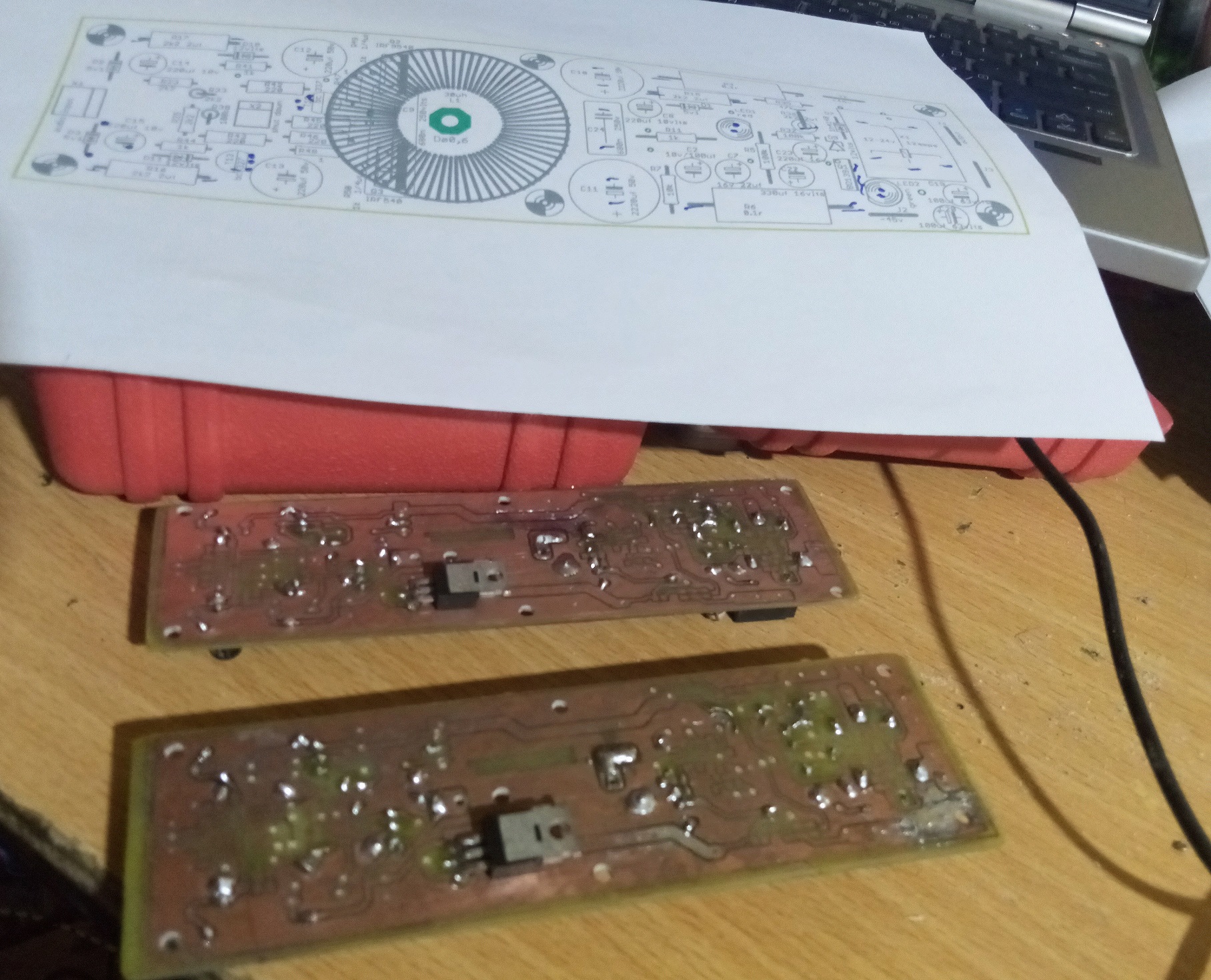

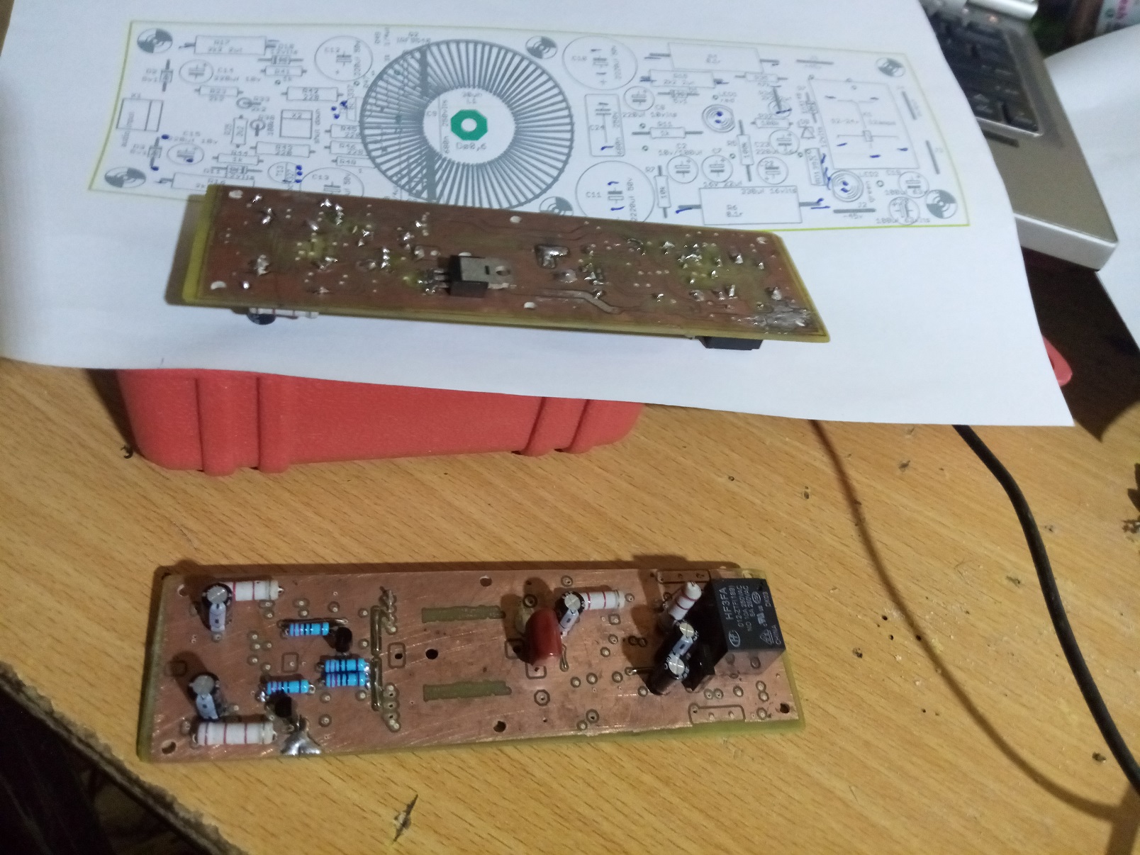

Hi stewin,
did you check DC protect, something wrong in your schema.
Regards
MANOJ
hi manoj ,i used sir kartino surodipo schematic the protection side from his ucd amp . he even has many videos of his many amps working.
i have seen the t5 and t6 are mixed up i have to swap them 😱🙁. thanks again sir manoj

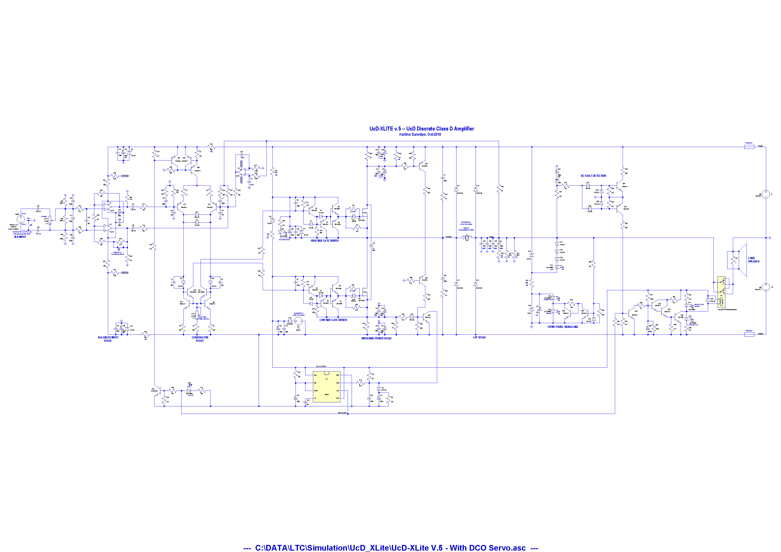

I have been following this very interesting thread for a while. I have built many other types of amps and am interested in looking at this class D design as my first attempt at Class D. There are some questions I have about its design and component selection...
Why not use AD713 instead of TL074?
The PSU stage for the Opamp surely could be better and utilise a capacitance multiplier with a linear regulator (transistor + zener etc)?
Would using higher Opamp rail voltages improve Opamp performance in this circuit?
How critical is board layout for signal integrity?
Opamp choice is critical in regards to latching. Whenever you need to force an opamp to potentially act as a comparator, make sure the specs say: Latch-Up-Free Operation.
Incidentally I know AD712 latches badly, so that's a no.
But the latest installment by stewin has a discrete comparator, so the other opamps may do.

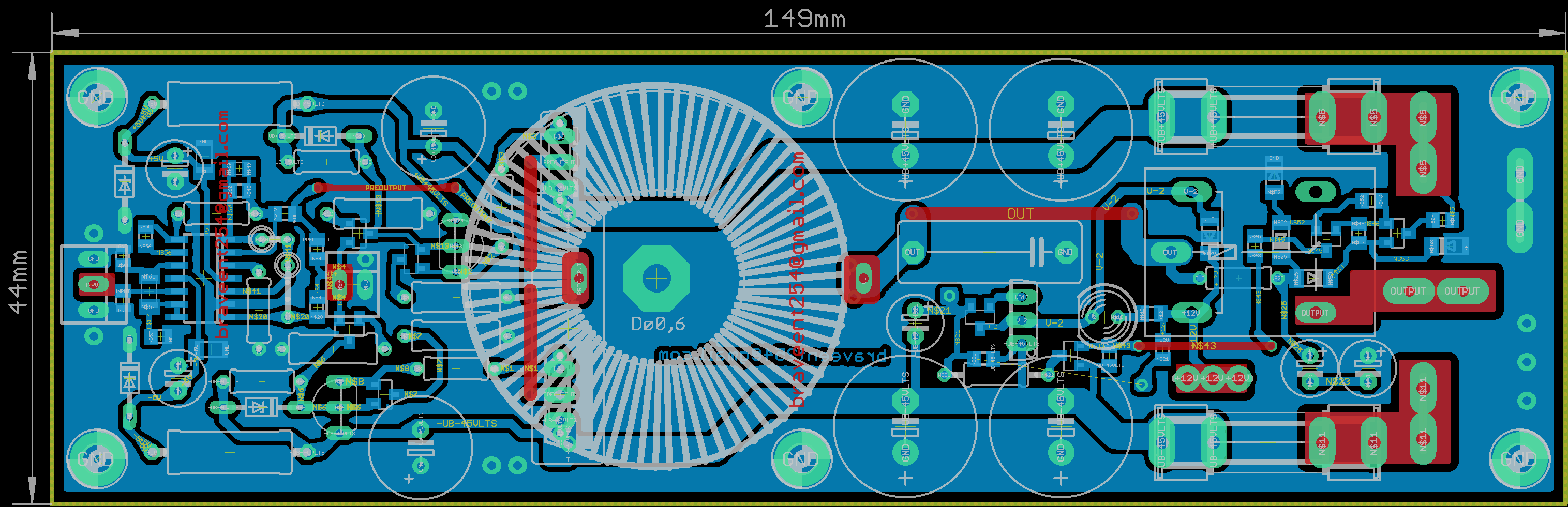

updates on my amp. firstly i rectified the transistor arrangement on the dcp section , then i removed the overcurrent protection and remained with the dc protect 😀 . (I should have used an optocupler at the ocp instead of the transistor😱. when i connected the ocp to the shutdown of the amp it had a bad noise interference.) the files below for the revised amp with only dcp

Thanks for the recommendations. BC327/337 are good for me as I have a lot of them. Where is the best place to get instructions on creating the choke? Which ferrite material can be used yellow/green/red?
I typically use Sprint Layout for boards so I will develop a new board using that tool. I am looking forward to getting into this while "working" from home! lol

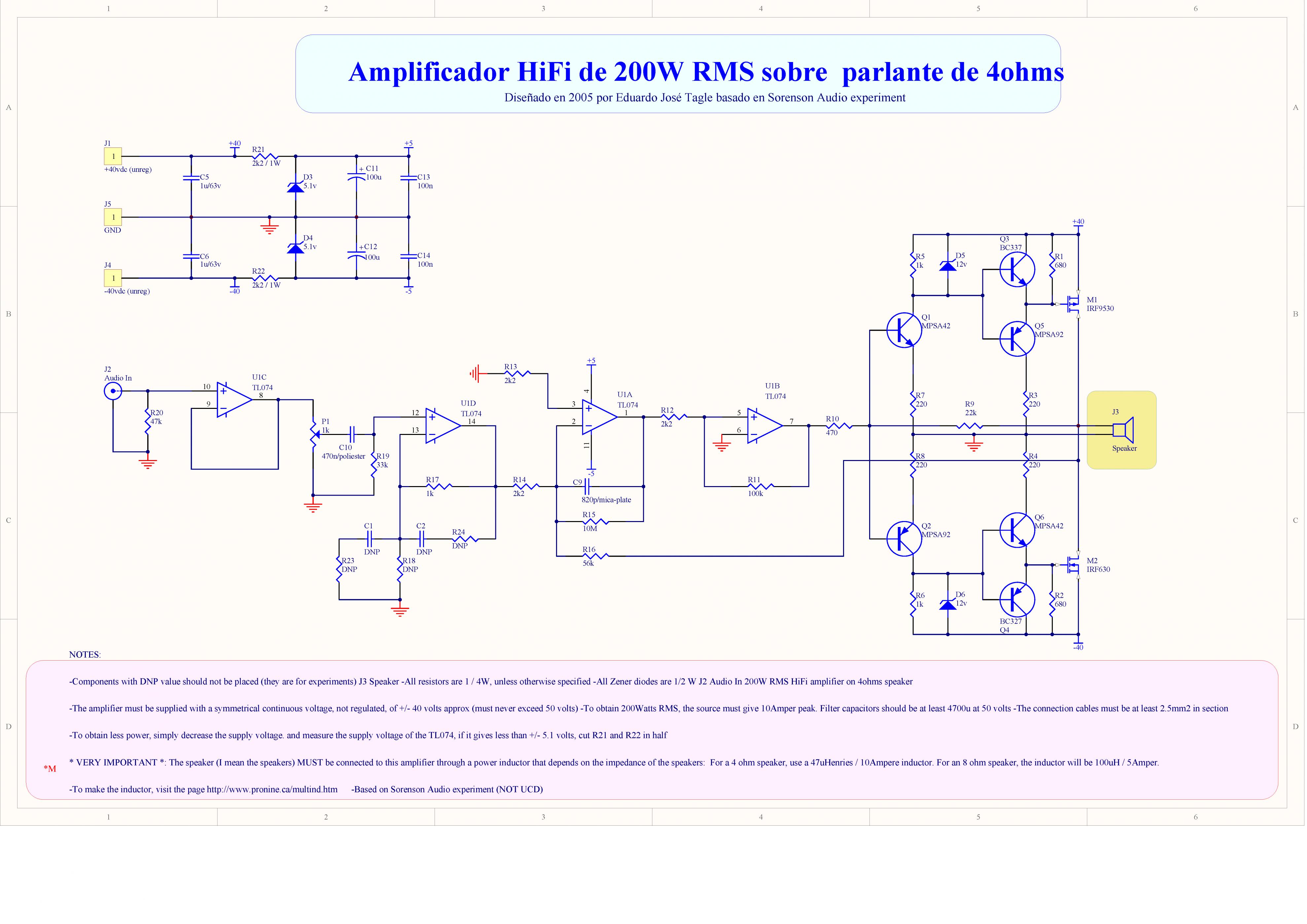

use this original schematic by etgale . it works fine .as for output inductor use 22uh to 50uh . choose the best for you.
please use 9540 and 540 fets

A relevant question, The op-amp TL074 has a 3 MHz unity bandwidth with a slew rate of 13V/V. Don't you think it will slow to respond to high amplitude, fast switching waveform from the output of the amplifier? Regards Vakas

hi please draw a schematic of lm311 using this schematic . thanks (hoping that lm311 is better than tlo74 in regards to latching)
Some op-amps go into a phase reversal when the common mode range at the inputs is violated. When it happens, the output goes hard to a (wrong) rail voltage, and if ever at all recovers from that condition too slow for the application at hand. Some parts simply give up the smoke. The manufacturers don't advertise it, except for the parts that don't latch.
There is a link to something about the common mode violations: https://www.edn.com/are-you-violating-your-op-amps-input-common-mode-range/
It is safe to say that whenever an opamp may turn into a comparator, you have a risk of latching.
When it latches there is no negative feedback, and the fireworks begin. Hopefully only fuses.
