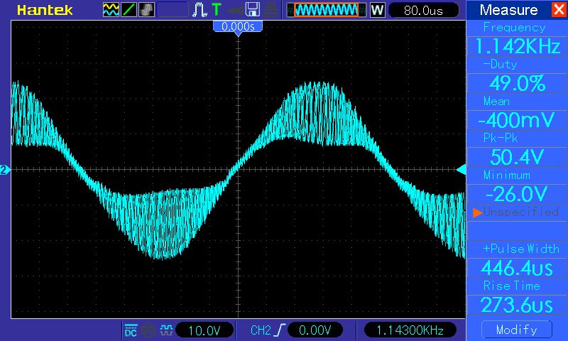

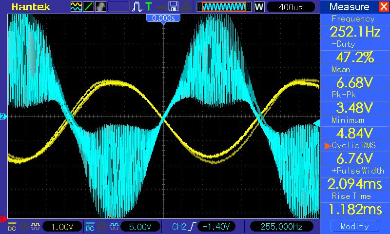

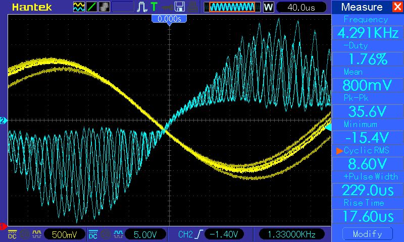

I make this modificatios in my amp, I use single sided board with all GND conected in your first schematic, and when i inject a 1khz sine wave, the output with a resistive load of 4 Ohms show this..

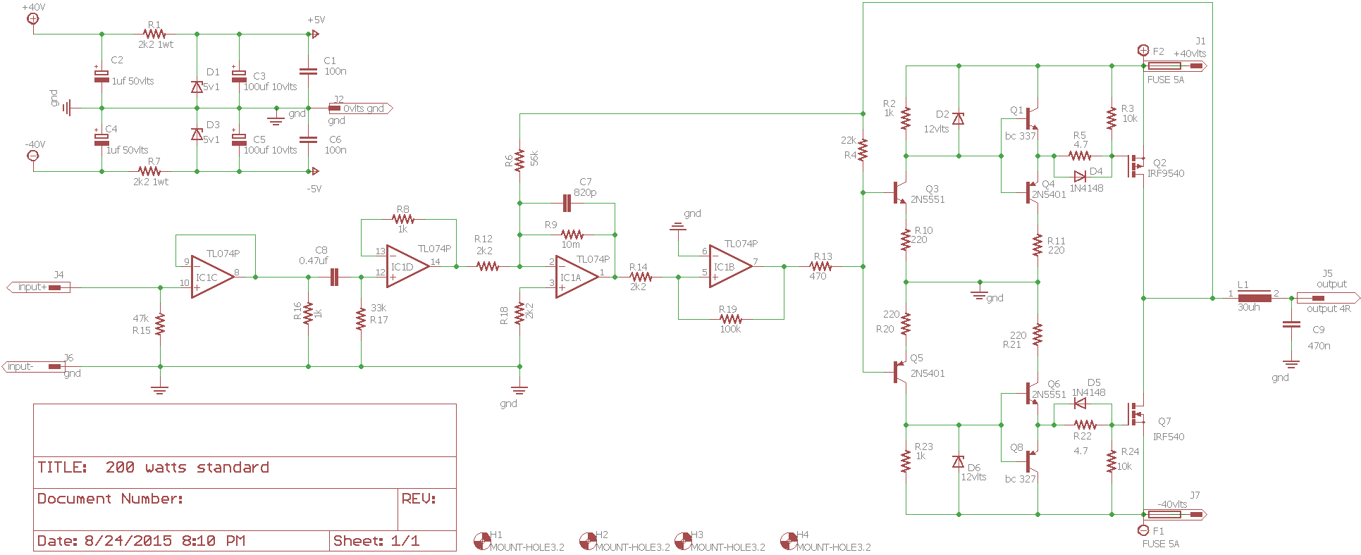

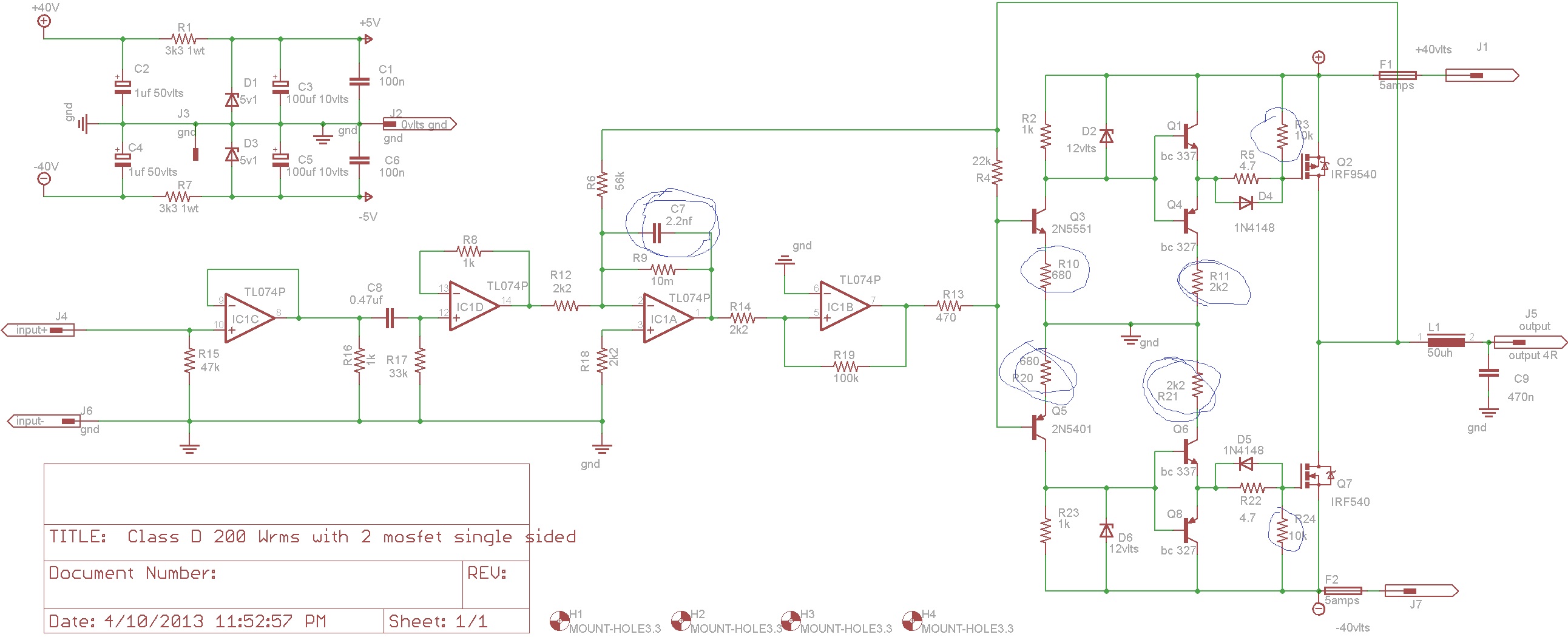

- I try make this amplifier, but got very noise, i change CAP C9 = 1mf x 250v in output filter and get a little reduction of noise, i use BC337 and BC327 instead 2n5551 and 2n5401 and use IRF9630 and IRF640 pair in output.

hi pav you are using the wrong schematics. please change the schematics to the below components . and to avoid disappointments please use irf540n and irf9540n- I try make this amplifier, but got very noise, i change CAP C9 = 1mf x 250v in output filter and get a little reduction of noise, i use BC337 and BC327 instead 2n5551 and 2n5401 and use IRF9630 and IRF640 pair in output.

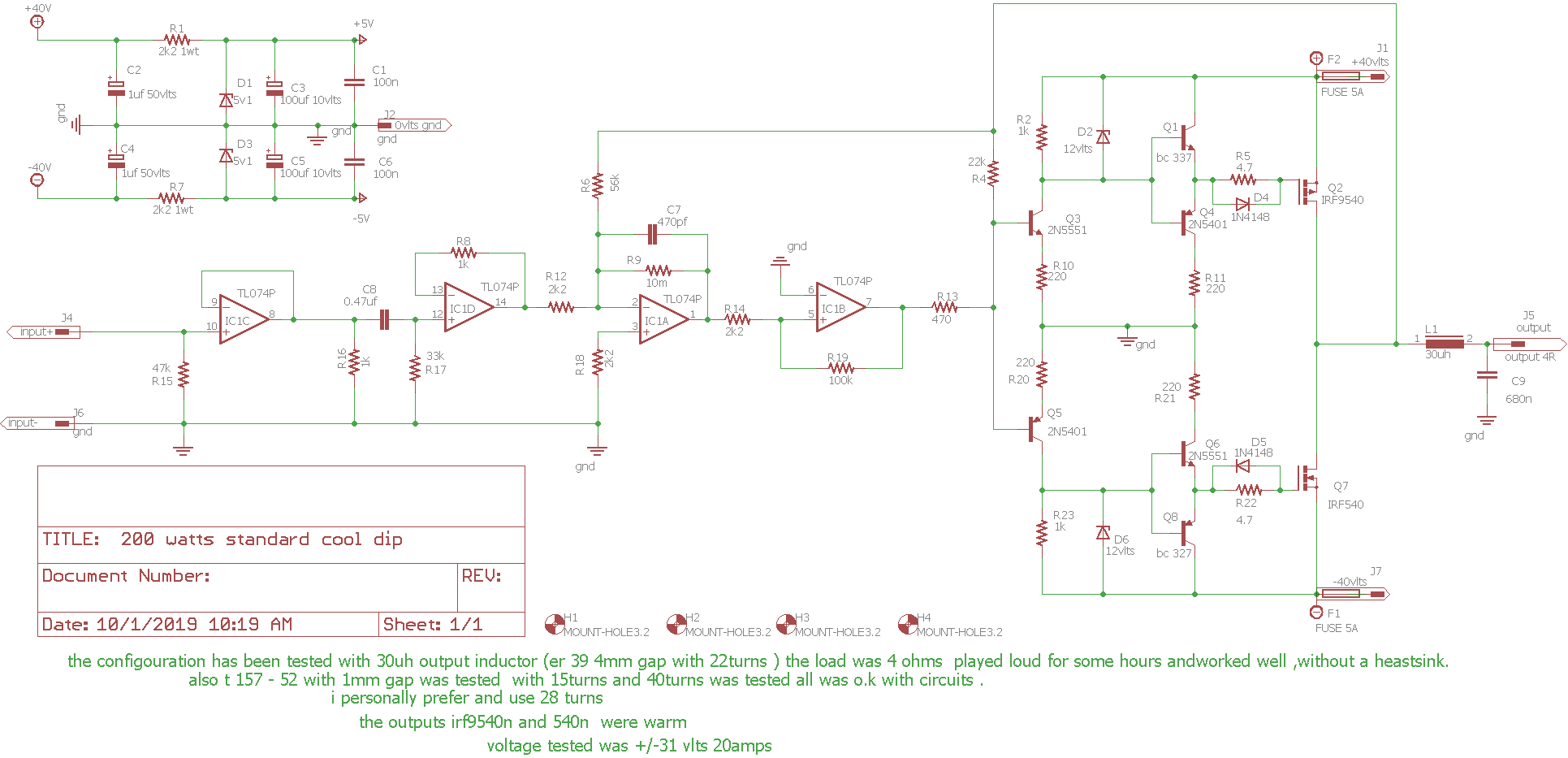

below the correct schematic
Very thanks my friend.. now really work fine.. 0,2% THD at 100WRMS
Hi Stewin
do you have short and DC protection for this schematic?

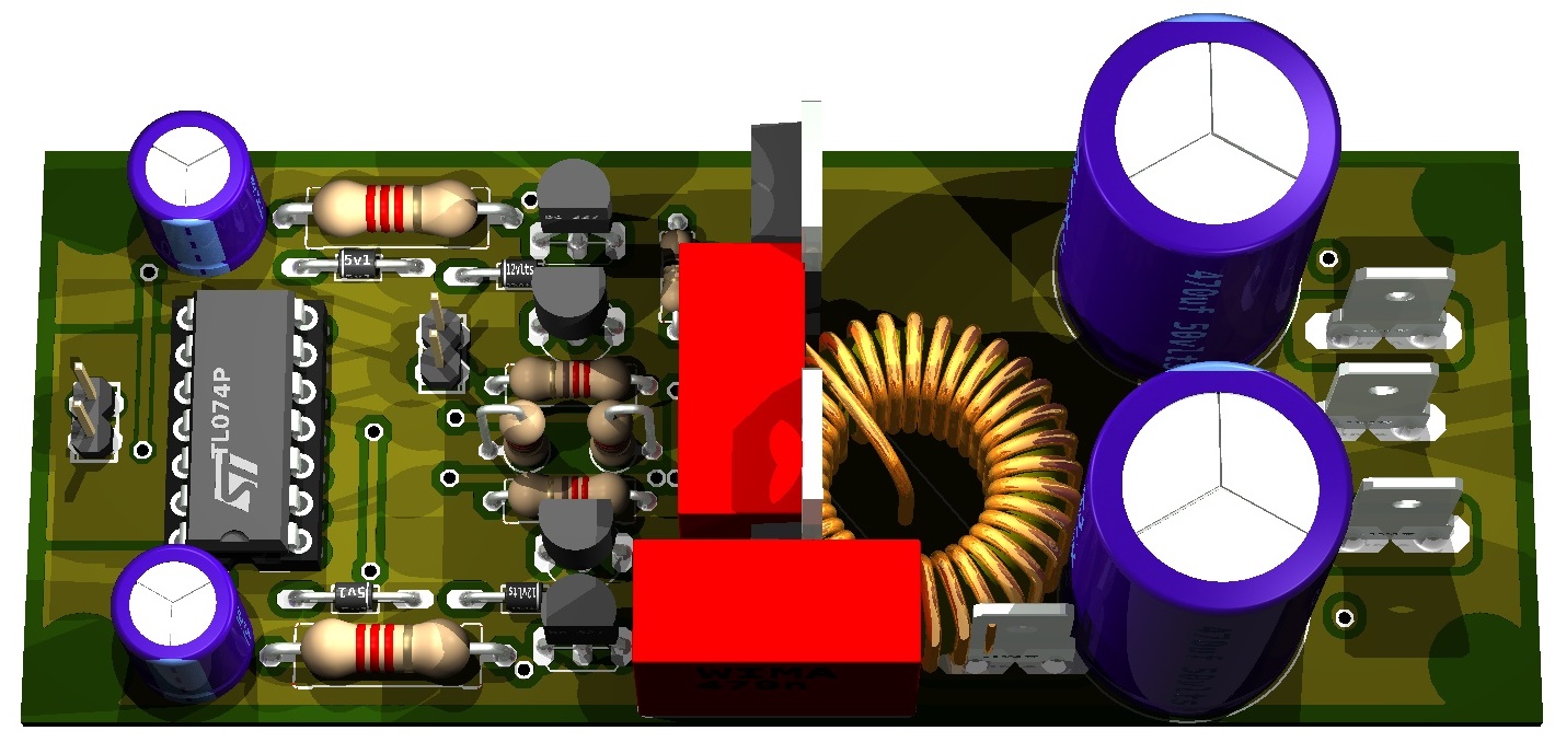

hi all . below are links to my 200watts smd version all i have tested and are working fine.
have fun all . and to GOD be all the glory

this was my last work on this amazing amp . revisiting it soon
also here are the files for my successful class d 200w amps
i use cadsoft eagle layout for all my layout.
