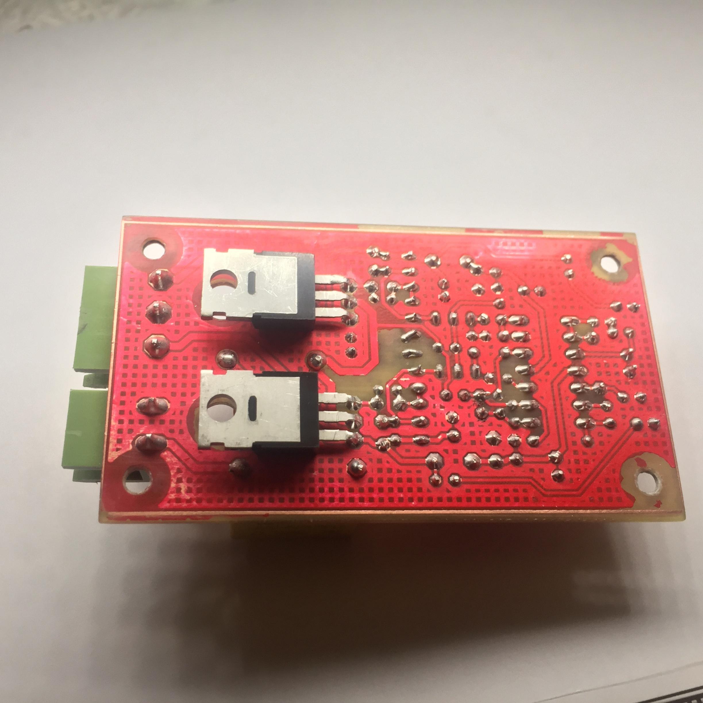

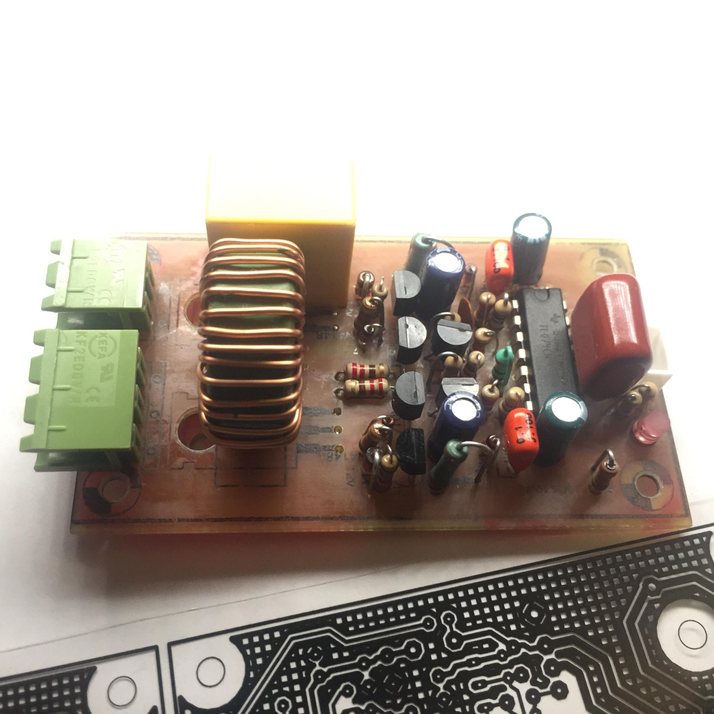

Hi all,

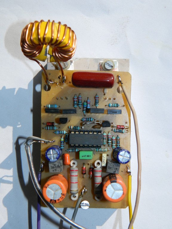

this is my first time to post here, i want to share my work and seeking for help as i this PCB but for some reason it is not working so any help?
Thanks a lot.
the amplifier should work well , please check your bc337/327 also is the quality of your tl074 good?
please post more pics ,even of your power supply and the dmm reading
Class d build
Thank you Stewin for the quick response, the problem caused by the filter inductor i had to change the core (from a green to a yellow one) and add more turns, unfortunately i don't have LC meter to measure inductance and i don't know if it is a ferrite or iron powder core and so i cannot calculate anything!.
Anyway it worked very well, one thing i am not quiet sure of is the heat dissipation of small signal transistors (Q4 and Q6) is that okay??? they get warm but i can stand touching them for a while but i can tell they get really warm.
PSU is +- 39 Volts.
Will post more pictures and readings soon.
Thank you
PSU is +- 39 Volts.

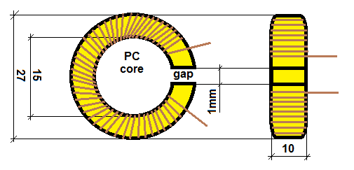

the heat in the small trannies is ok . but if you are using a yellow white core or green blue core , cut 1mm gap one side of the ring with a hacksaw and coil 33turns.
have fun
have fun
like the below
Yellow-white is an iron dust core, iron dust cores are distributed gap an shouldn't need slotting for linearity. Better to pick the right grade of iron dust core to start with?

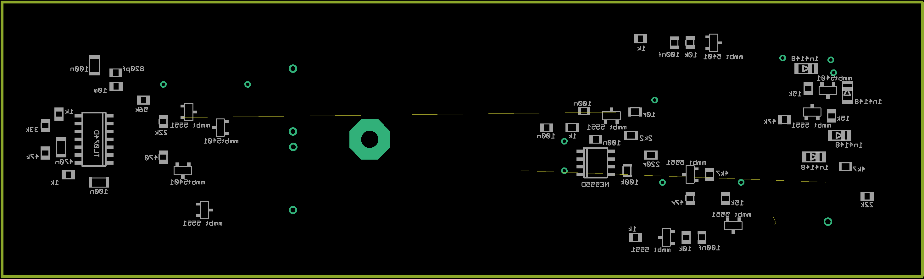

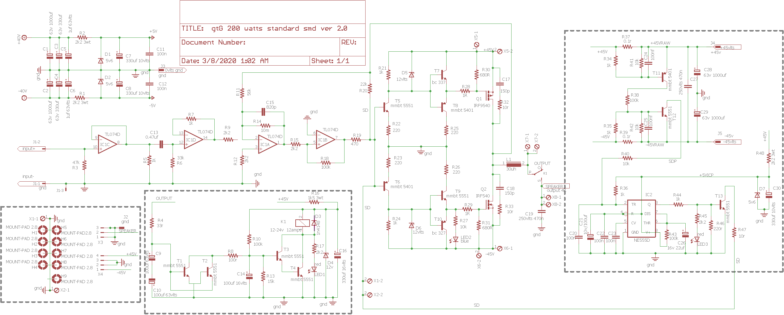

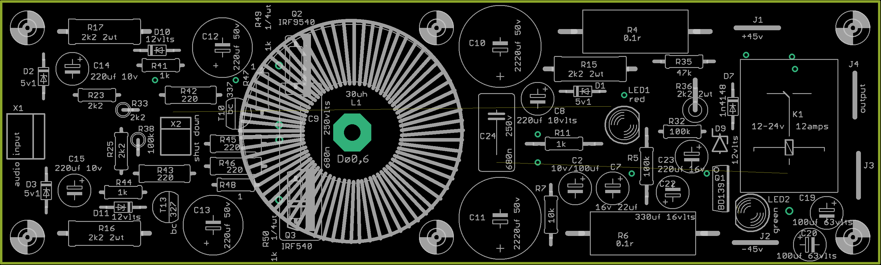

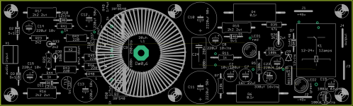

hi all , just finished the fully smd version . please check if there are any errors .
also i have added a relay for on delay and dcp also over current protect is on .
where should I add the over temperature ?
if there are any updates ideas or suggestions ,they are highly appreciated ,please post them here . all files are below
core used can be t-106 to t-157
thanking you all in advance steve
yes can stewin but p-channel will always get hot cuz slow rds on 0.15 but it will work with proper heatsink.

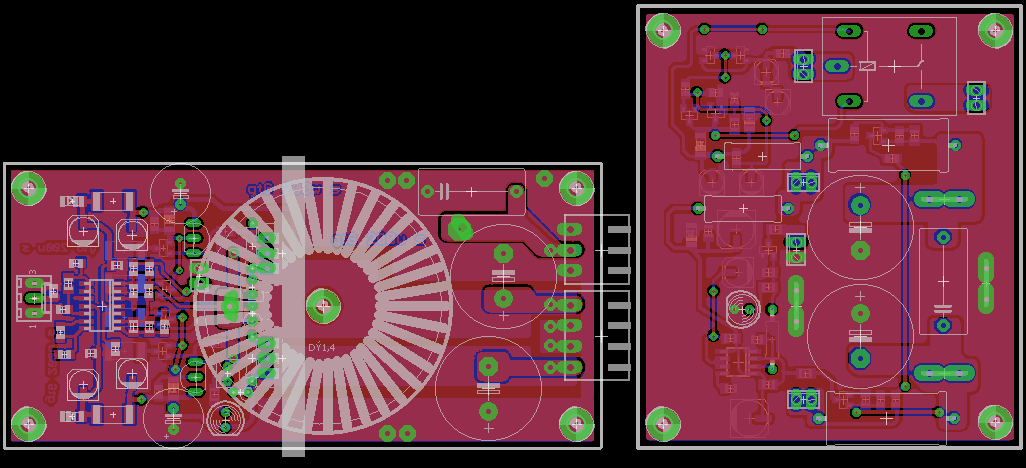

hello all, the smd version of this amp with protection . the eagle file is for eagle 9 onward. old eagle will not open the pcb project , have fun all😀😀
200wt dual smd standard ver1 bottom clear components.png26.9 KB · Views: 533

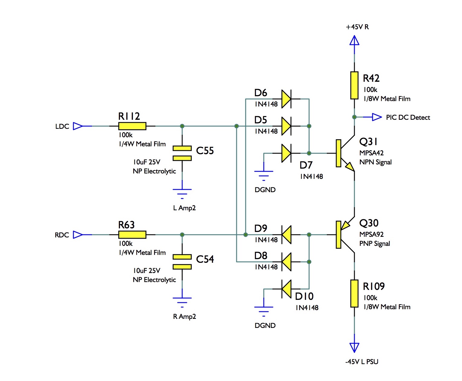

Hi stewin,
did you check DC protect, something wrong in your schema.
Regards
MANOJ
😕😕 and i have etched the pcb 😱😱
