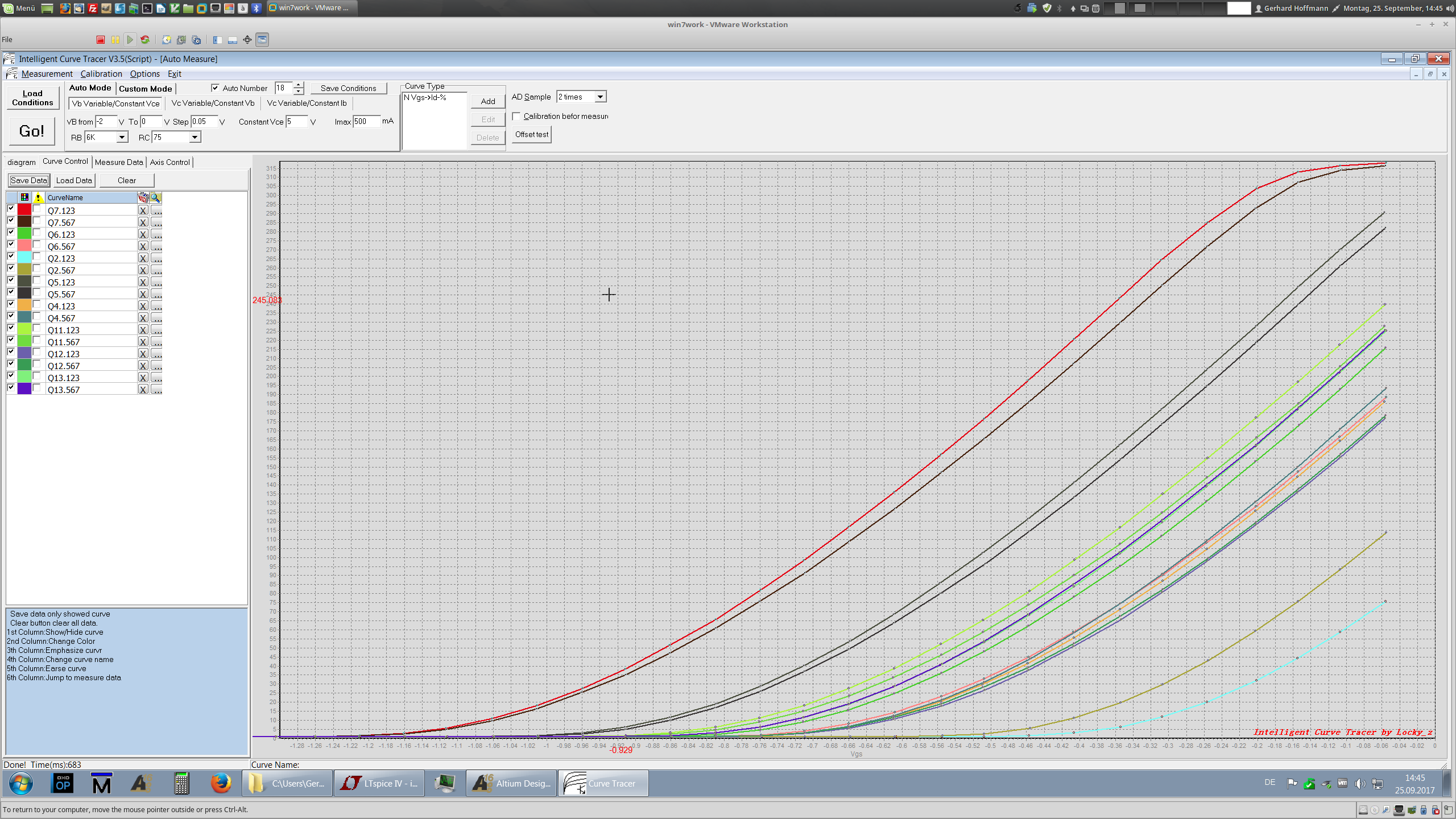

8 Pairs, Results of a lot of money, badly spent:
