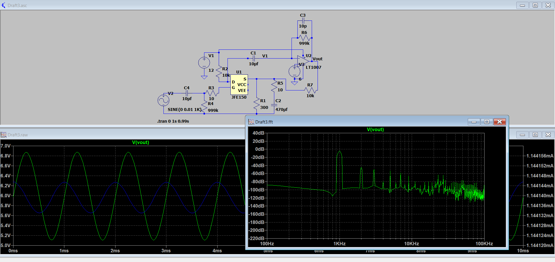

Yes, the schematic is wrong. With Rs=300ohm and the typical Idss=35mA, the drain current is around 3mA. Therefore, to have the JFET in saturation Vds>Vgs-Vt, the drain resistor Rd should not be larger than about 3kohm, 10kohm is not good for a 12V supply. Probably a typo, Rd should be 1kohm.
We have feedback so things are a little different but it works at about 1mA, here are results.
P.S. input should be below 10mV

Check the Vds, your simulation shows the JFET is barely in saturation. Or it could be the device model doesn’t use the typical parameters from the data sheet (Vt=1.2V, Idss=35mA).
Correct it is not in saturation at all but I have seen implementations (and I have made tests myself) with JFETs not in saturation area. There is a circlotron design only with JFETs that the input stage works with JFETs not in saturation area (linear ?)

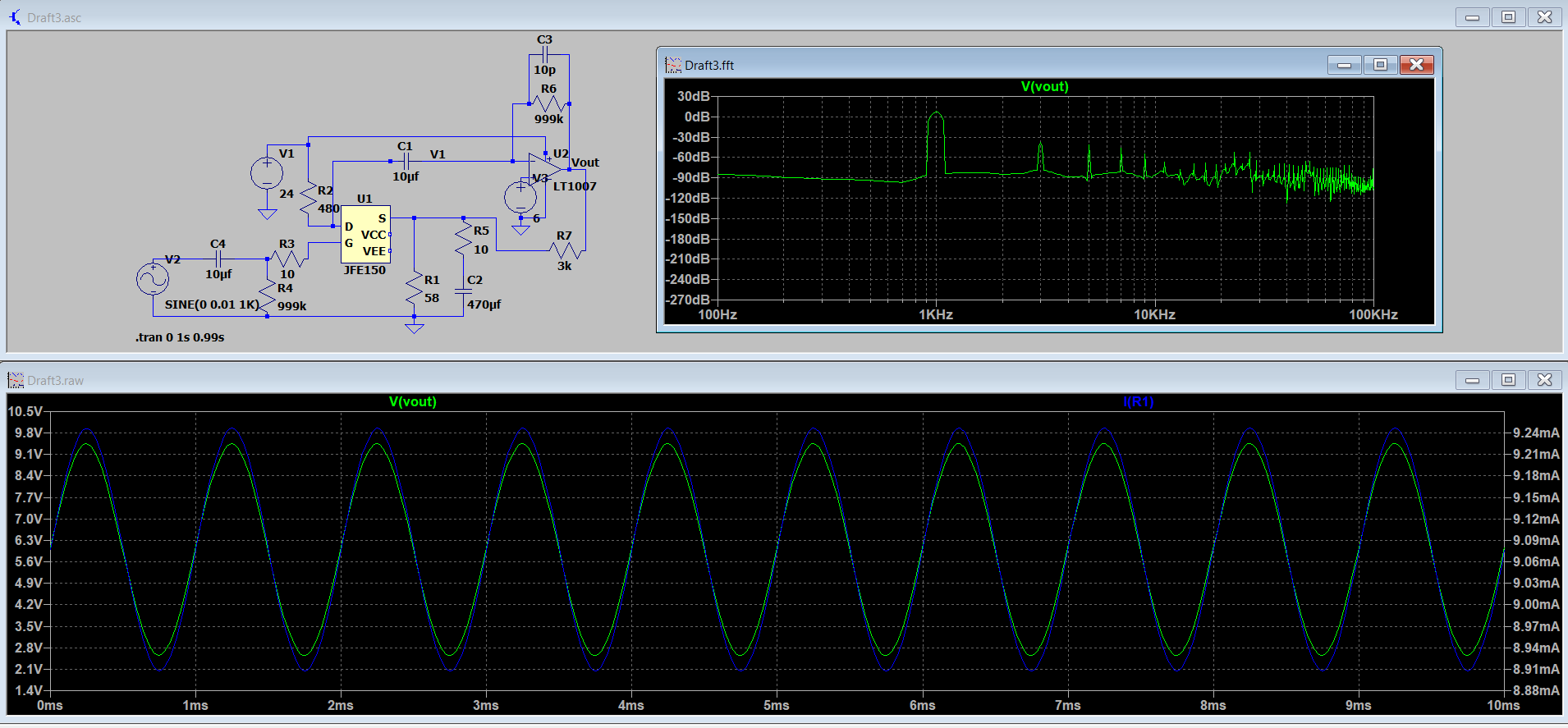

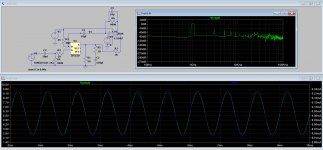

the circlotron design is here in diyaudio. Anyway, changed values to have Ids=9mA, Vgs=-0.52 which would be ok i guess and Vds=18V. If I read correctly the datasheet, this should be saturation area.
In linear the simulation still gives results and the same does in circlotron. I created the circlotron too, with my changes but only tested in lab, haven't produced the full amplifier yet and it is 3rd in the row project waiting but I believe i will test early next year.
