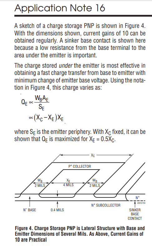

Where do you propose to obtain a discrete "charge storage PNP" like the one Widlar used in his LT1010 voltage follower ?

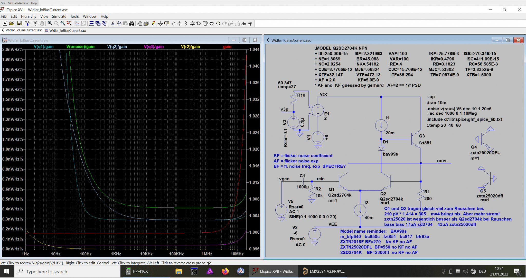

Ah, Bob Widlar wasn't a one trick pony 🙂
I'm thinking at the input stage of his BJT Ersatz-JFET opamp.
Don't hit me for this circuit, I'm still stumbling around.
I can prove everything and the contrary.
More input transistors seem not to drive the noise further down,
more current does. With just 3 cent-transistors, 400 pV/rtHz
looks respectable, and that with low input current.
Q1 and Q2 have 0.7Vdc for Vbe AND Vce.

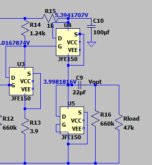

At last some results on the phono stage, after almost two months I have only used JFE150 for the implementation, no other active device. So:
  • SC70 gave me nightmare to solder. Besides that, I didn't know if some issues I had were because of bad soldering. After a lot of experiments I learnt how to solder them but still I have doubts. WHEN LCSC is going to have them so they can solder for me?? PLEASE
  • It is 1st time that I had such a difference from simulation to reality, more than 30% and because my circuit is very sensitive, it gave me too much trouble to experiment on the bench.... I managed to reach to a point where voltages are the same in two channels but resistor values are very different. However I checked every connection 10 times to ensure good soldering of everything.
  • Sound seems very promising, it was compared to a Symphonic Line phono stage, for now I have stability issues with psu.

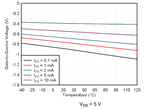

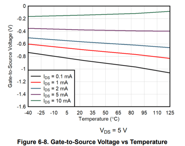

Gerhard,
Good info. here, thank you. Are you saying you achieved zero TC with 6x JFE150 at a total of 45 mA?
I would have expected the zero TC current just greater than 10 mA:
Note on JFE2140, it is a smaller area device, the zero TC is achieved at a lower ID:
Regarding the follower, we do see it in many circuits that don't need ultra-low noise performance, it is easier to deal with but of course the noise adds directly without the benefit of a gain division. I don't know exactly what the Widlar voltage follower is; can you give a link?

yes, check circuit below fed with 28V. The voltages are the ones on the real circuit but:
  • R13 is 10 Ohm
  • R15 is 780 Ohm
On the 2nd channel to have same voltages R15 is 900 Ohm.
I dunno maybe my soldering is not the best and contacts have issues but today the phono stage was on the system. I don't have distortion analyzers etc, only music matters to me. So first impressions are excellent but it seems I have to adjust the RIAA curve a little. Impressive detail.

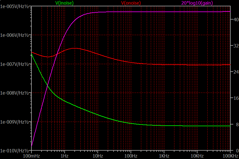

JFE150 noise testing setup -- per the datasheet -- the one issue I am having is deriving a very low noise bipolar source ~50V (batteries and cap multiplier perhaps?). One issue with the 3,000 uF electrolytic on the Source -- noise in large electrolytic capacitors:
For apples-to-apples comparison, Vds is kept constant at 5V, the gate grounded and V+, V- adjusted for the current specified. So to compare a matched pair of BF862, CPH3910 to a JFE2140 I would like to follow their procedure.

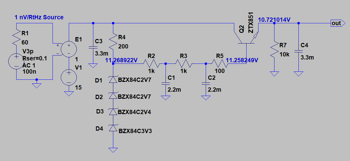

Cap multiplier with adjustable voltage references a la AoE3
