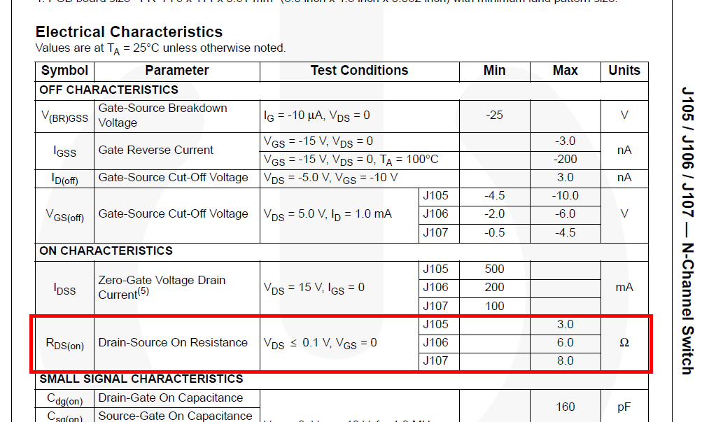

This is a JFET, not a MOSFET. The Idss is 20mA, which is the typical maximum current but they spec 50mA max which would be just before the gate becomes forward biased. The DS VI curve rises to about 20mA at about 1 Volt so that part of the curve is about 50 Ohms, but above 1 Volt, it flattens out towards a constant current, ie high impedance.
JFET datasheets often include a specification for Rds_ON , here is one example.
Helpfully they tell you the measurement conditions, which can be duplicated in simulation for silicon-vs-SPICE validation.

Note that Marks data sheet Rds(on) is only for voltages less than 0.1V, ie current less than Idss. This would be useful for switching audio, but not any kind of DC. I liked to use P-channel JFETs for Voltage controlled attenuators like compressor-limiters. In those days I used 2N5460. The advantage of a P-channel is that the gate voltage is positive. A friend of mine used unbuffered 4000 CMOS for this with great success, ie without any supply voltage, using the lower half of the gate(s) only.

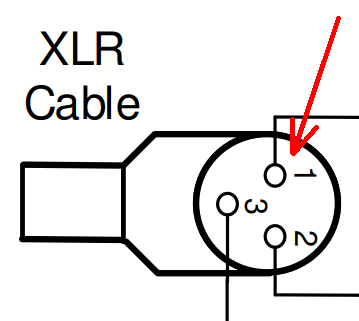

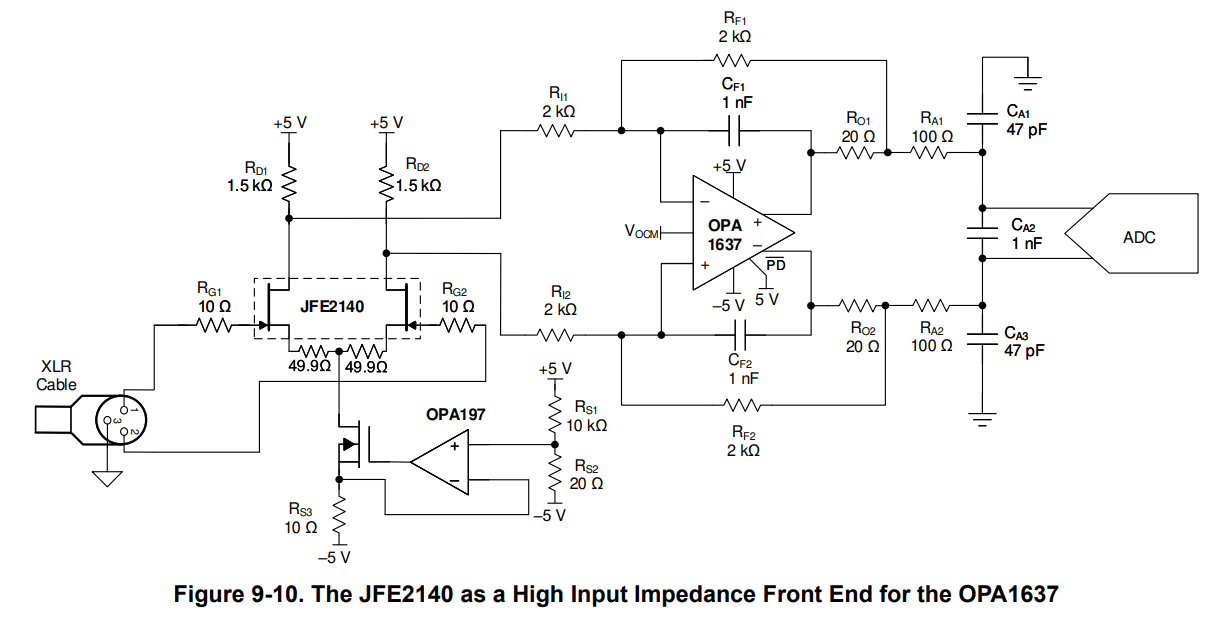

Just a slight pointer, idk if it has been mentioned before:
JFE2140 Datasheet, Figure 9-10, Page 18 - Consider checking the numbering on those XLR pins. I am hoping nobody would blindly copy it like that since every audio electronics designer knows the XLR pinout, but maybe put that on the to-do-list for the next datasheet revision.
Aside from above mentioned issues:
The JFet pair is running open loop and 1mA / device with 2 x 50 ohm source resistors. At anything above a few mV IP swing there will be quite a bit of distortion compared to a similar closed loop circuit.
At 1mA it is quite a way off the zero tempco point = thermal distortion. I'd be running around 6mA / IP device, close to zero tempco point, should result in about 10 to 20 x lower distortion.
Obviously have to bump up supplies.
