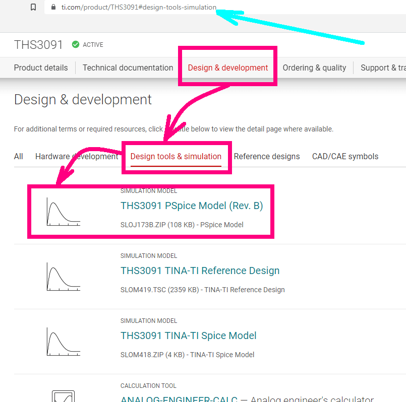

This does not really belong into this thread, it's just that I need it for an 2140
amplifier: Is there somewhere a Spice model of the THS3091 CFB opamp ???

The advice offered by @BrianL in post #256, seems to have worked for me.

Thanks, I did find a zip archive somewhere on ti.com that
had lots of binaries and in a folder "timing simulation", there
was a netlist that included the model inline.
I snipped it off and put it into /d/libs/spice/gerhard_opa.lib,
but did not yet try it .
