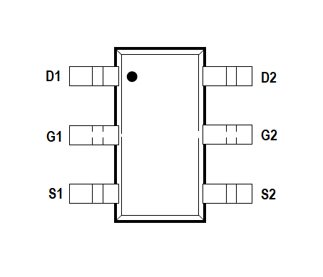

I updated my original post, but I thought I would add it here as well. The matched pair: JFE2140, is now available on ti.com: JFE2140 data sheet, product information and support | TI.com

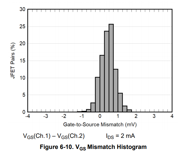

Mismatch between VGS (spec'd at 2mA drain current) is 4mV max. IDSS of the two JFETs is spec'd to match within 5% (min/max).
Nice John, thanks TI. Like that the so package is pin compatible with the LSK389. And the lower price 🙂
And with the half transconductance I asked for, resulting in lower input capacitance. Perfect fit for a couple of future projects.
That is worse than Toshiba decades ago where 2SK389 / 2Sj109 are specified at 3%.
The majority of them measured below 1% actually.
I am sure TI can do better.
Patrick
We specify our datasheet min/maxs 6 standard deviations away from the mean for a parameter like this, which means its an extremely conservative limit. Most companies are nowhere near as conservative, but when you have a non-obsolescence policy like TI, you have to be conservative to ensure you can meet the datasheet limits over multiple decades at high production yields.
Here's a great example, notice that the VGS for 2mA ID is spec'd at 4mV max. And here is the histogram from the datasheet, notice where 4mV is on the x-axis.

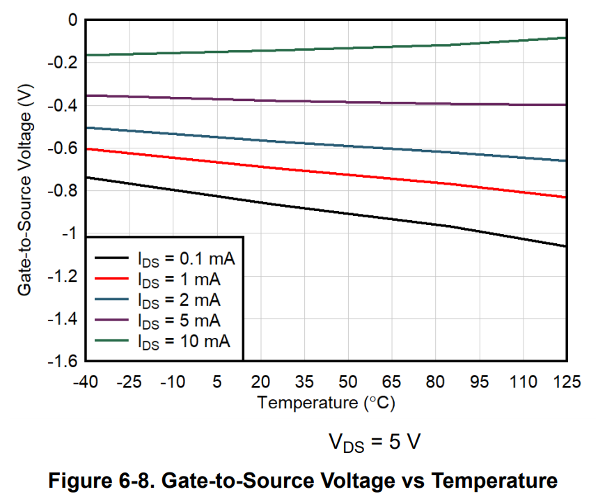

I think figure 6-8 in the datasheet is the closest to what you're asking for. It plots the VGS vs temperature for a given drain current. Looks like about 5mA of drain current is the closest to a zero tempco. Interestingly, at the highest drain current (10 mA) the tempco is positive, while the lower drain currents show a negative tempco.
