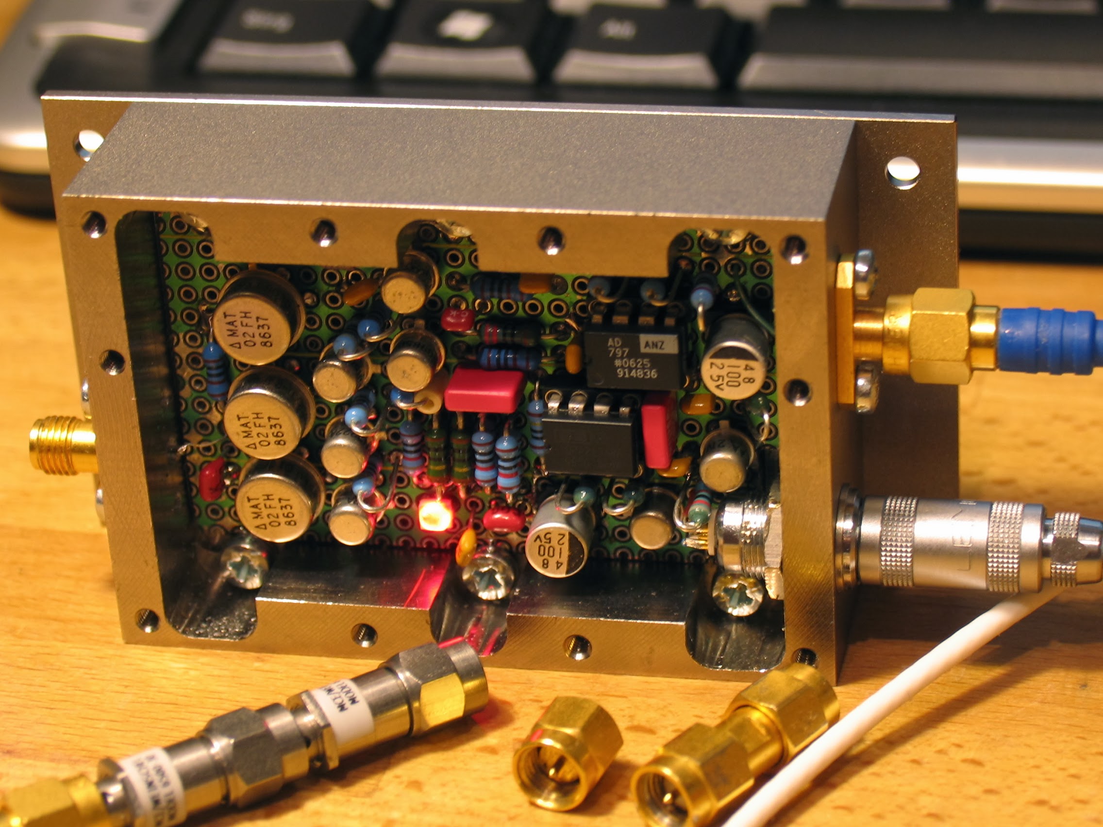

THAT has nice ones too, with NPN and PNP arrays. If burning amp happens (I can't make it) I plan on donating my stash of MAT02's and 03's in cans along with a lot of other stuff as door prizes or other forms of give away.
Look at the date codes. I had them 35 years in the drawer until I decided they were not too precious to be actually used for something.
Cheers, Gerhard

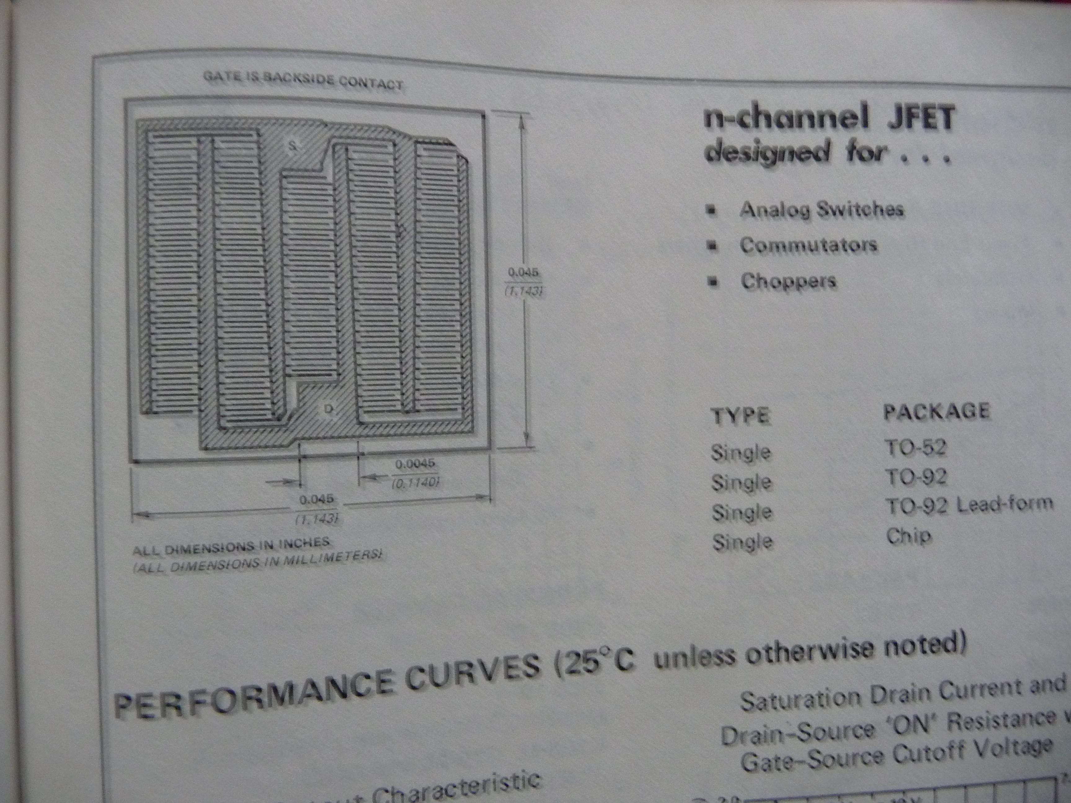

these are NIP and NVA geometries from 1976 paper datasheet edition from Siliconix 😉
So my question remains : bandwidth vs. noise, wich did you choose for your "new" FET ?!
