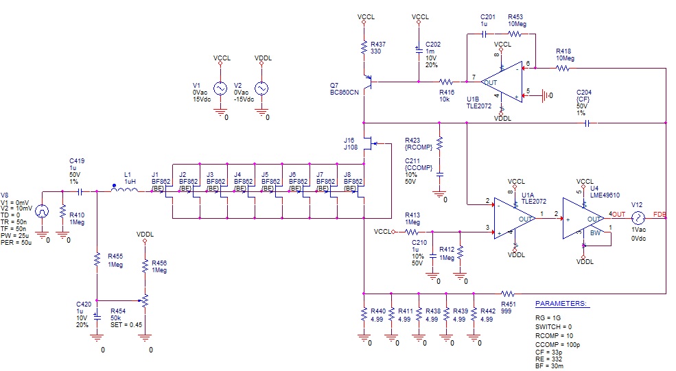

You will be tempted to look upon the JFET stage as CS with its 1 Ohm source resistor. That is true until you close the feedback loop. Then, the FET suddenly feels like it is used as a follower. Input to the gate, drain looks into the low impedance cascode and the source follows the input ac-wise. Closely, like there was a large source resistor.
But the fed-back voltage has a phase shift. Voltage at the source lags the source current. Just like there was a capacitor on the source node. And we all know what capacitively loaded followers want to do: oscillate.
When you measure the Z of the input, you see a smallish capacitance in series with a negative resistor. The mechanism is in every text book in the chapter of LC or transmission line oscillators for VHF or above. Standard circuit for this app.
You can heal that by slowing down the FET by Millering it to death, probably at the cost of the cascode stage but you will have to accept high effective Cin and low bandwidth.
The other solution is to speed up the loop. Replacing the loop gain opamp with a VCVS works really good, unfortunately it is hard to solder in. Two fast-ish opamps with less gain and phase shift each seem to work better than one. A THS4307 (??) got it stable in a 1 MHz amplifier but its horrible 1/f noise could not be masked by the FET stage, destroying the purpose of the amplifier. And a 1 MHz amplifier in front of your scope does not give real bragging rights?

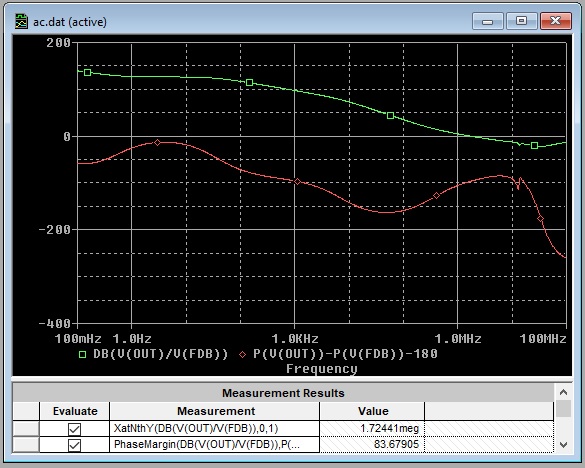

See my article. It’s quite stable. I don’t recognize some of the issues you raise as insurmountable. I used 110 Ohm source R. Since the signal source is highly inductive, the overall noise contribution with this approach is about 0.2 dB over that of of a 10 ohm source R.
Might be this topology is a dog if you’re trying to build a wide band amp, but an RIAA pre is not wide band since you have two poles in the equalized response.

Since apparently you skipped the measurement results in the same thread, perhaps a simulation will do? So is it stable?
That is not the circuit from your website where I secured the evidence above.

And the loop gain of the large loop says nothing at all about stability when you omit the inductor on the input that defines the oscillation frequency together with Cin and -Rin.
Nobody questioned that it is stable as long as you leave the input open.
That is like claiming that your black powder is completely safe when you avoid adding "But don't put it on fire!"
The IF3602 amplifier I measured above on the network analyzer used the same problematic but often seen architecture, just a different bias servo. It is stable for most things connected to the input, even with all IF3602 dual slots populated. It also does behave on the network analyzers 50 Ohm port. At the marker frequencies, the s-parameters are decoded to Ohms and pF. (post #53 in this thread)
At Marker 1 @250 KHz, the input resistance is -144.28 Ohms in series with 1.296 nF. It's an exercise for beginners to calculate the inductor required to oscillate there. Remember Thomson? omega, L, C ?
You can stabilize it with a > +145 Ohm gate stopper. Other frequencies may require more.
Easy solution. Unfortunately, 145 Ohms add 1.5nV/rtHz noise density which makes the ultra low noise amplifier futile.

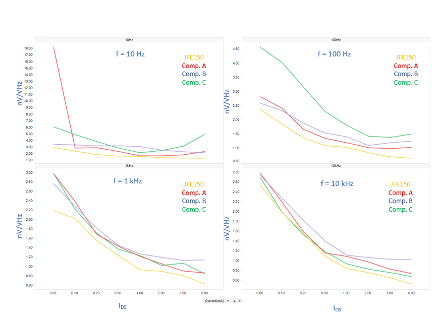

1. What are the improvements in terms of noise compared to the 2SK3557? It seems that both voltage and current noise are practically identical in a wide range of I-DS.

1) See attached for data comparing several devices in the same Ciss/voltage rating to the JFE150. This data was all taken on the same system and configuration.
2) We do not guarantee noise, however we do test other min/max specified parameters such as IDSS/IB/VGS that have a strong correlation to noise performance.

Thank you for sharing this interesting info Mike.
Some additional requests (my apologies if I am taking advantage of your kind generosity 😀):
1. Can you share a graph comparing voltage noise vs. frequency plots of several of your components (will help to evaluate the variation between components)
2. Can you share a graph of the current noise vs. frequency?
3. Can you share info about noise variations over temperature?
4. Can you share info about transconductance variations over temperature?

Interesting. In both 1KHz and 10KHz charts (so allegedly far from the noise corner frequency), the TI device seems to exceed the simple theoretical variation of noise vs. Ids, which is Vnoise~Ids^0.25. In fact, all commercial JFETs (currently dead or alive) I’ve seen have a much weaker dependency, of around ^0.15-0.2. Otherwise said, noise increases less than expected in a first order theory, when the drain current decreases.
Can you explain this behaviour? The impact is that using these JFETs at low drain currents will affect the noise performance much more than expected with other low noise devices. This is in particular important, since using your devices @Idss is hardly possible, due to power dissipation thermal effects (long off topic story here, and it’s not about temperature effect on the noise, that’s not an issue within limits).
