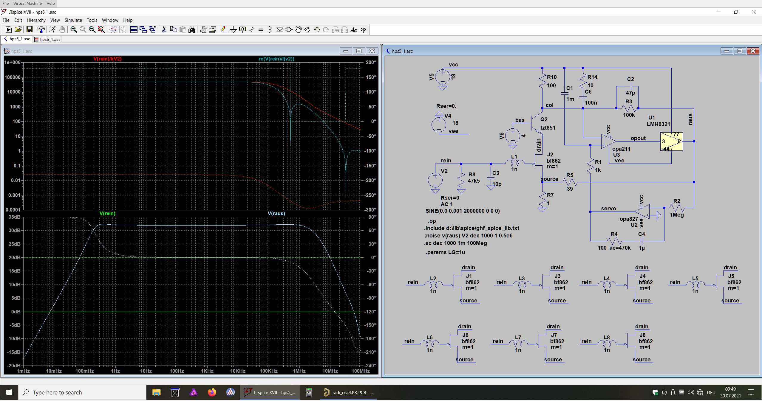

This architecture with the feedback into the source is often seen, but a bad idea. It works with an ideal VCVS, but not with a real live opamp.
Worked and works for myself, Scott Wurcer, Dennis Collins, Samuel Groner, and hundreds of others that built precision LNAs or MM/MC preamplifiers using this topology (and almost always with inductive gate stoppers). I’ve reached to the conclusion that nothing earthly would convince you about this reality (certainly photos, measurements, published articles, did not help), so I gave up. You are entitled to your own, private reality as much as anybody else.
P.S. Here’s an 11 years old interesting exchange on this topic, for your perusal: https://www.diyaudio.com/forums/sol...te-low-noise-amplifier-lna-8.html#post2188150 Not that I’m hoping you will ever change your mind, of course 😀.

The claim that it works for you is contradicted by your HPS5.1.
It has -1000 Ohms real part at 800 KHz.
And it does not matter if the gate inductors are 1n or 1u.
That it is negative is shown by the 180° phase flip.
Input impedance is Vgenerator / Igenerator, the function re() delivers the real part of a complex value.

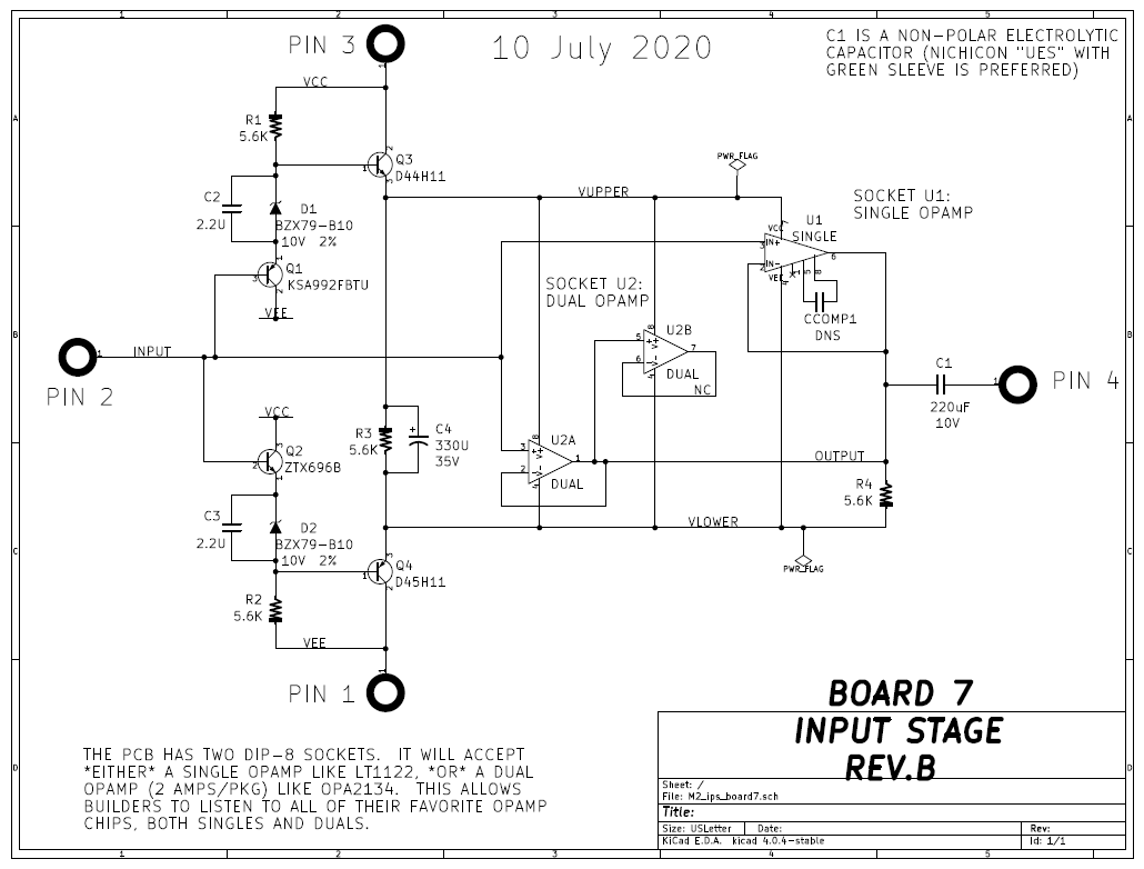

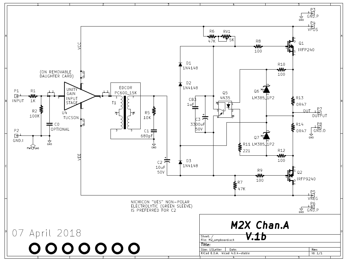

Regrettably the BUF802's output swing limitations prevents it from being used in an M2x daughter card. We can work around the crummy PSRR and the lamentable input offset voltage, but the requirement to swing a 9.3V peak-to-trough sinewave, ain't possible.
... Unless we bootstrap the supply rails as is done in M2x daughter card #7.
But that gives me a queasy feeling at these bandwidths.

Because it oscillates nicely with the right inductance or cable on the input.
And if it didn't happen by chance or went unnoticed:
Absence of evidence is not evidence of absence.
Both the simulator and the network analyzer are clear about that.
Don't tell me nobody can hear that. Maybe you smell it in combination with one of these
ultrafast VMOS power amplifiers, from the place where the tweeter used to be.
Unstable amplifiers are broken, and negative input resistance is unstable.
