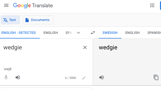

Not often I don't have a clue of what you are talking about and Google hasn't got any translation either.Good because the TI Store has a hopelessly intractable wedgie in its under pants.
