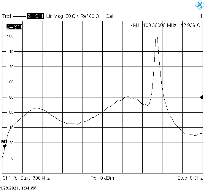

That it has no dissipation at DC where Z==0 does not mean it has no dissipation on frequencies where it has Z==1K, mostly real.
Unfortunately for beads, the nominal impedance is measured at 100 MHz. But you may need it at 100 KHz, where it is MUCH MUCH smaller.
This here is a 10 Ohm Murata bead which I measured when I needed to calm down an Infineon BFP640 BJT, where it does a wonderful job at a few GHz.
At the nominal 100 MHz it features Z==13 Ohms, as would be expected from the data sheet. At 100 KHz, the impedance is zero. In the plot, even the 100 MHz are very close to the left. Higher Z beads are similar in proportion, I can measure some if there is interest.
But at f==0, the result is the same.

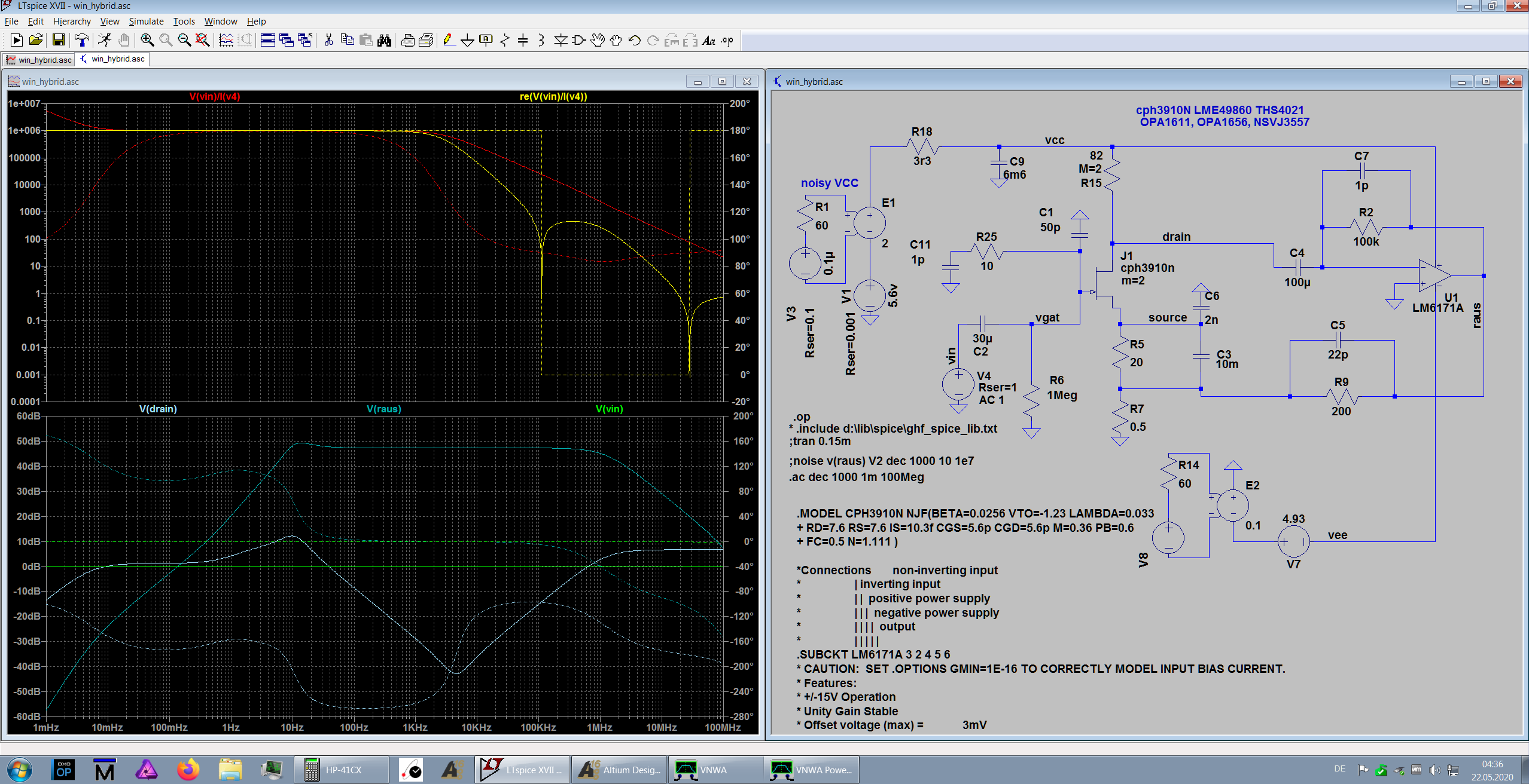

In this circuit, you would need a few 100 Ohms at 200 KHz to stabilize it, a thing that ferrite beads cannot deliver. And if it would look like few hundred Ohms at this frequency,
it would also create thermal noise like a few 100 Ohms. You cannot fool thermodynamics.
The circuit example is from an text book whose authors I regard highly.
Gerhard

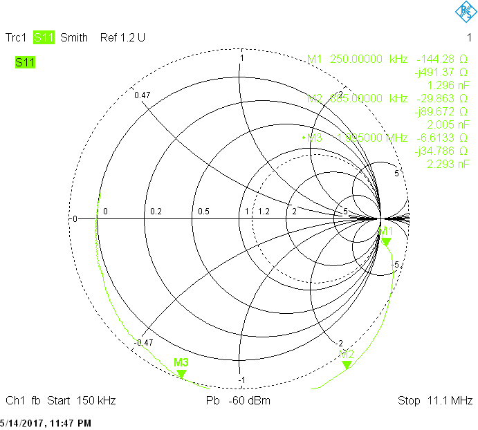

And the neg real part is a reality, as you can see in this measurement of an IF3602 adventure of mine:
Sorry for light green on white, the green on black of the VNA screen looks better.
At the 3 marker frequencies, the s parameters are decoded to Ohms and pF in series.
This architecture with the feedback into the source is often seen, but a bad idea.
It works with an ideal VCVS, but not with a real live opamp.
