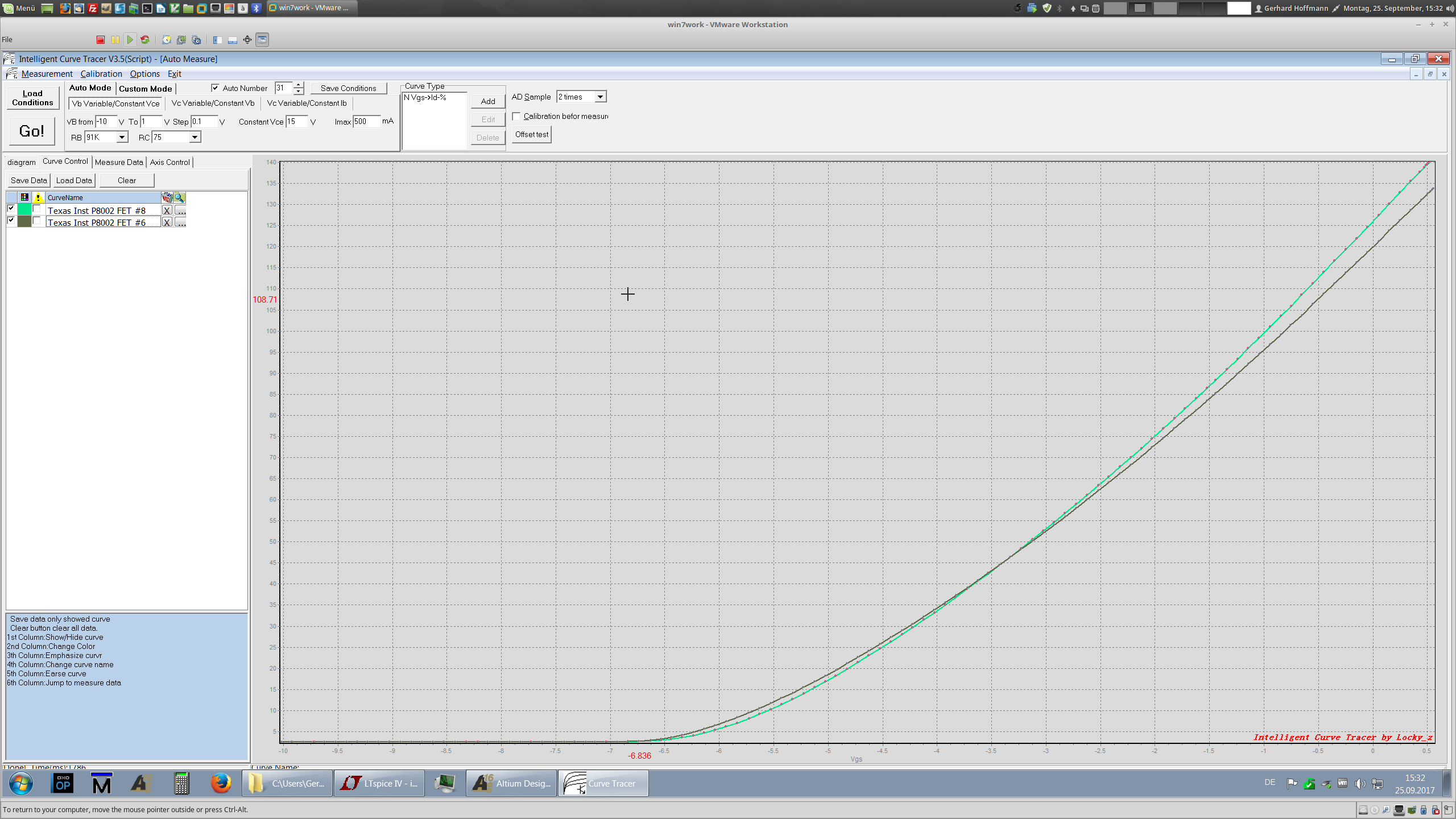

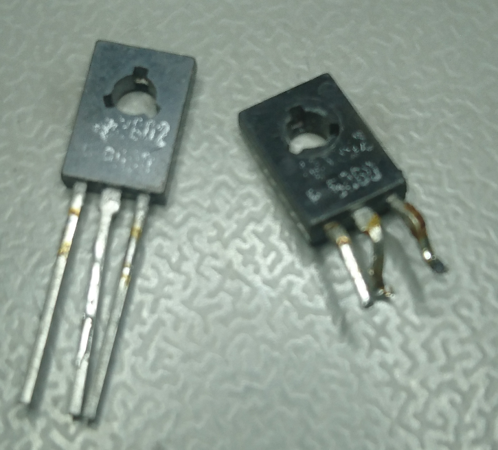

Is this here what you want? TI P8002
You are 45 years late. OMG I'm growing old.
P8000 in TO-220 were unobtainium already then.
