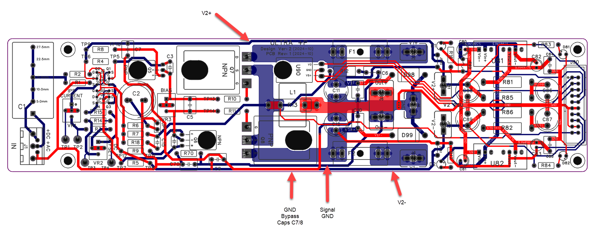

I do not use auto-router. I don't think its not a realistic tool for audio layouts. Routing is time consuming. This is just a hobby for me, so I'm not very efficient at it. The end result may be good, but it takes me awhile. Users that do this for a living like @prasi would likely come up with a much better layout in about a 1/10 of the time. I also always end up with vias to move traces between the top and bottom layers. Prasi's boards rarely have this - he is truly gifted.
I spend a lot of time on the ground routing as I feel this is an area that is often neglected. I use the approach that the Wolverine boards use.

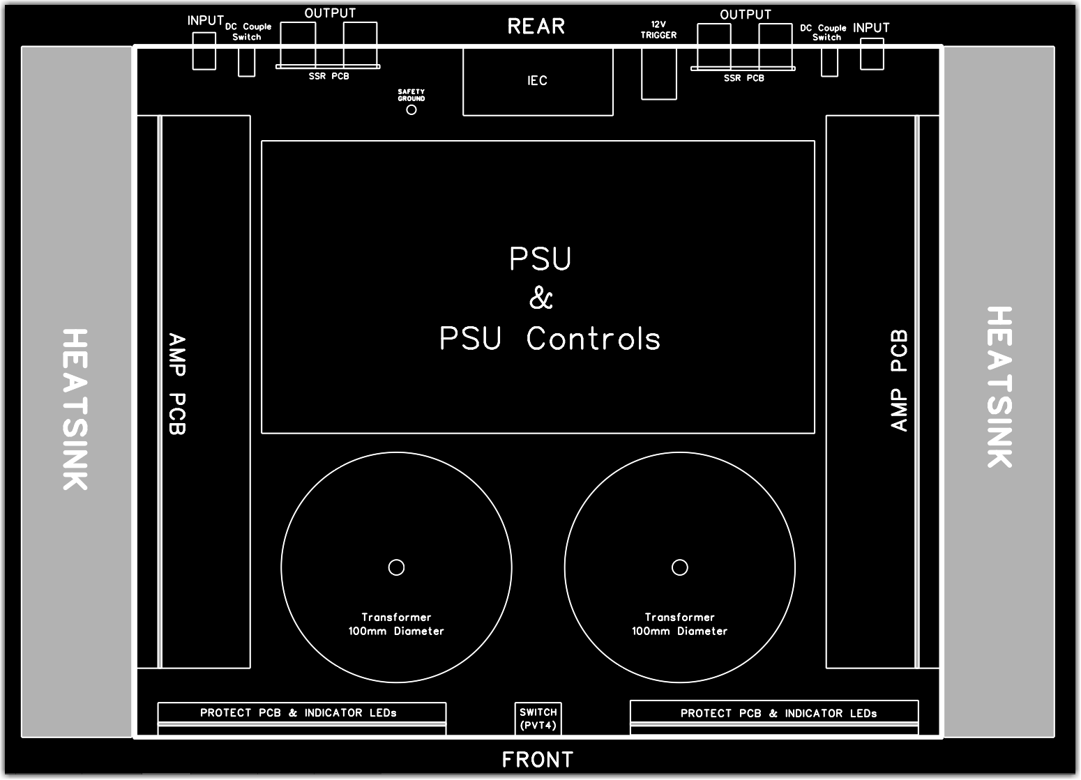

My layout is oriented toward a chassis with side mounted heatsinks. I think my boards are too long for your approach. But if you think they'll work for you, send me a PM.
Reactions: U102324
I generally don't like the hot-rod look with heat sinks on the sides. I think another alternative would be that of two heat sinks inside with input close to the back plate. I will do some fitting using pieces of paper since I have a box that I want to use. I think I showed in an earlier post. All that I have is time, so I will keep myself occupied for a while. I hate making things on the fly, it becomes too expensive. Unfortunately mistakes are costly because anything I do is per contract. I do not have the capabilities any longer to do what I like with my own hands.

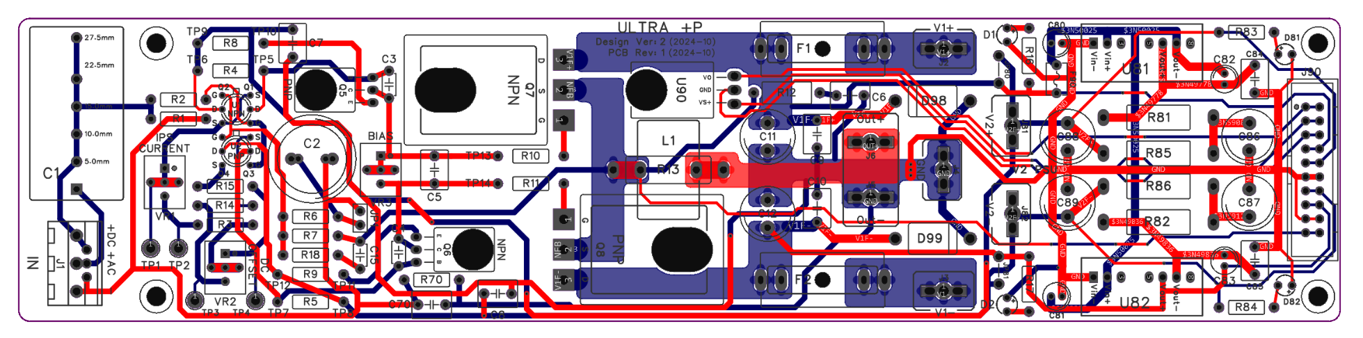

I'm about the send the new boards off for production and was doing a final review. Question for the Layout Experts on reducing ground loop area.
The V2+ trace is running on the top of the board. I think I can reroute this to run on the bottom along with the ground and V2- traces. I think this would reduce the ground loop area going to the IPS-VAS. Does this sound right? Is this something I should take care of before sending it off?
@Vunve, Board dimensions are 55mm x 240mm

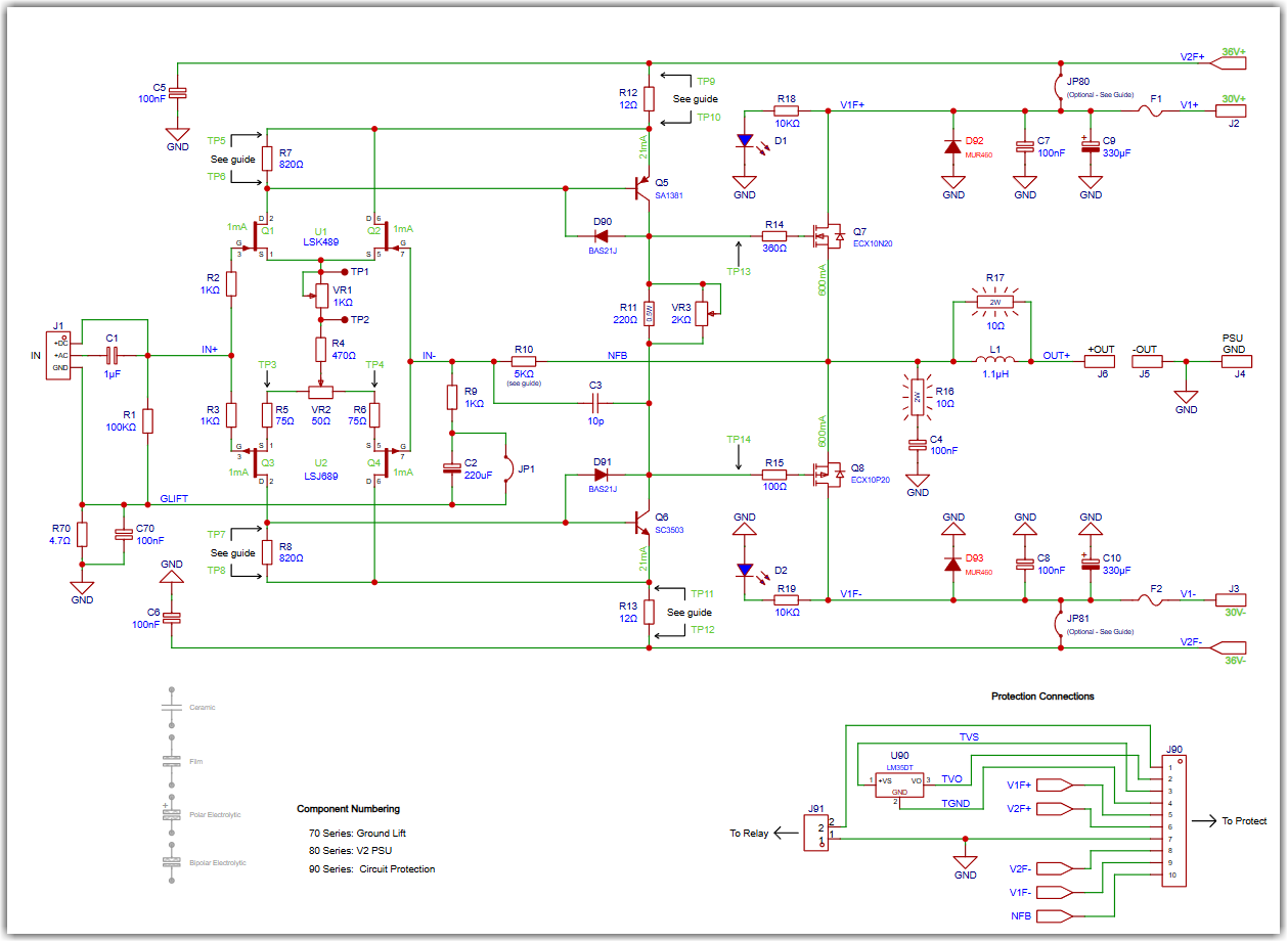

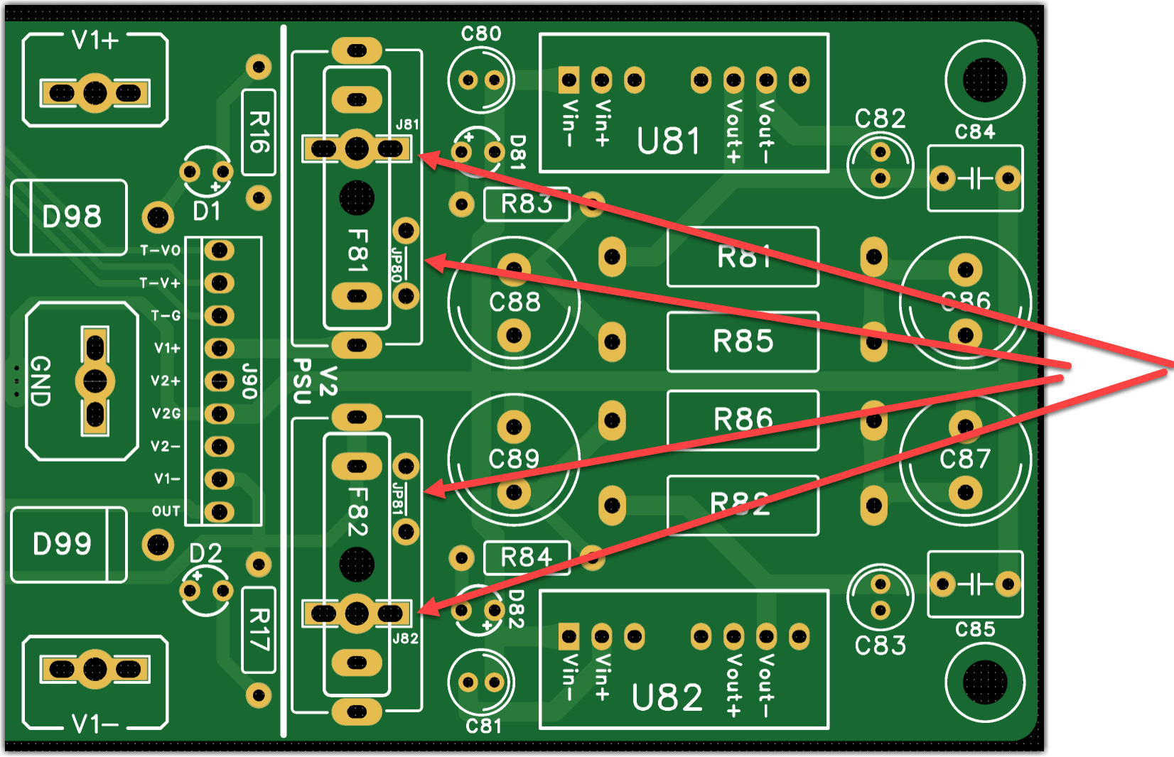

Interesting thoughts on F81/F82. I did try to simulate different failure mechanisms, including one of the rails failing or the output being shorted. In those cases, the DC-DC converter current draw increased but did not exceed its limitations. One of the reasons I used the larger SIP8 devices is to allow enough dissipation to survive a fault condition. Perhaps the additional fuses are unnecessary. The board size probably won't change much though. Within the footprint for the fuse blocks F81 & F82 are connectors J81 & J82. These provide a pads for tab quick connects if the builder chooses to use an external V2 PSU. There is also jumpers JP80 & JP81. These allow a builder to omit the V2 PSU and provide power from the main rails. I can reorient these and maybe shave a few mm's off the board size, but not much.
You wrote Gate diodes D92/92,94,91... do you mean diodes D94/95 and Zeners D92/93? These are not included in the Exicon to my knowledge. I thought it was D96/D97 that are redundant for the Exicons. As the datasheets don't seem to explicitly show the diodes, I thought it safer to add them as optional components. In either case, these are not necessary for the amp to function. A builder can choose to omit these. This is discussed in section 5.10 of the guide. Omitting D96/D97 has been brought up before. It wouldn't really affect the layout much, so I opted to leave them in as optional.

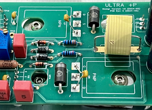

C13 and C14 may not be needed. Sims do not indicate they are needed, however many builders on this forum using Exicon laterals have indicated problems with oscillation in practice that don't show up in sims. I thought it safer to add them. When I assessed them in simulations, the impact on THD and slew was very small to non-existent. This is mentioned in the build guide in section 5.2.
R10/11 are recommended at 330R/220R for TO-247 and 220R/150R for TO-264. Similar to what you are recommending.
I have built several amplifiers with exicon lat mosfets. With 10P and 10N I always had oscillation problems if I didn't put C13 and C14. In the first few times I set 100pF but later I verified that 47pF is enough and the amplifier appears "less slowed down".
Curiously, with 20P and 20N I never had those problems and it was never necessary to add c13 and c14.
Hi adiaz,
Yes C13/14 have been a point of long discussions. I did remove the from the schematic. However, the boards did not have pads for them. They mounted into the pads of the MOSFETs in the original PCB. If they end up being needed, they can easily be added back.
My plan was to build with the new boards without them and check for any hints of oscillation. If needed, I'll add them back starting with a lower values.
Here's a picture of how they were implemented on the original boards.
Reactions: adiaz and U102324

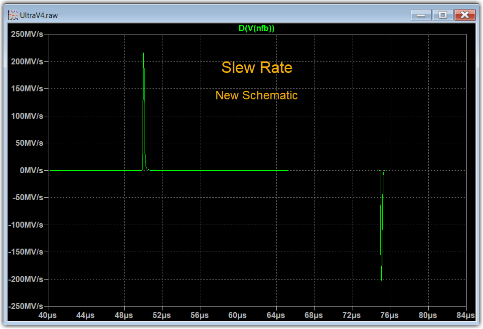

An overdue update:
I put the boards into production, but canceled. This was after finding a few things in simulations.
  1. The IPS rails now connect to the VAS emitters. This reduces high frequency distortion resulting in a 5dB to 6dB reduction in IMD.
  2. The input gate stopper has been split into two 1K resistors. This provides a small reduction in high frequency distortion.
  3. Anti-Saturation diodes have been added to the VAS. This provides a small improvement in clipping behavior. It might be more pronounced in real life. I understand that the models for SC3503/SA1381 don't model quasi-saturation well. These can be left unpopulated if the builder chooses.
  4. The bias trimmer VR3 now has a resistor in parallel. I found that when shorting the outputs, dissipation pulses were high enough to potentially cause failure of the trimmer. Paralleling with a resistor reduces dissipation across it and also allows the bias to be adjusted with greater sensitivity.

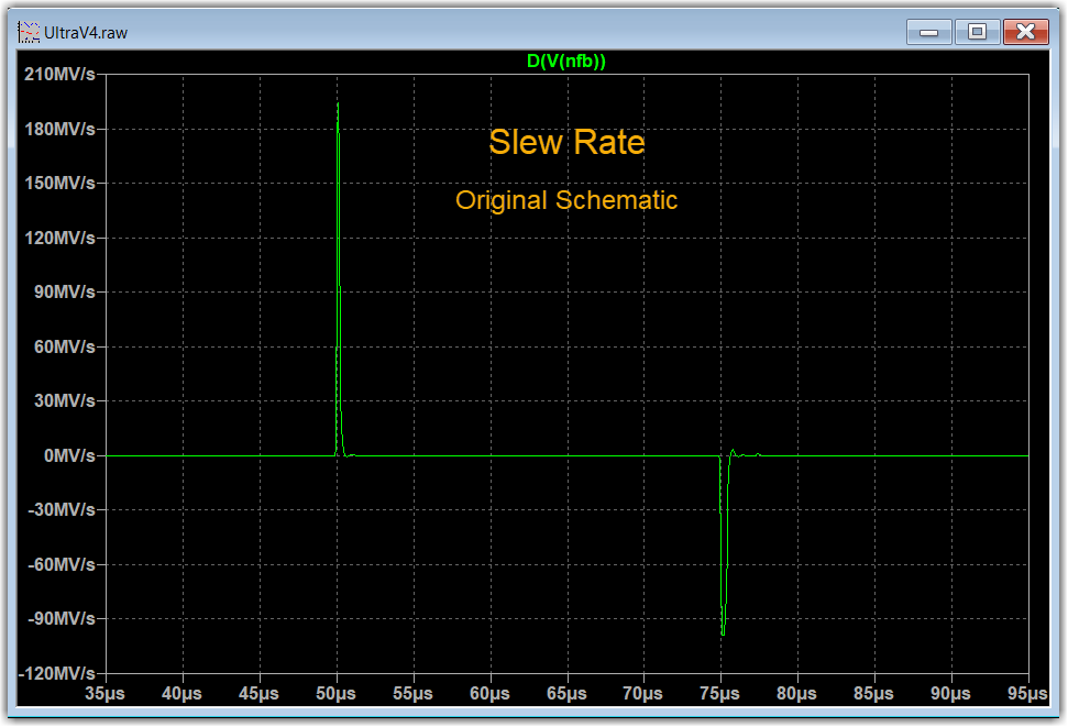

  5. Compensation has been changed to input-inclusive compensation. This requires fewer parts, has very similar THD performance and improves slew rate. It also has a lower ULG frequency for the same gain margins.
  6. The values for the MOSFET gate stoppers have been updated. I don't fully understand this one. By lowering the value of the P channel gate stopper, negative slew rate improves. High frequency distortion also drops. The resulting pole in the P channel MOSFET is still lower than the ULG frequency, so I think this is safe.
  7. One of the unused pins on the protection connector has been used to add a connector for a relay. This connector will placed next to the input connector. This makes wiring a bit cleaner if the protection board is at the front of the chassis and the output relay is at the rear. I attached a sketch of how I envision the chassis to be laid out with these boards in a dual mono configuration.
  8. The changes allow for the C1 input cap to increase back to a 37.5mm pitch footprint.
I should have the changes to the PCB completed this weekend and I'll send the off for production.
In addition to the amplifier, I'm working on:
  • PSU with controls. This supports a dual mono CRC PSU with switch driver, 12V trigger, soft start, thermal switch and mains DC blocker. Design is complete and tested with breadboard. Boards are done. Working on a test build. The mains DC blocker is based on Bonsai's design.
  • Output SSR board. Design is complete. Boards are done. Working on a test build.
  • Protection circuits. This will include clipping detection, thermal protection (works with the PSU to disengage Mains relays), and DC Offset protection. These are based on Rod Elliott and Bob Cordell circuits. Still working on the design and breadboard testing. Boards will include indicator LEDs and will mount to the front panel.
