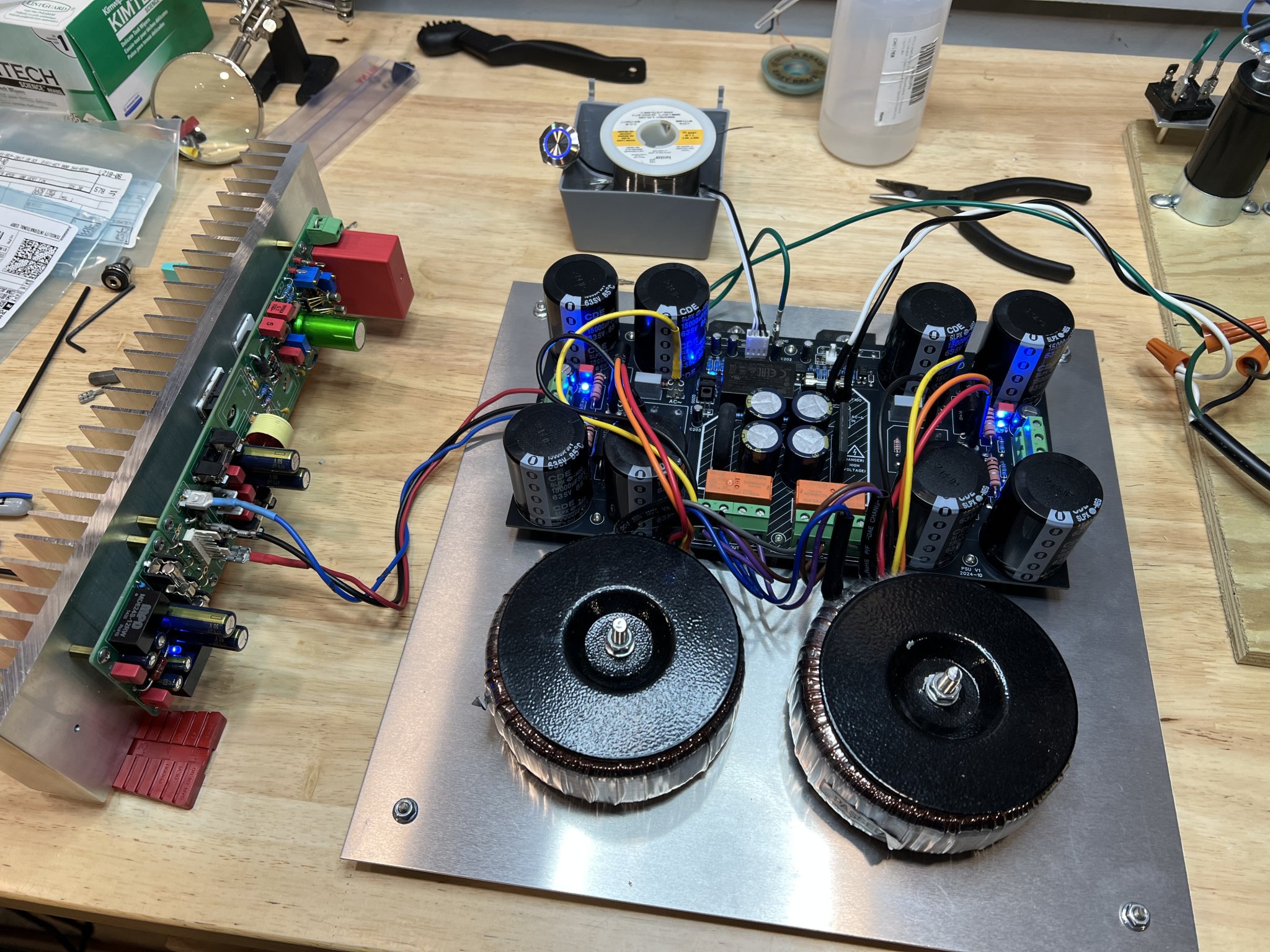

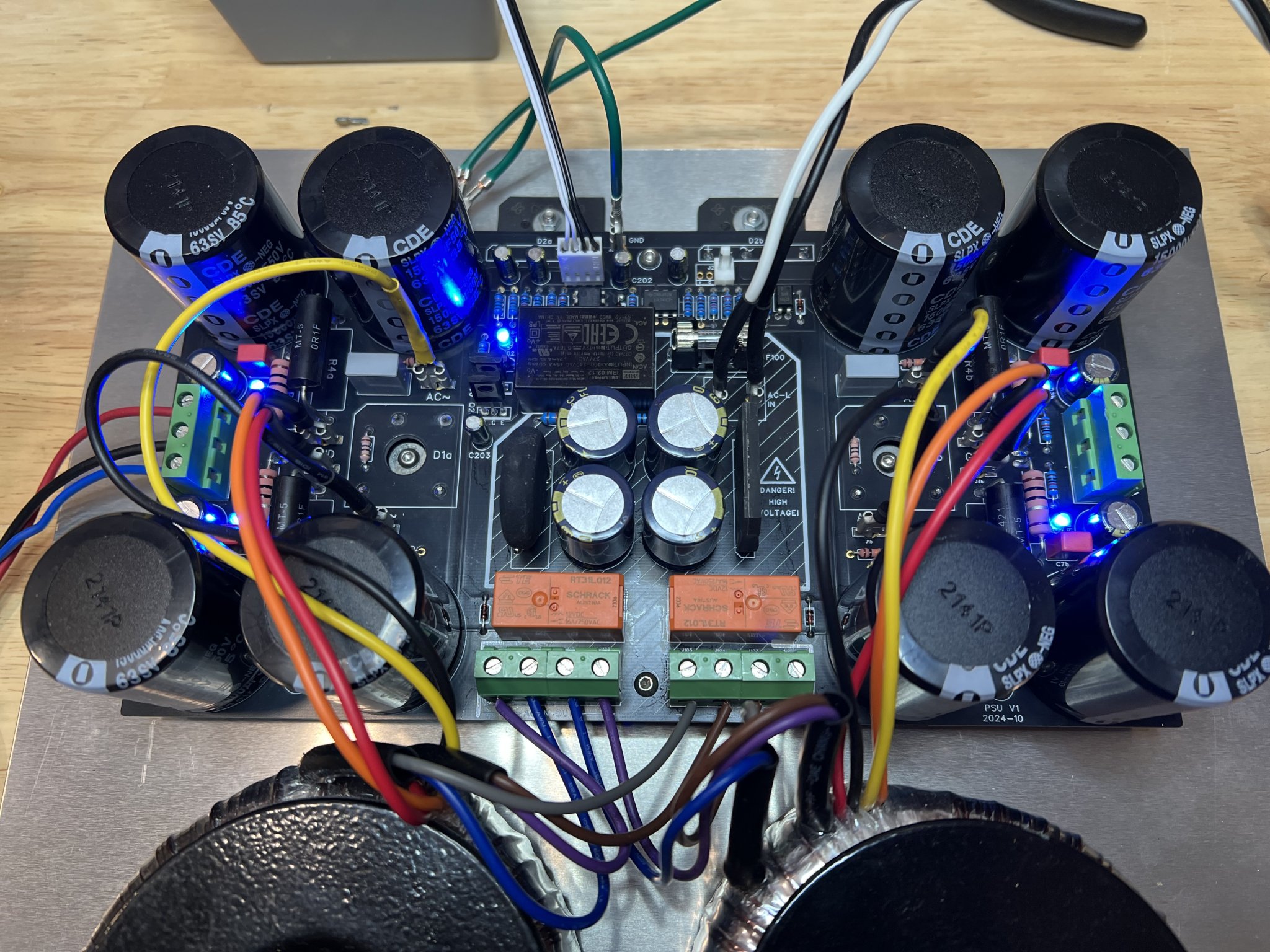

While waiting for the new boards to arrive, I got my power supply build and tested. Well, a quick test anyways - no magic smoke released. This was a test to ensure it all works before buying the chassis. This should all fit into a 300mm deep, 2U, rack width chassis.
It's a dual mono CRC PSU with:
  • Each PSU based on DIYAudio store Power Supply. It has 15,000uF x 2 per side per rail.
  • Dual Mono Ground Loop Breakers
  • Mains DC blocker (based on Bonsai's iSSDCB)
  • Control Circuits
    • Always-On 12V SMPS for control circuits
    • Momentary switch driver (based on Rod Elliott's P166)
    • Soft Start (based on Rod Elliott's P39)
    • 12V Trigger (based on Rod Elliott's P156)
    • Thermal Interrupter (uses an external LM35DT circuit - Bob Cordell inspired)
I'm kinda surprised I could fit this all into a 240mm x 127mm PCB without resorting to SMD devices.

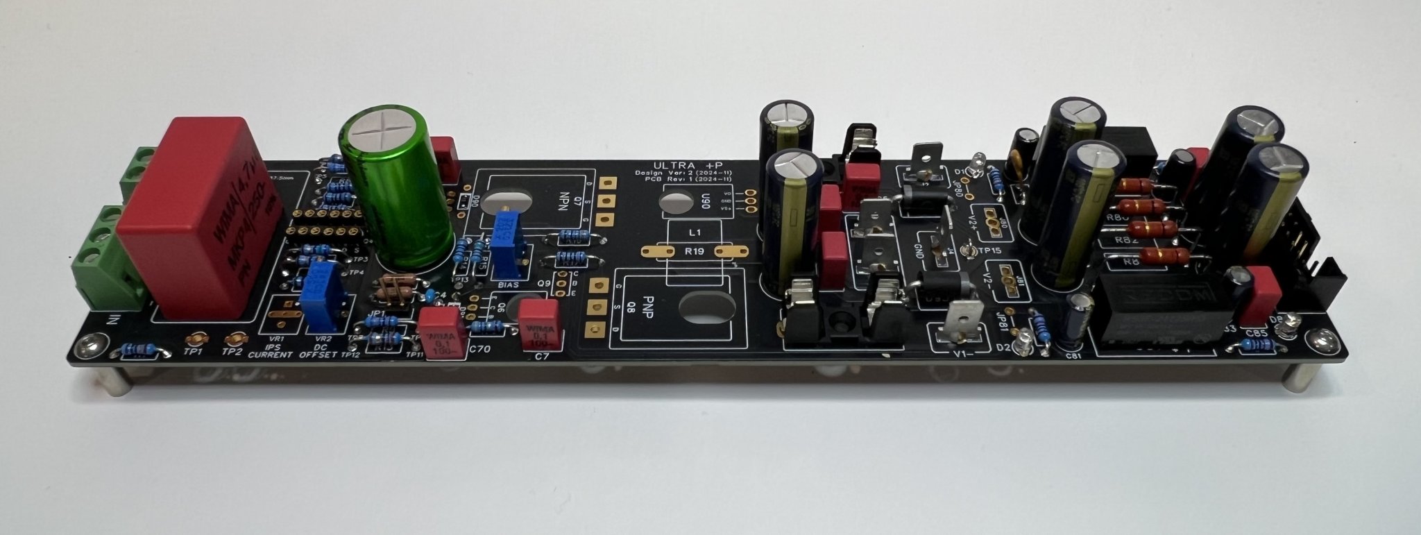

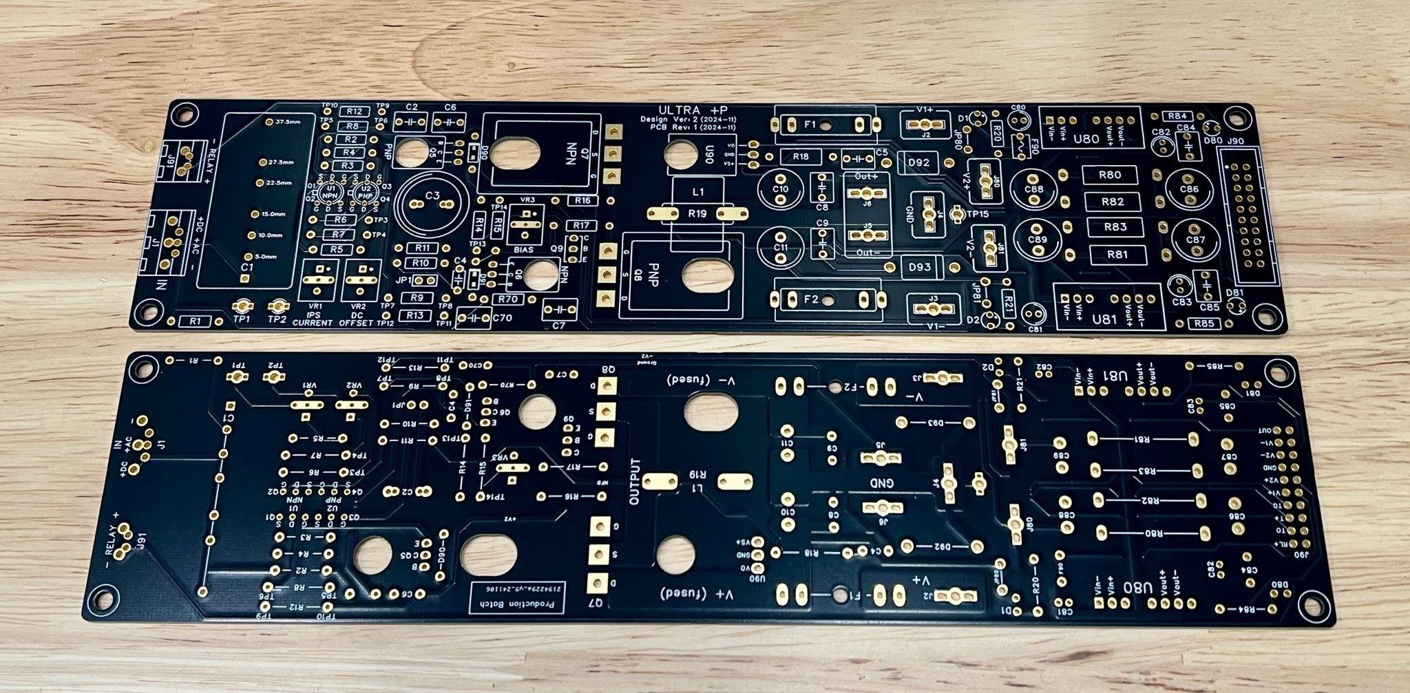

Hi @Vunce,
I did correct the pad size issue on this version. The pads have a 1.1mm hole and will accommodate caps with a footprint up to 42mm x 20mm and a pitch as big as 37.5mm.
The input connector is labeled corrected. It is accommodates a 2 or 3 position connector in 5mm or 2.5mm pitch. The idea for 3 position is to allow for a switch on the rear panel to bypass the input couple cap for a DC coupled input. Take a look at post #142 for more info.
It's interesting... I think the attraction is from the simplicity of the core circuit. But this is also what makes the tuning challenging. It's more sensitive to part parameters. The trade-off for simplicity. Fun project though. Can't wait to till we have several different builds out there to see what people actually think of it.
Hi lineup, the input drain resistors R8/R9 are dependent on the VAS device uses AND the gain of these. My models have a gain of 115 to 125. If the gain is outside of this, you need to alter the resistor values to get the same VAS current. I am targeting for 20mA.
I’m working on an updated guide that will have a table of resistor values to use with different gains.
Test build is getting closer. I missed one pot in my parts order (VR1), so it'll be at least several more days while I wait for that to arrive. Which give me time to get my heatsinks tapped.
I'm using 330U for the feedback cap C3. The 220u and 330u caps are the same footprint and about the same price, so I elected to use the larger cap.
With the lower pole from C3, I'm using a WIMA 4.7U MKP4 for C1 and 100k for R2. Probably an overkill.

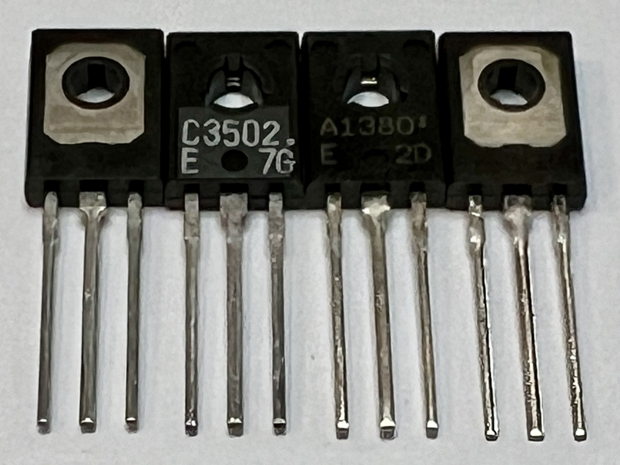

For the VAS devices, I managed to source a large supply of Sanyo 2SC3503E and Fairchild 2SA1380E. These are the lower voltage versions of 2SC3503/2SA1381 with a 200V Vce rather than 300V.
Authenticity on NOS parts is always a concern. The Fairchild 2SA1380E were from a authorized distributor. The Sanyo 2SC3503E were from a reseller out of Taiwan. I tested a sampling from each for gain and breakdown voltage. They seem to be authentic. Gain is in spec (range of 120 to 200) and Breakdown voltage is measuring in the 250V to 300V range.
I've found that these lower voltage parts have a higher median gain. The SC3503E / SA1381E I have on hand all test with a gain in the 115 to 125 gain and not much variability. Two-thirds of these 2SC3502E / 2SA1380E are testing in the 140 to 150 range with some of the N channels measuring over 200.
I plan to use these in the build as a final test for authenticity. If perform well and can hold up to 20mA and 700+mW of dissipation, I'd say they are authentic.
If they check out, I have enough of these to make them available to builders if there's interest.

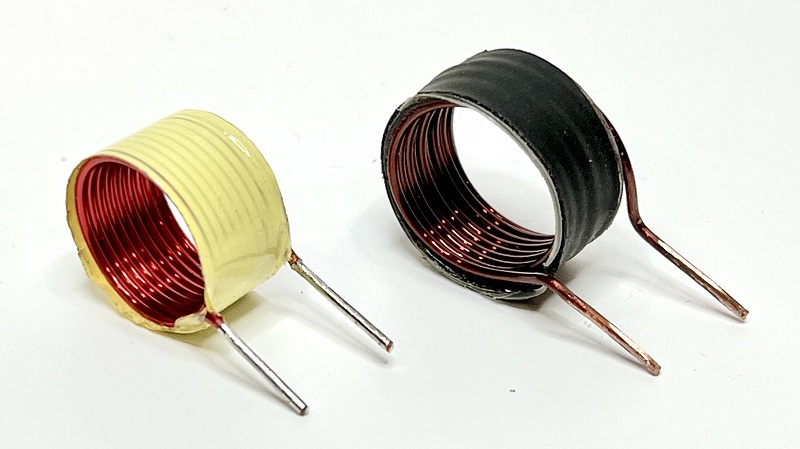

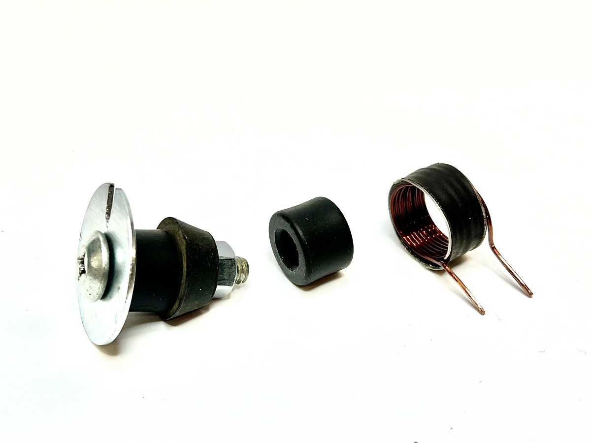

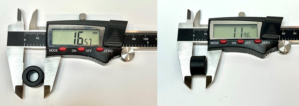

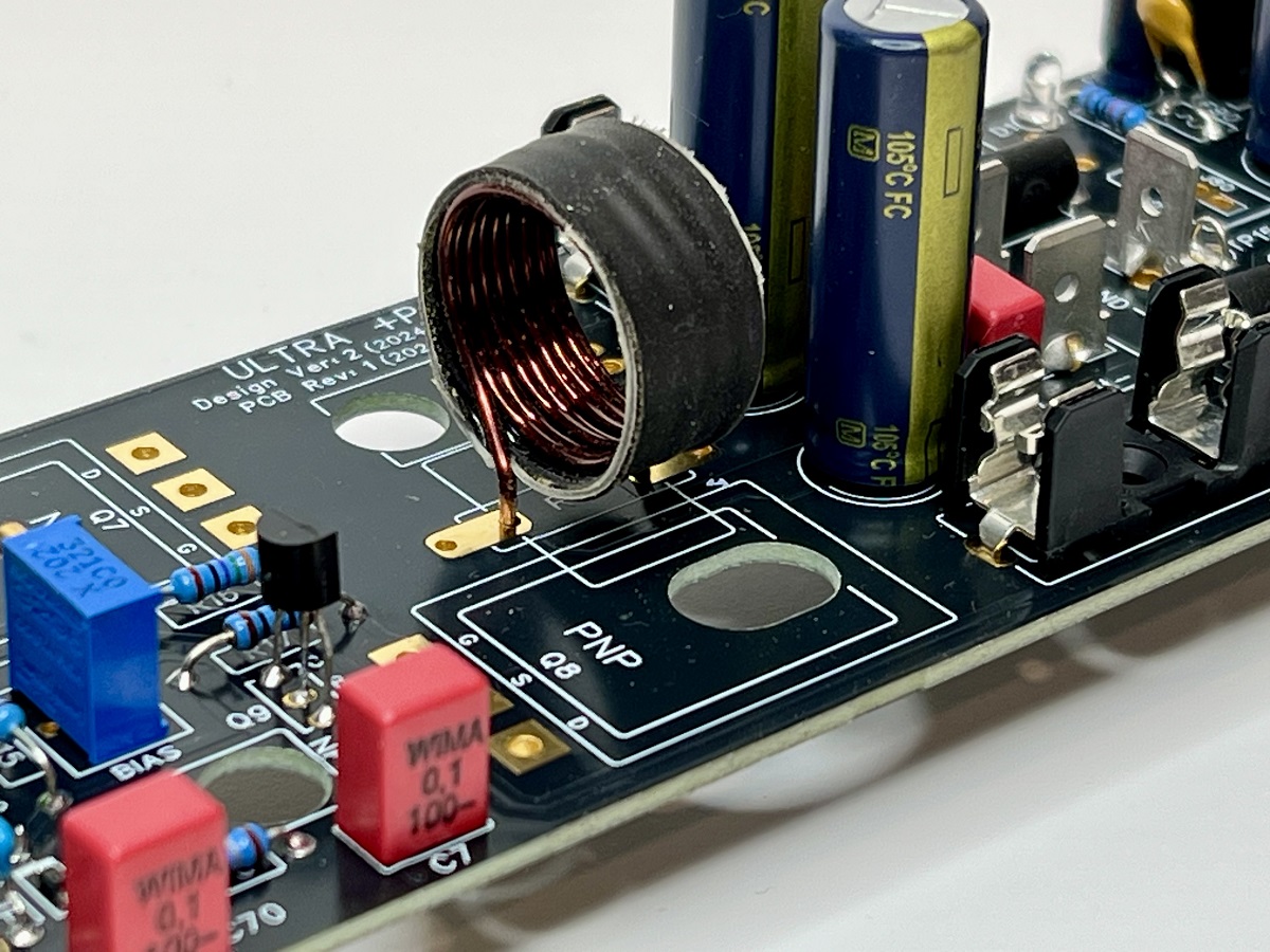

While I wait for parts, here’s some photos of the inductor and the jig I used to form it.
I used a one of those plastic spacers you get with your the TV Wall Mount kit as the former. It's a packet of various bolts and spacers you get when buying a mount. The spacer I selected is 16.6mm in diameter and 12mm thick. I mounted it with a washer on the end that I cut a slot in to hold the wire and then wound it. To hold it together, I used some 3/4 inch heat shrink tubing I got off Amazon. I end up with 11 to 12 turns. After the tubing shrinks, the outer turns are not captured by the heatsink. I peel these off and bend the leads down, then sand off the enamel. I end up with a inductor of about 9 turns for an estimated inductance of 1.35uH and a lead spacing of 10mm. And the heat shrink keeps it tightly wound.
