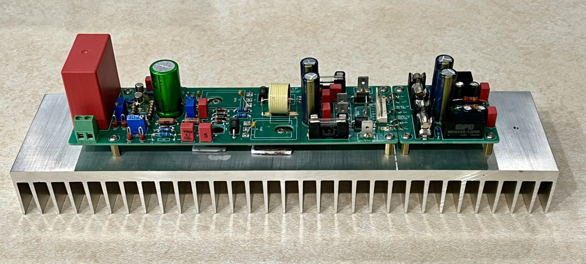

This is my version of the amplifier which differs from lineup's design. Changes were made to address parts availability, stability (thermal & DC), noise, PSRR and protection. However, even with the changes, the spirit of lineups original design is maintained.
PCBs for this were designed to accommodate builds in a chassis as small as 2U x 300mm deep. The nature of Lateral MOSFETs allows the design to run as much bias as the heatsinks will allow. Although it will work in a 2U chassis, as the heatsink capacity increases, the class A region can be increased with higher output bias. Refer to section 5.6 of the build guide for PSU and heatsink sizing and it's affect on the Class A region.
The design is intended for ±24V to ±30V main rails from 18V to 22V transformer secondaries. Though not recommended, it can run as high as ±41V on 30V transformer secondaries. My build uses ±30V main rails running dual mono in a 2U chassis with 600mA of bias. This produces a 5.75W class A region with max power of 40W into 8Ω. Section 5.1.1 of the build guide discusses transformer and OPS device options and their max power potential. Within the recommended supplies, it ranges from 25W to 40W into 8Ω.

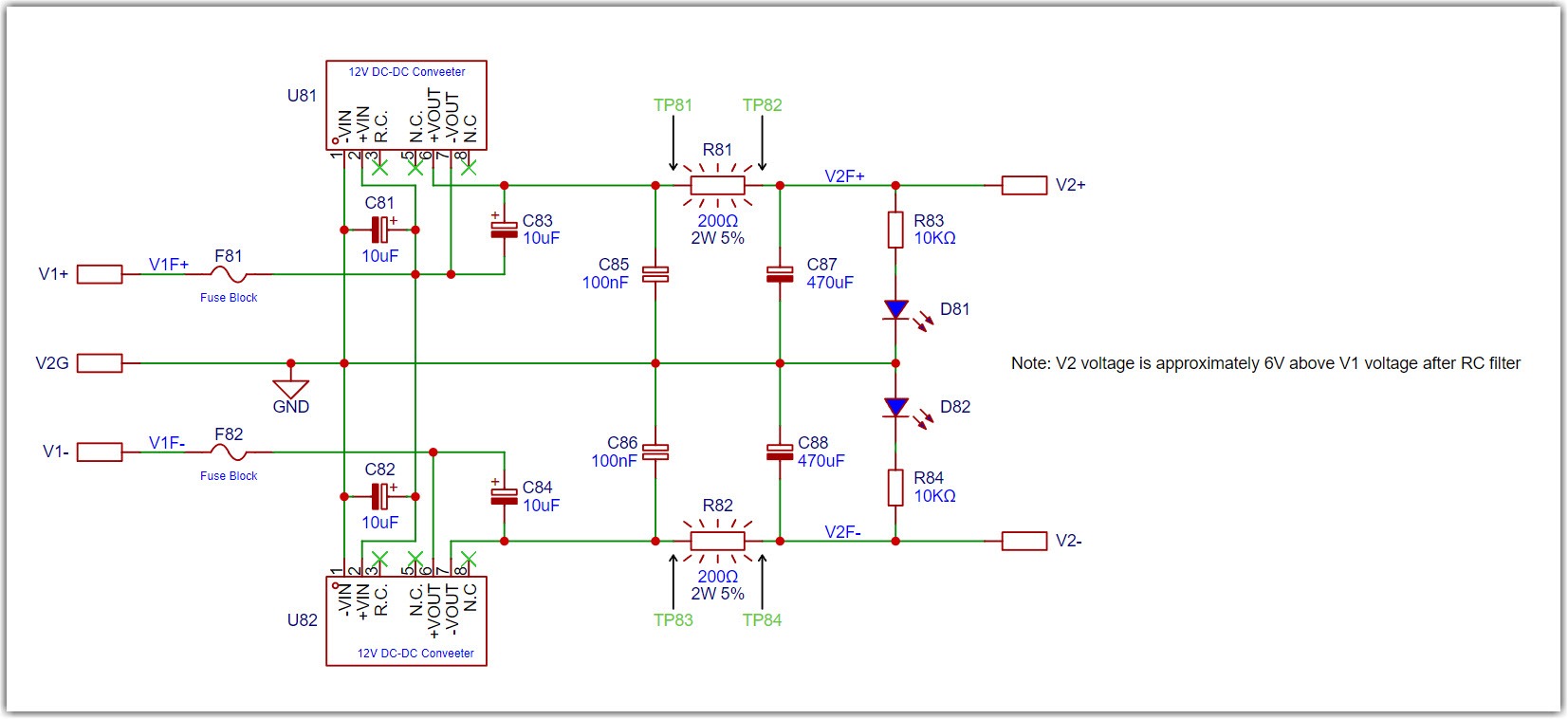

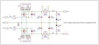

V2 PSU
The V2 PSU concept is a not included in lineups design. From simulations, I found that this design benefits from higher IPS-VAS rails. 5V above the main rails seems to be the sweet spot. Benefits include:
  1. Boosting the ISP-VAS rails allow for an aggressive RC filter which significantly increases PSRR.
  2. Lower distortion at higher power levels.
  3. Increased overall output by allowing the output devices to swing closer to the rails. This also allows for higher bias settings with less dissipation than simply running higher voltage main rails.
#3 above is probably the main reason to use a boosted IPS-VAS section, rather than just higher overall rails. Especially if you combine it with the voltage drop a RC filter on the IPS-VAS rails produces.
The V2 PSU is implemented using DC-DC converters in the V2 PSU PCB. This allows the VS PSU to be established at 5V to 6V above the main rails without the need for additional transformers or a custom transformer with additional secondary windings. I got this idea from Winfield Hill's AMP-70 design. See post #20 in this thread for more info.
The V2 PSU is implemented on a separate board in the initial build for several reasons.
  1. I wasn't certain if it would work until it was actually built. I consulted with the manufacturer on my use case and they couldn't give me a clear answer. By using a separate board, I could implement changes if needed without rebuilding the entire amp.
  2. It's not clear to me if builders will like this idea. Section 5.1.3 of the build guide has various options for this including eliminating it and running a conventional single PSU.
  3. Section 5.1.4 of the build guide discusses PSRR. It shows an variant I'd like to explore of splitting the RC filter into a RCRC for improved PSRR at mains frequencies (-6dB improvement at 50Hz).
If you have any feedback on the V2 PSU, please share. For future versions of the PCBs (if they happen), the build would be simpler if the Amp and V2 PSU shared the same board.

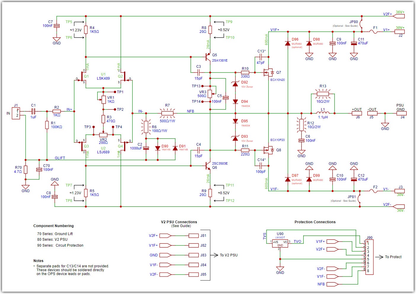

Several factors influence the DC offset.
  1. Gain mismatch in the VAS is the biggest culprit. Degeneration (R8/9) tames the DC offset drift with thermal changes. But it affects distortion if you take it too far. A more complex VAS configuration would mitigate this.
  2. Mismatch in the monolithic JFETs. This is not revealed in SIMs as the models are perfectly matched.
  3. Mismatch in the lateral MOSFETs. This is also hard to assess with models as they are all uniform, where actual devices vary.
It's for these reasons I opted to include feedback cap C2. You can trim the DC to NULL, but without C2 (and C1), the drift from cold to hot states is much higher. With C1 and C2 in place, it is very well behaved. Mine only drifts a few millivolts. I believe Benpes is also very well behaved. Thermal modeling in LTSpice is tedious. It takes awhile to setup, but it helps a lot to predict how the design will function in real life. As well as using device models as close as possible to the actual devices.
There's several ways to approach trimming DC offset. Not suggesting my approach is the best. I borrowed the idea from AMB Beta 24. I like it for the economy of parts. Mainly to allow everything to fit on the PCB without getting too crammed.
When designing the PCB, I tried to allow space for premium parts in these positions. The C1 footprint allows for WIMA FKP4 Metal Foil Polypropylene and the C2 footprint allows for bipolar Nichicon Muse UES 25V caps. I assume this would appeal to some builders.

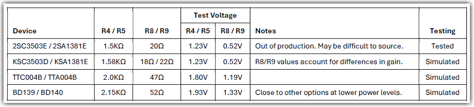

Benpe and me both opted to use out of production 2SC3503E and 2SA1381E devices. These reduce the amount of trimming needed as they are more closely matched. On my build I had a batch of 10 devices each and used a simple transistor tester to further find the closest match I could for gain between the N and P channel devices. As a result, my DC was off by around 10mV or less before trimming IIRC. Once trimmed, it drifts less than 2mV from cold to hot states.
If you use the more commonly available KSC3503D / KSA1381E, you need to use different values for R8 & R9 to account for the gain differences. This was tested in simulations using models adjusted for actual measured gain of currently available devices. Hasn't been built on the bench, but I have confidence it will work. Simulated performance is a bit less than 2SC3503E / 2SA1381E, but it's minor.
Another interesting observation is the behavior of TTC004B/TTA004B in sims. Distortion was a bit worse, but the slew rate has much better symmetry than SC3503/SA1381. Not sure if this actually matters in practice though. It is only revealed at higher power levels.

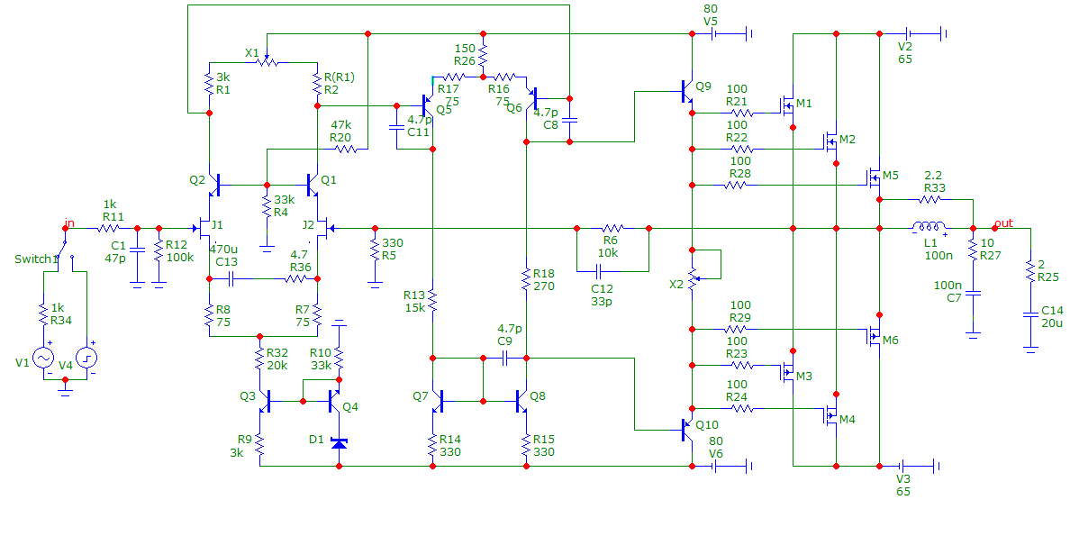

What models are you using for the VAS? Take a look at @cabirio's models from this thread: Tweaked BJT LTSpice models
For KSC3503D / KSA1381E those models were used. They closely matched measurements from actual devices.
For 2SC3503E / 2SA1381E, the KSC3503 model was tweaked for BF=120. That change closely matches the measure values of 2SC3503E / 2SA1381E that me and Benpe had on hand.
You can use the table in the guide to adjust for different VAS devices. This is from section 5.4:
I get a very different bandwidth. I wonder why our sims are so far apart on this. You can see my bandwidth sim in section 2.2 of the guide.
