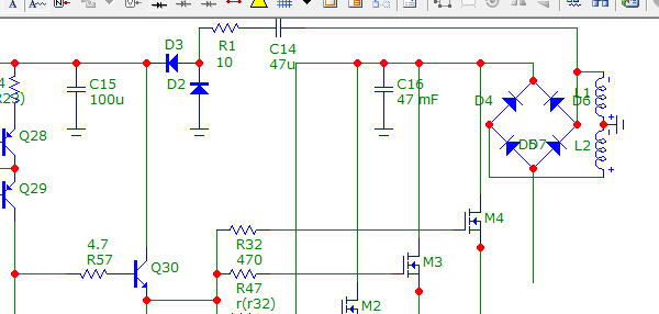

If we get to a GB, I'd really like some feedback on everyone's thoughts on the V2 PSU. Especially potential builders. Do you like it and if so, should it be incorporated into the amp PCB rather than separate?
I'm not in the camp that avoids "switchers" at all cost in audio projects, with good filtering they can work well.
But, I do like to keep options open and keep the PSU boards separate. If one chooses to use the V2 PSU make the In/Out connections a simple wire jumper between boards as you did for your prototype in the above picture.

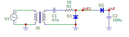

What about using a voltage doubler for the driver, then you don't need two tappings on the transformer. so feed the output section voltage through voltage doubler into the driver section. Should be easy enough and a cheap solution to get two voltages.

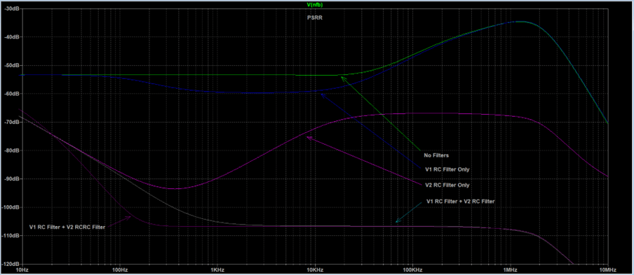

Here's the TLDR summary of PSRR from the guide 🙂. This shows the impact of no filters and the impact of the V2 PSU along with a typical RC filter on the main PSU. In this SIM 0.1R & 10,000uF.
You can also see my exploration of improving the V2 PSU by changing the RC to a RCRC with the same overall resistance and capacitance.
My amp uses this method. The supply ripple is not important as the driver voltage is twice what is needed, so even with 20V ripple it is a non issue really, the driver current is 10 mA only. It is cheaper than another winding on the Xformer.
