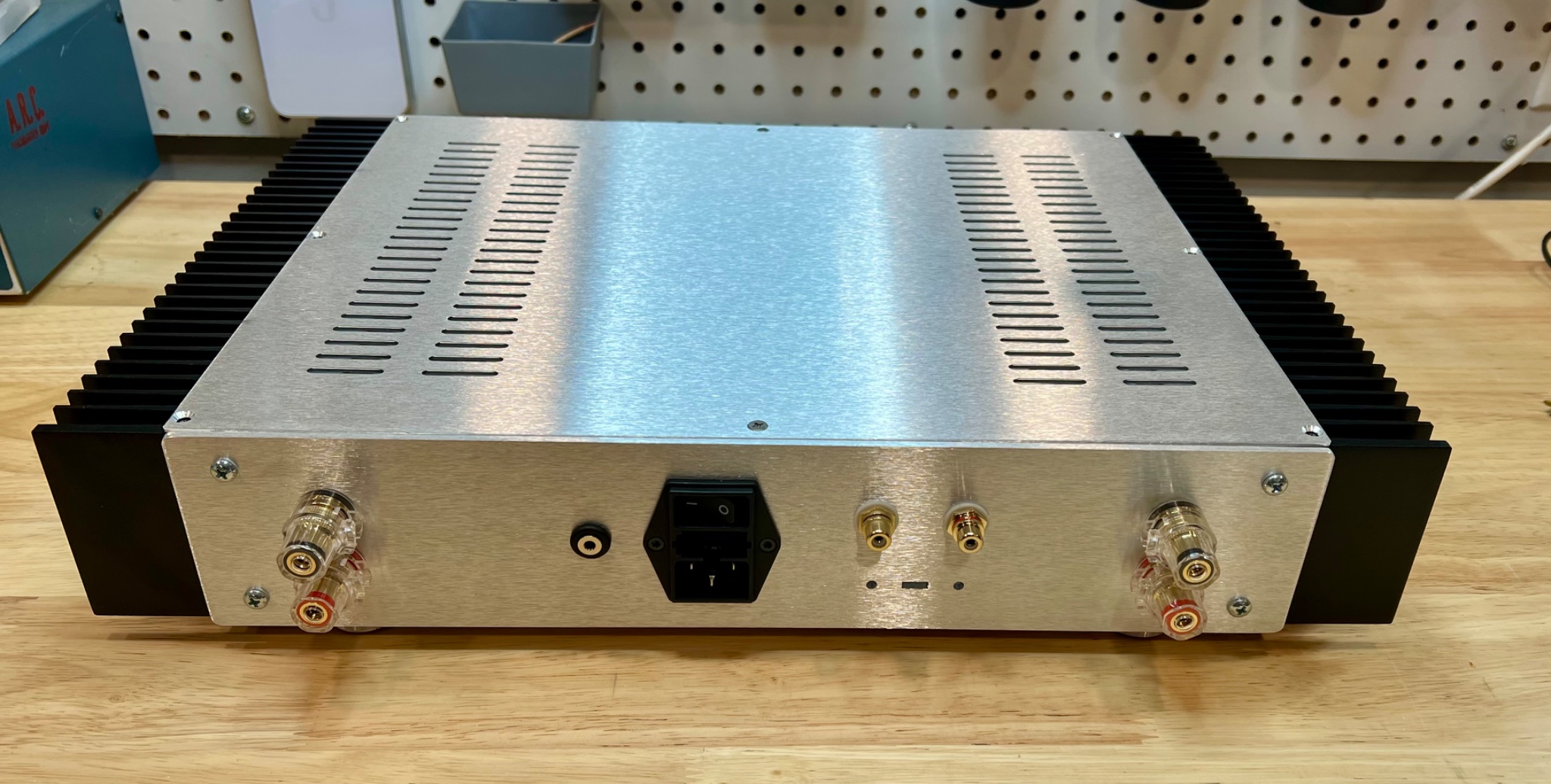

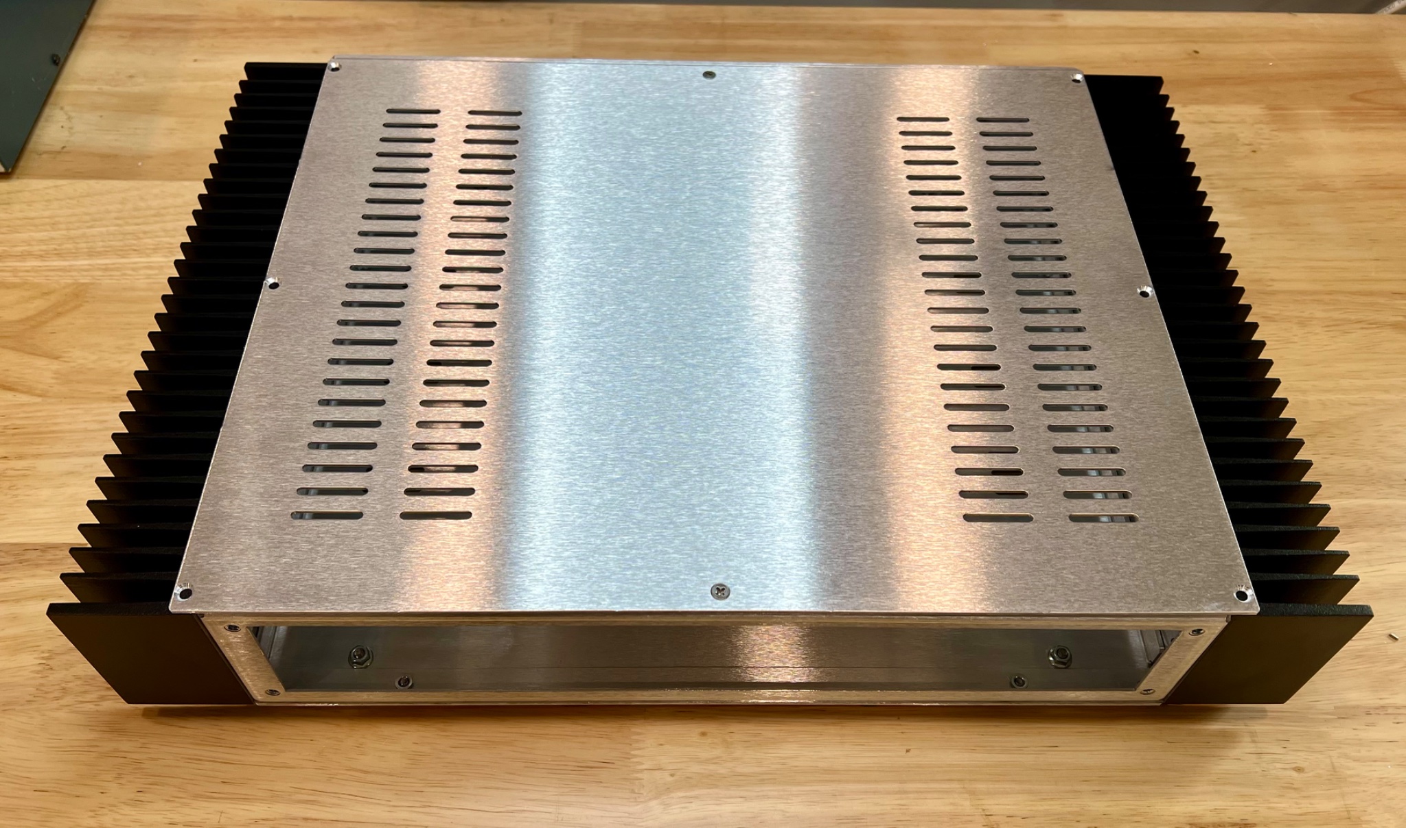

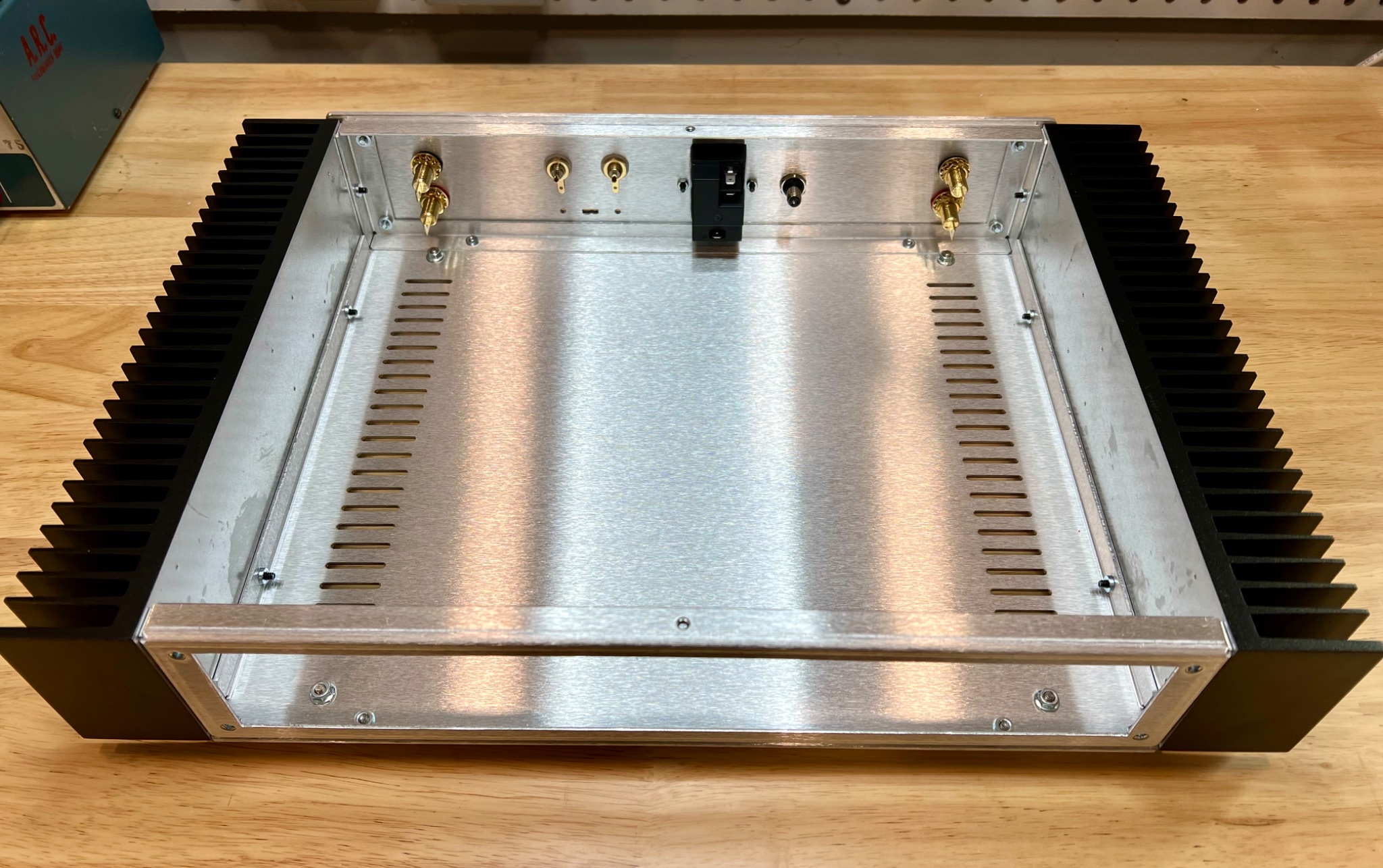

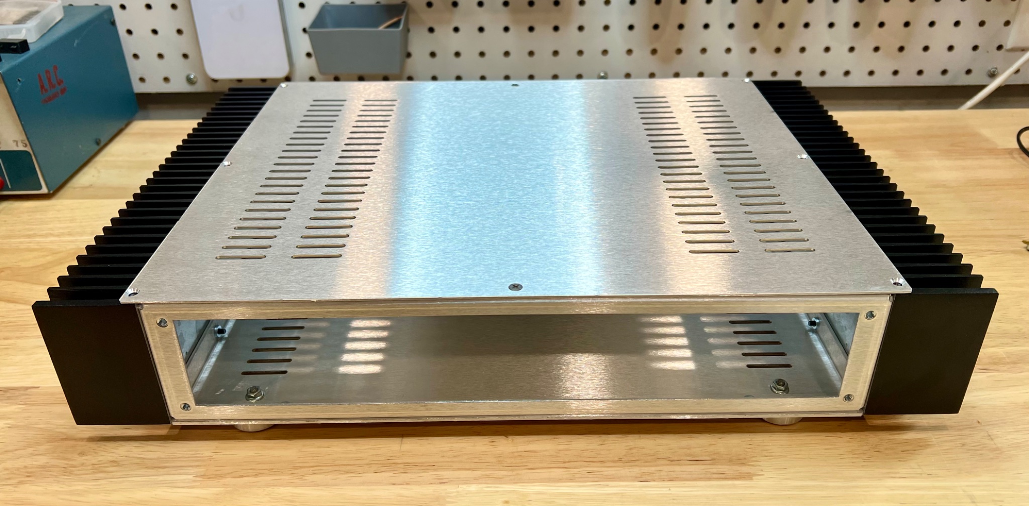

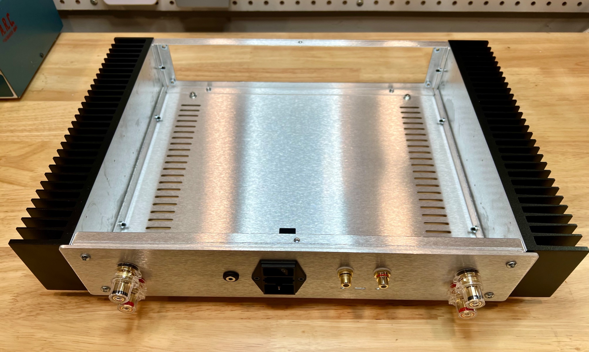

I figured I might get some questions on the chassis I'm using, so I took some pictures before it is stuffed.
This is custom chassis built by Jin at par-metal.com. It is a customized version of their 20-series chassis designed to accommodate Conrad Heatsinks MF30-75 flat backed heatsinks. Jin also fabricated the back panel for me - much cheaper than Front Panel express if your OK without the text engravings. Jin has the CAD files for this now, so I'm guessing others could order it as well (chassis only. I ordered the heatsinks direct from Conrad).
I plan to use Front Panel Express for the front panel, once I figure it out.
Some may object to the lack of symmetry on the back panel. I positioned the inputs next to each other based on advice from Andrew at HiFiSonix (@Bonsai). He has some excellent article on grounding and recommends placing the inputs next to each other with their grounds connected and tied to the chassis through a small capacitor. This layout facilitates that.
