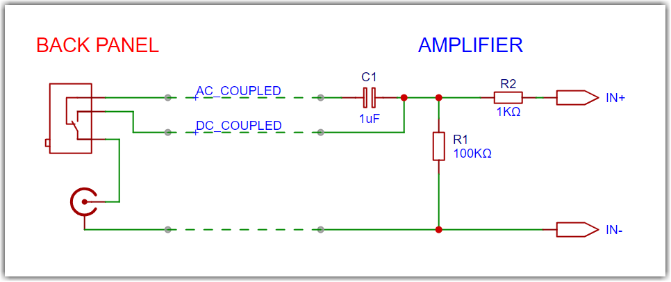

So... Nico made a observation in the other thread that if your source is AC coupled, the input cap (C1) on the amp may be series with the output cap on the source. And this could have the effect of lowering the net value of the capacitor and therefore impacting low frequency response by raising the corner frequency of the input high pass CR filter.
The board has enough space to expand the input connector from 2 position to 3 position. I'm thinking of adding this, with the 3rd position used to bypass the input cap, making it DC coupled.
The idea being that a builder could add a slide switch to the back panel to allow the connection from the source to be AC or DC coupled. I'd suggest the switch be the shorting variety (make before break), which would allow it to be switched while it's active.
Optional of course. You could build it the conventional way.
Thoughts?

Smart move. The user can decide if he wants bass extension. Truly DC coupled amp. Better in everything sonic. Improved phase response, improved distortion. Simply great!

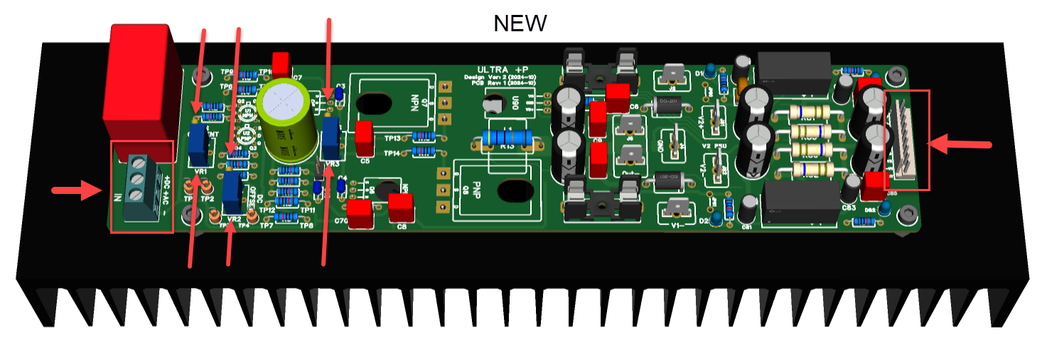

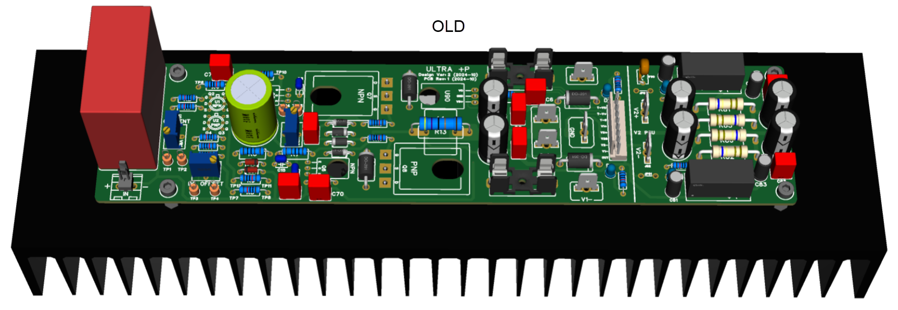

After adding the 3 position input, I was looking the layout over and decided to make a tweak to the a few component positions. I changed all the pots to have the same orientation and cleared the components obstructing them from the top/bottom. The idea is to allow for the use of side adjustment pots rather than the top adjust pots shown in the 3D rendering.
This will allow a builder to adjust the DC offset and Bias from the top once the boards are installed in the chassis. The boards will likely be implemented with the inputs to the rear, so one board will face up and the other down. You'd just need to have the pots mounted to account for this, and then maintenance will be easier once its all put together.

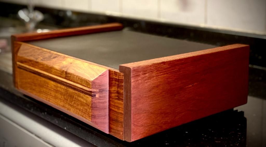

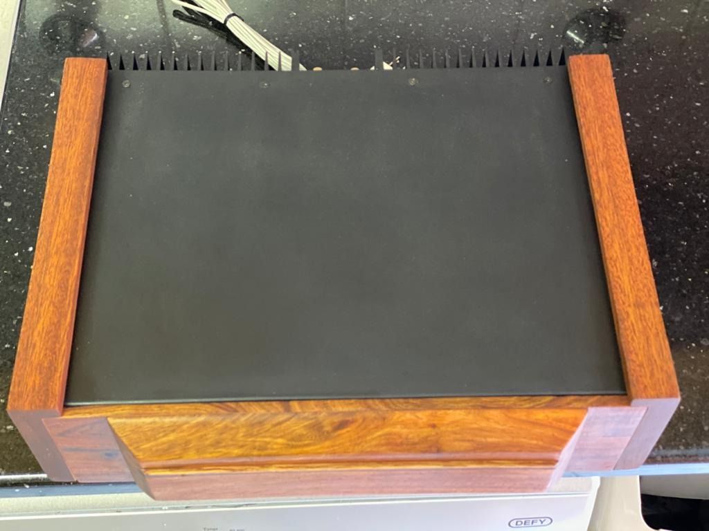

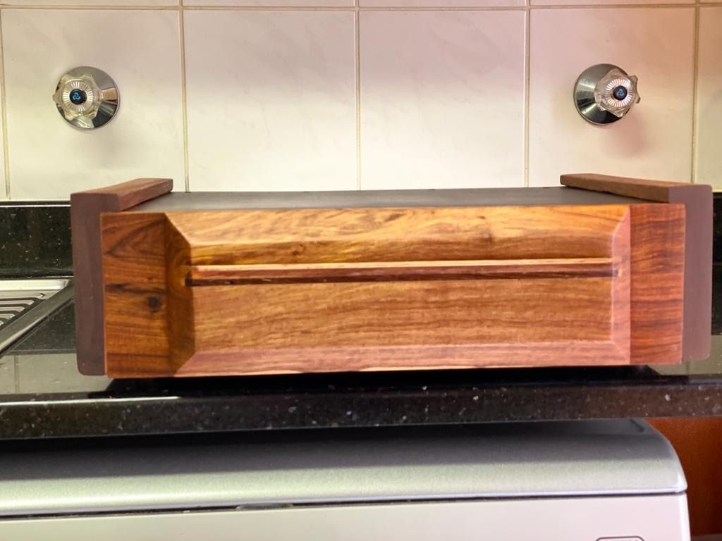

Your design was bread boarded on Saturday even omitting parts that I did not believe was needed and there was no issues to be found. I am starting with my PCB which would be two amps (one mirrored) following your PCB as left channel on a single PCB as mentioned before. I already have a box made up for it from a project I did not complete. I am using a fixed bias by replacing the bias pot with a 1N4004 diode.

I think the revised board is ready for production. I made a few more updates to the connectors.
  1. I reduced the footprint for C1 from 37.5mm to 27.5mm. This allows the input connector to be turned 90 degrees. This should make it easier to route wiring in a 2U chassis.
  2. I also moved the 9 pin protection connector to the edge of the board to make wiring cleaner.
  3. As previously mentioned, the trimmers are all vertical mounted now without obstructions to allow side adjustment trimmers. This allows for easier adjustments while mounted in the chassis.
Time to stop tweaking it and send it off for production.
