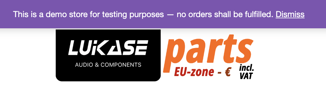

Looking at the site I see the warning that it is only a demo. Has anyone (@lineup) successfully ordered there?

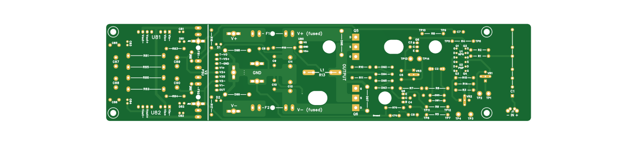

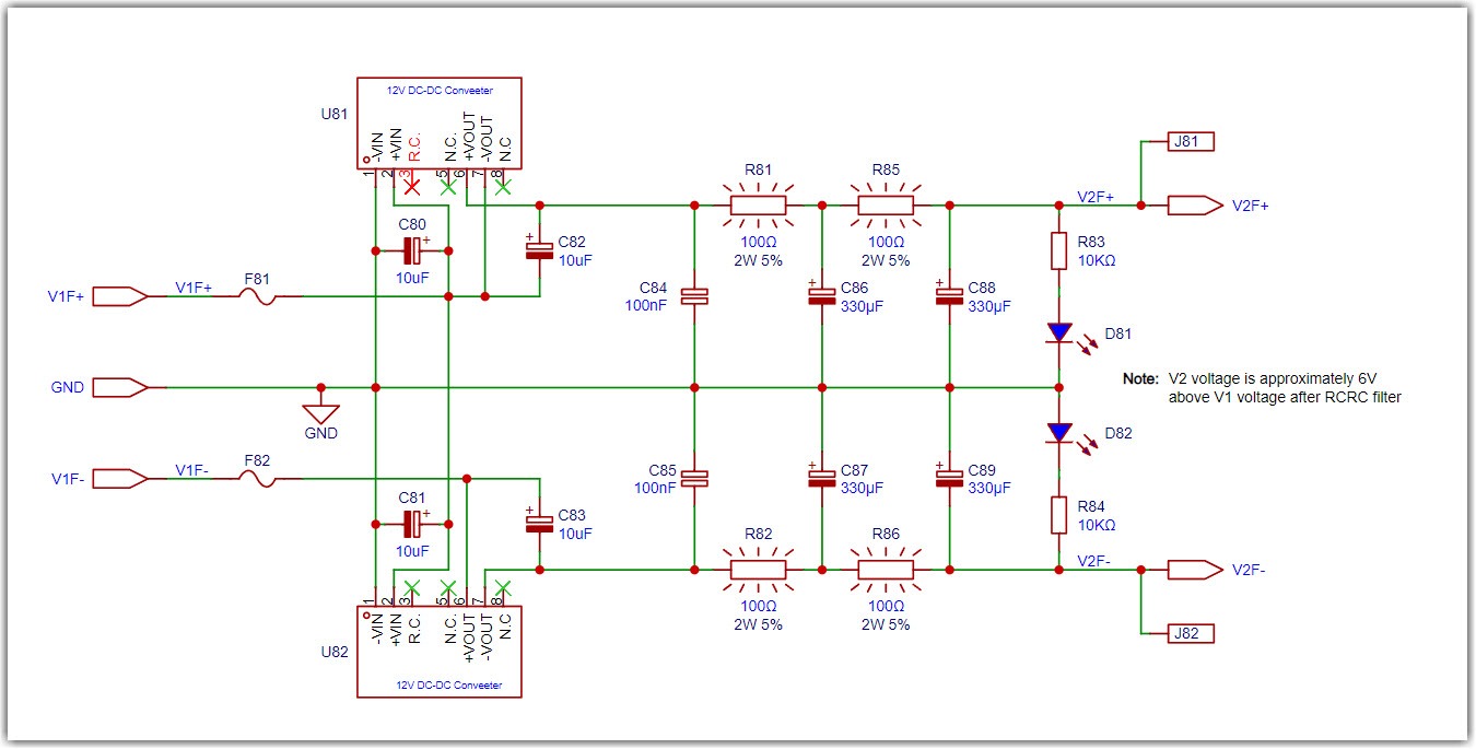

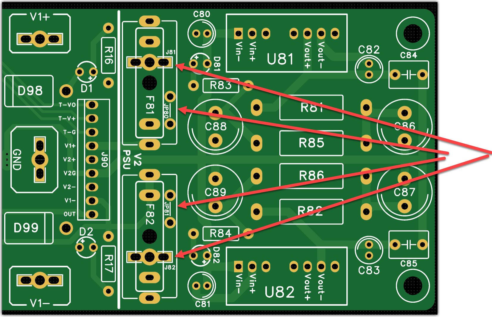

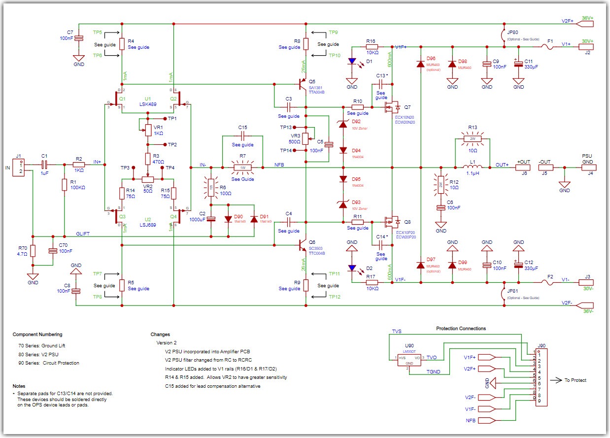

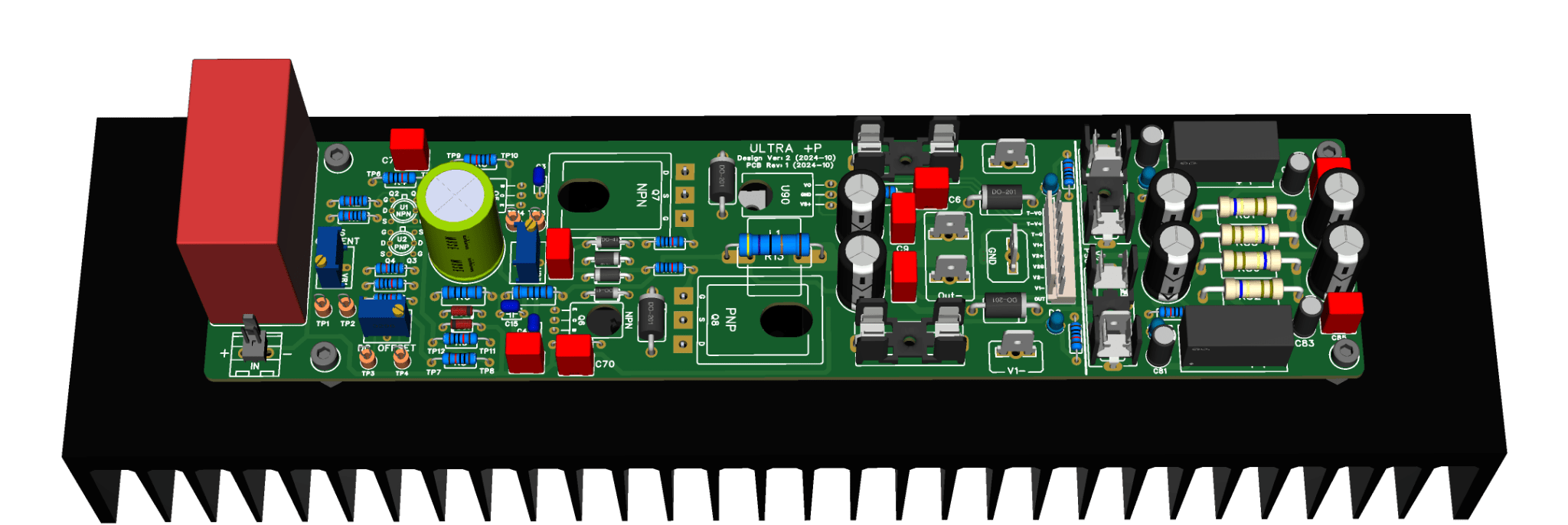

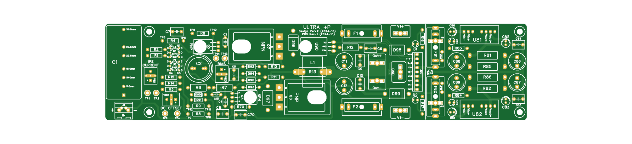

Draft of the changes. These are described in more detail in Post #96. Need to sleep on it and then give them a final check before sending off for production.
Think of splurging on black PCBs.
Note: You may notice that C11 and C12 dropped from 470uF to 330uF. The value for this position is not critical. I changed these to match the values used in C86 - C89 for the V2 PSU. In the original version the V2 PSU used a pair of 470uF caps. These became four 330uF caps. Using 470uF caps in the RCRC filter would be beyond the capacitive drive capabilities of the DC-DC converters. with 330uF it stays within their 1,000uF limits even with if they are all 20% over-spec.

Your layout skills are very good. The board in my opinion is nicely laid out. Labels are not obscured by components and everything else is in its place - nicely done, Brian.
EDIT: I agree with Vunce. The problem that I see if DC fails on the converter the main amp will swing hard to rail and blow main fuses as well, so F81/F82 really is not a protection. BTW the saying goes, for every fuse there is a transistor protecting it, which would fail before the fuse does
EDIT2: Gate diodes D92/92,94,91 is not necessary, they are built into the mosfet already. It would save a bit of board space.
EDIT3: C13 and C14 is really not necessary, the gate capacitance is already high, I have never had any oscillatory problems with Lat MOSGETS (ever) The gate to drain/source capacitance is already high and these capacitors only slows down the MOSFET more.
EDIT4: R10 and R11, could be 270 and 330 ohms respectively and fixed.
@Vunve, Board dimensions are 55mm x 240mm
Thank you for the kind words Nico. I put a lot of work into boards beyond just the basic layout. Like chassis compatibility, device footprints, and the top and bottom silk screen to aid builders. Nice to see it acknowledged.
Interesting thoughts on F81/F82. I did try to simulate different failure mechanisms, including one of the rails failing or the output being shorted. In those cases, the DC-DC converter current draw increased but did not exceed its limitations. One of the reasons I used the larger SIP8 devices is to allow enough dissipation to survive a fault condition. Perhaps the additional fuses are unnecessary. The board size probably won't change much though. Within the footprint for the fuse blocks F81 & F82 are connectors J81 & J82. These provide a pads for tab quick connects if the builder chooses to use an external V2 PSU. There is also jumpers JP80 & JP81. These allow a builder to omit the V2 PSU and provide power from the main rails. I can reorient these and maybe shave a few mm's off the board size, but not much.
You wrote Gate diodes D92/92,94,91... do you mean diodes D94/95 and Zeners D92/93? These are not included in the Exicon to my knowledge. I thought it was D96/D97 that are redundant for the Exicons. As the datasheets don't seem to explicitly show the diodes, I thought it safer to add them as optional components. In either case, these are not necessary for the amp to function. A builder can choose to omit these. This is discussed in section 5.10 of the guide. Omitting D96/D97 has been brought up before. It wouldn't really affect the layout much, so I opted to leave them in as optional.
C13 and C14 may not be needed. Sims do not indicate they are needed, however many builders on this forum using Exicon laterals have indicated problems with oscillation in practice that don't show up in sims. I thought it safer to add them. When I assessed them in simulations, the impact on THD and slew was very small to non-existent. This is mentioned in the build guide in section 5.2.
R10/11 are recommended at 330R/220R for TO-247 and 220R/150R for TO-264. Similar to what you are recommending.
I accept your simulations Brian, I am referring to actual experience with these components, but if you want to be certain then that is of course your design. There can never be too much protection in anything. It is mainly economics of scale. I stand to be corrected but remain, well done, world class layout.
P.S. Have you considered self resetable fuses?
