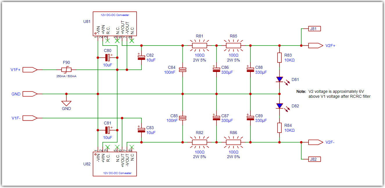

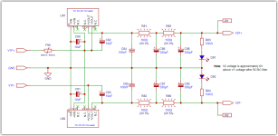

Here's what I'm thinking after incorporating Vunce and Nicos' input. The fuse blocks are removed and a PTC Resettable Fuse has been added to the positive rail.
As I examined this further, the intent of the fuse is to protect the DC-DC converters and these source from the positive rail. So, the fuse is really only needed on the positive rail.
I have it spec'd as optional (90 series). Its a 250ma / 500mA part. Meaning a 250ma holding current (125mA per rail) and a 500mA trip current (250mA per rail). The 250mA per rail correlates to DC-DC converter max current rating of 250mA. The DC-DC converters should draw about 35mA each in normal use and maybe 100mA of surge at startup. Even if the surge is higher the part has a 2+ second trip time, so they should survive any momentary startup surges.
I decided to leave the board size at 240mm x 55mm and provide a bit more space around the connectors. It was pretty tight before.

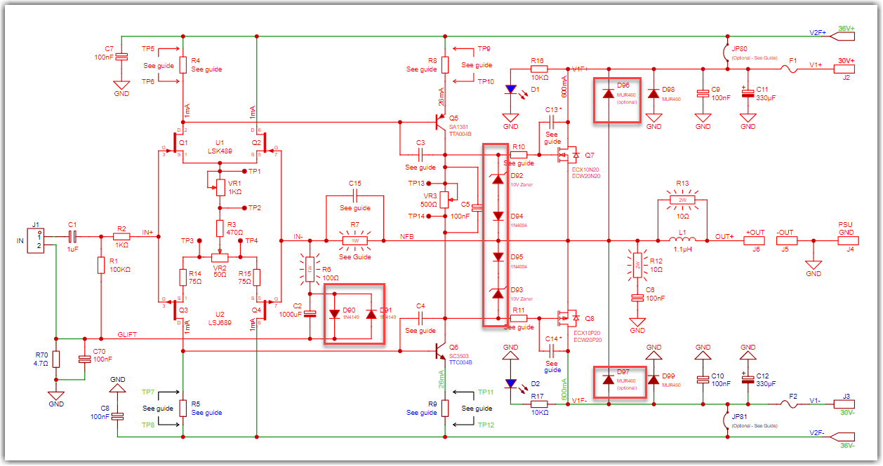

After much discussion in this thread and the original design thread, I'm thinking of a few changes:
Anyone have any sentiments against these changes?
- Increase R6 & R7 by a factor or 10. This will reduce the size of these resistors to 1/4W components. This allows C2 to be lower value and therefore use a higher voltage cap. With these changes, the anti-parallel diodes D90/91 are no longer needed. Discuss on this start at post #212 in the original thread.
- Remove the Gate-Source diodes D92 - D95. These are redundant to the Exicon devices integral protection.
- Remove D96/97. These are also redundant to the Exicon devices integral protection.

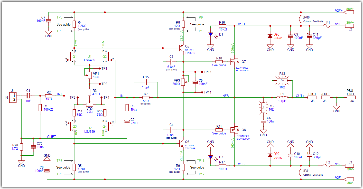

A lot of discussion going on in the original design thread about VAS currents and VAS degeneration. As a result, I'm rethinking some of the component values.
VAS degeneration R8/9 have been lowered which also lowers R4/R5. Performance improves, with the tradeoff of more variance in the OPS from cold to hot states. Still reasonable though. Maybe 50mA or 60mA of variance at most.
I also introduced lead compensation via C15 which lowers C3/4. This improves THD a bit, but increases bandwidth from 2.3 MHz to 4.3MHz. Not sure that this is good. We'd need to build it to see if this causes problems in practice.
This also incorporates the changes from post 128 above.
The schematic below has values for 2SC3503E / 2SA1381E. If TTC004B/TTA004B are used, R4/5 drops to 1K and C3/C4 are omitted. Perform will be similar with a slight nod to SC3503 /SC1381

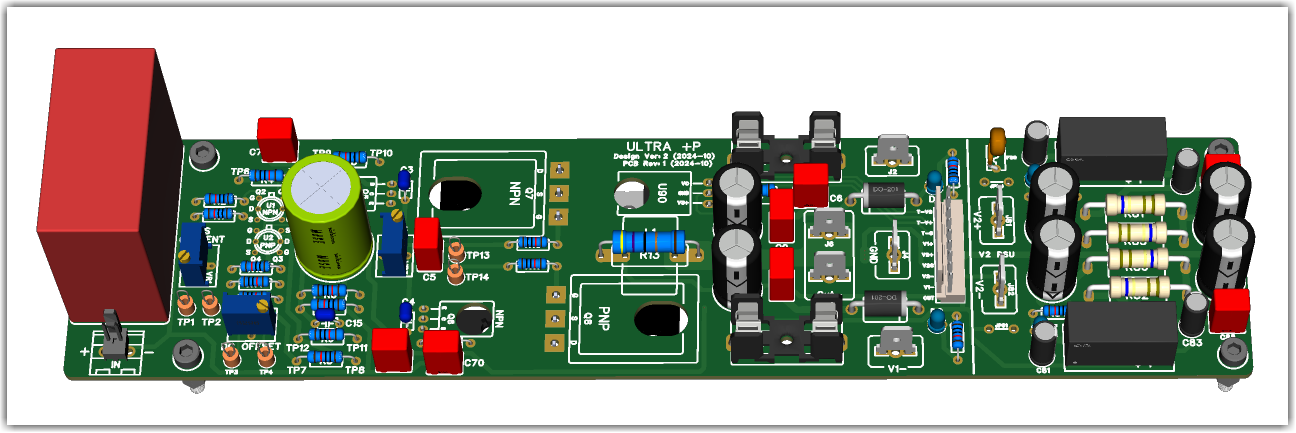

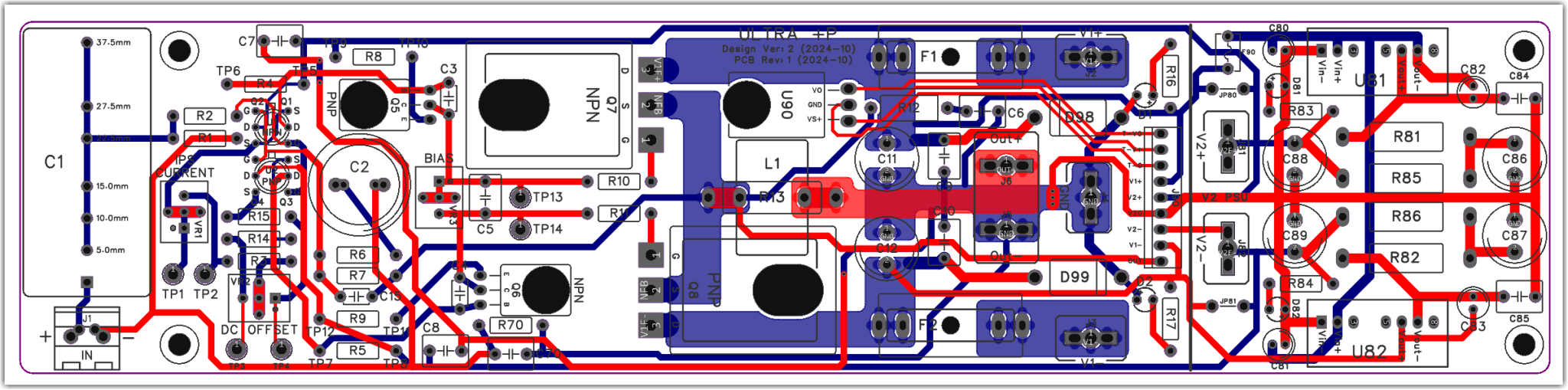

And the layout updates. Board size remains the same, just more space around components. Which will be nice. Some of the Test Points were a bit tight in the original layout.
One other note... I revisited a Capacitance Multiplier vs the simple RCRC filter. The resulting PSRR was about the same. Only real upside to the Cap Multiplier is that it dropped less voltage allowing the MOSFETs to swing closer to the rails. You could theoretically run lower voltages for the same output and have less Class A dissipation. The additional complexity didn't seem worth it too me.
I am blown away by your PCB layout, it is beautiful! And I am not trying to suck up to you. Unfortunately, the other thread is getting a little overly complex and I think it is losing its original intention..

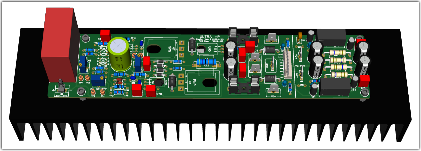

240mm x 55mm. I used this size to make it easier to fit on a heatsink as small as 2U. It should work work with the Modushop Dissipante 2U chassis and clear their mounting brackets.
