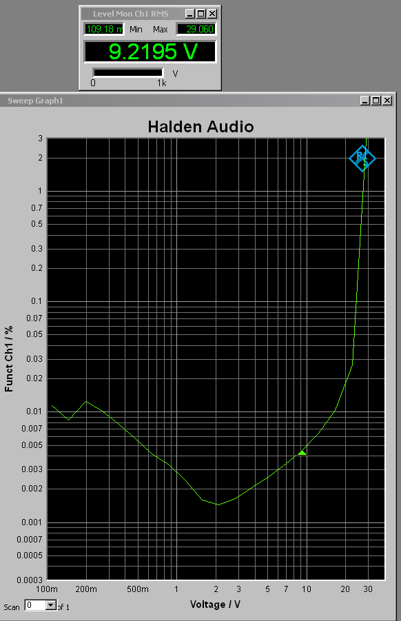

yes that a thought. I have never measured harmonic distorsion with a Se input (with the UGS 6). Only measured with Bal. input > Bal. out.
Here is the measurement of mine (Bal.in > Bal. out with the UGS 6.
We see a small "hiccup" from my measuring instrument when it changes measuring range at 200mV. This graph is a combination of noise (N) and total harmonic distortion (THD) and tells quite a lot. Up to 2V, the noise floor (N) dominates this graph. The graph will then decrease as the signal increases. We already know that the noise floor is disappearingly low so this is more than approved. From 2V it is THD that decides and we get an increase in distortion as the signal increases. The fact that we have a minimum of around 2V fits perfectly since this is the maximum the preamp must deliver for a typical power amplifier to max out and go into cutting.
We see that it can handle "ridiculously" high 20V RMS at a distortion of only 0.02% and does not cut until around 27V rms. (38V peak !!)
Regards
Johnny

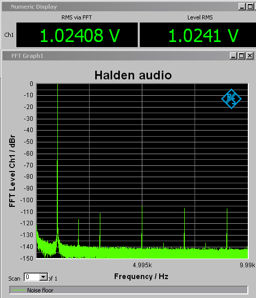

here is some more measurments of mine (still with the UGS 6)
THD+N , 1V og 1kHz
Here we see exactly how the superharmonics are distributed by a signal of 1V at 1kHz. The highest is the fifth harmonic which is at -105dB. This is very similar to the XP-30 which has the highest at -110dB.
THD+N , 1V og 1kHz
