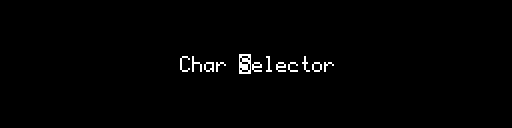

Alex - one more tweak which would be perhaps useful. With the current version of FW assigning of the name for an input or change power off message etc is really panful and time consuming as all ASCII codes are available (including very strange special symbols etc) so in case that you have to scroll to find a character you want to select it may take some time. Maybe you can limit this to useable character set (upper and lower case, numbers and perhaps hyphen, underscore, space etc).
I know - you do this once in some time only while you setup this feature but maybe it is worth to consider to make this task easier...
-jacek
Ok just done, you have now a reduced font set.
If you want to have the name setup faster I can also remove the blinking function.
If the blinking function is the only indication, that you´re actually "IN" the setup-menu, I would leave it as is 🙂
remove the blinking is better.
also, i am already implementing a character selector like that :
U8g2 setColorMode(2) and then fill a box around the char selected.
a monospace font is useful there 🙂
just an idea
Yes this is exactly what I had in mind to replace the blinking but the problem is that I need to check also if this is compatible with the VFD...
