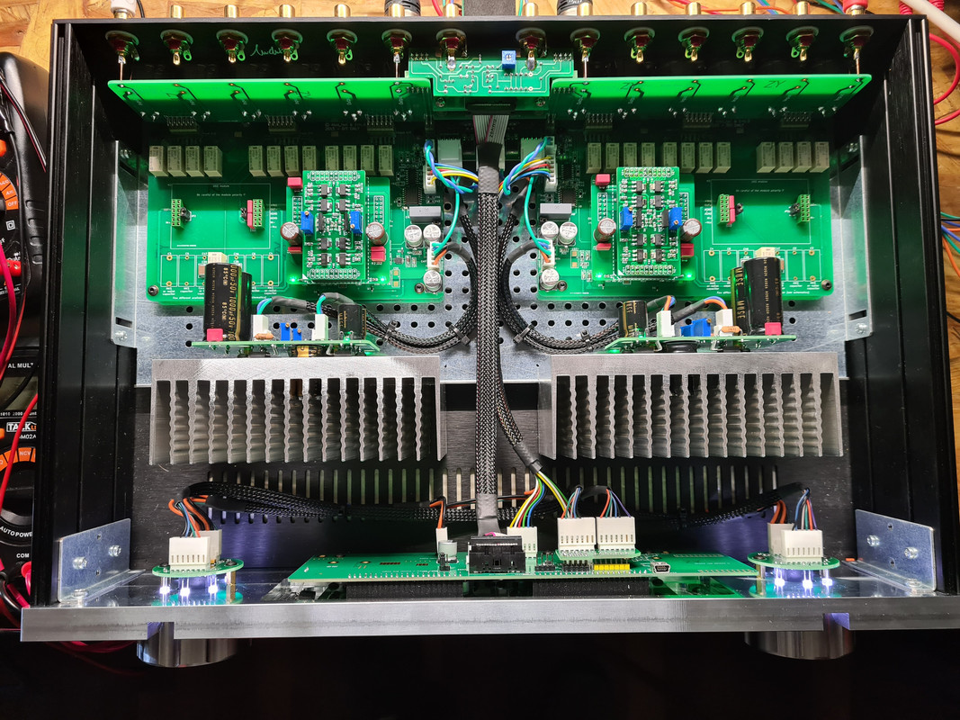

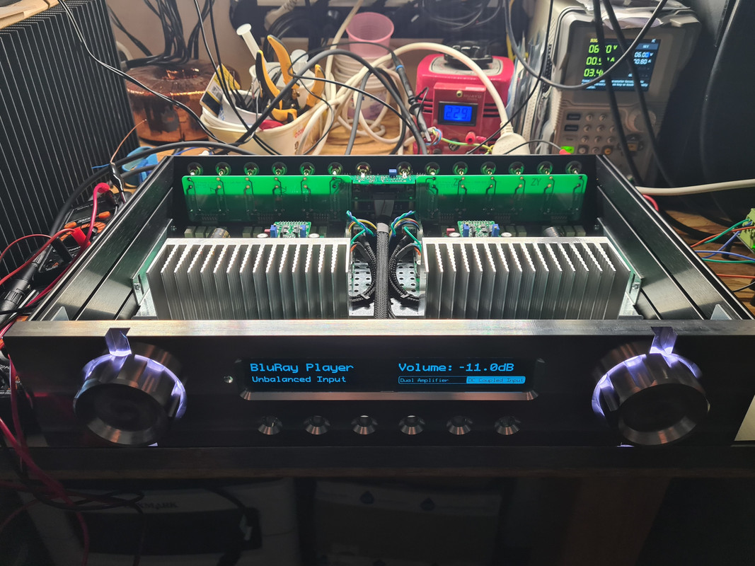

About the UGS v6 :
before anyone would start screaming about "copyrights" and so on... i have full authorization from Mr.Pass himself.
as long as i keep for myself, everything is already sorted out.
i was doubtful to show them in photos... but I evaluate the mindset of the people around here to be suffienctly good to not start a war about it...

very impressive build my friend... respect!
thanks 😉
if somebody is interested i can manufacture the whole mechanical and custom electronics parts to reach the same level.
of course, is sold as "cost of material", my work is free 🙂
thanks 😉

i meant that if somebody is crazy enought and wants to replicate 1:1 what i did I can supply all the custom mechanical parts to mount on the Slim-Line case.
I have full and free access to a fiber laser to make the engravings/lettering and to a 3-axis cnc to work on the alu parts (knobs, frontplate, heatsink).
i will not share plans, but i can do all the work and sell with a price of cost, withnout any premium or surcharge. i don't want to make a profit from it.
at the moment the case is still missing the anodization... a medical situation has stopped me from sending to the anodizing facility. i will recover next year.
i would love to see a build-gallery....
i can work on it. when i will disassemble everything in order to get parts anodized i will document carefully all the details. 😉
