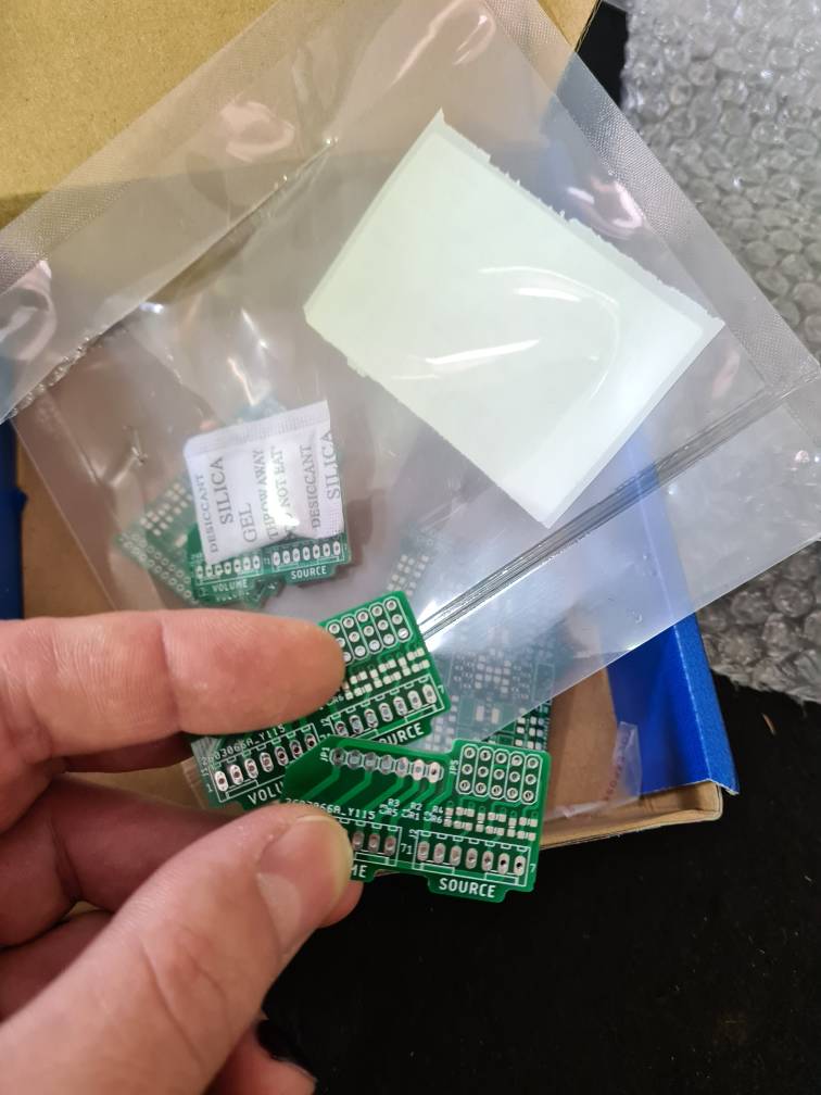

They are here...
I can't test the second encoder because the optical encoder is still in the hands of ups. They blame snow for the delay ... Go figure.
As soon as I get them I can test my whole contraption and then... If someone needed i can give Gerber's for both the adapters and the ring light.
I trust stone for the functional test of the second encoder.. i didn't see that delay coming. So on that matter I have no feedback. Other than that... Everything else seems to run pretty smoothly.

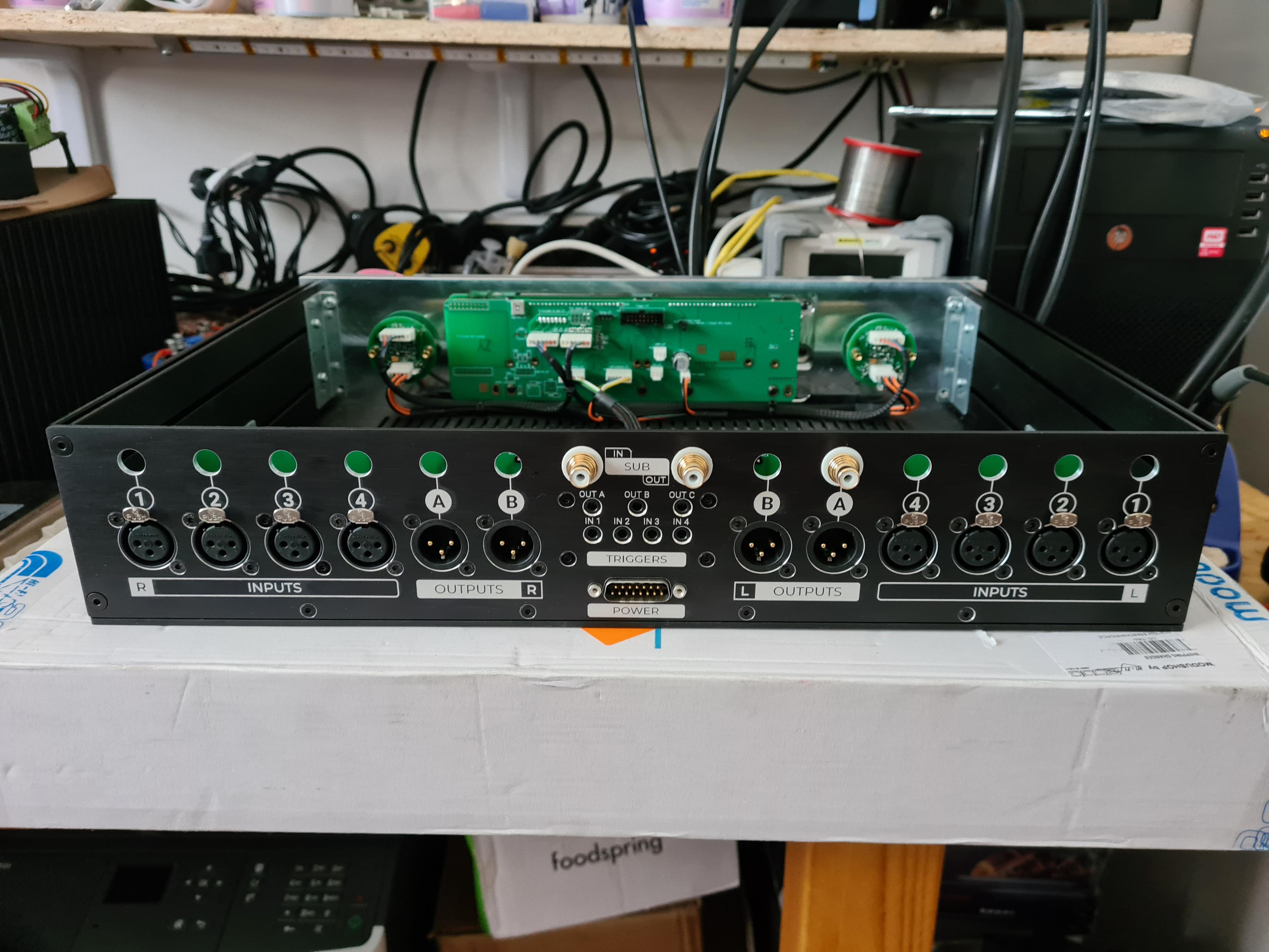

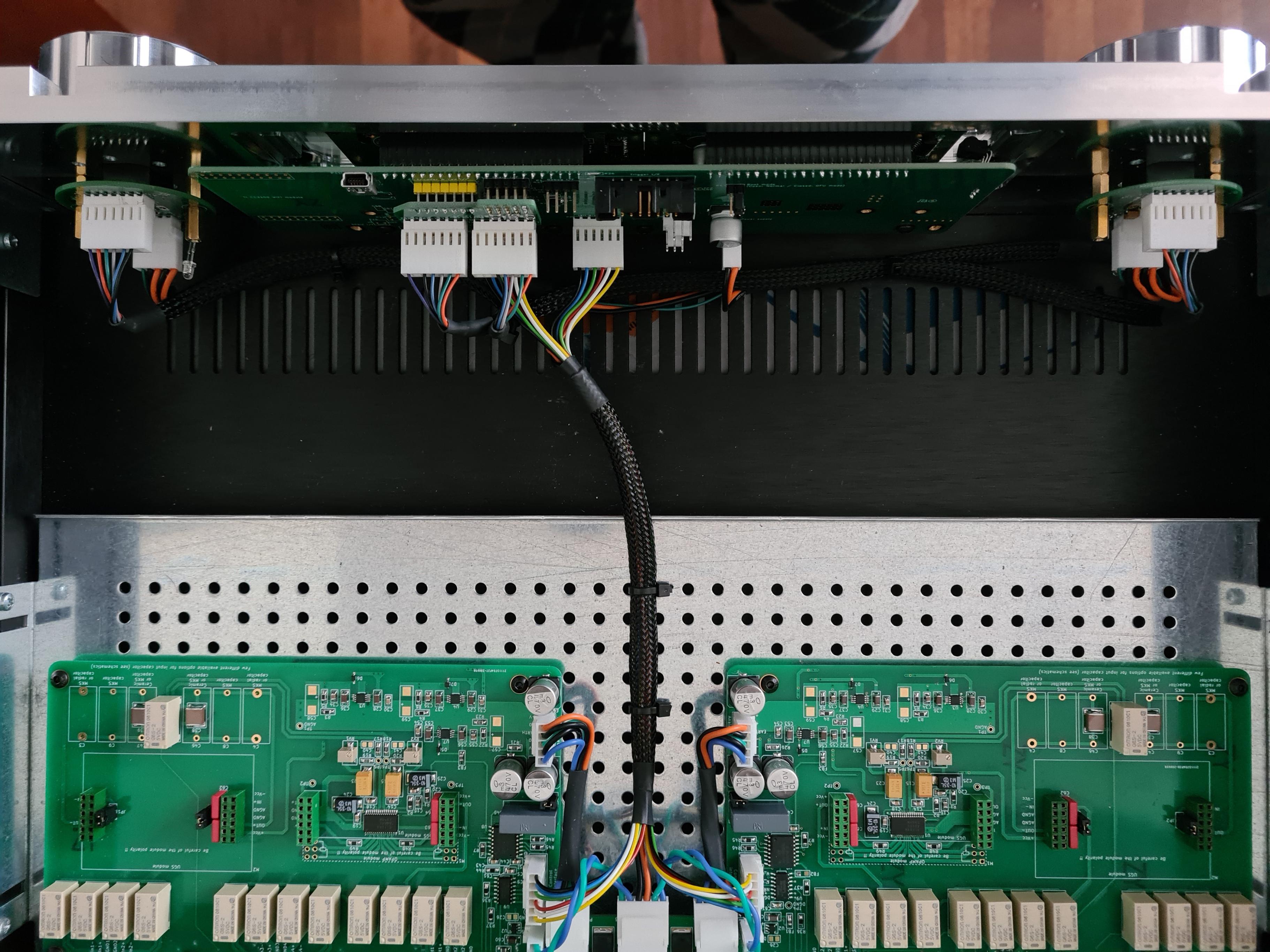

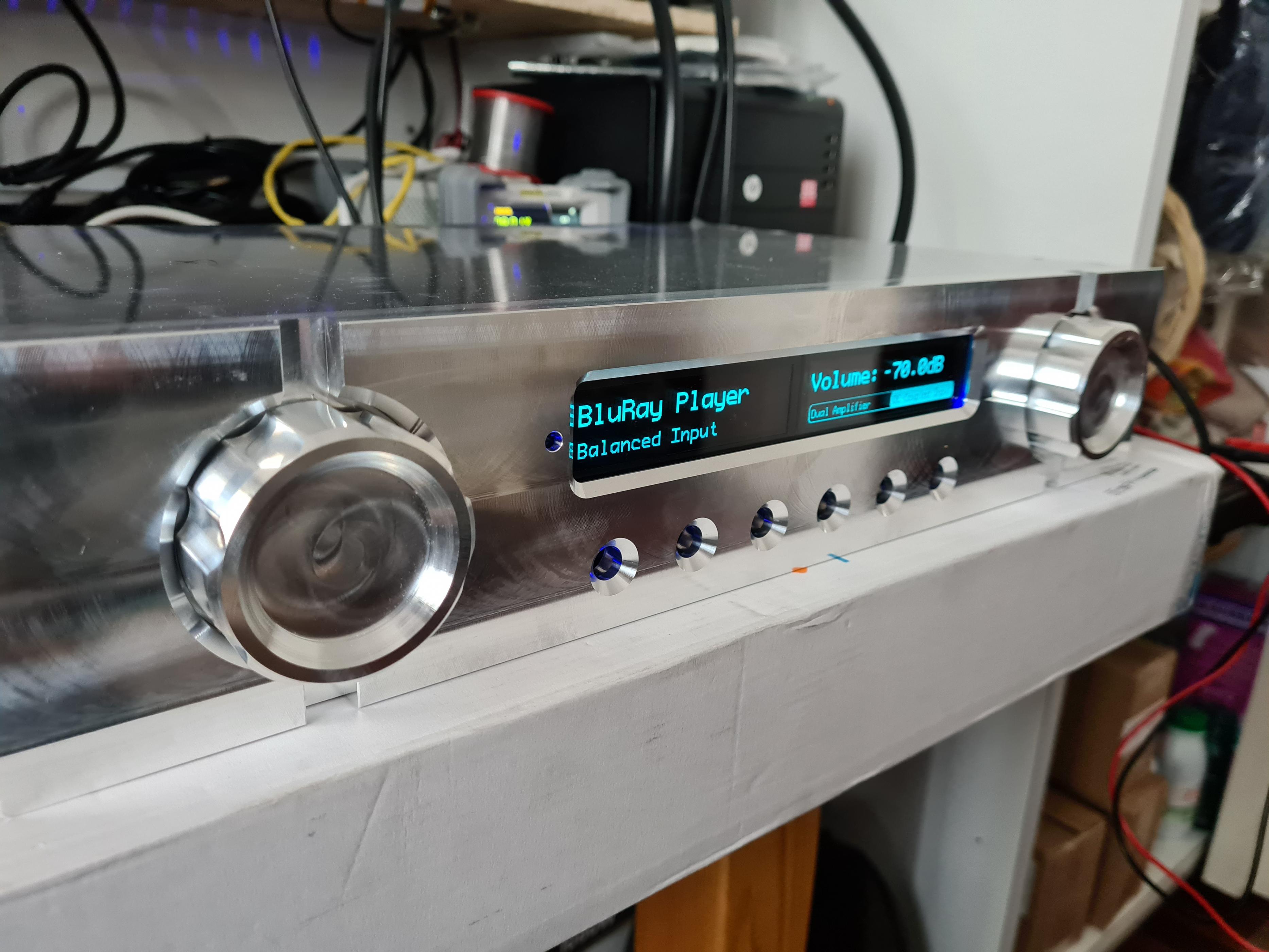

The pcb splitter and the source/volume ring fading light works fine. Just a minor overlook over a resistor placement on the splitter, easily fixable, already doing a re-run on them to be able to guarantee a smooth operation for whom will decide to adopt it.
(if you look at the photo, don't mind the led placement on the encoder support board, they are placed temporarly, i still waiting for the right ones 🙂 )
And as a closing note, progress made also on the back panel.
Still missing all the anodization on the parts i have milled, but finally i can see the light at the end of the tunnel 😀😀

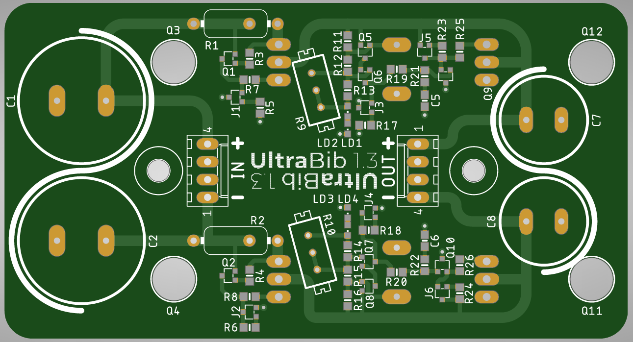

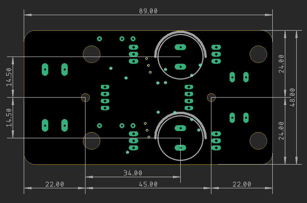

Another thing related, that may someone needs for a more integrated build.
I've made an ultra-compact ultra-bib 1.3 for my special needs.
As you can see dimension are pretty shrunk, only under-mounted fets. High specs cap place holder.
Other than than, is yet another rendition of the ultrabib 1.3 with all smd components.
on the way to me from JLC. when they arrive and tested, as always i can share all the details/info.I want just to notify that in the case someone in the while needs some sort of solution to simplify their build.
